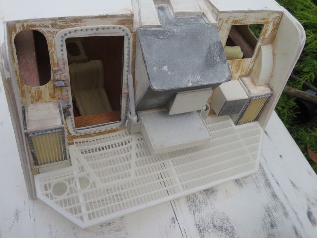

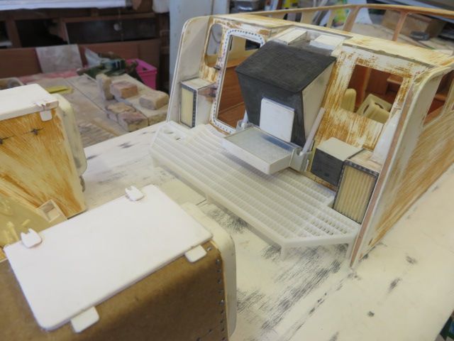

          since my rear grating for the fore cabin came, I have soldiered on with making all the fittings for the cabins which will be sprayed the orange of the boat.
          I started with the aft cabin, and have recently finished the major parts that needed to be fitted ready for those all important layers of paint.
          #90914

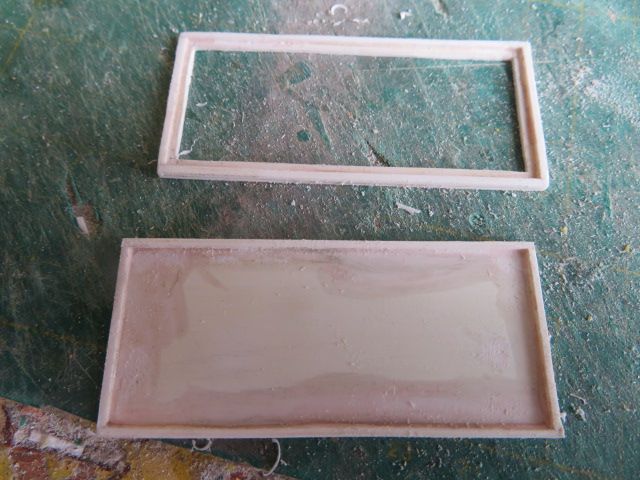

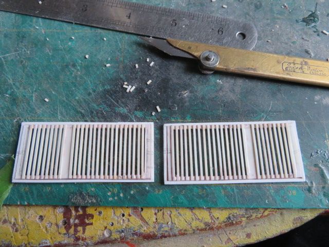

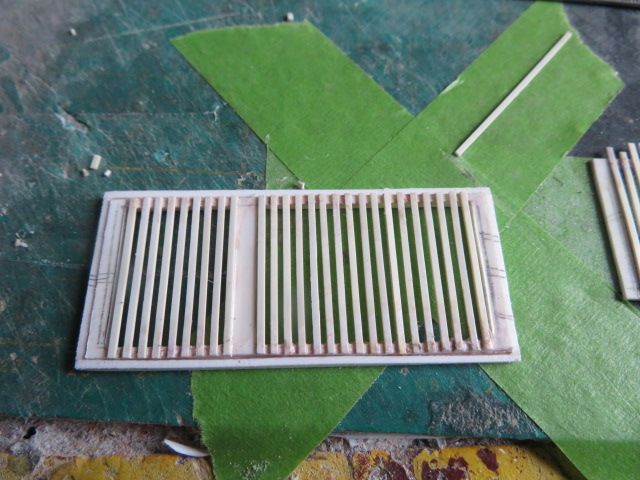

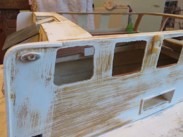

            it now came to the detailing of the main cabin and the fixed parts that are to be painted with the cabin all the same colour…..Orange.
            and the first parts were the main recessed locker covers for the fuel fillers and goose neck vents, which are set into the cabin both port and starboard.
            I do like a bit of fiddling now and then,
            and the covers to the filler caps and goose necks in the recesses of the main cabin couldn't have been more fiddley.
            the only way I was going to tackle it was by using plasticard, and a delve into my large supply of plastic sprue in many thicknesses and widths.
            and the build of both the frames and the grills began, and amazingly they came out right.

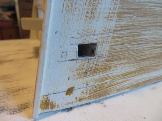

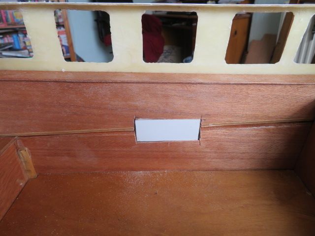

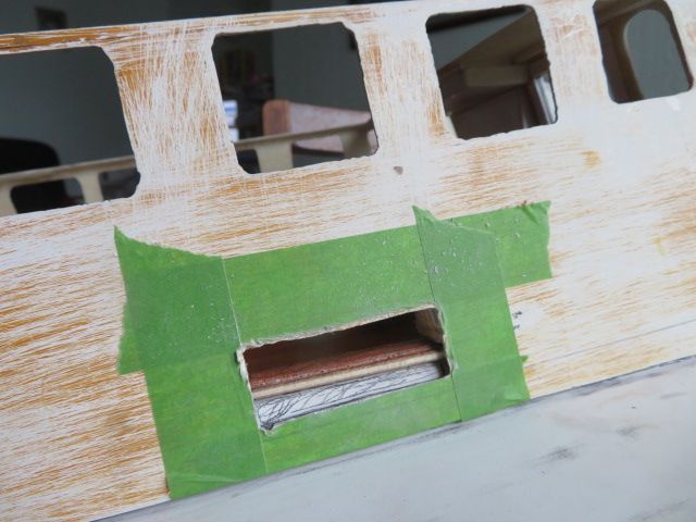

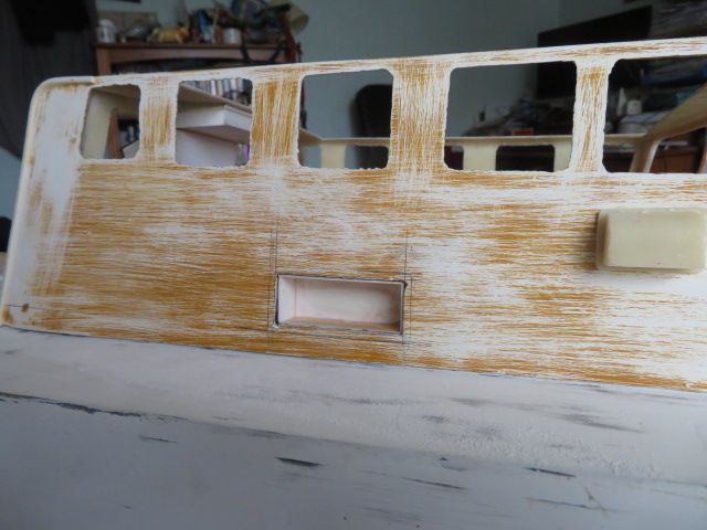

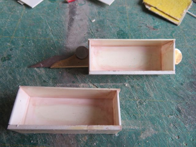

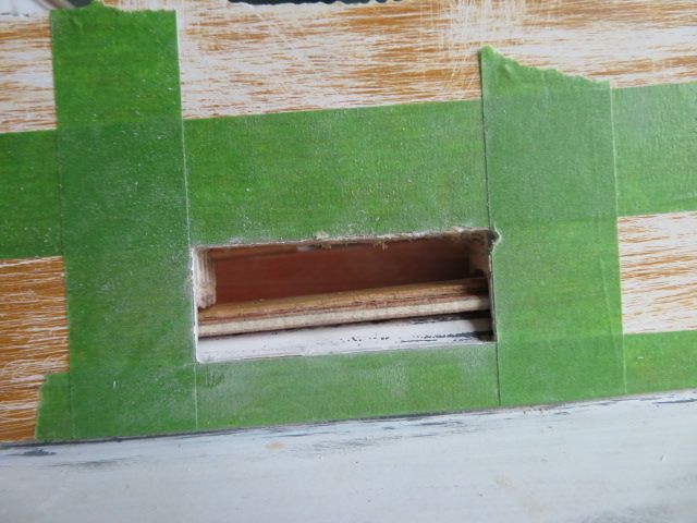

              so!!!, I made the grills for the covers to the fuel fillers and vents………….but they are no good if I cant put anything behind them………and as they were, they were just going on a blank "wall",
              so some surgery was needed to make that recess to put the vents and fillers in to.
              there needed to be holes cut in the sides of he cabin, and cut outs in both the inner cabin tray and the combing which the cabin and interior fit into and on top.
              finally there needed to be two "lockers" [for want of a better word] made from plasticard , the size of the grill frames that I made yesterday to fit into the holes to be cut out.
              all things were reliant upon the size of the grill frames, and so these were marked out on the sides of the cabin and masked off. they were then drilled and reamed out, trimmed and filed up to shape and size and then used to make the lockers.
              I was in fact surprised just how easy the process wentm and with a little trimming up afterwards of the combings around the hull access, the whole thing went well.

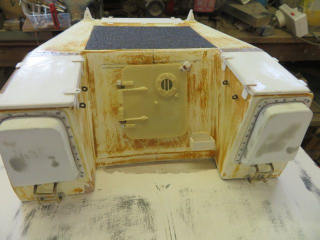

              #91007

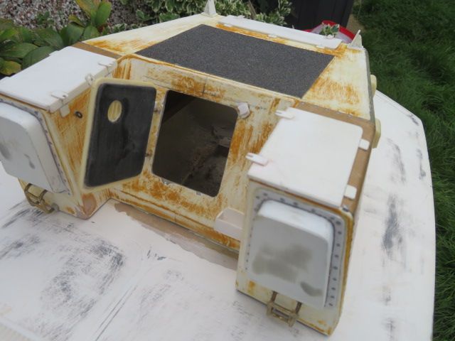

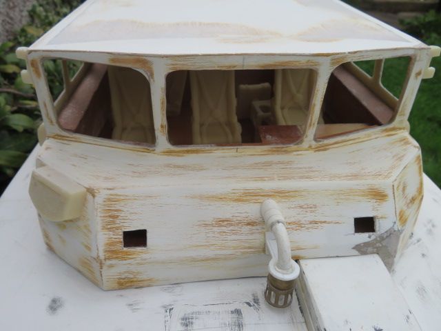

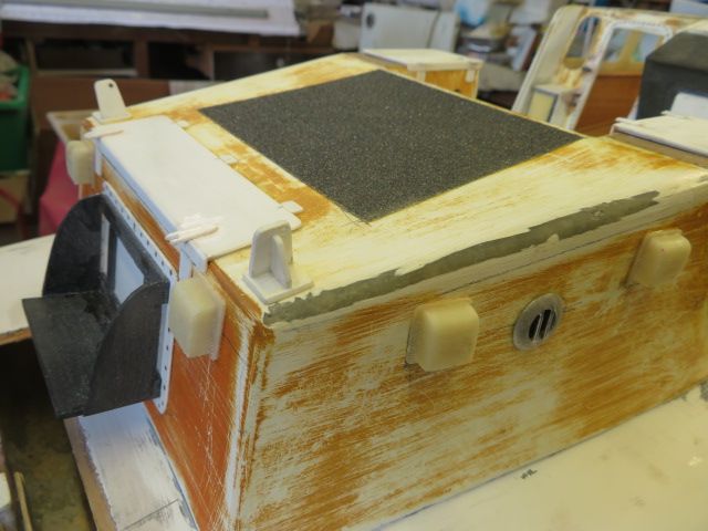

                started putting the small detailing parts onto the main cabin and hull this evening.
                cut out the apertures for the LED's behind the deck lights, the water outlets both port, starboard and aft, the hydraulic ram outlets and the surrounds to the recess for the water, diesel and air vents, and the guides to the safety rails which run along the fop corner of the cabin.
                just off now to make the retaining bracket and stop for the boat hooks port and starboard.

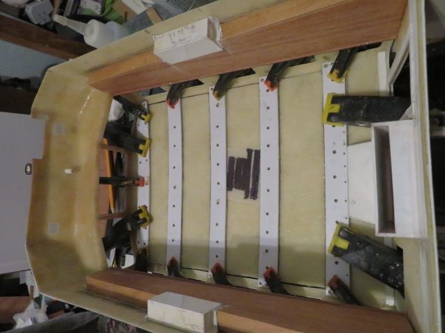

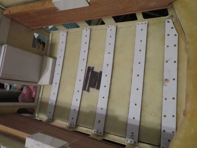

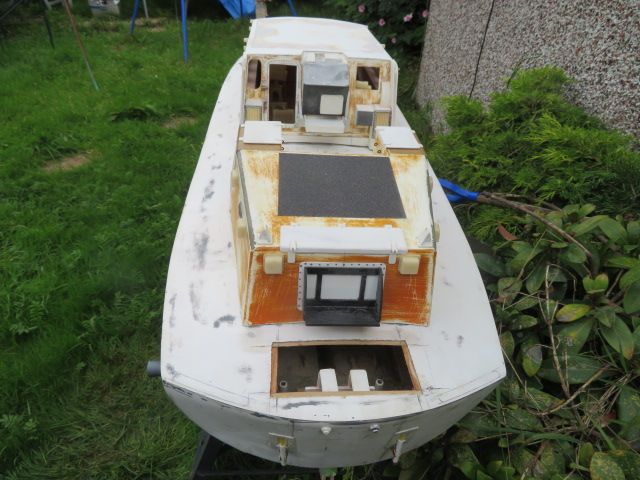

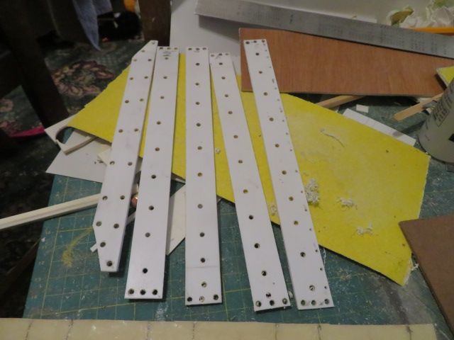

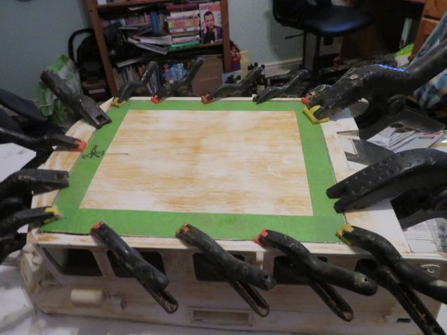

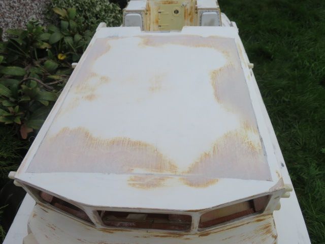

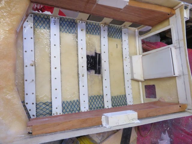

                  it had now come to the point wher almost all fittings had been attached to the main cabin, ready for spraying orange, and so
                  it had come the time to re-attach the section of the roof that I had cut out, in able to gain access to the interior whilst making the interior tray.
                  first I cut some cross beams from 2mm plasticard to support the roof and also glue to the sides just above the line of the window frames
                  the cross beams were drilled to enable a purchase between the plasticard and the grp cabin.
                  I first glued the beams to pre markerd positions within the cabin with 30m epoxy, and left for a couple of hours or so.
                  once set I used epoxy again and glued the plasticard beams to the cabin rims, held with spring clamps, and left to set and cure over night.

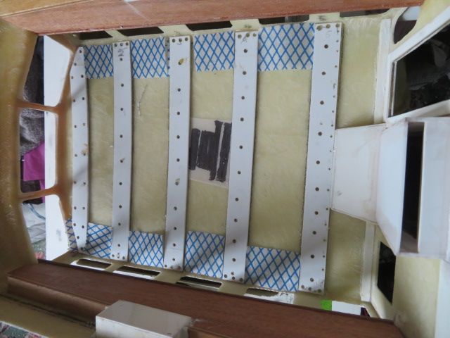

                  tomorrow I will glass and resin the insides with grp polyester resin and [probably] surface tissue to seal it all up, before filling from the outside with p40 filler.
                  #91009

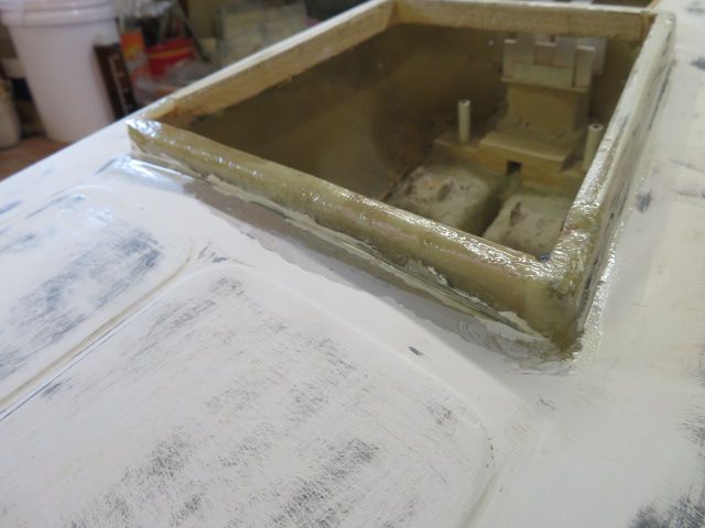

                    This evening I have just stippled in some J Cloth squares into the gaps between the cross beams to hold the cabin top in permanently .I used grp polyester resin to stipple in and cement the j cloth to the cabin top.
                    I mixed more than I needed of resin and catalyst, because I also needed to fill in the keel recess at the bow so that I could drill the two ruffle holes at the bow keelson, so that the hull, once holes were drilled, wouldn't leak.
                    finally I used a little of the surplus resin to paint the aft combing where, after sanding to fit the cabin top, the gelcoat was removed and had left bare chopped strand matting. I sealed the "open wounds" with resin.
                    i'm just now for the resin to set and cure before doing anything further on either the hull or the cabin.

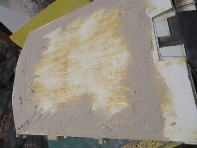

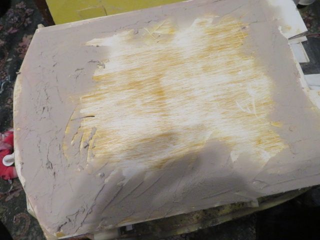

                    #91028

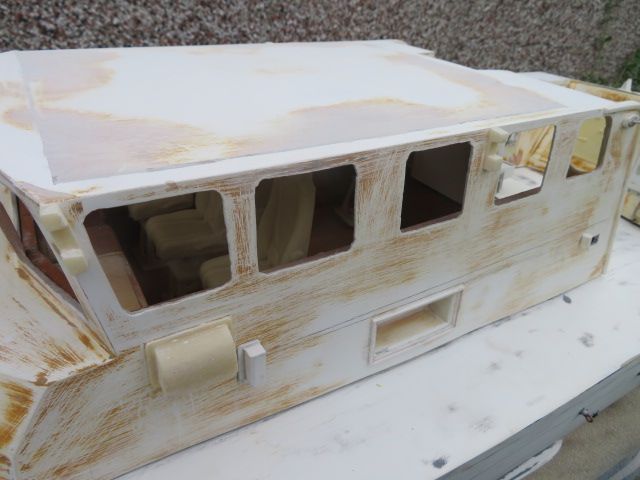

                      the roof panel has glued in place and set well,
                      so tonight I gave the joint between the two a copious filling of p40 filler to both fill the gap in the roof and also to level it all up. tomorrow I will get the sander out and run it over the top to level it all up.

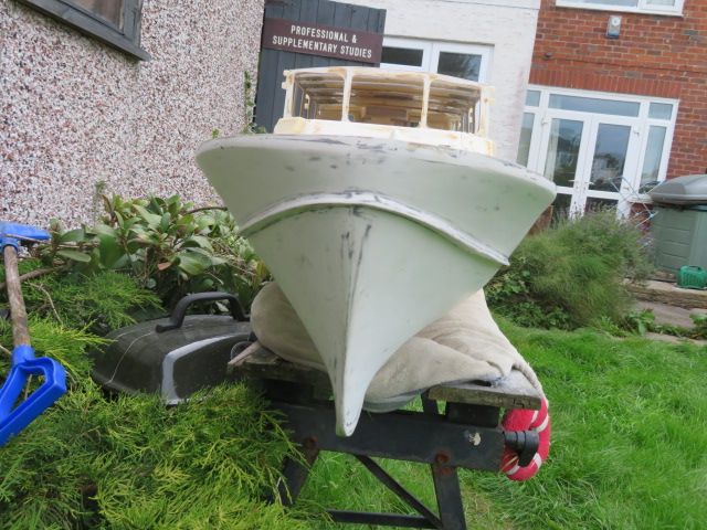

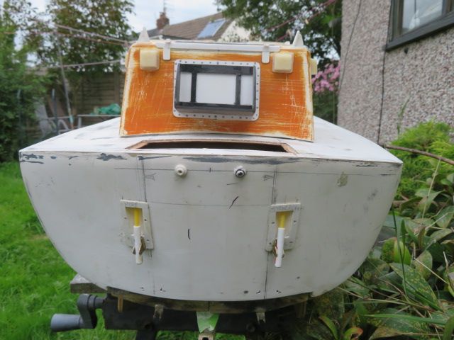

                        #91036
                          after I've sanded it off bob, i'll take some later this afternoon.
                          #91038

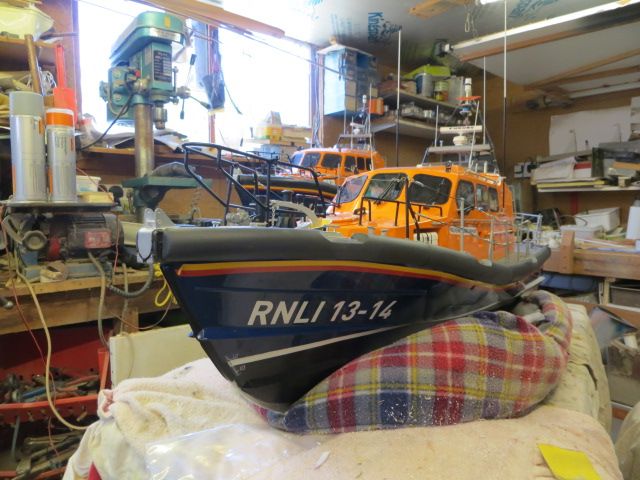

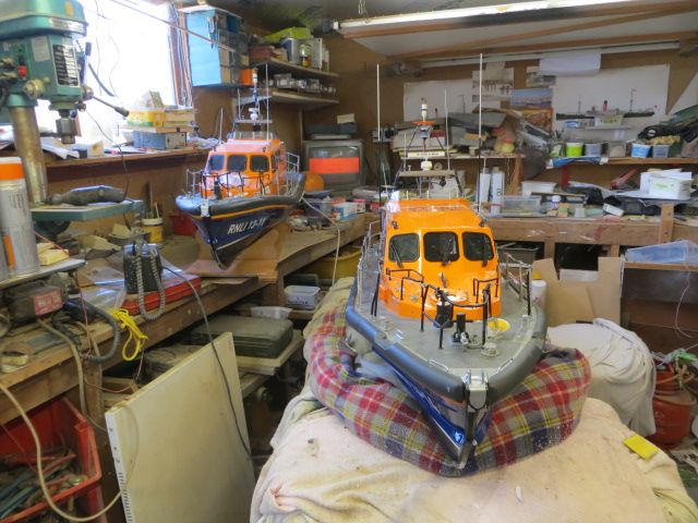

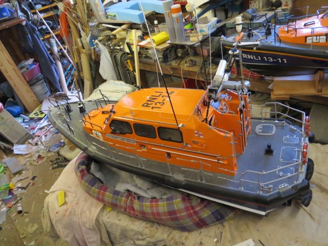

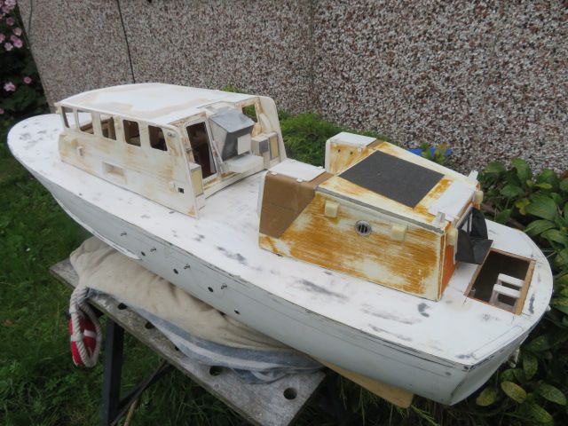

                            Here you go Bob!
                            #91039
                            Fred wooley
                              @fredwooley76212
                              Wow that looks good you going to be very busy sanding that to be painted loads of Aerosols going to be needed to do it so it looks right

                                Many thanks Neil
                                Sorry Neil, we need a one metre rule alongside, to get a feel for the model size?

                                    Posted by Bob Abell on 22/08/2020 17:52:13:
                                    Many thanks Neil
                                    Or…..Your good self?
                                    its an inch short of four feet, Bob……47" long………..quite a big brute.

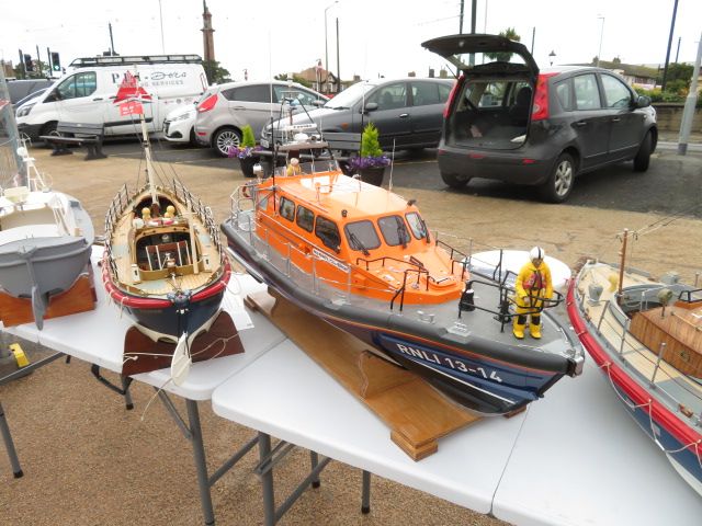

                                              Thank you, Neil, for the Feast of Lifeboats display
                                              You could be called a Lifeboat Junkie?
                                              I was invited to have a trip on the Holyhead Lifeboat, many years ago, but had to decline due to my self survival instinct. Can`t remember the reason for the offer
                                              Your latest model looks quite dated and looks like one step up from the boats with a wooden shed at each end?
                                              Would that be a sensible assessment?
                                              I like the quality of the build, very business like

                                                you should have gone on that trip Bob, there is nothing more exhilarating than standing on the deck of a lifeboat under full song, and you wouldn't get a safer boat to sail on. Nowadays, there are so many HSR reasons and forms to fill that one never gets a chance these days unless its a corporate day aimed at local businesses for donations to the local station.
                                                in their day the TYNE was a very advanced boat, and other than the inflatable ribs was the fastest boat in the fleet at 18 -20 knots. The first called City of London 47-001, paid for by an appeal in London cost £420,000 and went on station at Selsey in 1982, but were light years ahead of the old double ended classic lifeboats of the earlier years.
                                                they TYNES are all retired now and sold out of service having been superseded by such boats as the TRENT, SEVERN, TAMAR and the latest boat, the water jet drive SHANNON class lifeboat as seen in the photos above. these boats just mentioned ate all capable of doing 25 knots or a little more if pushed.
                                                The Shannon costs £2.5 million to build, BUT  the best sounding lifeboat ever is without doubt, the TYNE class lifeboat with her twin V6 two stroke Detroit diesel engines, as used basically in the Sherman tank of WW2.
                                                IF YOU have youtube, just listen to this, the final trip of the last RNLI TYNE LIFEBOAT leaving station last year.those engines are the sound of God waking the world up with a corus of heavenly music.

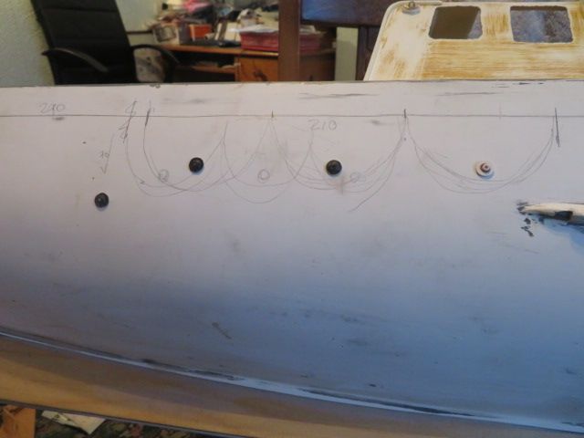

                                                      I started off the day well with the first half of some moulds for small fittings for the Tyne and a few generic ones for the Mersey to cast. by lunchtime I was ready to mould the second half of them.
                                                      I couldn't find the Vaseline for the release agent and so tried "painting" on to the half of rubber already moulded some ordinary vegetable oil used for frying………what an absolute wizard of a trick……….worked even better than Vaseline.
                                                      however this is where the euphoria was burst and the bubble blown….. I ran out of silicone rubber halfway through the pour, and so my last mould was only half finished,
                                                      ok so I thought, I'll order some from my usual supplier on next day delivery………… "sorry, but the shop is closed for holidays" came the answer…….sod me!
                                                      i hope that they are just on holiday and not ceased trading………as that mould contains all my stations for moulding.

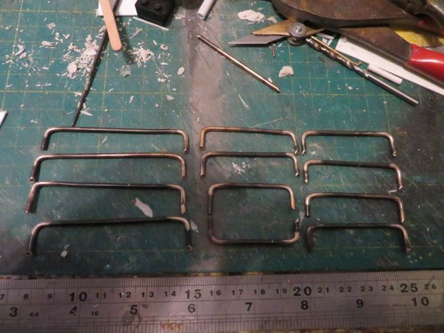

                                                      i had to contend myself with making the toe guard looped rails on the gunwale edges of the deck………..not the best of days, i'm afraid.
