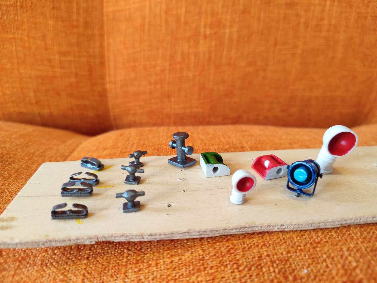

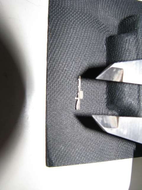

        Some more fittings have been made for my Eezebilt Fire Boat. The  largest is about 15mm high. Just hope I don’t run out of things to make until the weather improves enough to start painting the hull outside. The Nav lights will have micro LEDs in them. The vents are 2 piece kits that I have altered the height.
        Working on some handrails and securing the roofs at the moment.
        Tim

          Good effort Tim
          It’s difficult making such small fittings!

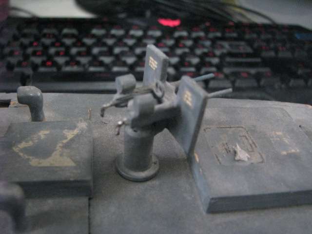

                        I believe that Ernie Webster’s original design called for two Lewis guns, made from paperclip wire and brown paper.
                        I favoured twin Oerlikons. Here is an original on a Terrier from way back in the 1960s, and, for comparison, a similar one at 1/48 scale made for the EeZeBilt PT boat about 10 years ago, together with one which I drew up recently for a 3d printer…

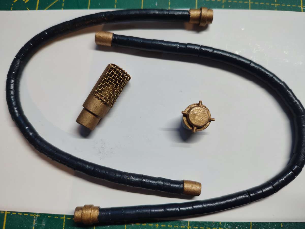

                          I have spent a couple of weeks, on and off, trying to make pipes that I assume supplied water to the pump for the water cannon. They seem to have been stored on the stern deck
                          I used a central core of copper wire, then built up layers of small pieces of ABS tube. After a few failures I managed to get two I’m happy with although not as good as I had hoped
                          Tim

                            I think you will find that they are hoses used to pump out water from leaking seaplanes. These boats were intended to support seaplanes, and ones which landed with holes in their hull would have no easy way of baling out.
                            You have done a really good job at 1/48 scale!

                              The look really good Tim and just what is missing from the rear well deck of my model.  I’ve been meaning to do something similar to mine for around ten years now.

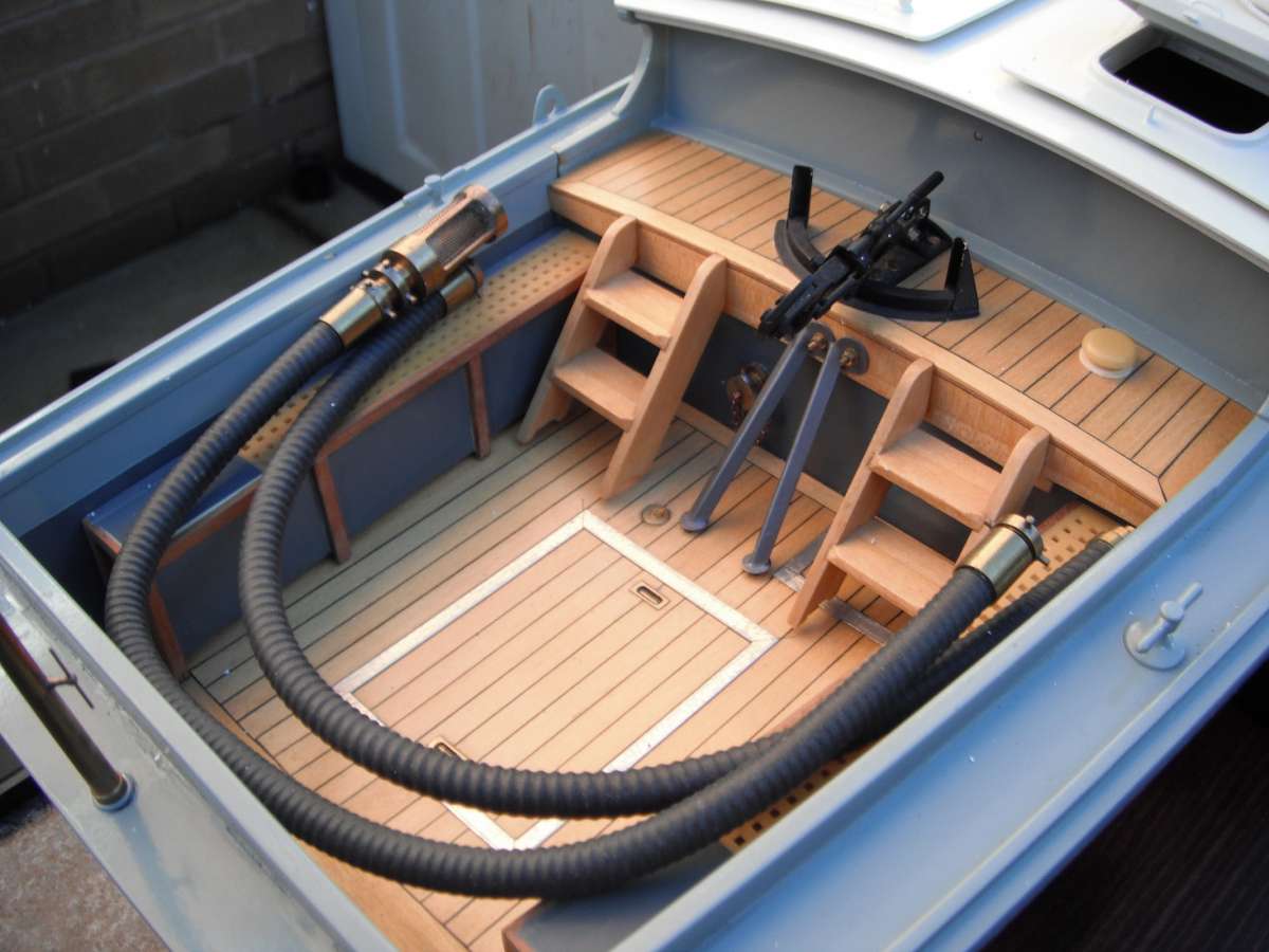

                                  An old friend of mine who had a passion for the crash tender boats, now no longer with us – showed me this trick a while ago about producing wire bound fire hoses.   It is to use net curtain wire – spring covered with a heat shrink and they are about 5 – 6 mm diameter.   You can generally pick them up in various lengths fairly cheap.   If you have a look at them closely – you will see you can see the spring beneath the heat shrink and it gives the affect of an armoured hose.
                                  The other method which can be used to assimilate these hoses is a tube bending spring and you can get these on line in various diameters and they can be found at about 5 mm diameter and about 300 mm long.   You can cover these with either white or black heat shrink and this gives the same affect.
                                  Bit late now, but, may be useful for you or anyone in the future.  Managed to locate an image of HS93 the late         Mr Peter Henshaw’s excellent model of the Fireboat.   These hoses were constructed using the wire spring method, as mentioned above.

                                    Now I remember Peter, he came to visit me when I lived in Halifax with his wife, what a lovely couple they were as well.  I can’t remember for the life of me what he was visiting for, it was model boat related, but I do remember him and his wife.  That must have been somewhere in the region of 15 to 20 years ago.
                                    That is probably one of the best representations of the fire tender well deck area I have seen.  I really must get around to making some hoses and steps etc for it one day.  I notice Peter has also added the fire hose connection in the bulkhead to connect the hoses to.
                                    Just a thought for Tim, hoses that supply water, such as fire hoses, are usually floppy so they can be stored easily and the water pressure will inflate the hose.  Suction hoses have to be reinforced to prevent the suction collapsing the hose.  So you can immediately tell that these are suction hoses.

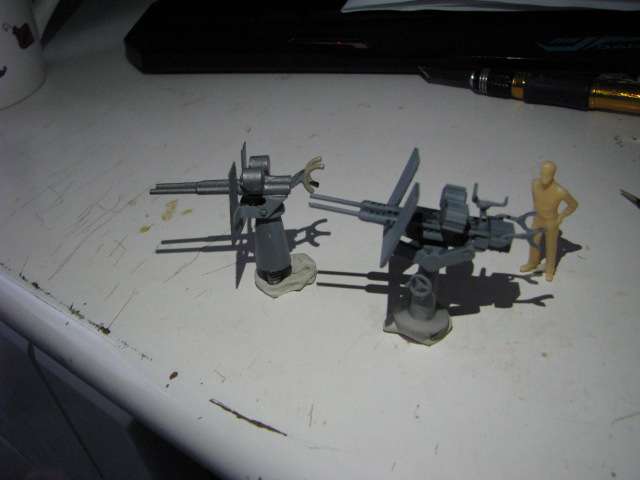

                                      Is that the 4″ Aerokits model at 1/12th scale? A lot easier to make fittings for than Tim’s at 1/48!
                                      For small sizes you could merge the two techniques. Pick a suitable diameter copper wire for the central core – then wrap a much thinner wire in a spiral around it, and cover with heat-shrink.
                                      I was wondering about the Terrier guns earlier, and drew up a Lewis gun at 1/72. It’s VERY small – about 1.5cm long. I suspect that. at very small scales, a model looks better if some of the detail is a bit oversized. The Warhammer figures accentuate detail in this way…

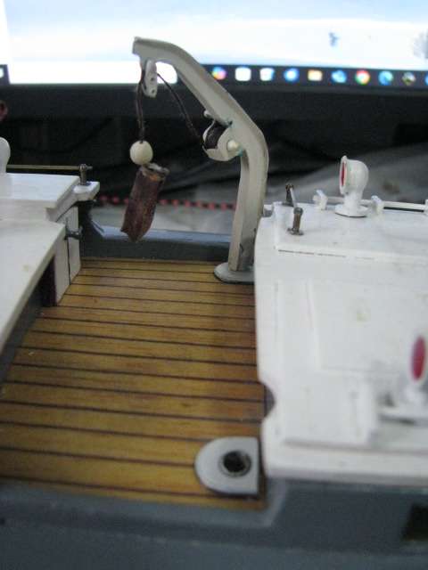

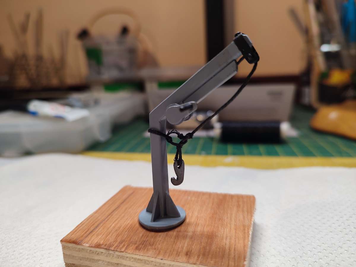

                                          I have finished (I think) the small crane. It’s my version so probably looks nothing like the real one.
                                          Also, I have had a try at a scrambling net using waxed thread. Think I will have another attempt .

                                            Bear in mind Tim, when its rolled up it will look completely different to when it is laid out flat and you maybe don’t need to be quite as critical as you might think.

                                              This is the crane on my prototype – made from (not very well!) soldered brass strip. It has a tube at the base which slots into either the port or starboard holes, and so can be swung inboard and outboard. The brown strip of canvas at the end is a body sling.
                                              I can probably draw up a 3-d print file for one if you would like it…

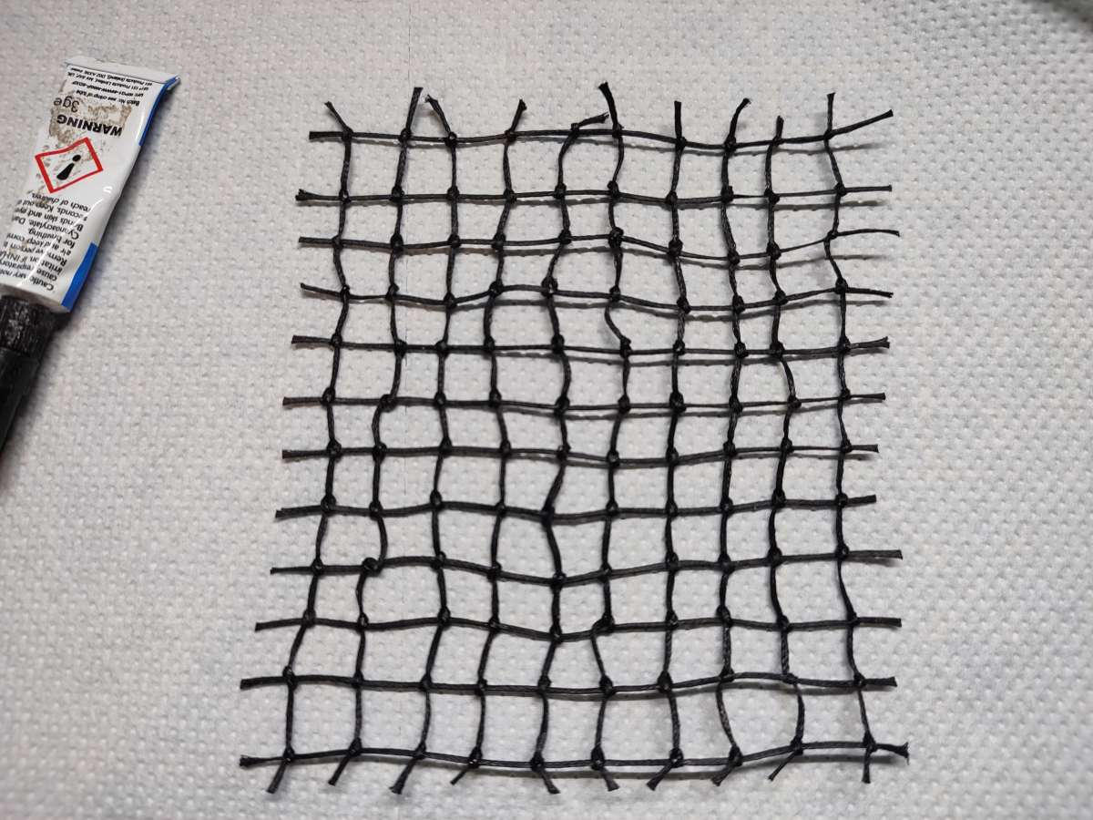

                                                    My neighbour wanted some netting for one of his model boats and said that used in older fishing keep nets was a good match. My BIL who’s a fisherman and frequent visitor to car-boot sales got him one which was just the  job.

                                                      That netting looks quite realistic to me. Here is a photo of 93, showing the rolled-up netting over the engine compartment. And, incidentally, the davit and winch which I copied for the prototype…
