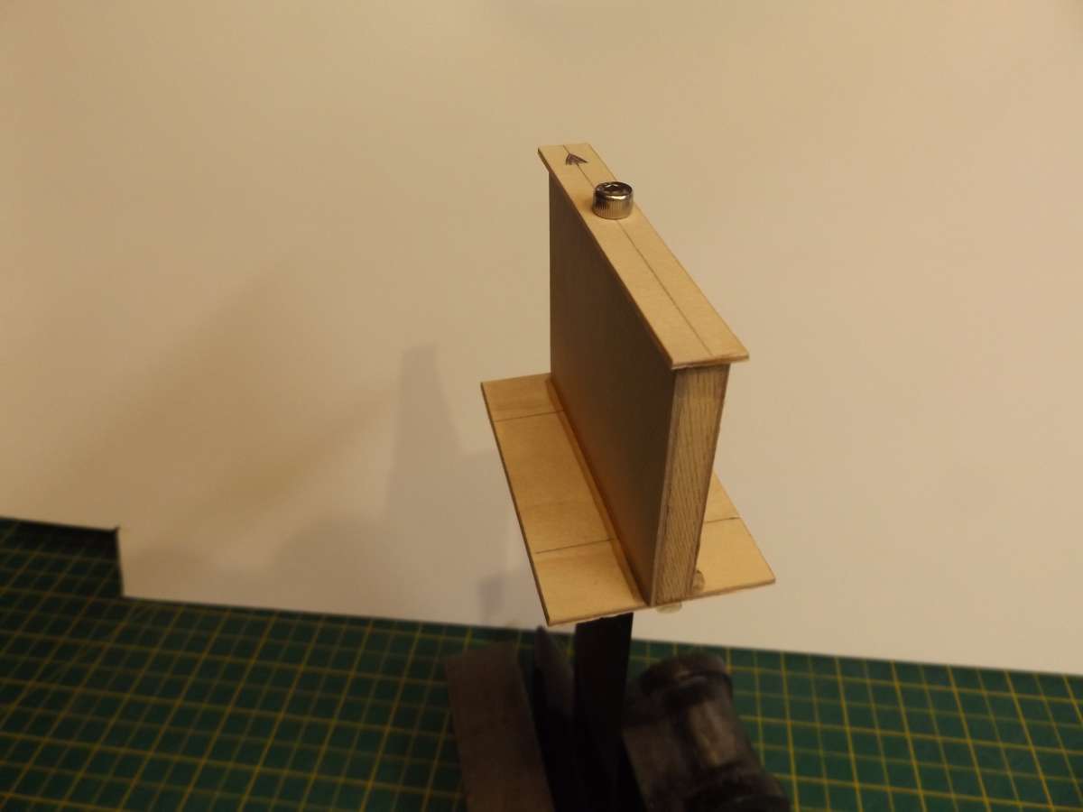

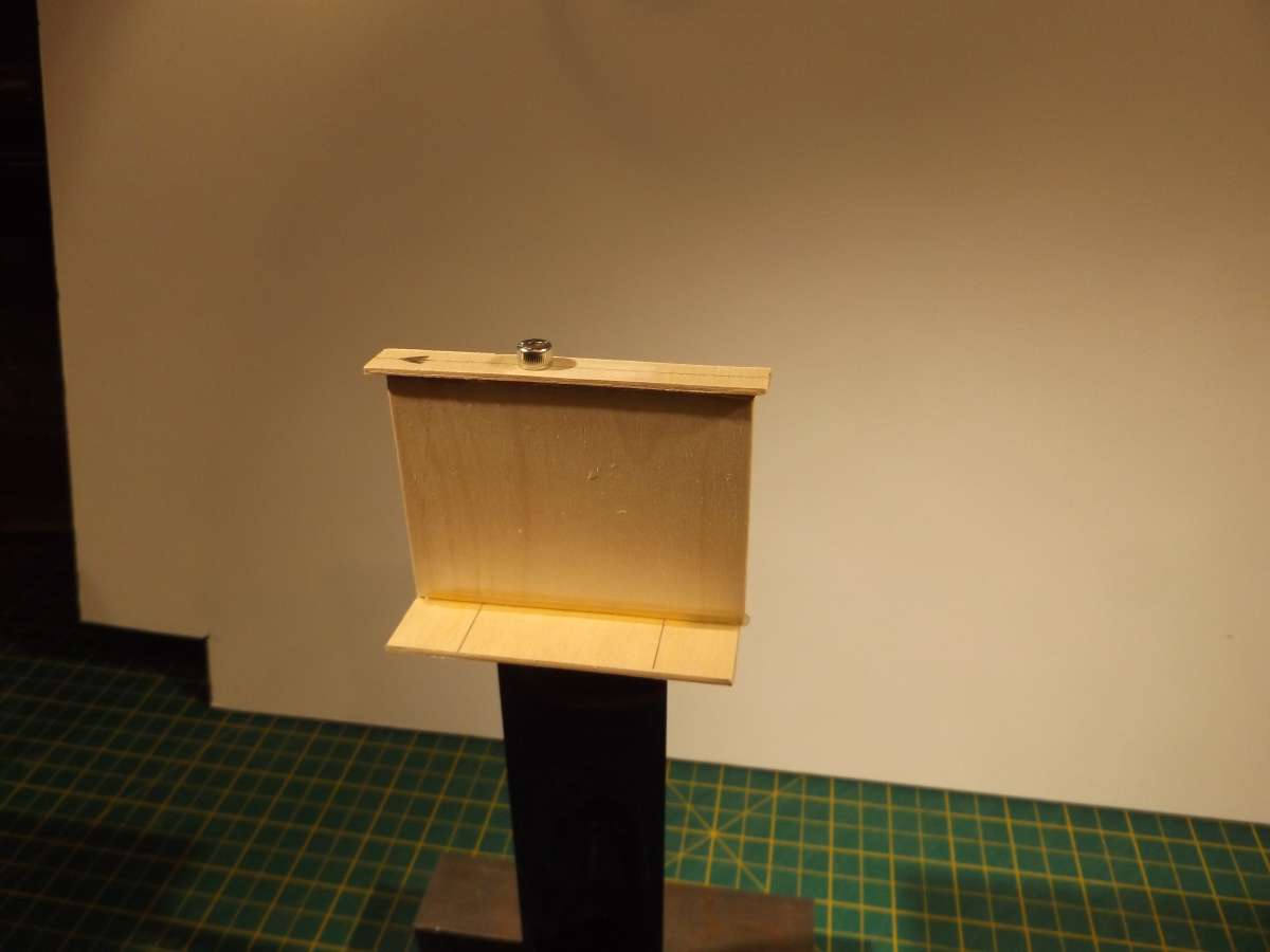

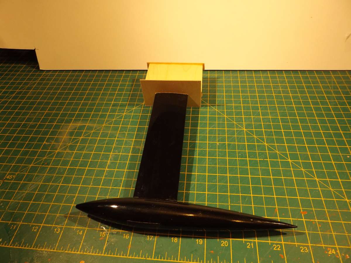

              Tim and I have been in touch about using stock DF keels for future yacht designs as many folk won’t want to mess around with patterns, moulds and molten lead pouring, fun as it is 🙂
              This is a keel box from ply for a 30″ Thames barge but this idea could be built into your keel quite easily , this will be braced with a couple of bulkheads, and you can whip the keel out if needed, both Wild Duck and Eventide are removable, but I have never taken them off the boat once complete 🙂
              Food for thought ??
              Regards RayKeel 1Keel 3Keel 2

                  Thanks for that Ray, interesting. I’d been giving the keel box some thought earlier as regards forming it. First idea was to try and use the DF mounting pieces after modifying them but maybe not at all now. Mine’s a bit more complicated because it’s got a quite narrow keel on the hull which the drop keel needs to come through. But a plan is starting to form which will probably involve some trial and error.

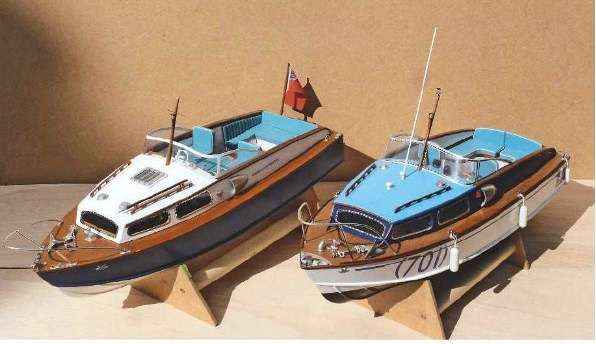

                    Won’t be doing anymore for a day or so as I’m collecting another model to add to the Fairey fleet! Some of you can probably guess what it is!
                    #122930
                      Give my regards to Liz!

                        Any chance of a photo of the Fisherman , I know you posted a drawing about a hundred years ago  🙂
                        #122940
                          Will do Colin.
                          The prototypes will be reunited!
                          I’ll post some when I get back Ray. I think there are some in the pre-build thread though. I would have liked to post the photo showing the two sail layouts but they are in a current book and subject to copyright.

                                  That’s a very smart looking pair
                                  #122945
                                    Certainly are!
                                    #122955
                                      Yabadabadoo!

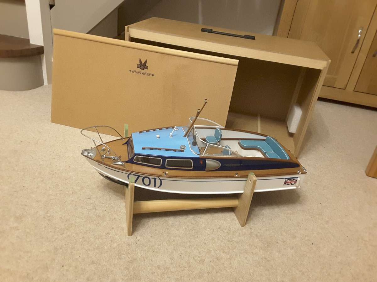

                                      The attention to detail that Dave went to with this model is superb and just reinforces what we knew about his model building prowess. The carry box is very nicely built as well and weighs more than the model!

                                      #122957
                                        Chris.
                                        I didn’t think you would be disappointed. I have seen the model in action.Dave put extra effort into detailing it. Glad it has gone to a good home.
                                        When you get it going again post some pics.
                                        #122958
                                          Thanks Colin, I passed your regards on.
                                          Yes, the other one is good but this one’s even better, the seats even hinge!

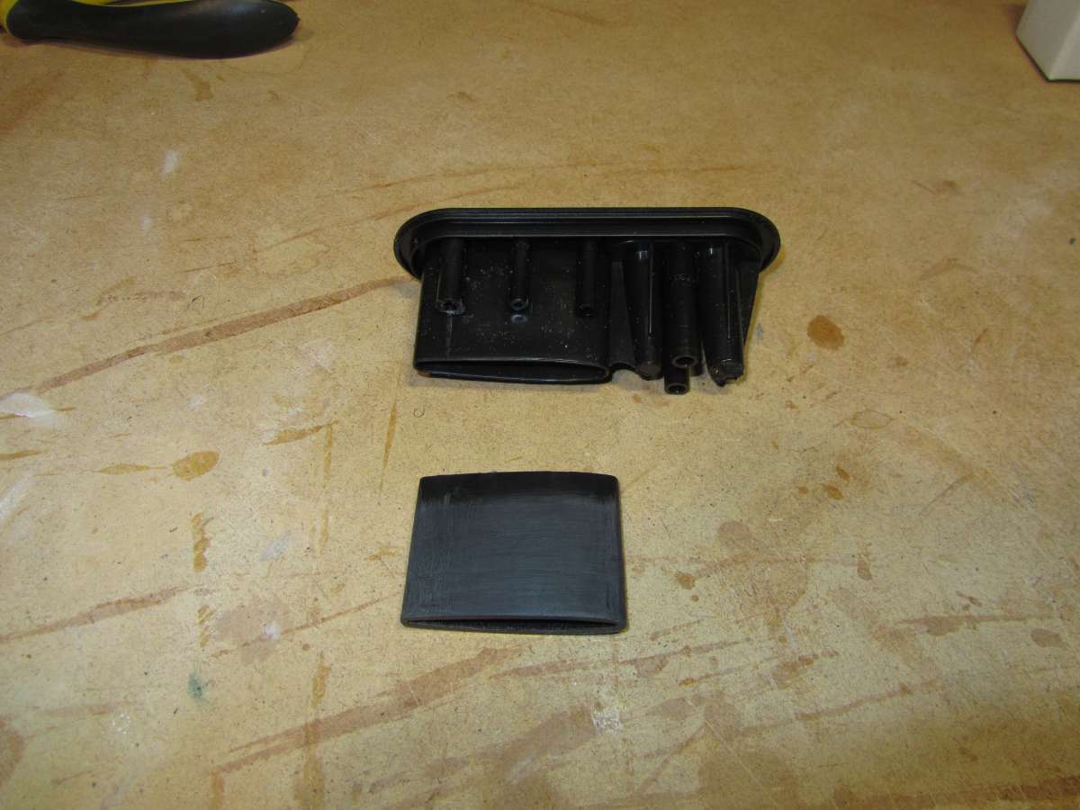

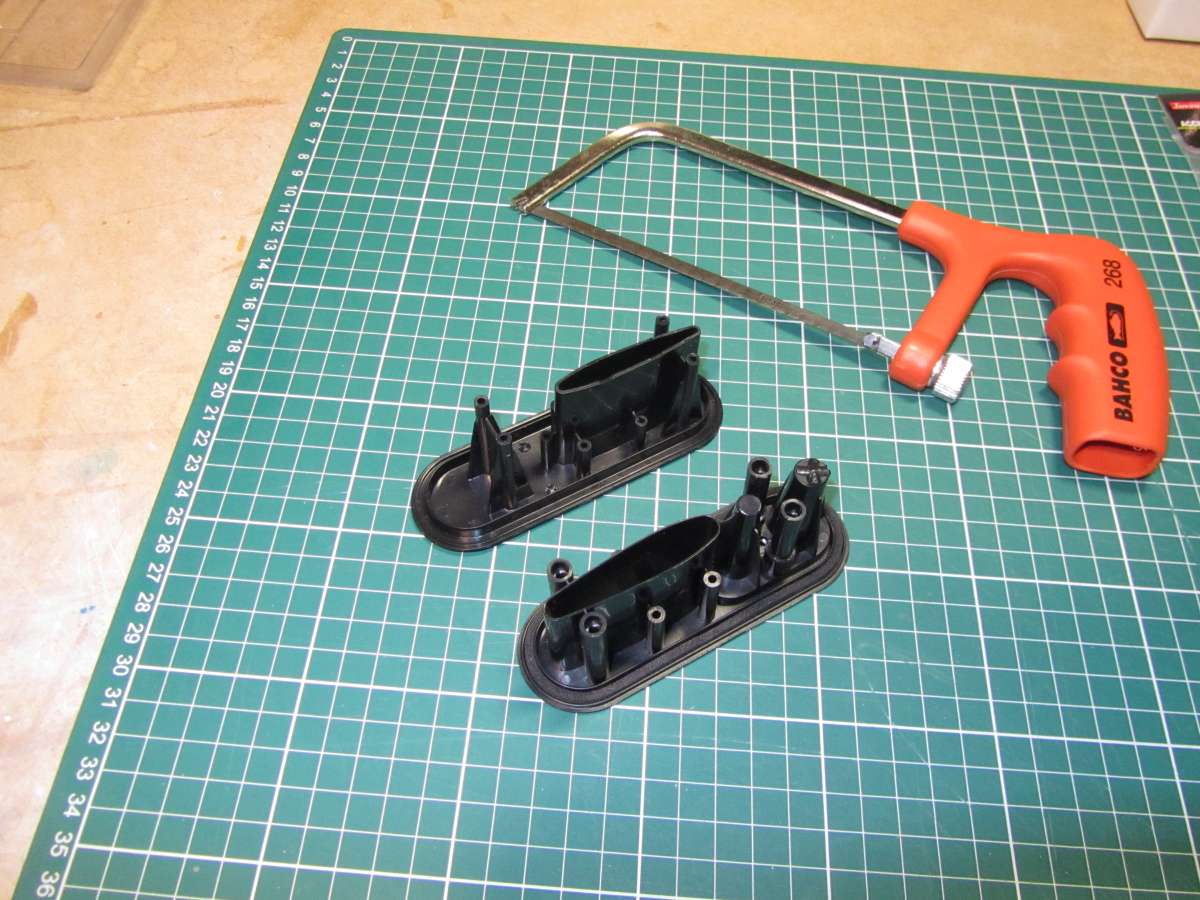

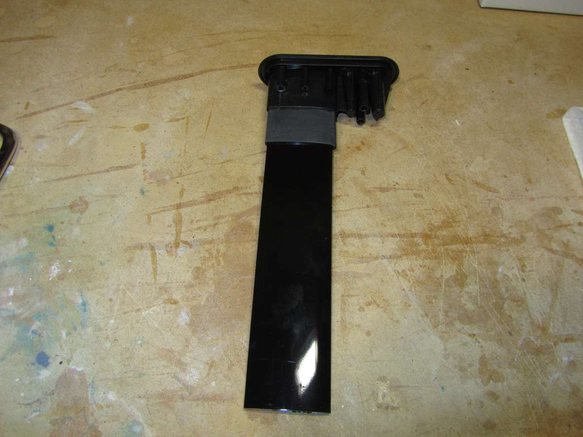

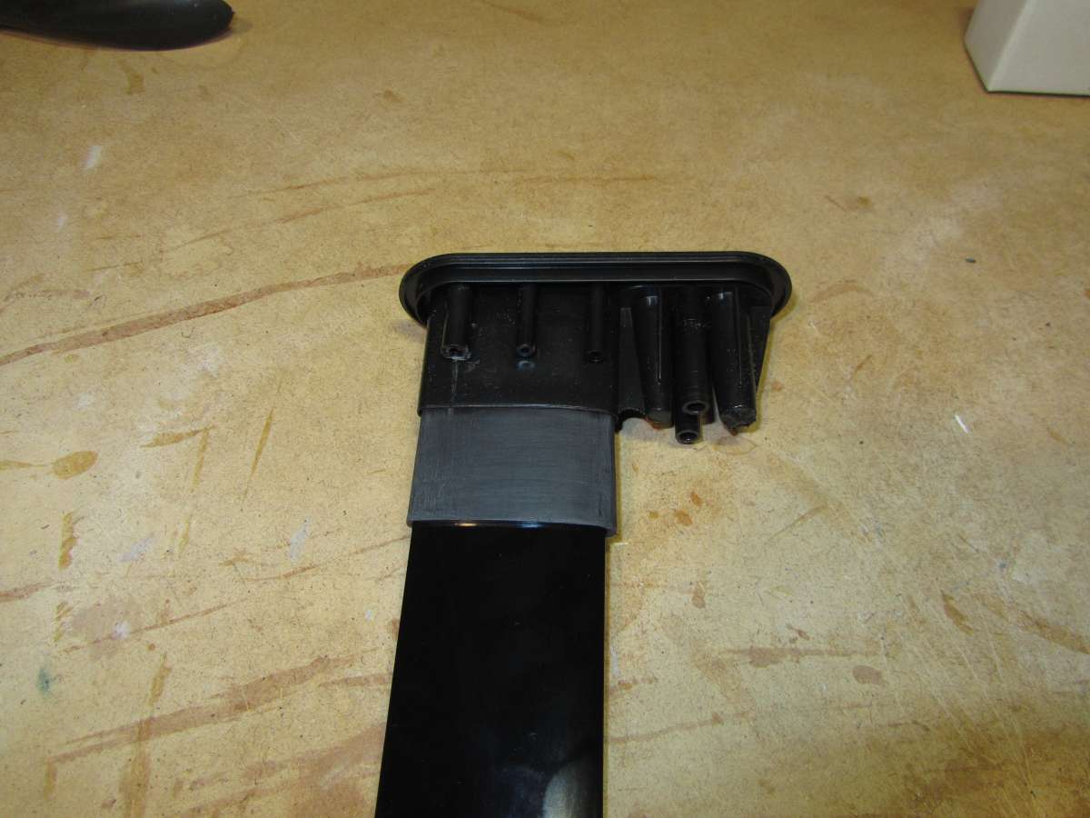

                                            Still not being able to spend much time on the boats but this evening I decided to have a look at the keel box. Having decided that as I’ve bought them I’d see what I can do with the DF parts.
                                            So drastic action was taken with the hacksaw, Stanley knife and file! Plan is to glue the upper and lower dagger box parts together to make a watertight whole. The bottom will be epoxied in place flush with the bottom of the hull keel and a fabrication made to which the DF top mounting part can be fixed to. I shall leave it in place but I won’t be using the recess for the mast as in the Fisherman the mast is further forward.
                                            I shall now see how this fits in the design of the model. If Ok I can then modify the drawings ready for printing and cutting wood before too long!
                                            Keel 1Keel 2Keel 3Keel 4
                                            #123121
                                              Hi Chris,
                                              This looks like clever stuff ! watching with interest 🙂
                                              #123122
                                                Very neat, looks like it was made for the job!
                                                #123134
                                                  Thanks chaps. Hoping I can get a watertight join between the two pieces of plastic otherwise I will have to build an outer box similar to Ray’s example as a second line of defence.

                                                    Is it possible or worth fitting some sort of internal reinforcement to bridge the joint on the inside? Maybe a profiled strip of balsa to fill the hollow interior and effectively make it solid. I can’t see from the photo if the other end is hollow.
                                                    #123137
                                                      Hi Colin
                                                      Sorry if I’m misunderstanding, but the plastic parts effectively form a tube from the underside of the hull keel to the top of the daggerboard where you bolt down into the top of the keel, so you can’t have anything inside the tube as the keel is in there. The top of the keel is therefore restrained as is the part passing through the hull keel and so the plastic tube is mainly to stop water ingress and to line the inside of where the drop keel passes through the hull keel.
                                                      However I’ve been doing some drawing and have started off with a keel box to support the top of the daggerboard but I’m now thinking to just position the joint in the tube inside the hull keel, wrap the drop keel in clingfilm and epoxy it in like we do with the prop shafts etc. as the idea initially was to avoid having a keel box and it’s an area where water could get trapped if you are not careful. The dagger box that Ray and Tim use in their builds is simple and effective for the design of boats but I have the added complication of a significant protruding keel (ballast keel on the full-size) which I’m using mahogany for and I don’t want any joints in it below the hull, so the drop keel needs to pass through it.
                                                      The design is obviously evolving and it’s too easy sometimes to over-complicate things! But I will get there!
