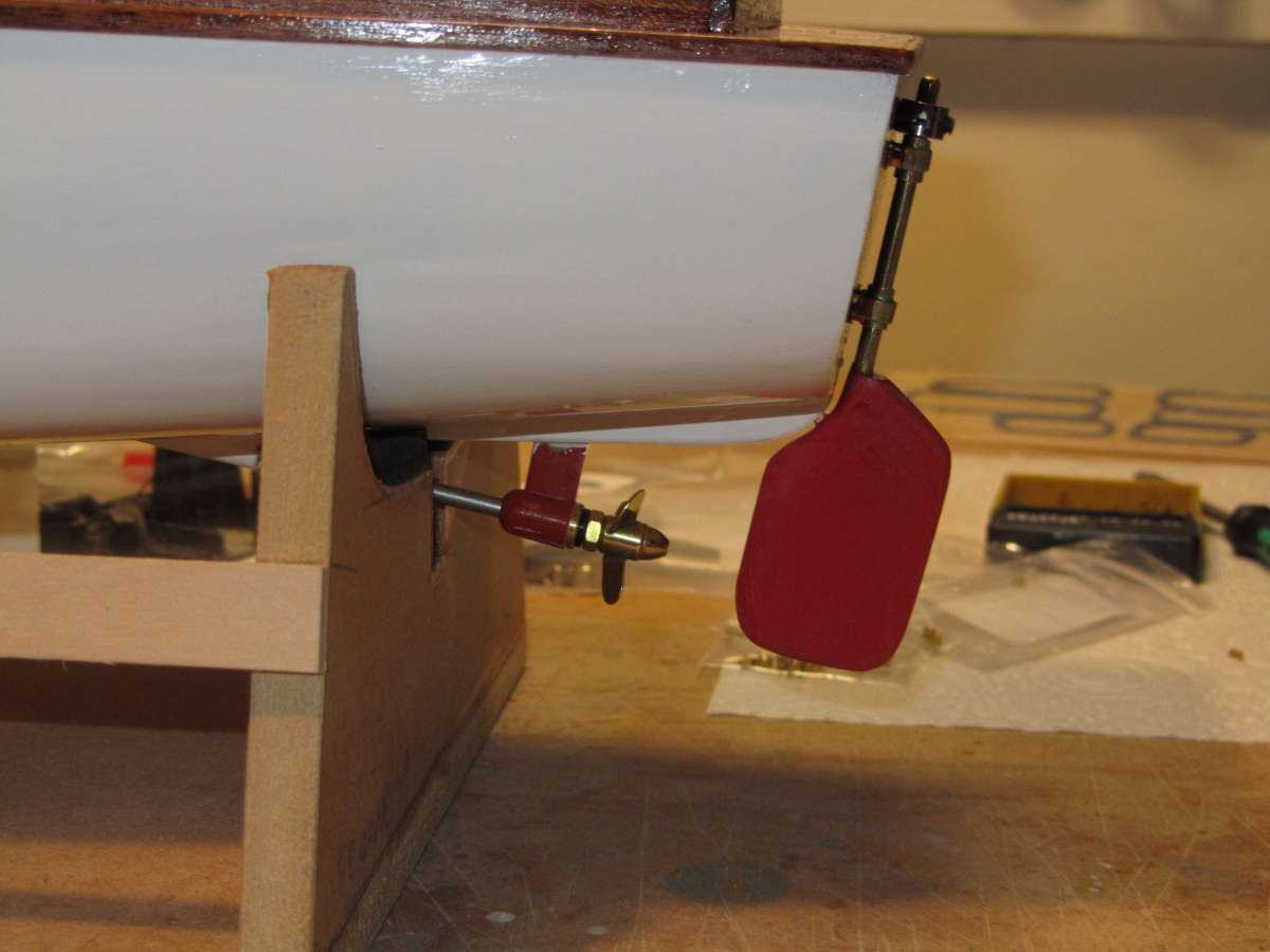

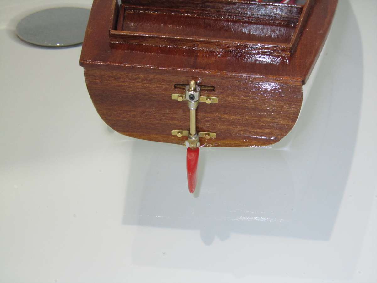

          Being having problems logging into my build blogs again so haven’t been updating. Not that I’ve done that much, especially as we’ve had such a good spell of nice weather.
          The strut for the prop shaft has been glued in place and the rudder is progressing, just waiting for some more materials and parts to finish that off.

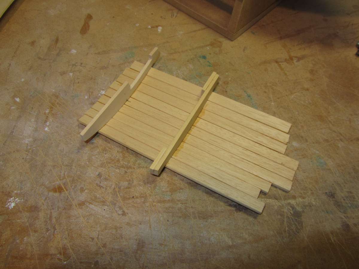

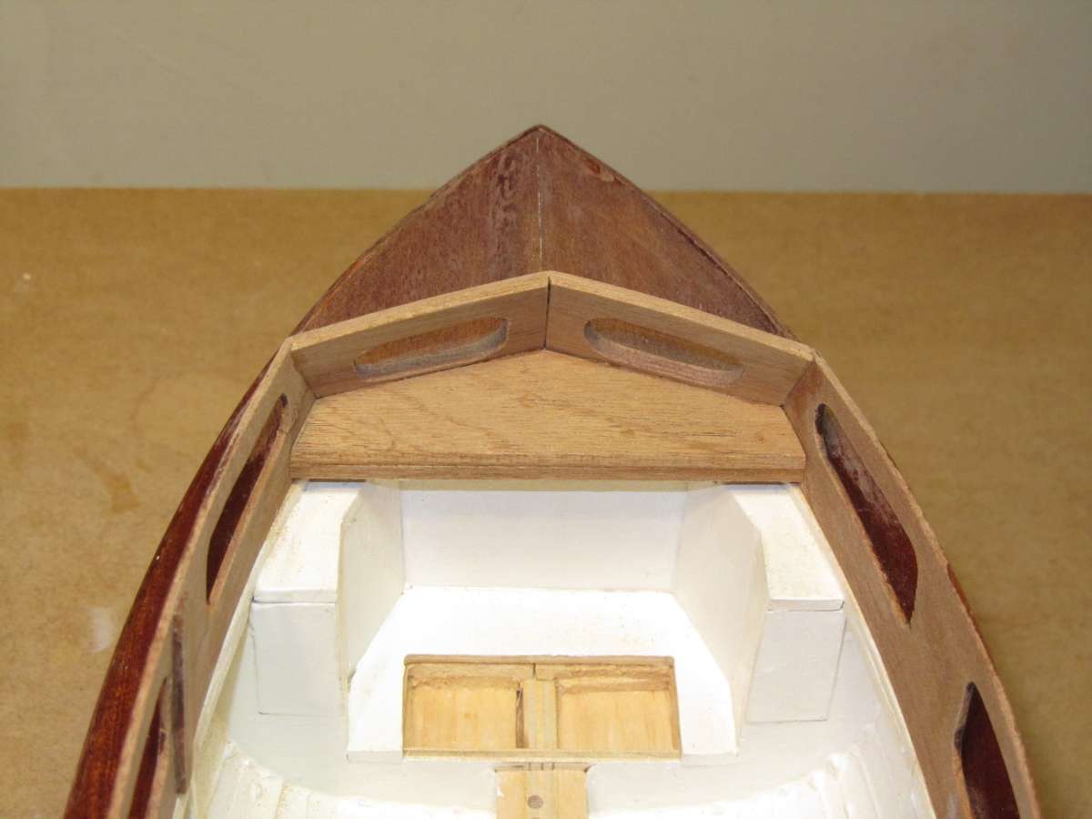

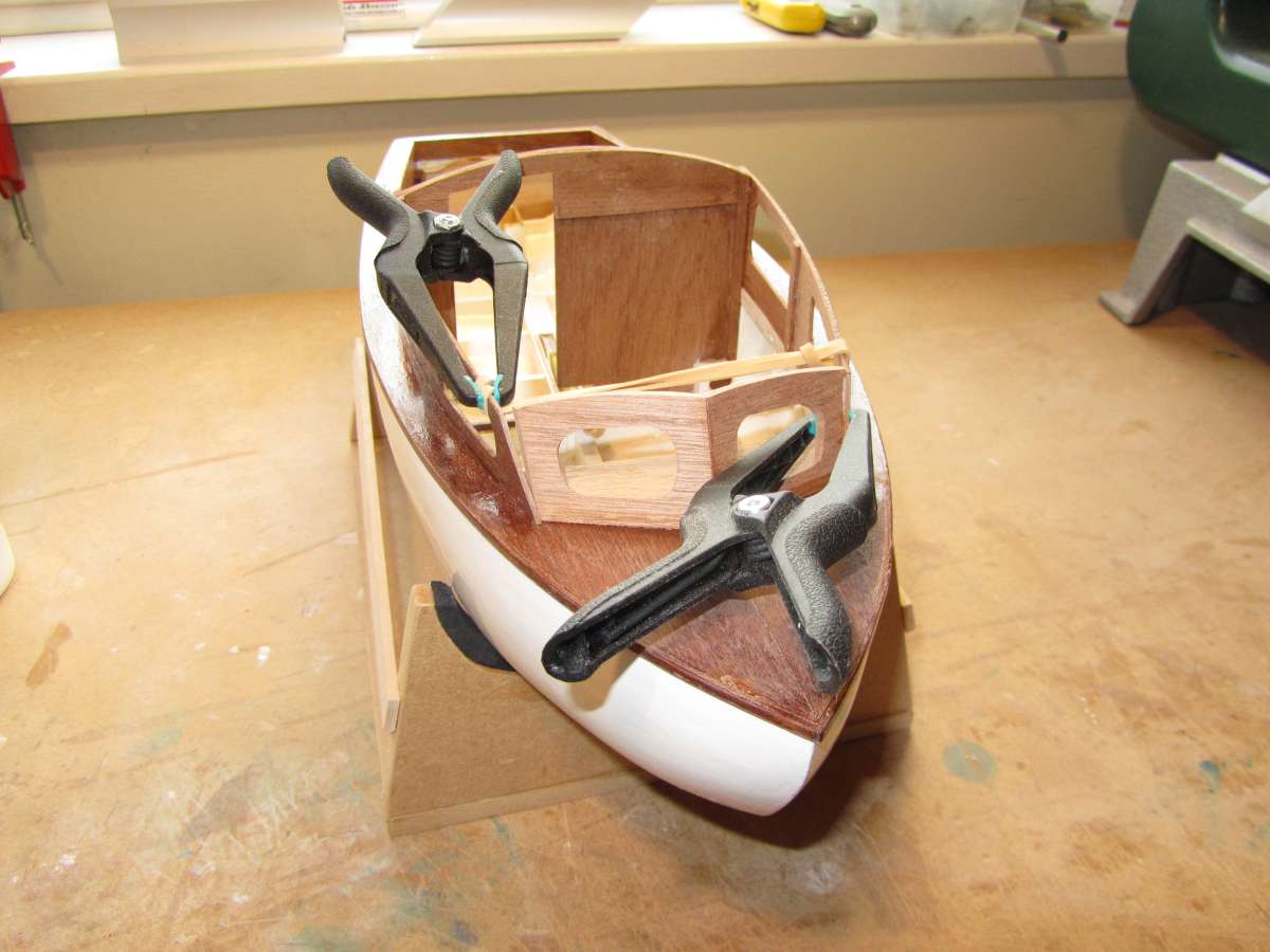

                    Back on the Faun and have glued the cockpit/cabin sides in place after removing some of the cockpit sides so that the hull will be visible as per the full-sized boat. First time I’ve built a fixed superstructure model. Access to the motor etc. will be via a removable cabin roof.
                    Superstructure 2

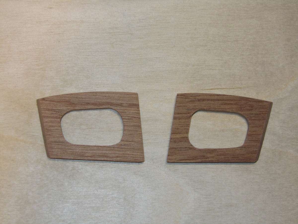

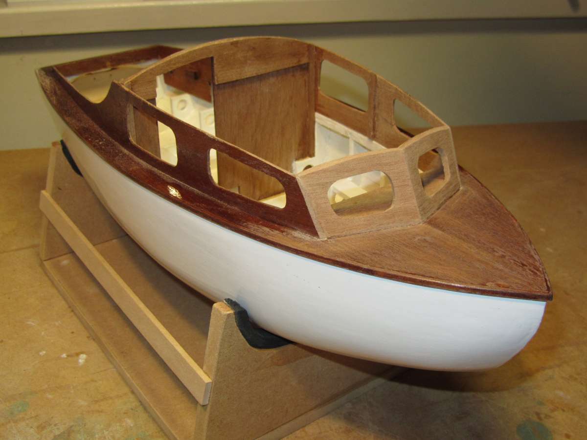

                          Didn’t realise how long it’s been since I last posted about the Faun!
                          Not a lot done because as I’ve said before I don’t do much building in the summer and have been busy doing other things.
                          But I did finish painting the hull and over the last few days I’ve made and fitted the front windows to the cabin. Not something I was looking forward to as even holding timber in place to mark up was hard and making a former from a block of balsa didn’t really go anywhere. The windows are quite complicated because as well as the vee they lean backwards, the cabin sides are angled as they move backwards and there is a curve to the top. Added to which they are mahogany and will be stained so I didn’t want to use any filler if I could help it.
                          So I decided that it would be a good idea to make a plinth first which I could work against and provide additional gluing area. This was particularly important as the starboard side of the cabin had been glued in position leaning out and took quite a bit of force to hold upright.
                          This worked well and I was able to work out the angles using pieces of balsa and cardboard. I’d assumed that the vee joint between the windows would be at right-angles to the deck but the cardboard proved otherwise! I realised afterwards the angle required is probably equal to the backwards inclination of the windows?
                          The windows were then cut-out a little way from the lines and I carefully sanded the chamfers on the bottom and sides until the windows fitted and then marked and cut-out the curve to the top, again to a chamfer. The top of the curve was flattened as the vee results in a point otherwise.
                          I’ve learnt from bitter experience not to cut out the window opening(s) until the blank(s) fit properly! So this was then done using a coping saw as the pieces were too small to do using the scroll saw.
                          Each window was then glued in place using aliphatic and left overnight and found to be nice and solid. The port cabin side was then glued in place and secured with a clamp and elastic band. The errant starboard side was then held in the same way and the inside moistened with spit and left overnight. Next morning found it nicely conforming to the required shape and it was easily glued to the window.
                          Bit of sanding where the cabin sides stood a little proud and happy with the outcome. I fully expected to have least a second go!

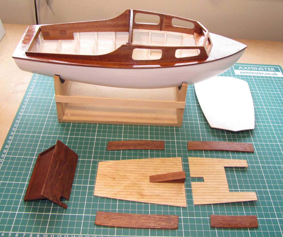

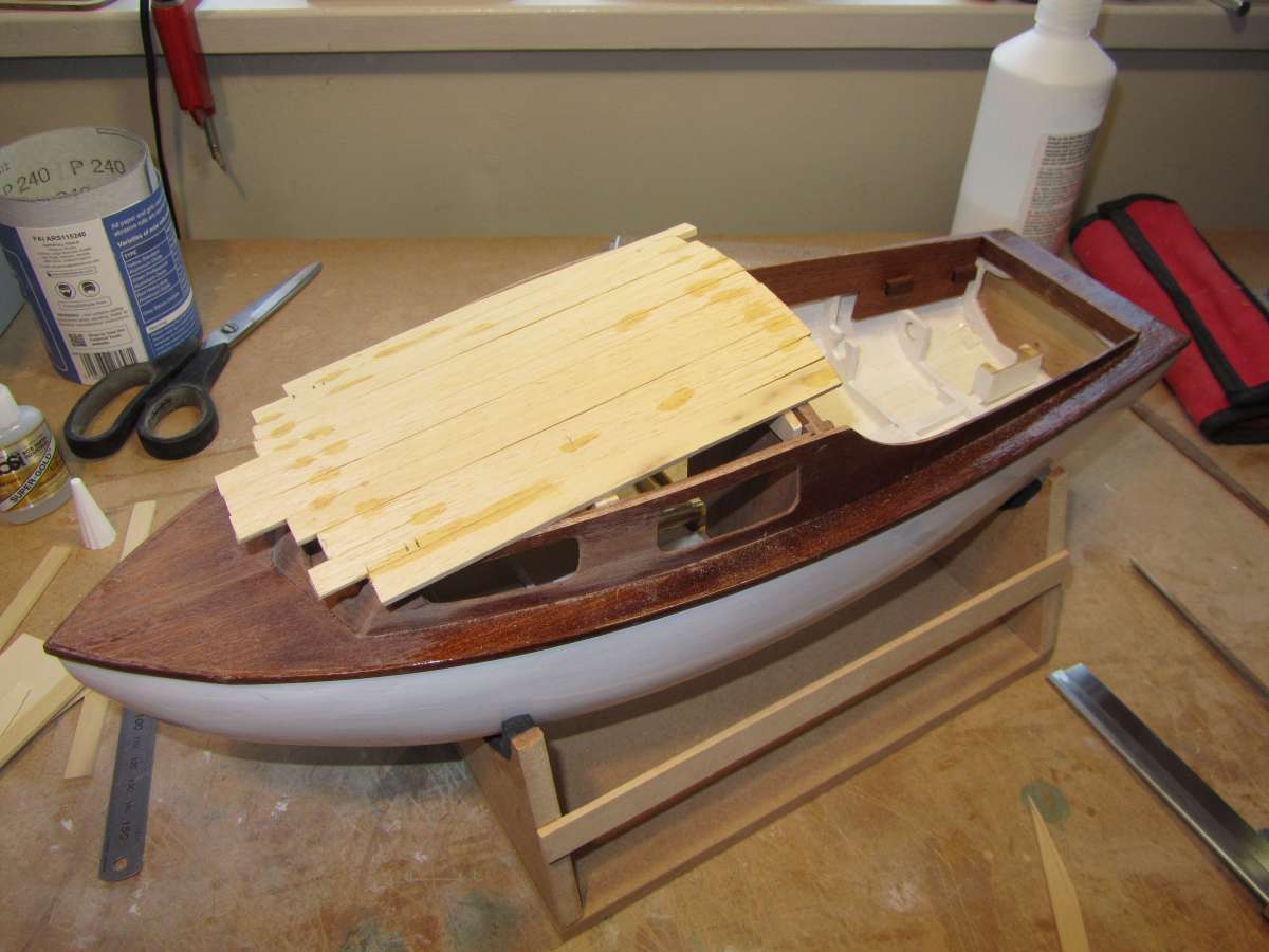

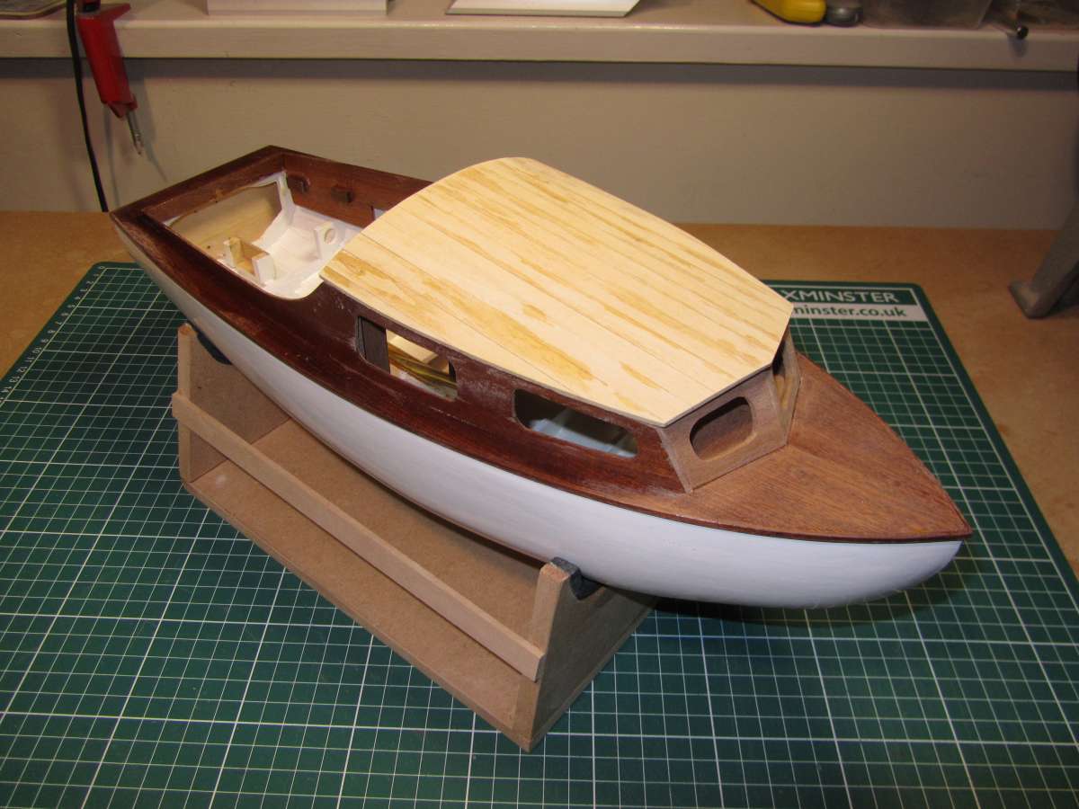

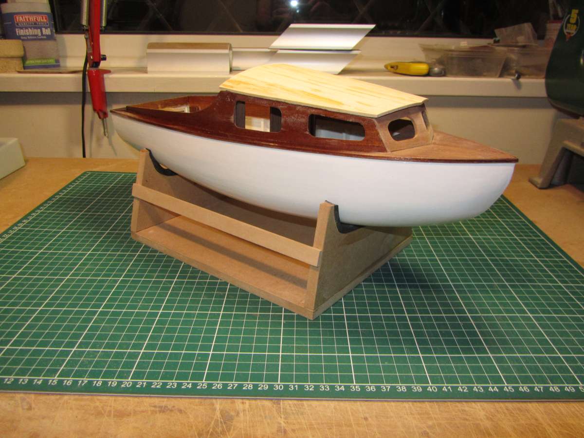

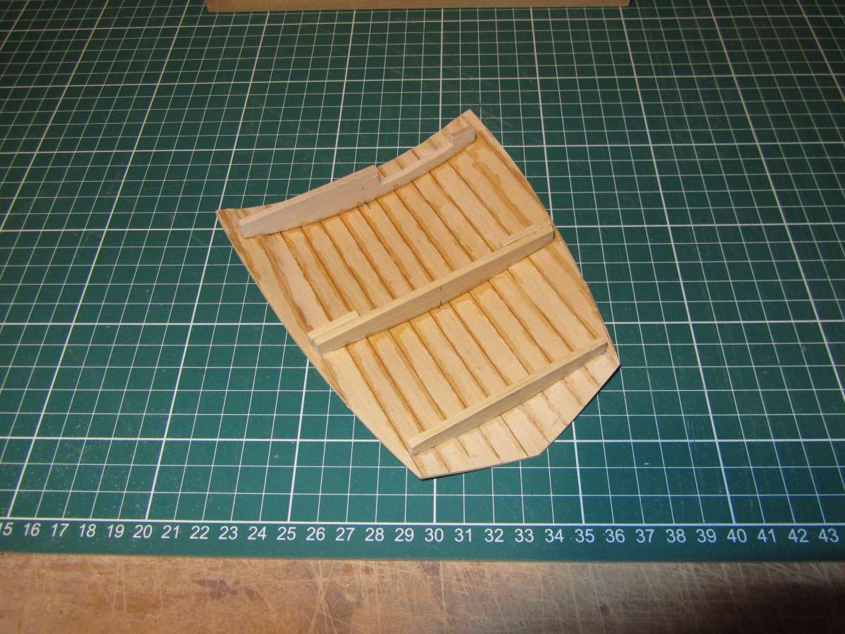

                              Been a good week really as been able to spend a few hours on Faun and as well as the windows I’ve managed to construct the roof as well. My first lift off roof and it was a bit tricky but got there. Bit of surface filling required and then Eze-Kote, lightweight cloth and paint.
                              Not too much left to finish off the build then. This was the last build to be started and will be the first to be finished!

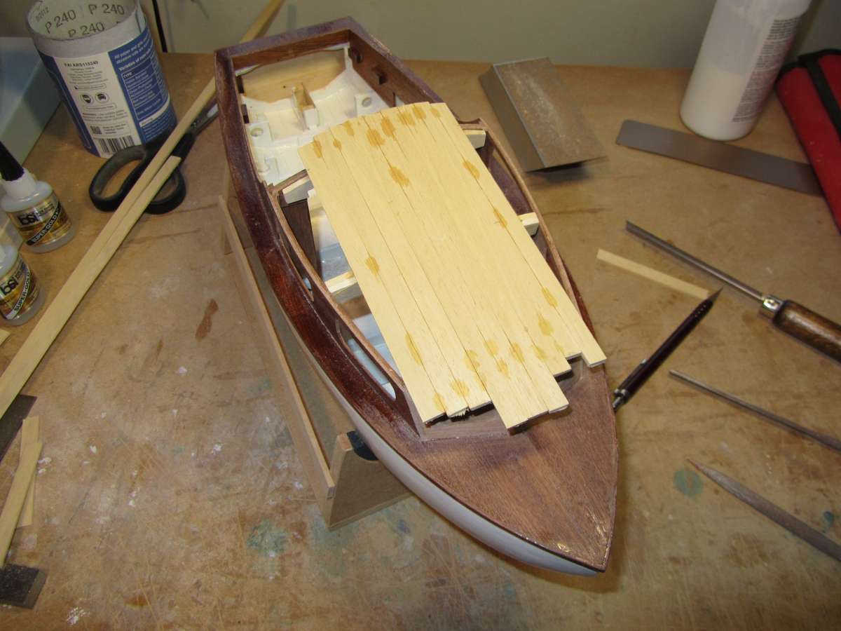

                              Oh, and the roof was my first real use of the odourless cyano that Colin recommended. Thanks Colin, it worked a treat. So good to have a full range of glues at my disposal again.
                              Roof 1
                              Roof 2
                              Roof 4
                              Roof 9
                              Roof 7
                              Roof 8

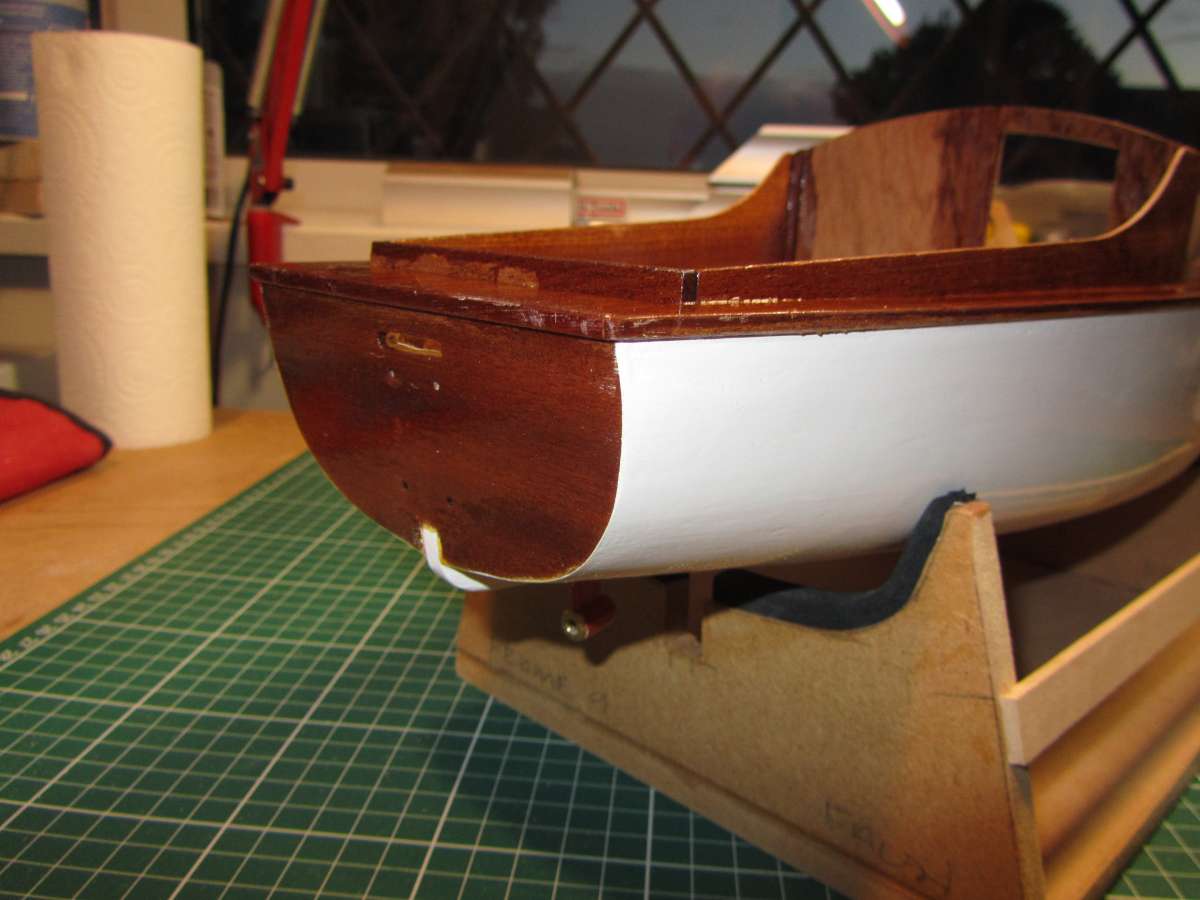

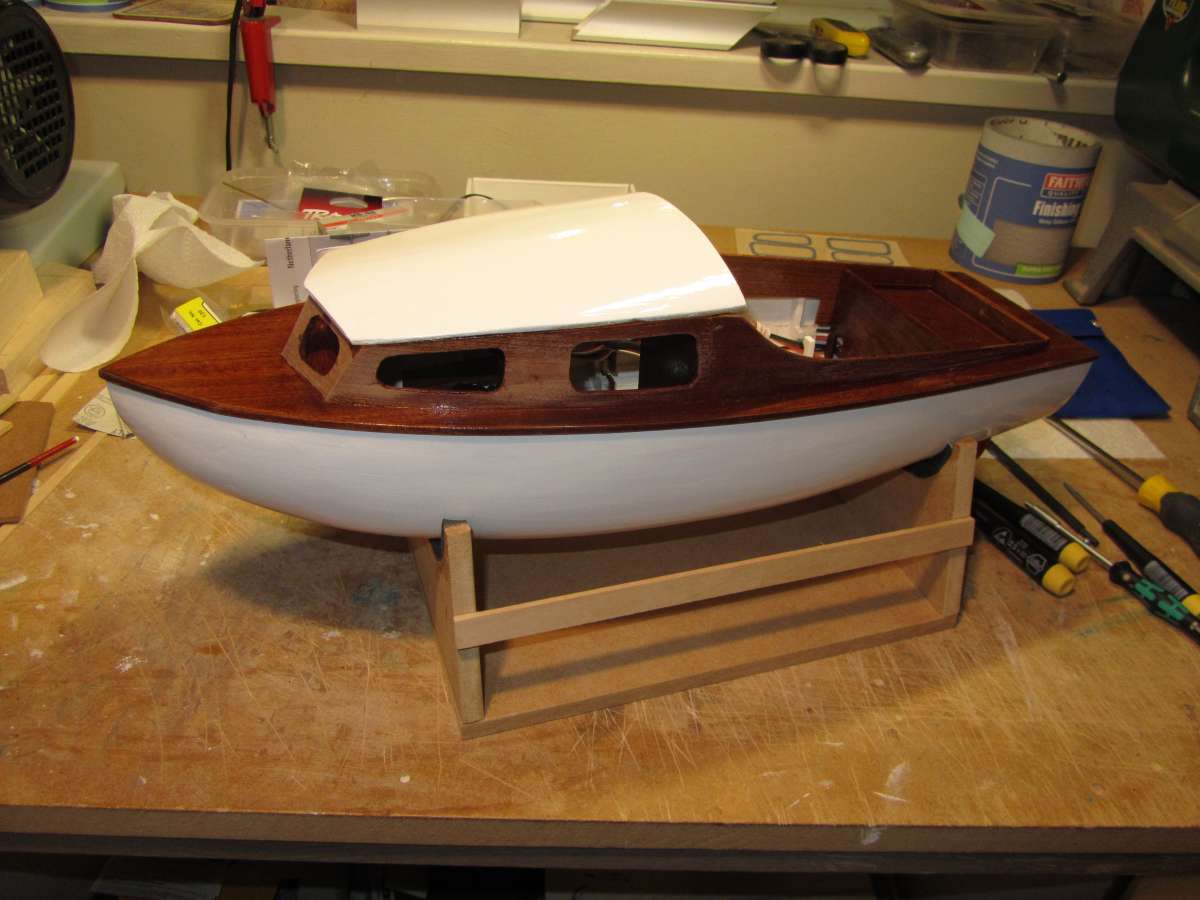

                                        Roof has had its first coat of primer/undercoat and one of my most enjoyable jobs, applying varnish, especially to the mahogany.
                                        Painting 4

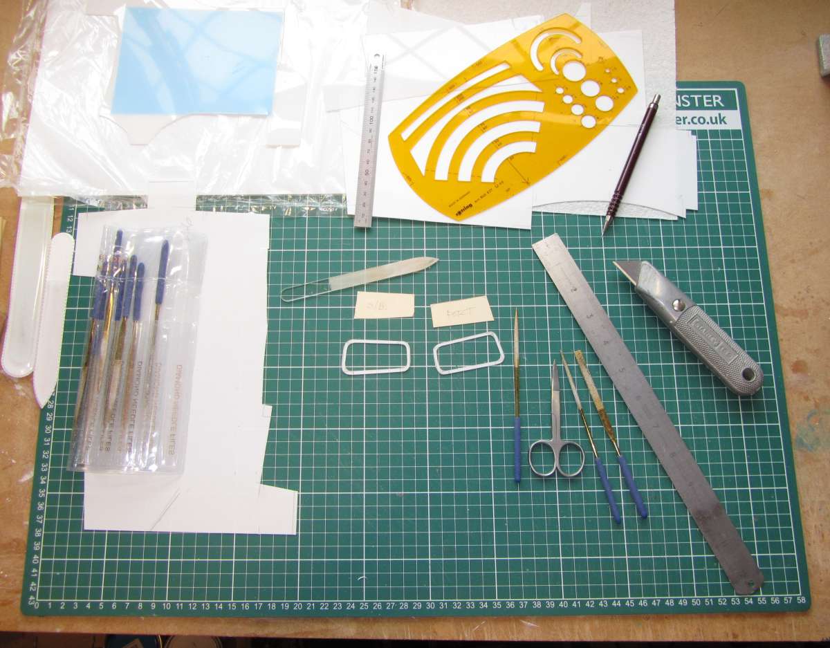

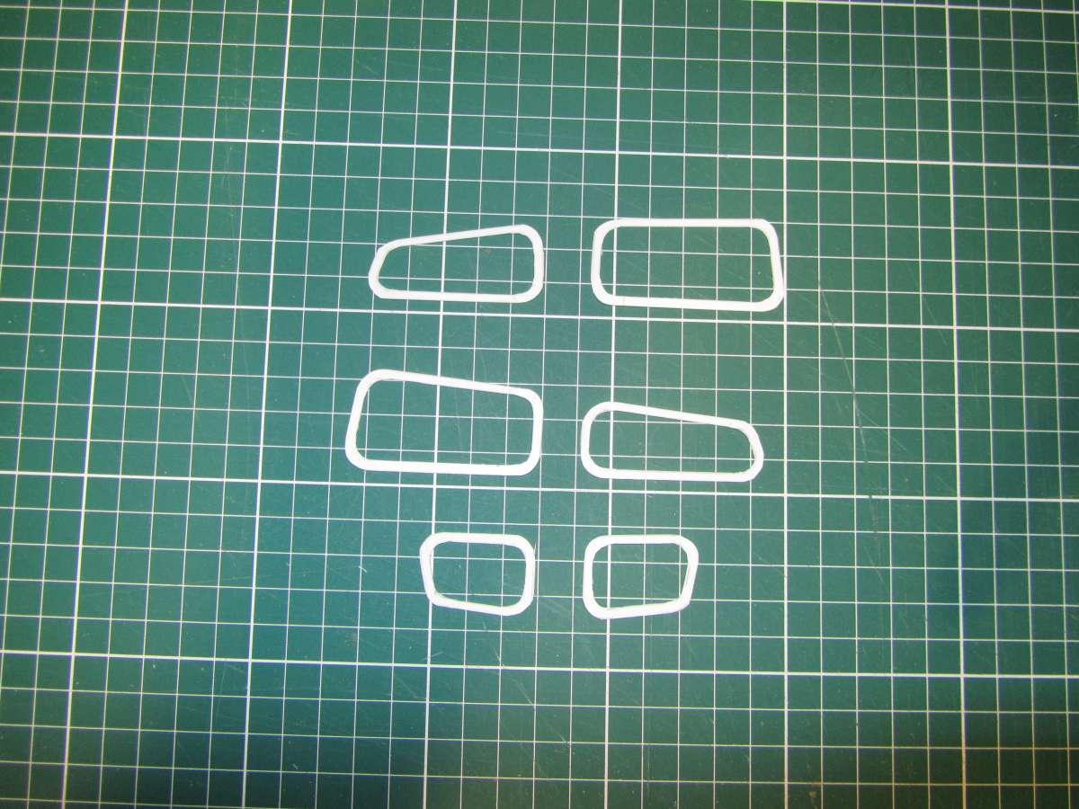

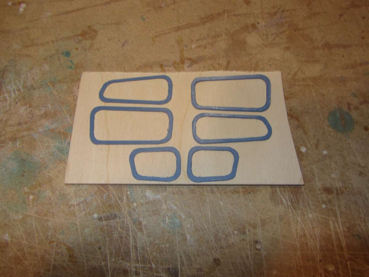

                                                Not too much more to do now. Roof is being glossed along with the motor mount and other bits and pieces inside the boat along with some more varnishing.

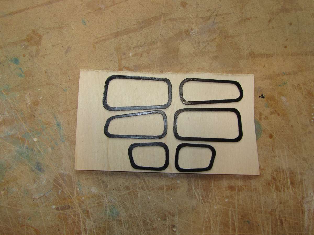

                                                Window frames have been made from 0.5mm plastic card and a coat of primer/undercoat applied. I usually chrome paint but as mentioned elsewhere I’m going to do in another colour. I’ve bought some tins of various browns and have primed some plastic card so I can do some tests. Black is another option used on full-sized boats but I think that may be too much of a contrast as well, we shall see. Trouble is it’s very difficult to make frames as narrow as full-size to scale and so they can be too dominant.
                                                Looking forward to tomorrow as I can reinstall the rudder, prop shaft, motor and RC equipment and it will then be ready for testing! Which just leaves a bit of detailing. Talking of which some goodies arrived in the post.
                                                Windows 9
                                                Windows 10
                                                Windows 11
                                                Ships Wheels

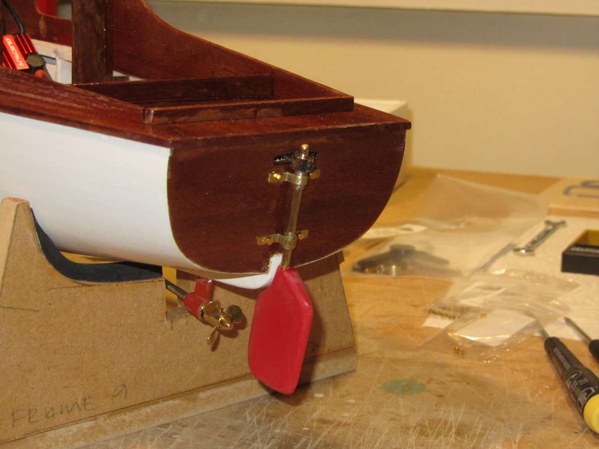

                                                    #126833

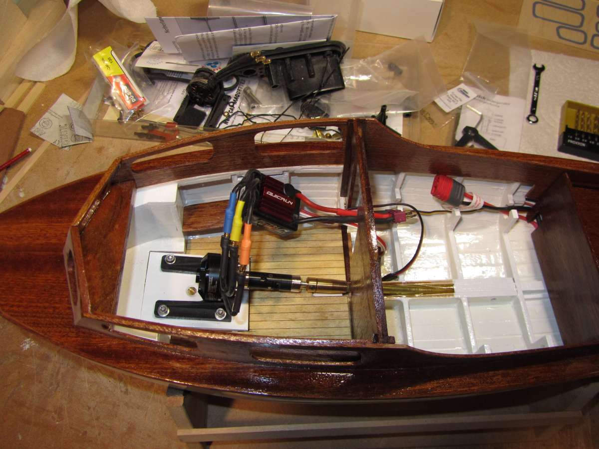

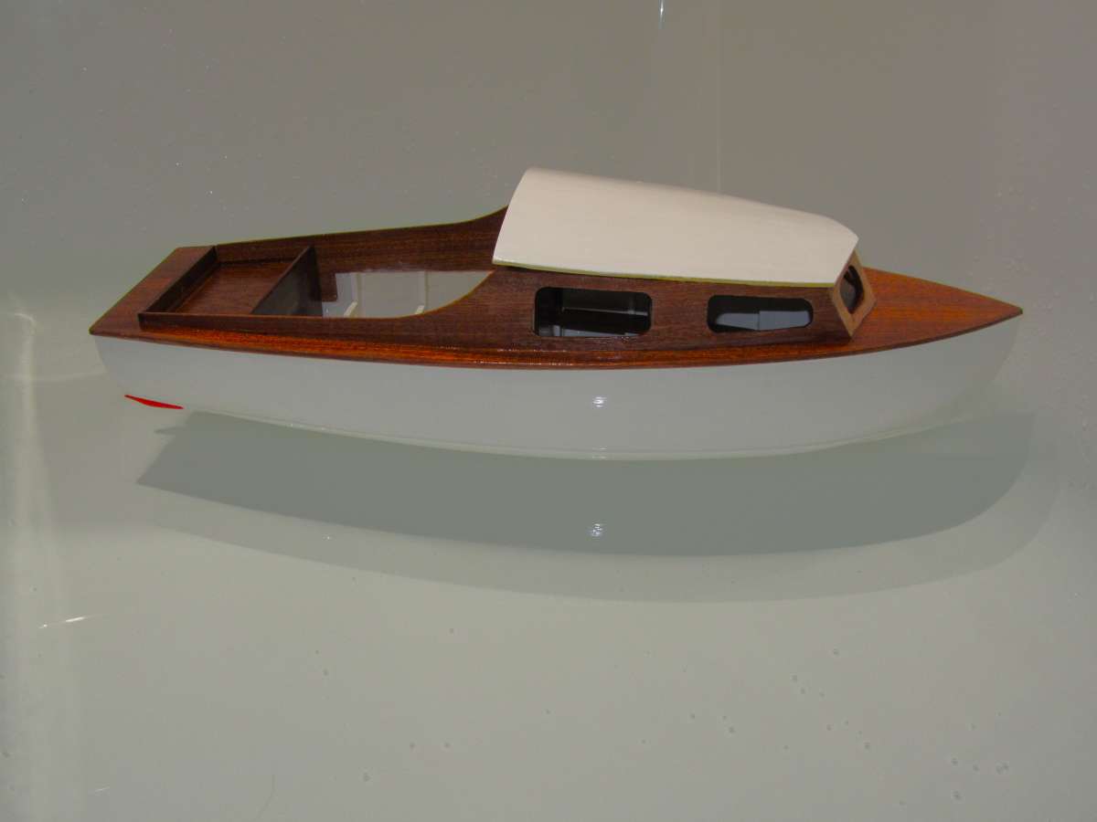

                                                      Started fitting all the hardware but came to a halt when I found I hadn’t got a servo extension lead left so had to order some.
                                                      Got enough in to allow me to try in the “test tank” though. Pleased to see that it sits at just the right angle and the slot for the rudder arm is well above the water level so water ingress won’t be a problem. Despite it being a round-bottom hull it is very stable as well so no worries when it comes to the lake trials.
                                                      For the window frames I decided to go with satin black in the end.
                                                      Windows 12
                                                      Installation 0
                                                      Installation 1
                                                      Installation 2
                                                      Installation 3
                                                      Bath Test 1
                                                      Bath Test 2
