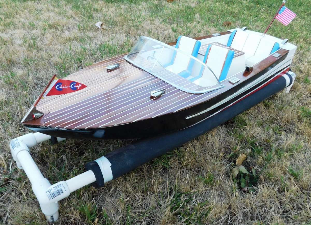

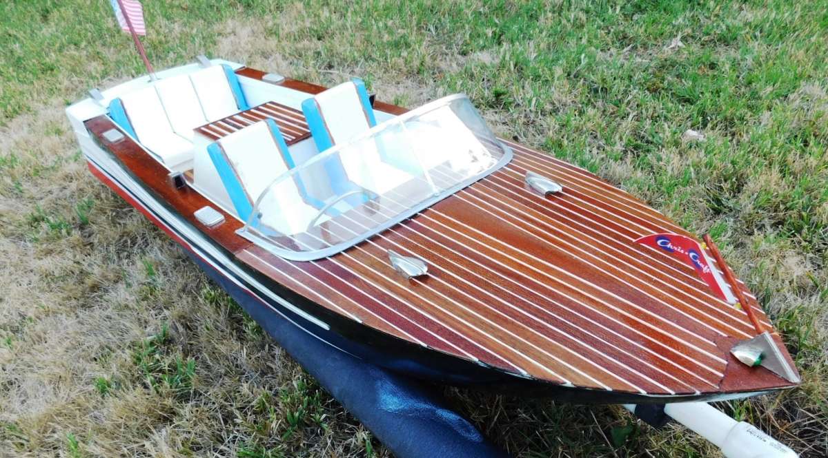

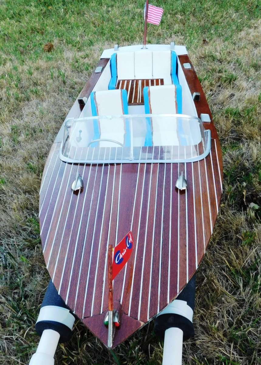

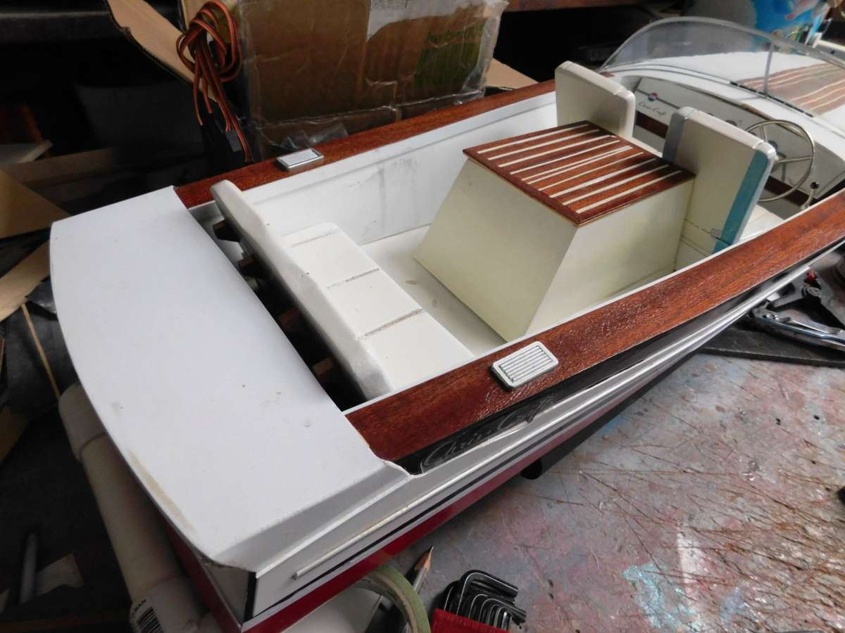

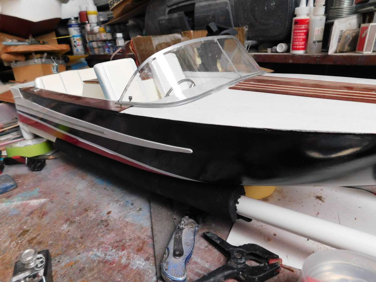

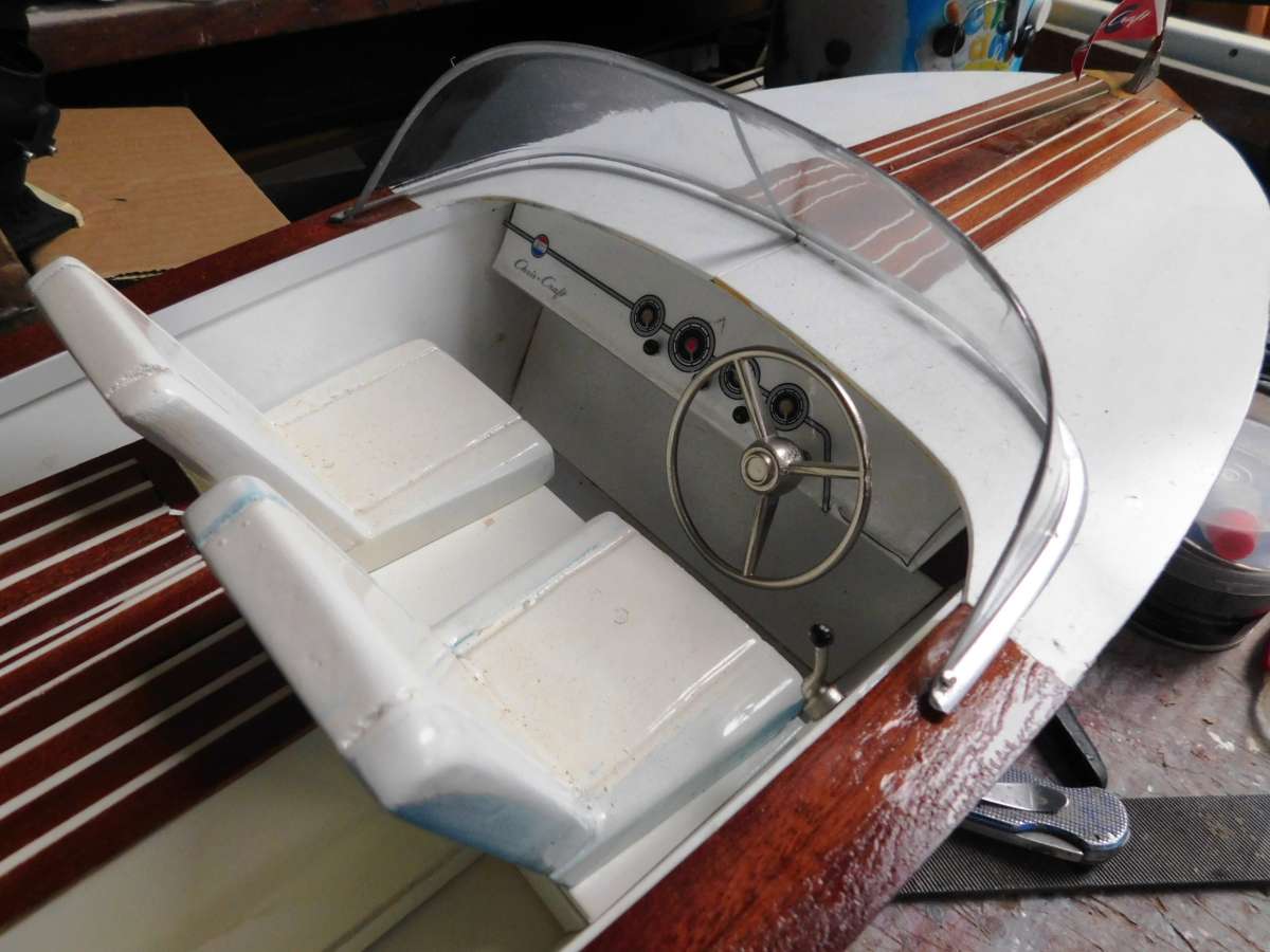

      Hello Fellow Boaters
      I bought this boat 80% finished from a club member.

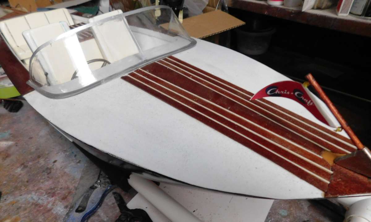

      I changed the floor to wood and added more timber strips to bow.
      This turned into a problem as I ran out of strips !!!
      I found so matching veneer sheets and glued that together.
      Cut this into the required width with my 63 mm little bench saw.
      I have ran the boat with the C3542-1450kv brushless motor on 3S Lipo battery.
      60Amp ESC and a 2 blade 40mm prop.
      Because of no chine rails it is a very wet running boat.
      Looks like adding the chine rails and repainting the bottom of the boat.
      HarryDSCN4836DSCN4840DSCN4837DSCN4838DSCN4839DSCN4862DSCN4859DSCN4860DSCN4861

                      I added 4mm square chine rails which has fix the boat.
                      It’s made the boat totally usable.
