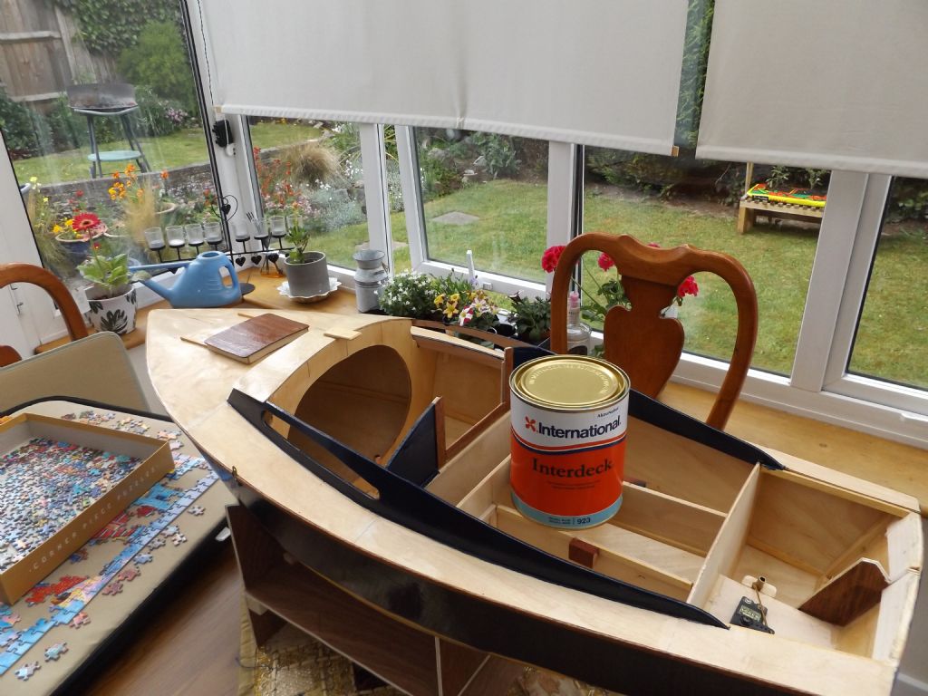

      #95671
        I managed to get to a chandlers at Maldon Essex the other day, and have bought the light blue International deck paint the pukka stuff, we don't want the crew slipping and falling overboard !!

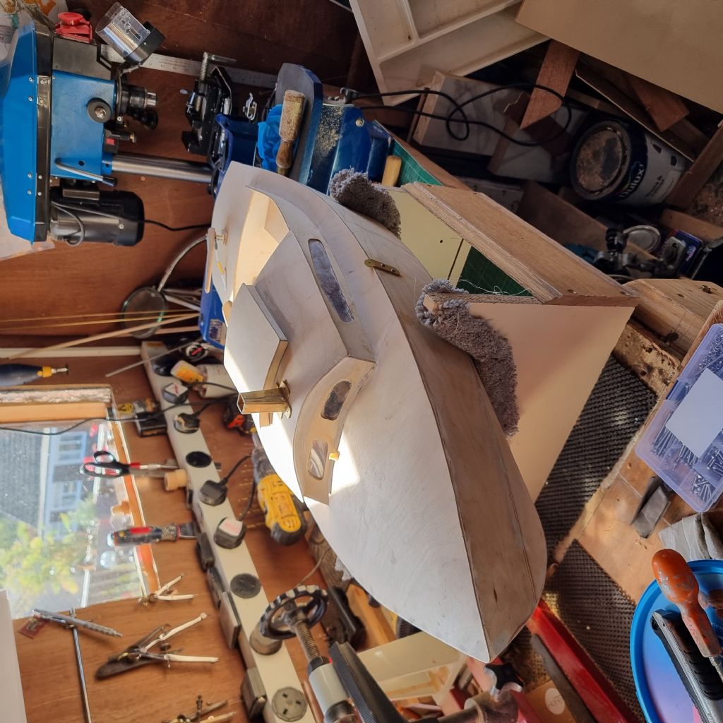

                    servo fitted.jpgHi Ray,
                    Are you still making headway with the Silhouette, I'm also building this model from the Magazine plan, well its been an on going project which was started in 1988 !, but since retirement I have been getting on with it.
                    I love you idea about fitting an internal motor and would love to pick your brains regarding this addition

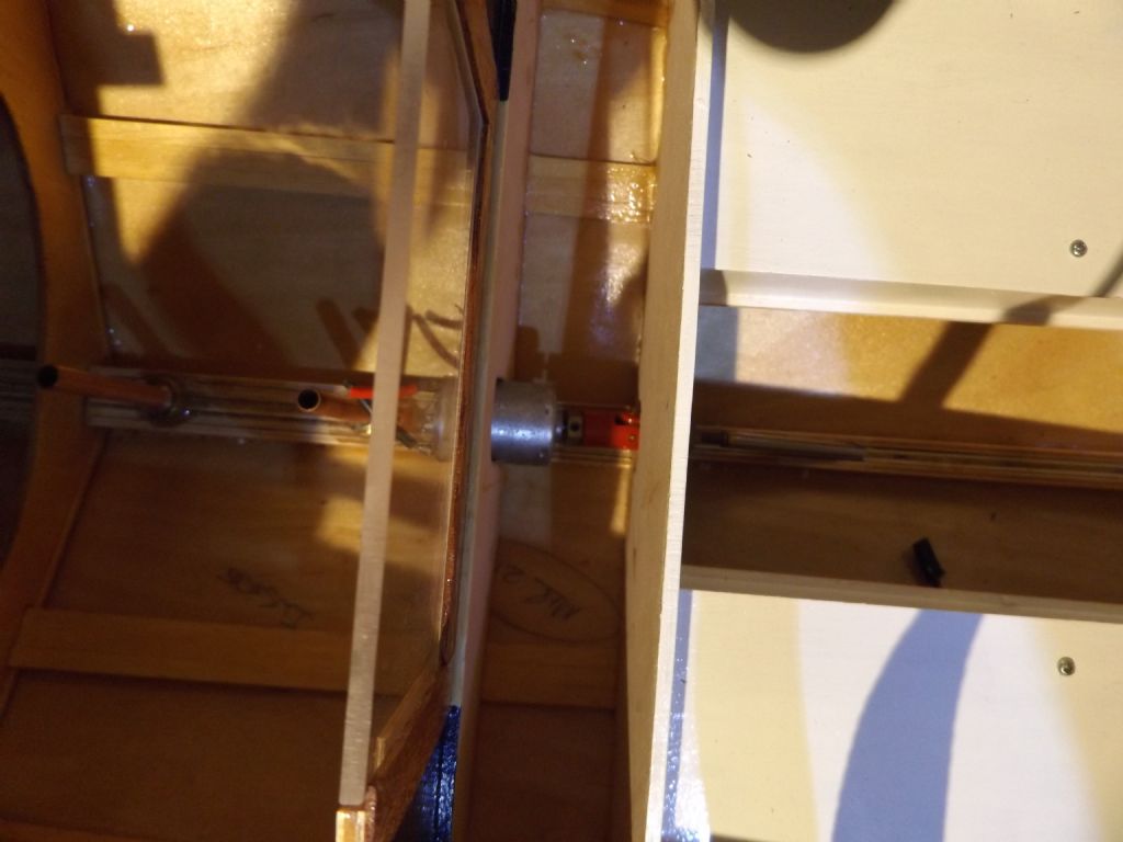

                          Hi Clive,
                          As you will see earlier in the build photos, I put a slot in the keel for the stern tube, which is a 8" tube with a 4mm threaded shaft , a standard Huco type coupling and a 400 size brushed motor, which will eventually drive a 30mm brass 3 blade prop.
                          The photo is rubbish as the whole set up is now deep in the hull, you will need to make the cockpit floor and cross bench removable for access.. the motor is wedged into the bulkhead opening, should be ok with some epoxy.
                          Don't worry about the build starting in 1988, I have a boat I started in 1972 part built

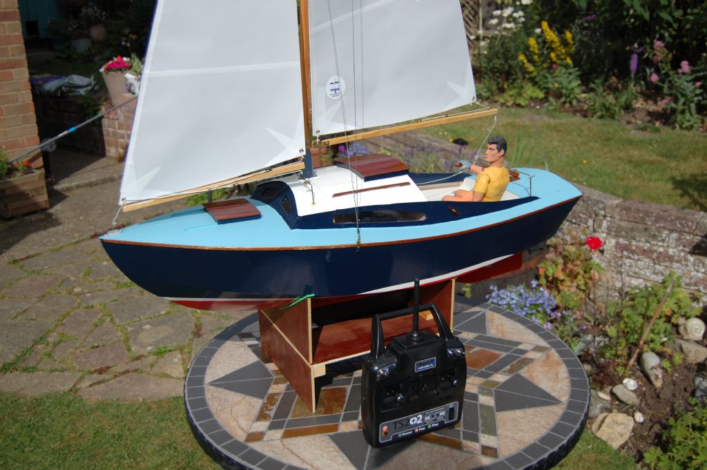

                            #100946

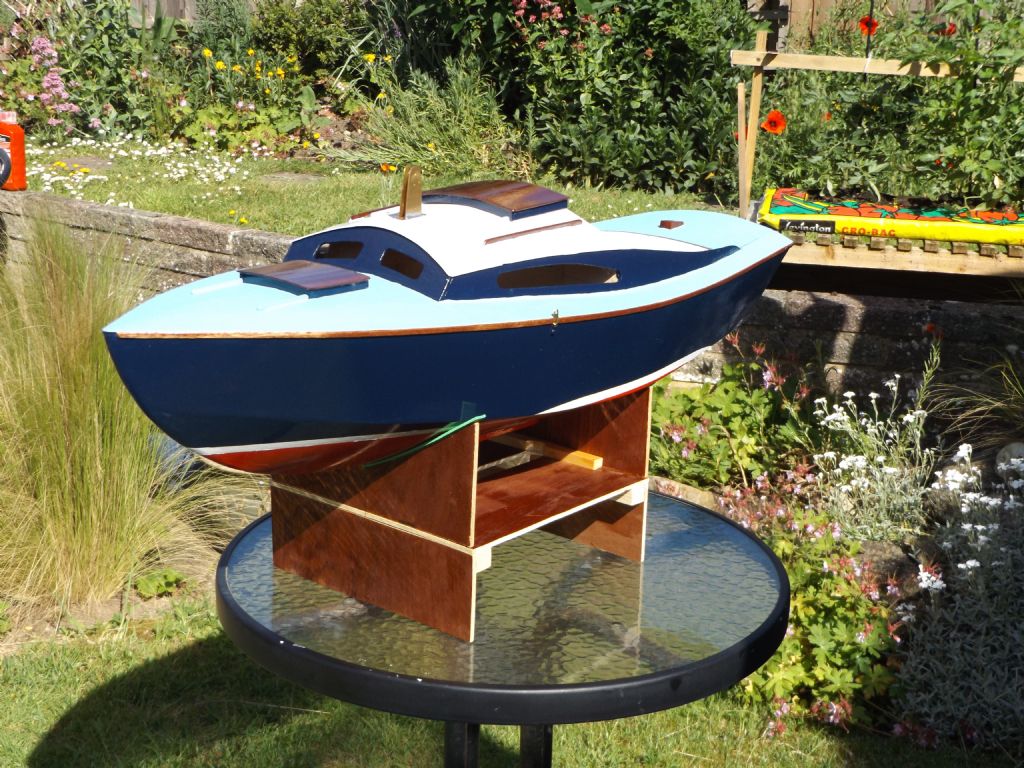

                              Here's the old project finally being completed for launching in a couple of weeks, Thanks to Frank at Nylet for the sails, just putting a single Hitec lever arm servo for the main sail , not sure if the scale rudder will be big enough but I have left some holes for an add on if required. Been to Tool Station this morning for the Cyano recommended by David this morning

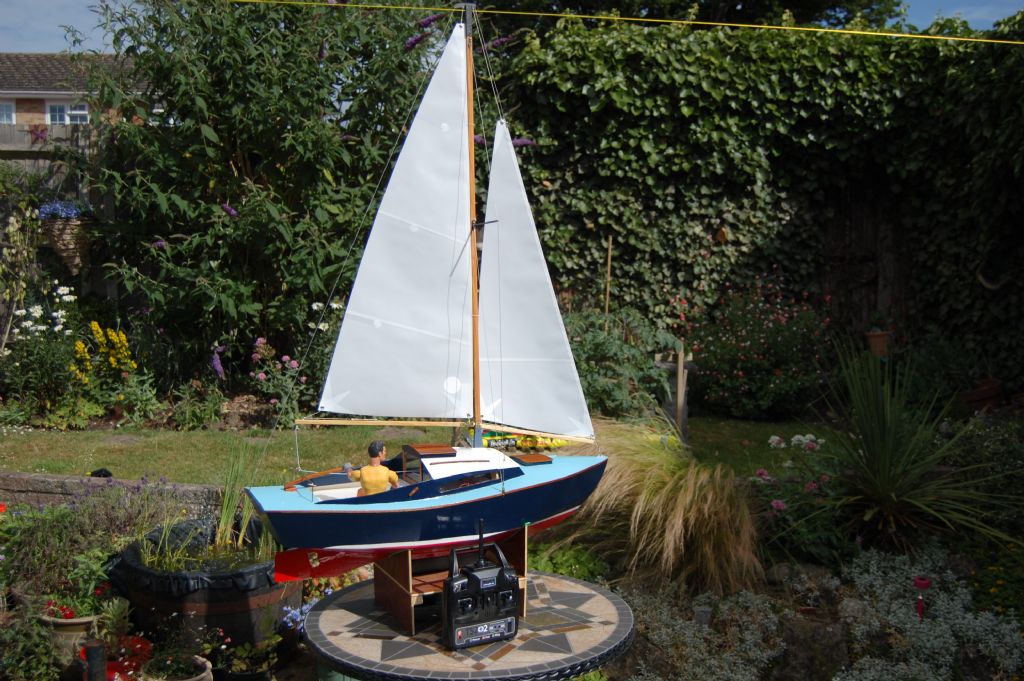

                                  sil 1 250622.jpgHi Richard,
                                  Your right being brought up on Swallows & Amazons book always gave me the longing to be on the water, cost me a bloomin fortune over the years sil 2 250622.jpg
                                  Regards Ray (looks better in the sunlight)

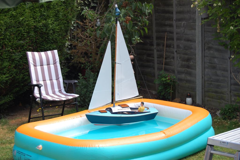

                                      #101155
                                        Hi all,
                                        Small test on the paddling pool , floats on her marks, but need a bigger pool
                                        Bluewater tomorrow for a proper test ..

                                          That light Blue navigation light at the top of the mast looks a bit Big laugh.
                                          Definitely looking good , looking forward to see some action shots

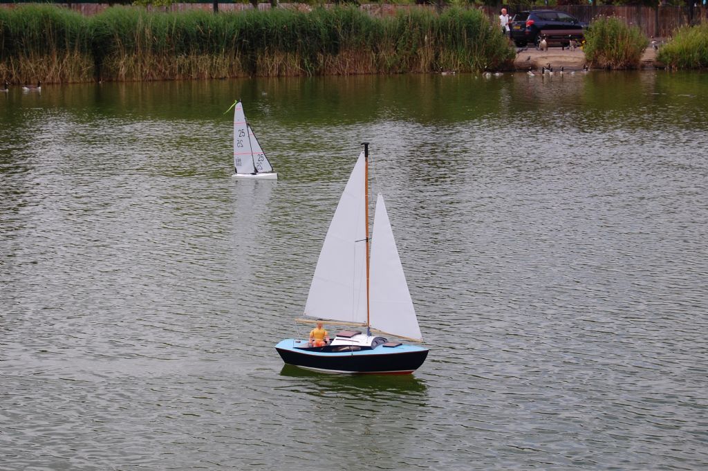

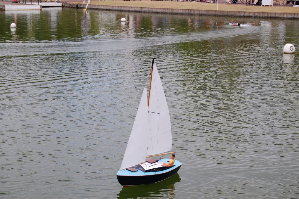

                                            sil 3 090722.jpgsil 2 bw 090722.jpgHi Clive,
                                            Well spotted we just love those solar bulbs round the garden
                                            Yesterday's first outing went well in light airs, she is not going to be a racer but pleasant to sail, could do with slightly more keel weight further down, and the rudder needs enlarging, as its the scale size worked better than I thought i would to be honest. I did anticipate this so 2 holes are already drilled in the brass rudder for the extension.
                                            So all in all a good result, and looks proper with the Action Man at the helm sil 1 bw 090722.jpg
                                            Regards Ray PS. Thanks to Frank Parsons at Nylet for the lovely sails
