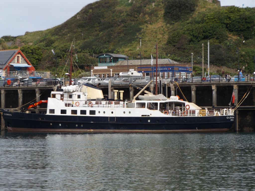

      This is my new project for the Lockdown 2, I have been producing a drawing from photographs over the last couple of weeks and now have enough drawn to start construction.
      Plenty of history on the web, built in Germany around 1958 and converted at the Appledore shipyards in 1985 for her current use, home base of Bideford, we have seen her on our stays at Ilfracombe and it's about time I built a small ship she will measure 36" which I hope is a handy size, will be ply keel and balsa from there on, here goes !!

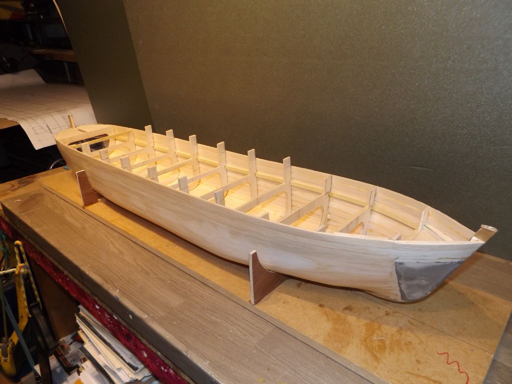

                old port planking.jpgHi All,
                Good weekend planking Oldenburg, using 1/8" balsa, as balsa in demand I will use Styro foam for the front & rear blocks carved and sanded to shape, then light weight glass cloth and water based resin on the outside & polyester resin inside if I can find some in the shed  Regards Rayold stbd planking.jpg

                                Here is the latest stage photos after some lightweight filler to cover the worst of the planking, I only managed to get bulkhead 3 the wrong shape and had to do some packing out, on with the glass cloth and water based resin, 5 coats later she is ready to be released from the board tomorrow so making a stand now.
                                Keep safe only 3 weeks before the pubs re-open

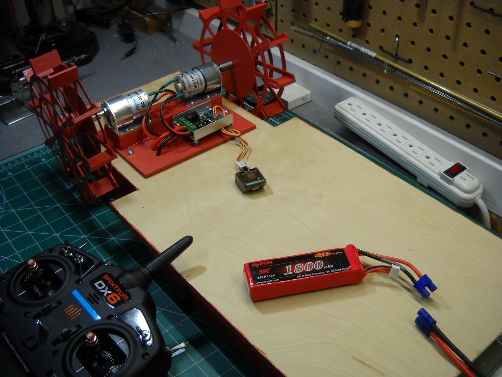

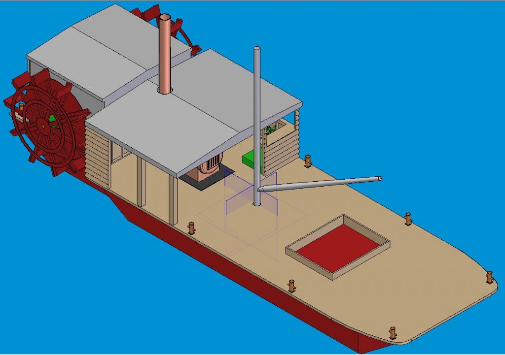

                                        Hi Ray – yes I am building a Murray River Drogher. I came across some photos on the internet, but couldn't find any plans so it is my own design. The hull is done and the drivetrain has been sorted. I'm cutting strips now for deck planking. It's keeping me busy during the lockdown.

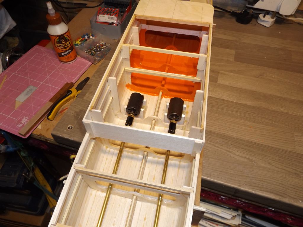

                                            The 2 surplus brand new 400 brushed motors found up the loft are nearly in place, they were originally destined for a B17 Flying Fortress but flying has moved onto brushless these days
                                            The big investment these days are the 10" stern tubes & 30mm brass props so £56.00 later the engine room is installed, motors in balsa cradles with a dowel & elastic band to retain.
                                            Ordered some ply from SLEC last week the good news is there is a container of balsa wood making it's way to the UK will keep the aeromodeller's amonst us happy…

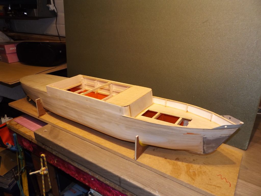

                                              The new ply consignment arrived from SLEC so we are back in business with the decks Litho plate aluminium round the bow makes it look thin enough to be steel I hope.
