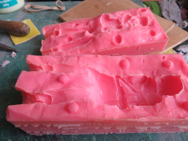

            Neil, you already know, that a picture is worth a thousand words
            How about a cross section through the whole chibang?
            #90603

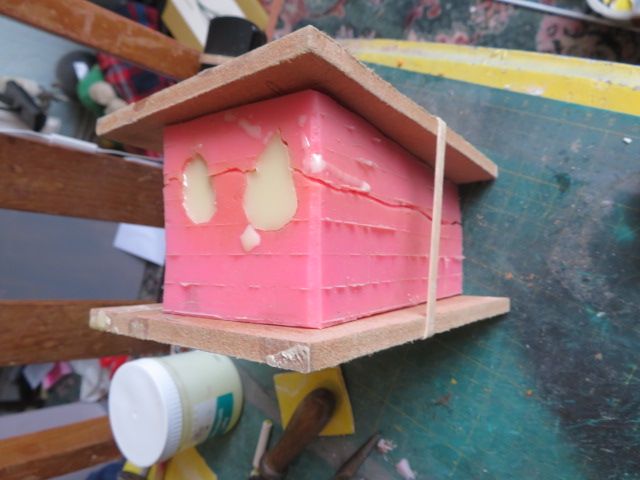

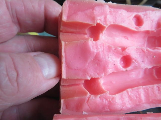

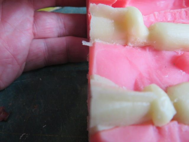

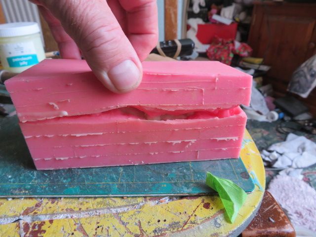

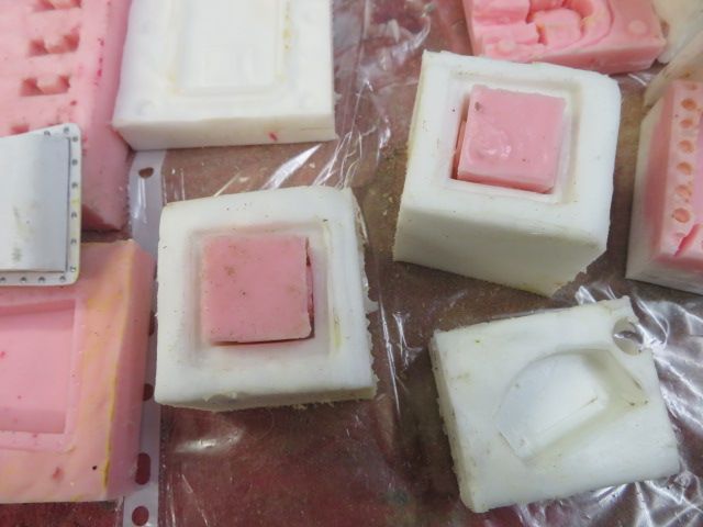

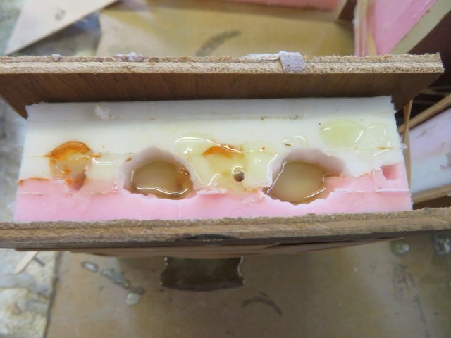

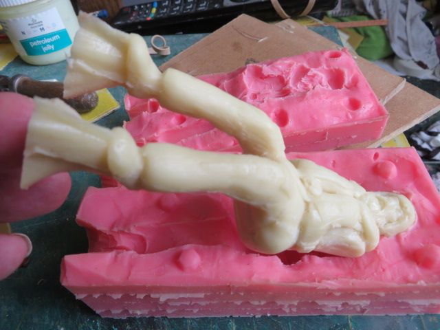

              wait for a finished mould matey with the original items in.
              however………the plasticine holds the models in place so that you can lay the rubber up to, to make the first half of the mould.
              then you leave the model half embedded in the rubber half that you have poured into the box, and peel away the plasticine and put it aside to use next time.
              you leave the half moulded rubber in the box with the model half embedded in it. rub Vaseline over the exposed rubber around the model embedded in it, and then pour the second half into the moulid box covering the model and the already set and cured 1st half rubber.

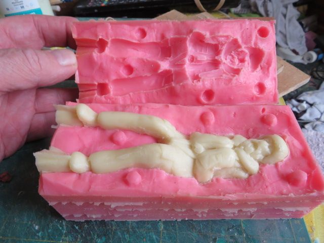

              have a look at one of the lifeboat men both outside and inside the mould for a visual explanation.
              so in the pictures below the man would have been sat in a box originally with plasticine covering half his body from head to toe whilst sat on his back and the plasticine moulded along the body length imagine in this shot, that the rubber is in fact plasticine.
              and the view above shows the cut outs to where the resin is poured into.
              #90604

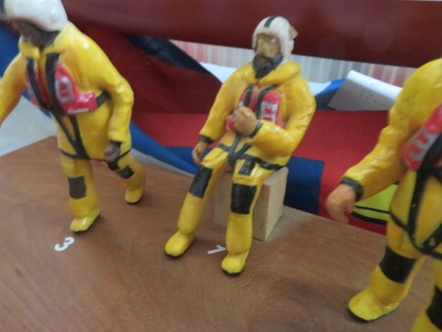

                and this is the full set of pictures.
                and this is a finished item if the model shown in the pics. the arms are moulded exactly the same way as the body and added later in what positions needed on the boat.
                #90605
                  That`s more like it Neil, I understand now, matey. You should have said that in the first place!…..Only pulling your leg, old chap
                  The crew look very realistic and lifelike
                  Really splendid

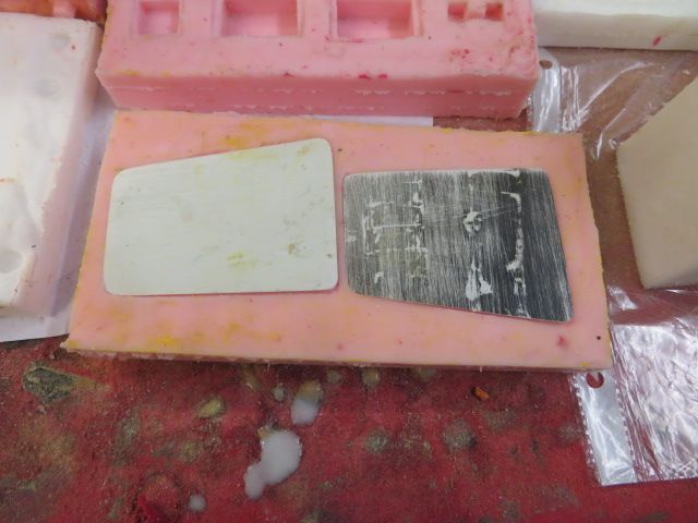

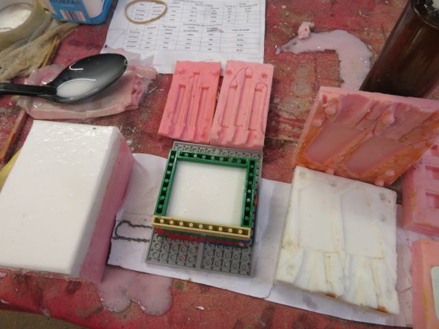

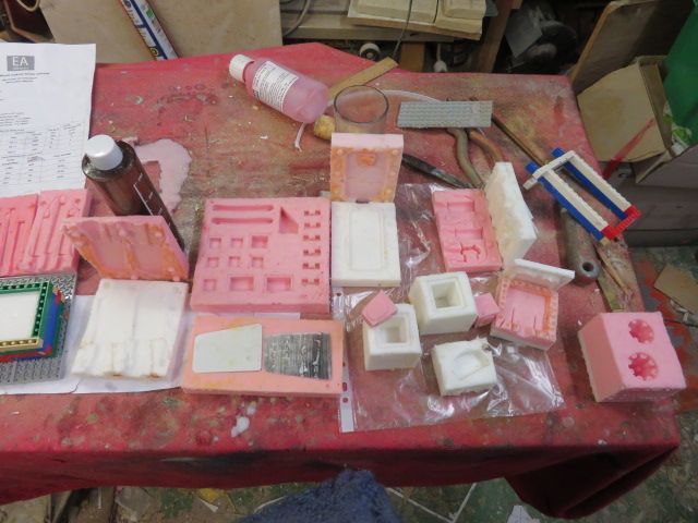

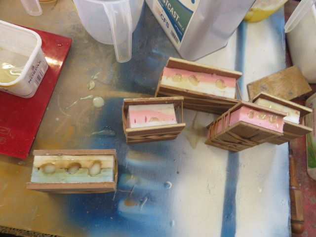

                      the moulds for the remaining parts to make up the bulk of the small fittings will add to those that can be supplied by macs mouldings to the Tyne and possibly some Mersey class lifeboat.
                      next job is to cast some in resin and see how they go.
                      #90695

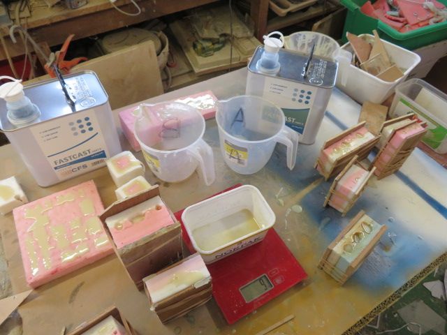

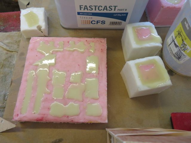

                        just done some casting of all the little fittings for the Tyne lifeboat…
                        but in my haste to get them done, as they were flowing well……..I forgot the put the brass rods for the rudder stocks into the moulds before casting the blades……
                        and so doing exactly what I said not to do, I am going to drill them and glue the stocks into the blades on the first moulds and use as the masters…..I'll fit my rudders that I made from plasticard on my Tyne.
                        but nothing really to show other than rubber moulds full of resin for the next hour or so.

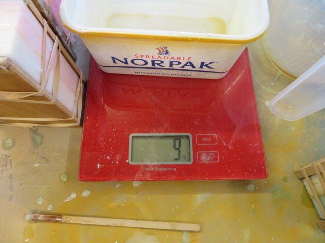

                        the picture of the scales shows that the mix of this resin is absolutely critical weight wise with a totally accurate 50/50 mix…………if either weight out by more than 3% and the resin just wont cure and you left with either a sticky mess or a rubbery model that is like playdough.

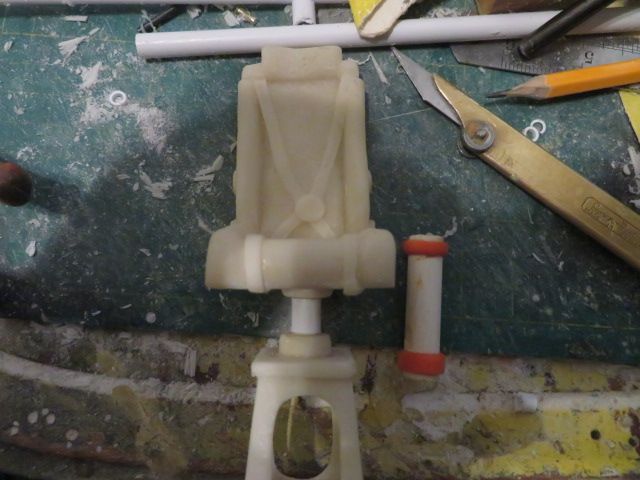

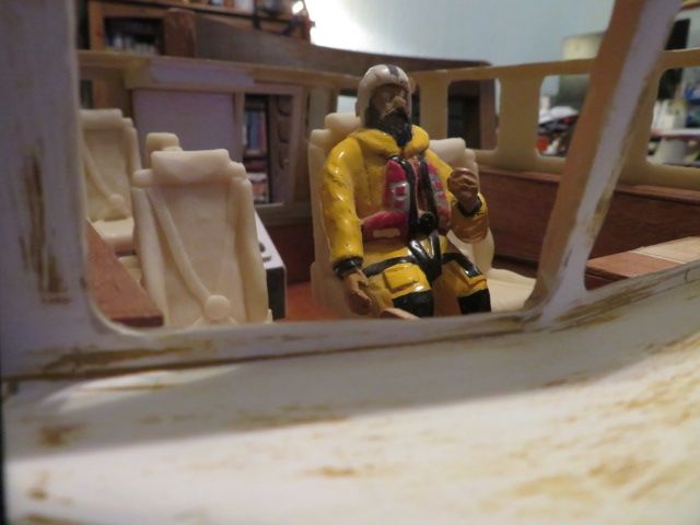

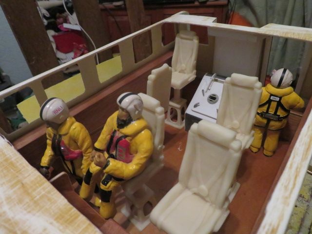

                          the seats and pedestals have been put together according to the old RNLI plans that I have, measurements scaled up….
                          but I think either my enlarged measurements or the measurements mentioned on the plans have gone somewhat awry as all six chairs stand far too high in the cabin, so I think a large adjustment will need to be done…
                          ……but that is for another day,
                          the old girl would have to have a convertible canvas roof like my old MGB to facilitate the crew inside………..errr ummmm. back to the drawing board,

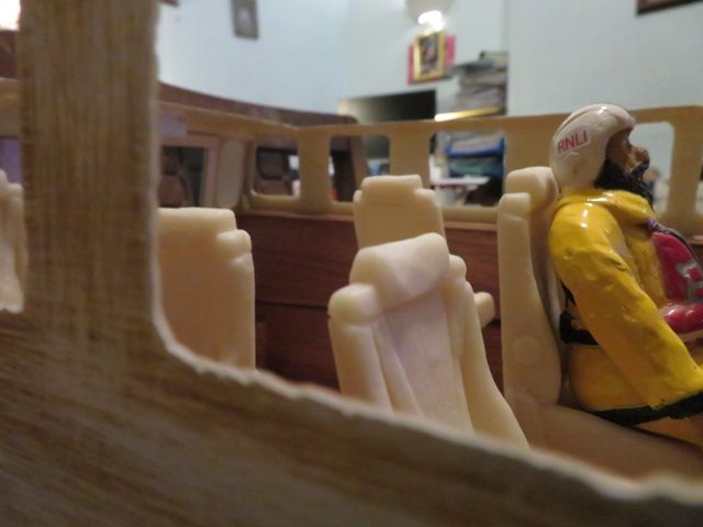

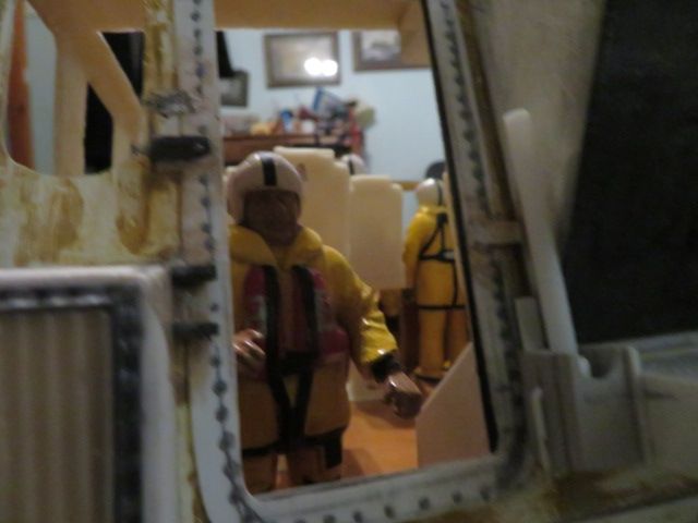

                                  img_6014.jpgI rectified the problem, after getting back from Nottingham, and a quest to get a model lifeboat down to an elderly man in Cornwall who agreed to buy it just a week before lockdown in march…………a mammoth task which had failed 3 times before during lockdown, but she started her journey this morning at 07.30 hours, lol.
                                  anyway, back to the problem of chairs two tall.
                                  i cut off the mid section of the moulded pedestals and got rid of the mid sections between the orange rings, and made some shorter shafts from plastic tubing…..
                                  all is well now and the crew can rest assured that they wont be banging their heads on the head lining and roof space, lol.

                                    Must be uncomfortable sitting on those straps though…😎
                                    if you have a man/men/ladies sitting on the seats , will they have a seat belt harness on ?
                                    Ashley (Just nit picking) 😈
                                    #90775
                                      on my boat they'll all be out on deck or on the flying bridge control on a SAR shout…..no one inside this trip lol.

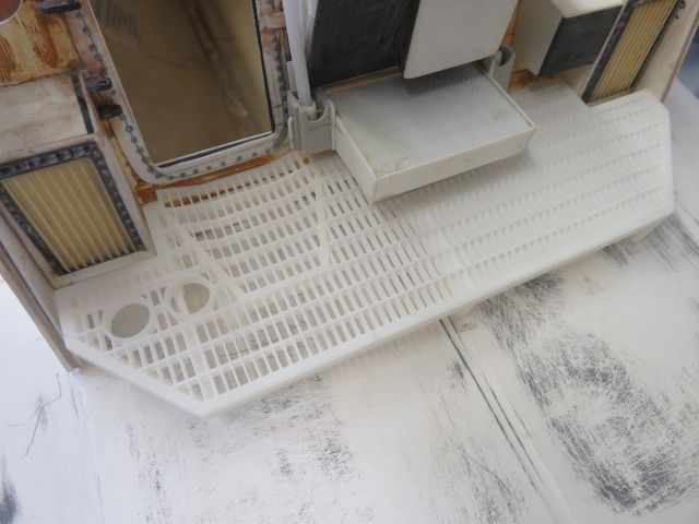

                                        I want to thank a good friend of mine and who I know through my contacts with the RNLI.
                                        He spoke to me at last year's RNLI Lifeboat day at Fleetwood and whilst chatting about making a model of our past Tyne lifeboat if there was anything I needed 3D printing he said he could see what he could do….

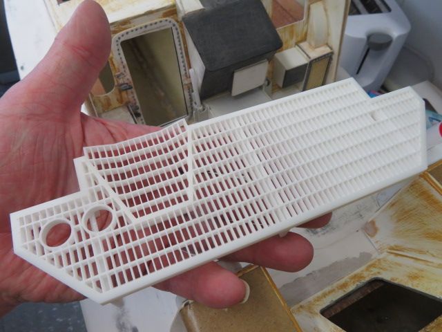

                                        I asked him a couple of months ago if he could 3D print the grating that appears at the rear of the fore cabin of the Tyne that is the flying bridge.
                                        today I picked the finished item up from him [ two in fact for he printed two, and is sending me the programme for printing more via email], and I was just gobsmacked at the amazing items…….they are superb, and I could never ever have done them sticking bits of plastic together….
                                        what do you guys and gals think……….I am overawed by them.
                                        thank you so very very very much my friend……..they are amazing. cheers, Neil.

                                          Hi Neil
                                          Very impressive and far better results than my 3D printer could manage.
                                          #90787
                                            if I put it to you that the printer used was/is used in making both resin and titanium parts for a certain 90 MILLION EURO jet fighter, then you'll know the quality of the printer………..
                                            it sort of puts the quality into perspective………..but keep it quiet, you never know who is reading this.

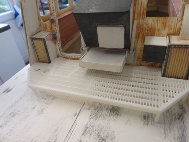

                                              and last night I started adding a few fittings to the cabins that will need to be painted in situ when the cabins are painted.
                                              every little bit helps.

                                                The 3D printing is amazing stuff but slightly depressing as it totally trumps traditional scratchbuilding skills.
                                                Quite where this leaves traditional modelmaking remains to be seen. The phrase 'nail in the coffin' springs to mind.
                                                Meanwhile I will just soldier on with balsa and ply. It might not produce the same results but at least I did it with hand tools.

                                                  i agree totally in most cases Colin……….
                                                  but with my arthritic fingers there isn't a snowballs chance in hell that I would ever have been able to make that……….maybe 20 years ago, yes……….
                                                  but not now, and as a major part of the boat, I wanted it just right.
                                                  #90812
                                                    however my old skills of tech drawing came in handy as I drew the drawings in both orthographic and isometric projections for Alistair to work from, so I can say I had at least some input into the model produced.
                                                    #90823
                                                      Stunning bit of printing!
                                                      If machines were that much cheaper and easier to use, what of our suppliers as well? Buy one figure, scan and print as many as you want at home..ditto…vents, anchors etc etc.
                                                      Perhaps at shows in future any 3d printed stuff on your model should be identified as such?
