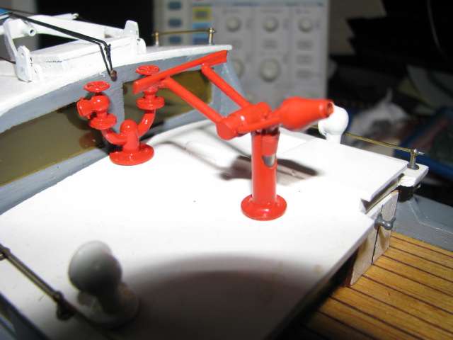

          Fire monitors would need remaking.
          I have working monitors on a Robbe Dusseldorf and a German rescue boat.
          Tim
          #127305
          Dodgy Geezer 1
            @dodgygeezer1
            Yes, they would need redoing. I have a requirement to do some 3d print plans for working ones, but way down on my list!

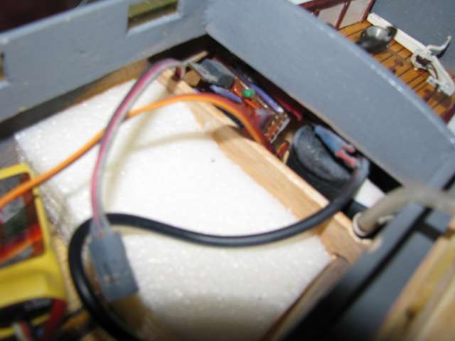

            here are some shots of the prototype. You can see how the water goes in. The pump is mounted under the towing hook deck (I had to change the bulkhead), and there’s a little radio switch next to it. The water comes in through a reinforced hole in the bottom…
            Incidentally, you can see how I handled the mast – it simply folds down, and some elastic holds it up when I fold it back…

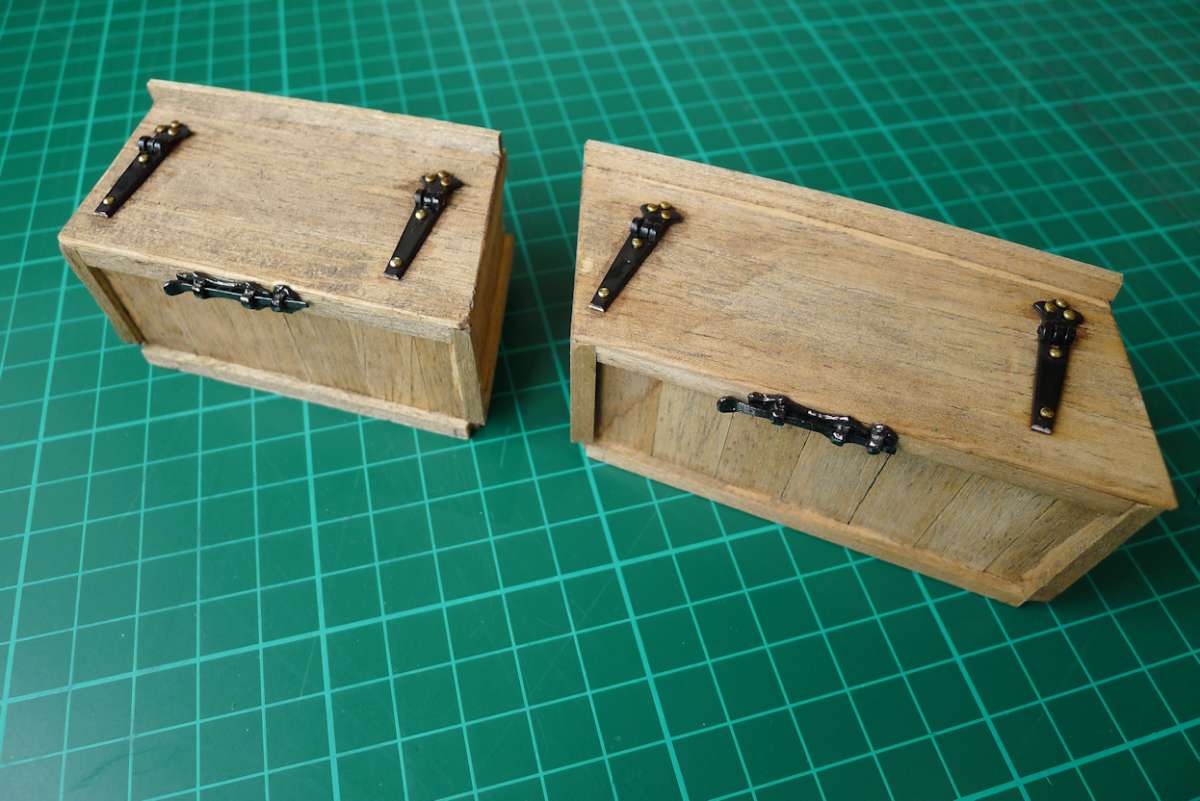

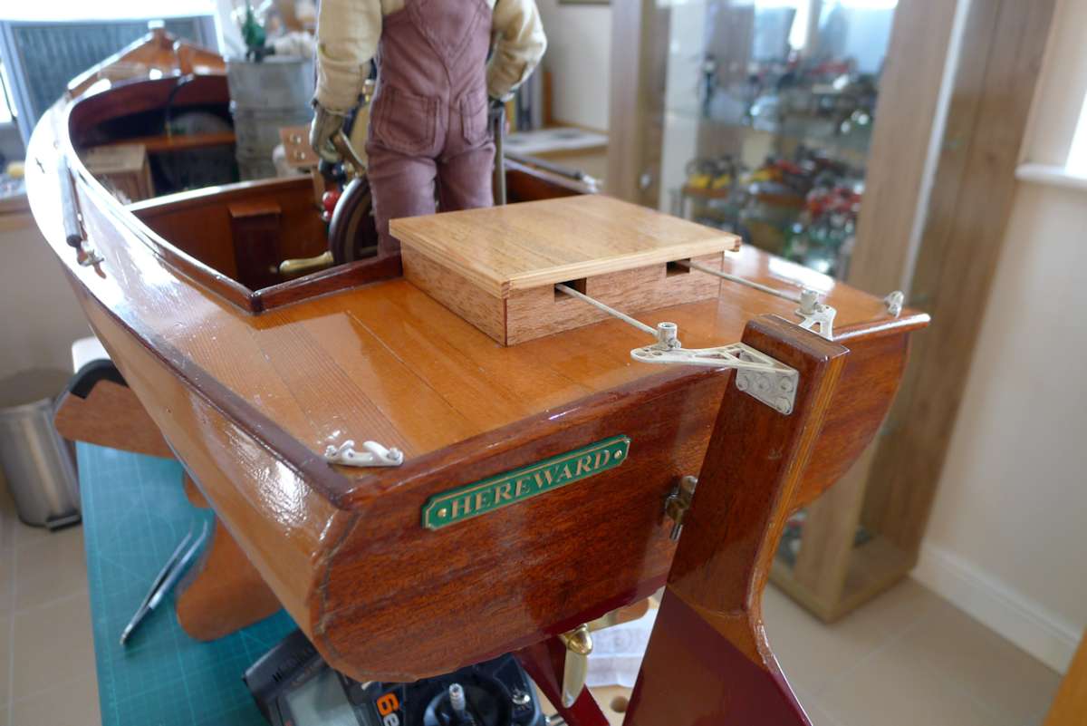

                  #127317

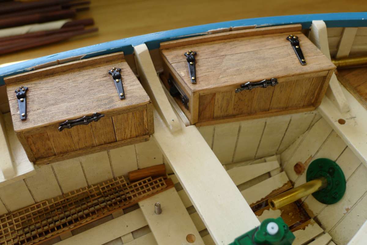

                    I think the trick with neodymium magnets is getting the right size.  They come in a fairly wide range of sizes, which basically determines their attractive force so you have the flexibility to select just the one you want.  I’ve used them a few times and think they are an excellent solution for holding bits and pieces in place on the model.
                    First up, these two side lockers are held in place by magnets on the lower edge.  They hook under the thwart at the top and click into place at the bottom, hiding the battery and the electronics.
                    20-06-21-05LifeboatSteamLaunchConversion49
                    15-06-21-14LifeboatSteamLaunchConversion26
                    20-06-21-04LifeboatSteamLaunchConversion48
                    Then similarly this steering gear hatch is held with a couple of small magnets on either side.  None of them are two strong so the covers remove very easily by hand but its just enough to ensure that they are never going to come adrift in operation.

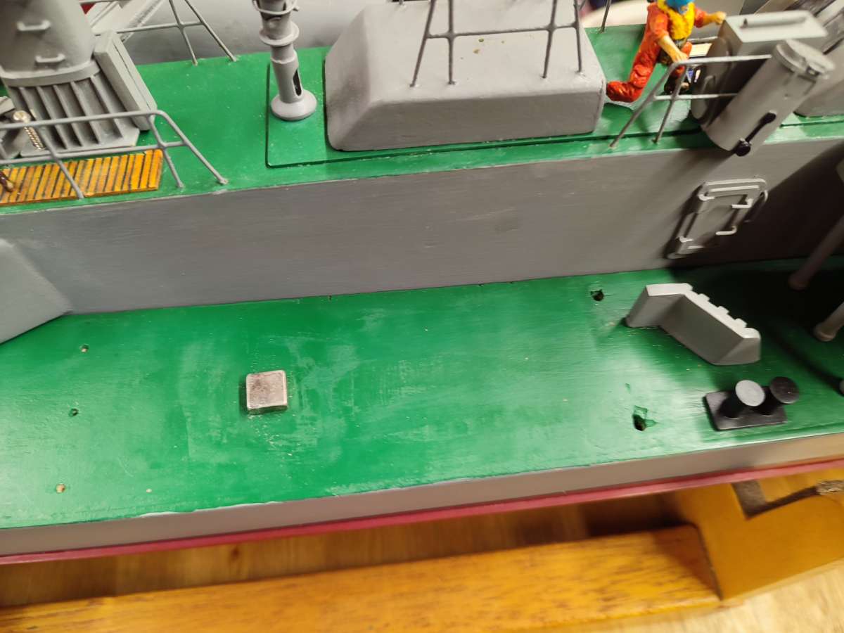

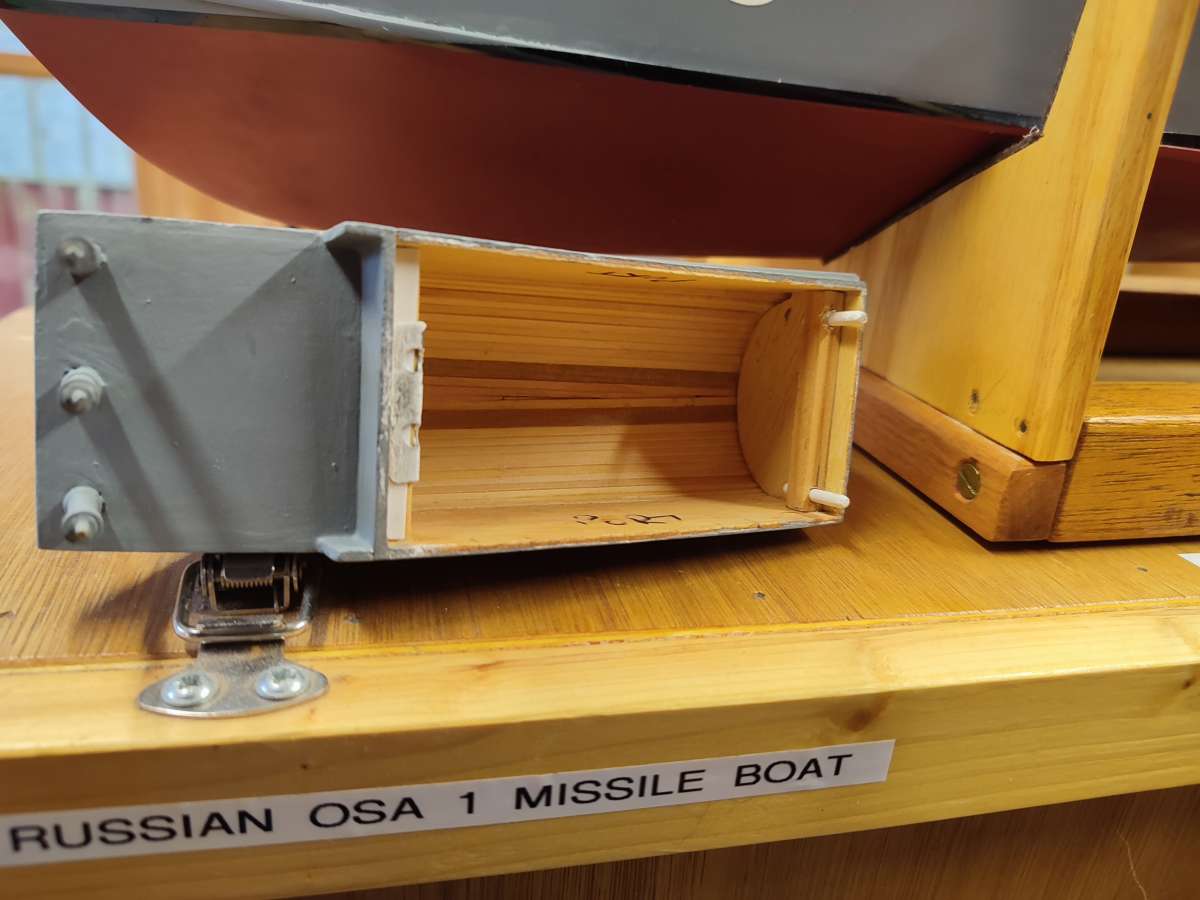

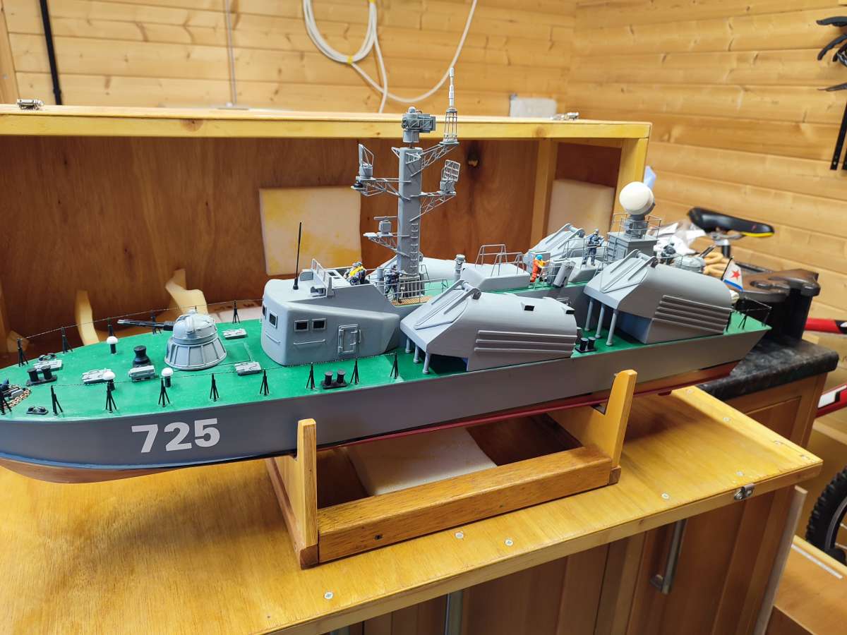

                        @timcooper90034
                        Some pics of Neodymium magnets on my OSA 1 Missile Boat (Eezebilt).
                        The magnets are 10mm square and locate on thin metal. The are locating pins as well.
                        IMG_20260223_153102IMG_20260223_153043IMG_20260223_153750

                        Dodgy Geezer 1
                          @dodgygeezer1
                          I hadn’t thought of making the missile boxes ‘knock-off’. Is that to simulate battle damage?
                          I see the boat has a North Korean flag? Does that make you the Respected Comrade Kim Tom Cop? Any American aircraft carriers on the lake had better watch out!
                          Are you using the rudder shape as shown on the plan? It’s an odd shape, but seems to work well. I was worried about the long thin hull rolling badly in a turn under torque, but was quite surprised at how stable it was in high-speed turns. A pic of the prototype doing a tight turn on a test run is below…
                          20240602_150954
                          #127340
                            @timcooper90034
                            Dodgy
                            The flag is the Russian Naval Flag. At least that’s what it was sold as!
                            <p style=”text-align: left;”>The rudder is  just a std brass one as bought.</p>
                            The missile boxes being easily removable gives easier access to the inside of the hull. The gun turrets are connected to mini servos to give some left to right movement. The mast radar and the drum tilt radar both rotate. With Nav lights and a stern light I thought easier access would be useful.
                            I used the basic Eezebilt plan but changed some of the parts, main mast, drum tilt radar, guns etc using articles from Model Boats mag.

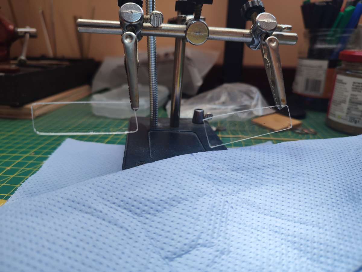

                                      Just manage to get the rest cabin windows to fit.
                                      Have now dipped therm in Future Floor Polish. This gives them a scratch resistant coat. Another coat tomorrow when it’s dry.IMG_20260522_153559

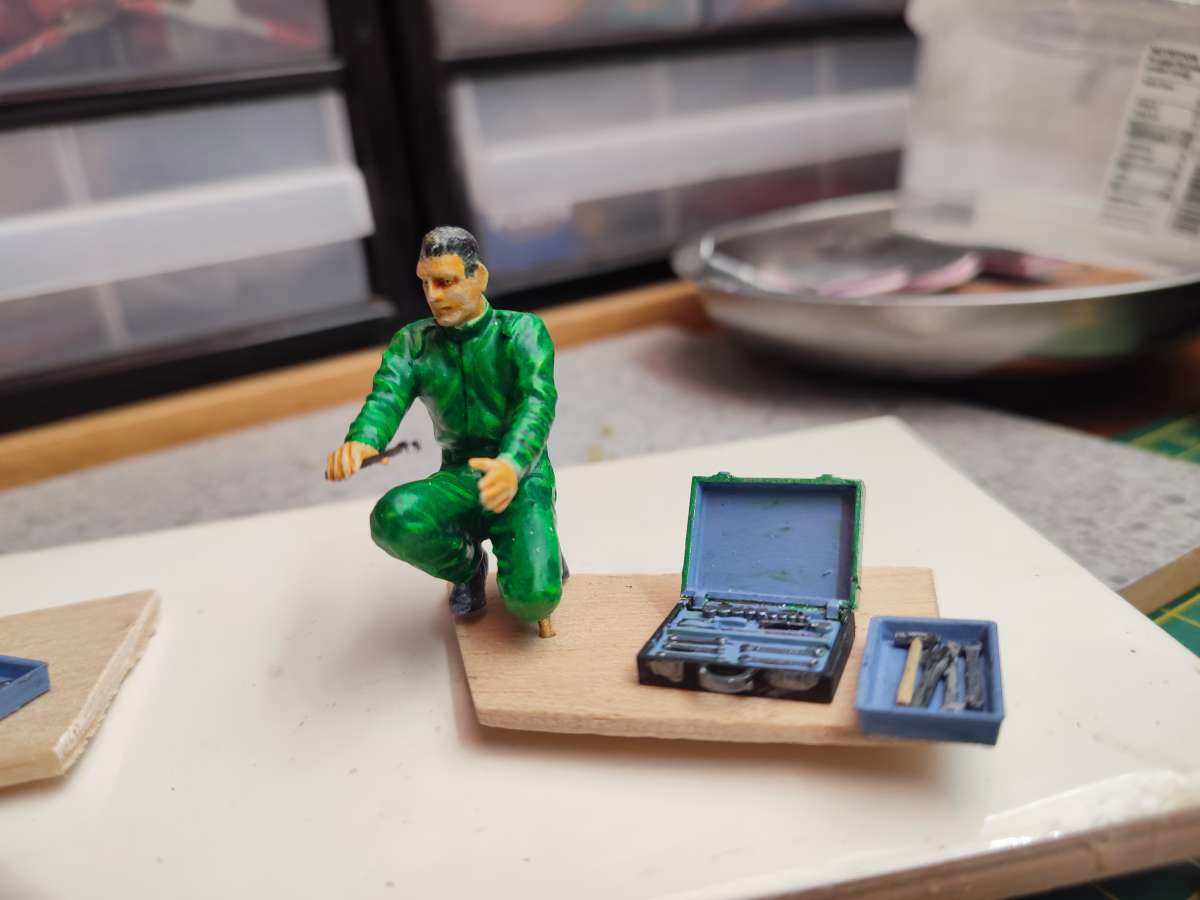

                                          @timcooper90034

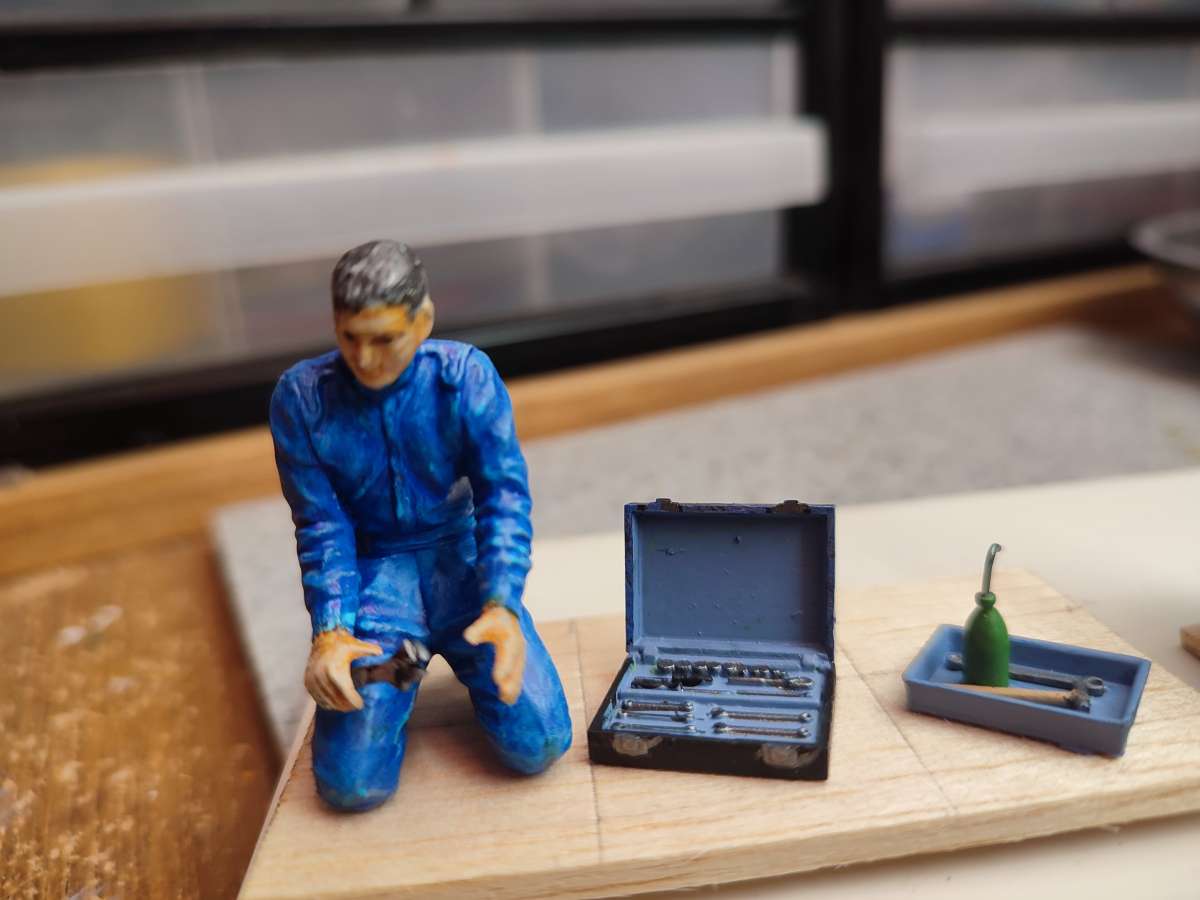

                                          Some progress on the first two crew members. The shading on the green overalls I’m still not happy with. Need to tone the highlights  down a little.
                                          Tim

                                            That’s an interesting tip about coating the windows in floor polish. I take it they glue in place OK?
                                            #128223
                                              @timcooper90034
                                              Not had a problem with gluing the windows.
                                              Not sure where you can get the Future Floor Polish from, I got mine on a trip to Canada 25 years ago. Still seems to work. Not my idea but can’t remember exactly where I read it.

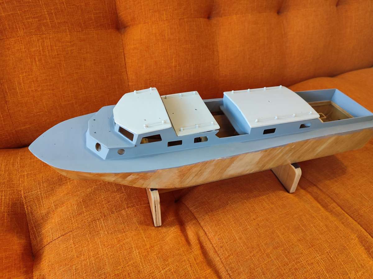

                                                    #128647
                                                      @timcooper90034
                                                      I took my RAF Fire down to my cabin ready for spraying just as the weather changed to too warm and we had 2 sons, daughter in law, and 3 granddaughters arrive.  So haven’t started masking up never mind spraying.
                                                      Yesterday whilst putting my OSA Missile Boat back I knocked the RAF Boat off the bench!
                                                      Isopon putty out today to repair the dents and scratches!
