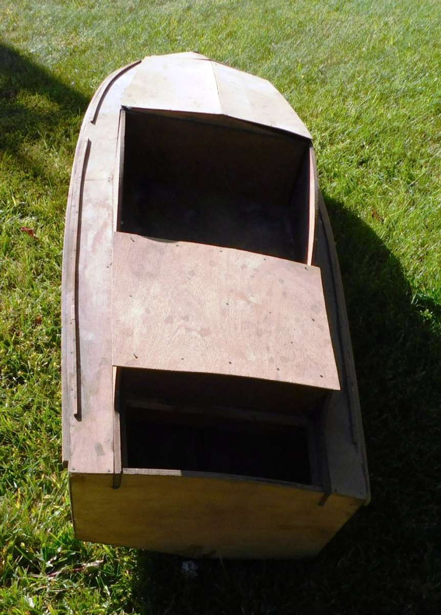

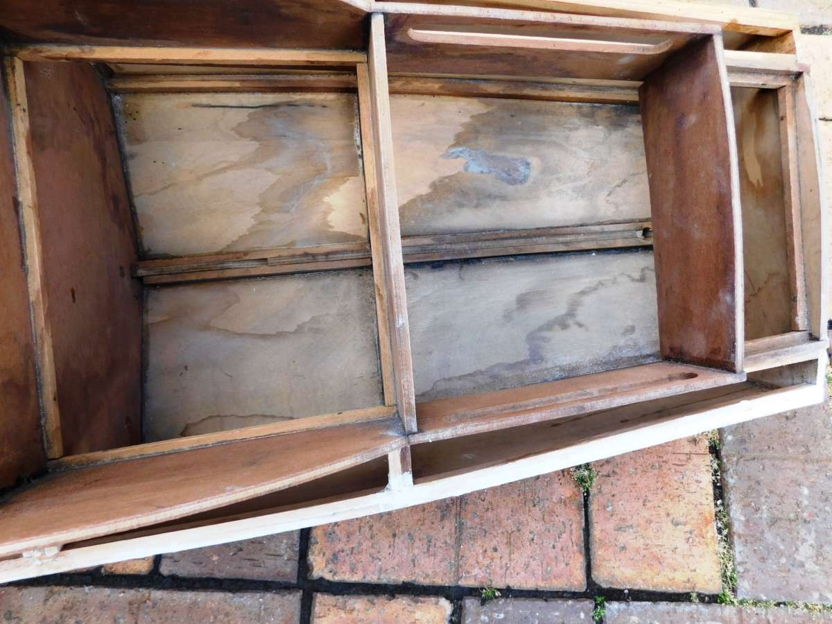

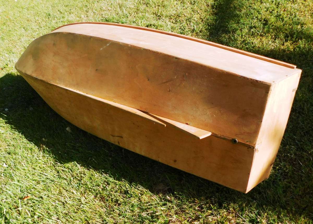

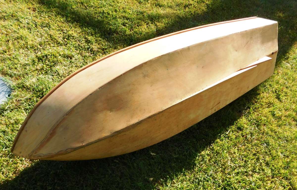

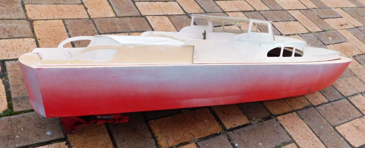

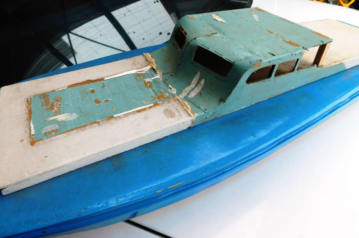

      Hi All
      MY wife told me no more boats this year(2025)!!!
      YES dearest !!!
      Two days later the Sea Queen arrived .
      I had already bought it my dearest !!!
      So onto the boat, someone had just stop on it !!!
      50 pounds for the boat and 50 pounds postage via E Bay Global Shipping.
      It would have cost more in just postage within Australia !!!!!!!
      So this how the boat arrived and as per the pictures on E Bay.
      HarryHull 1Hull 2SternBow 1

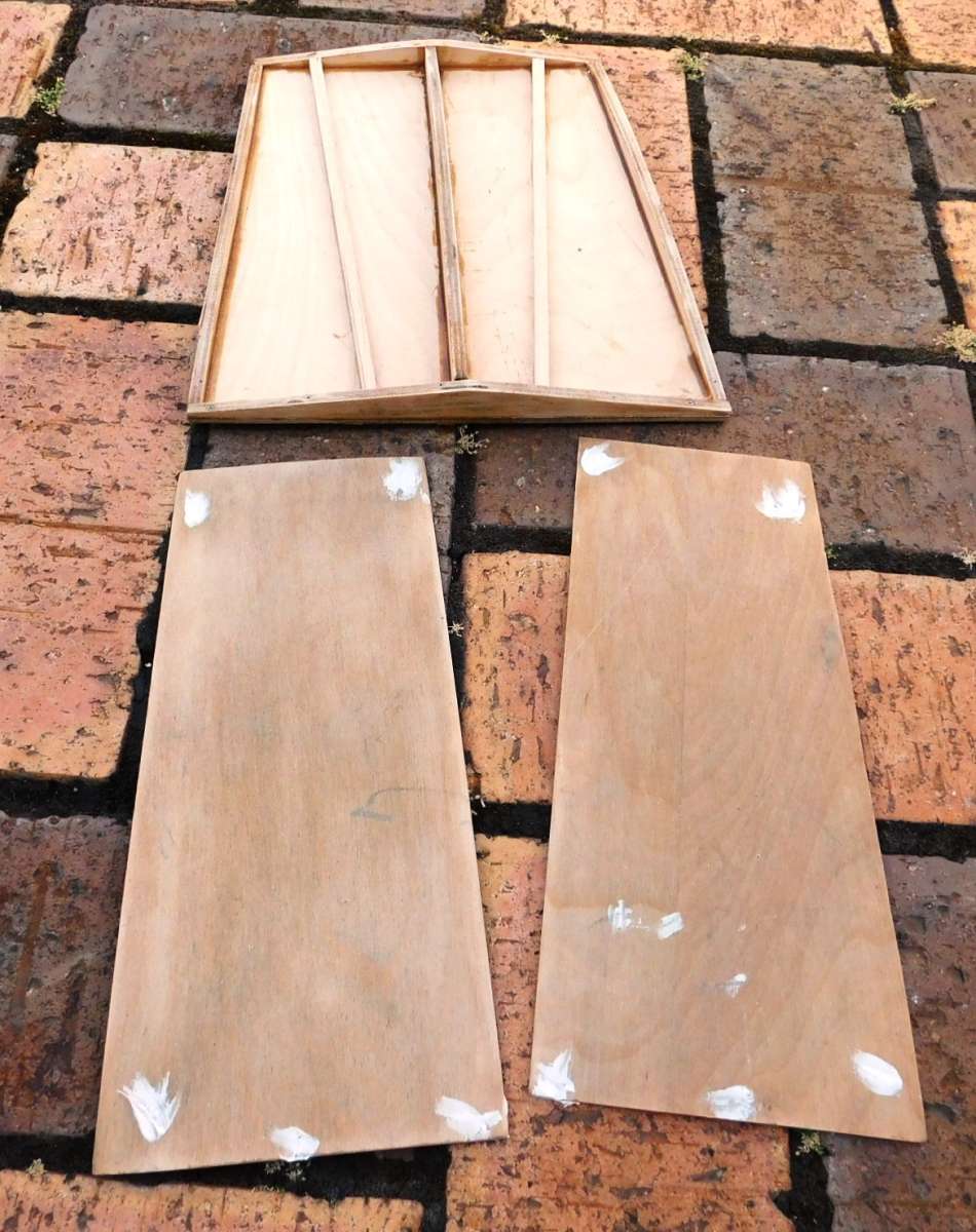

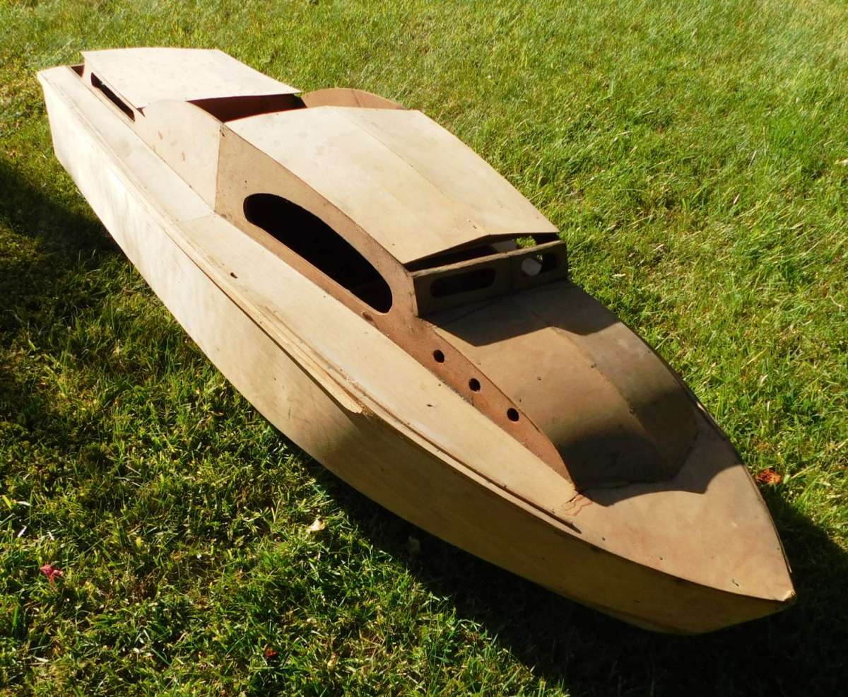

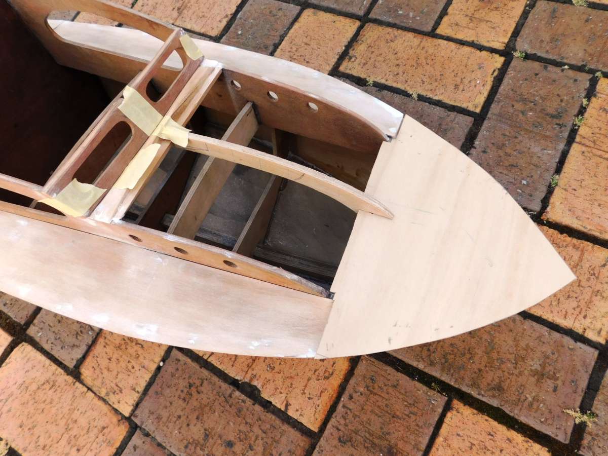

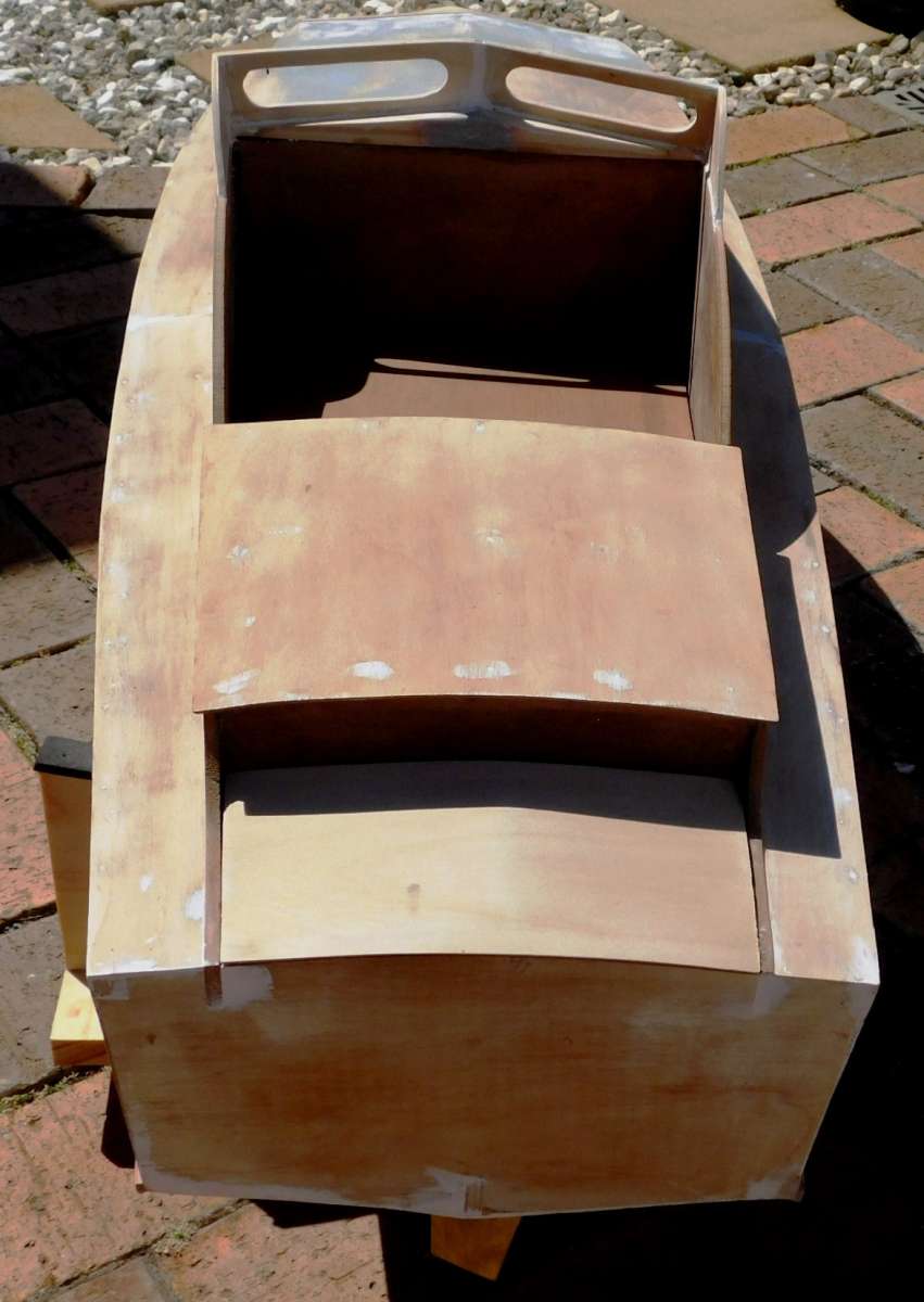

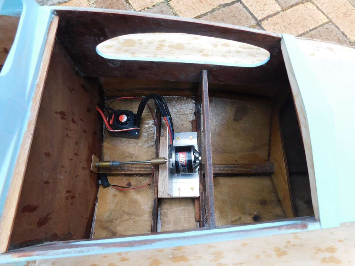

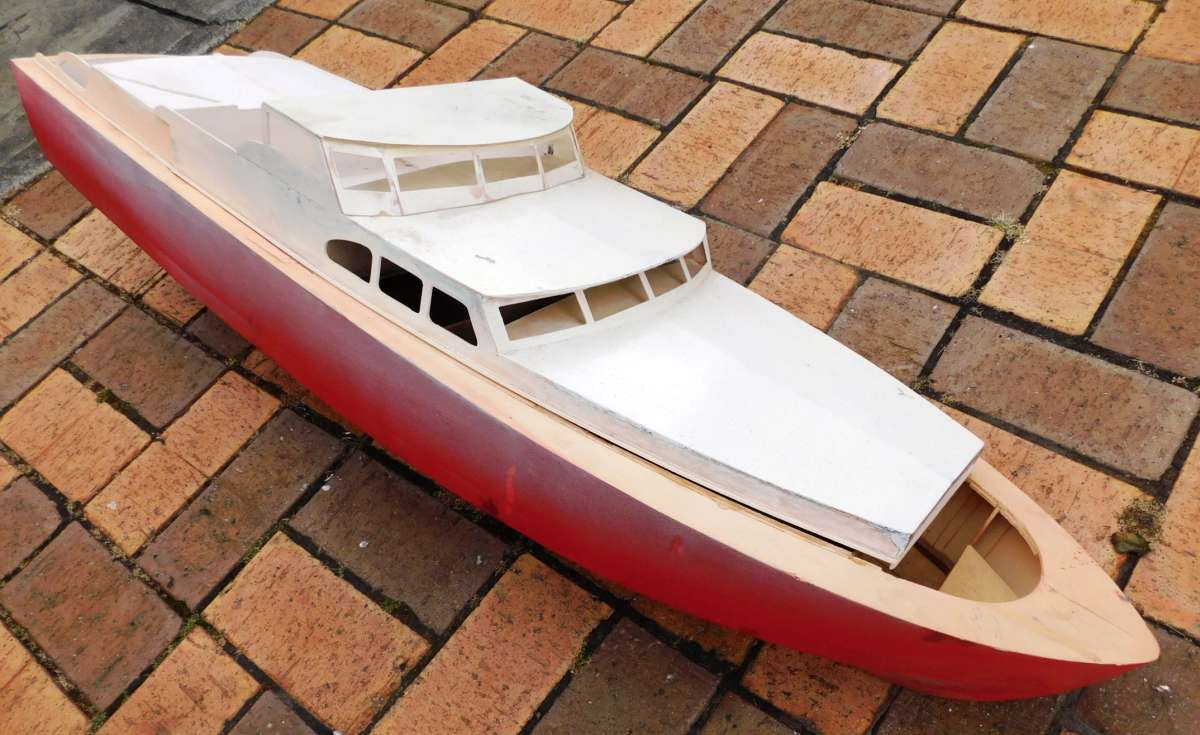

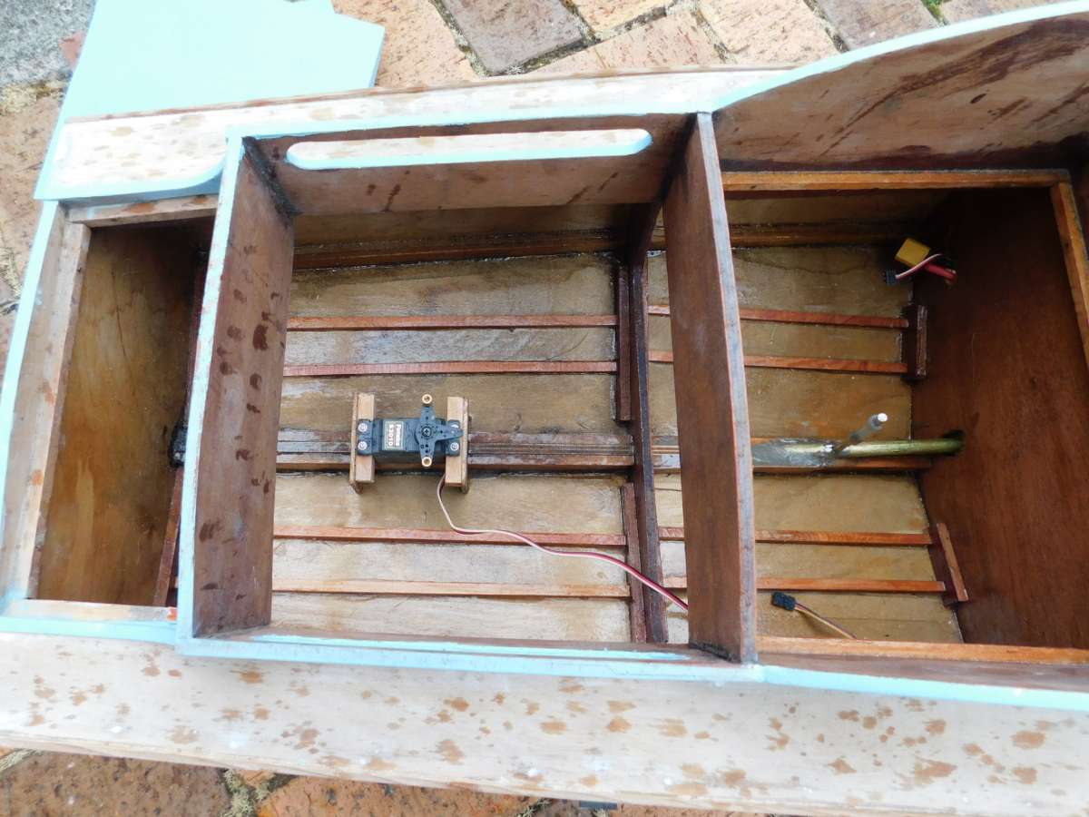

            HI All
            All the decks are off, cutout the bow section for reglue-ing as well as all the frames and stringers inside.
            Re-made the forward roof frame and added more timber to the back of frame 1.
            The new deck is going to finish at the back of frame 1 because that  I can save the deck skins.
            I have de-nail a lot of the boat and going to add chine rails to the boat.
            The motor is a Turnigy L5055C-700kv which I plan to run on 4S for about 10,000rpm with a 50mm CNC 3blade prop.
            I have started restoring the stern cabin roof, but the forward cabin roof is to be replaced.
            HarryTop ViewBow 1Engine bayMid ViewSide View 1Side View 2Stern cabin roof

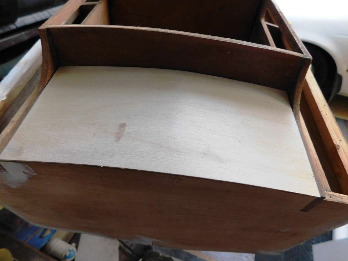

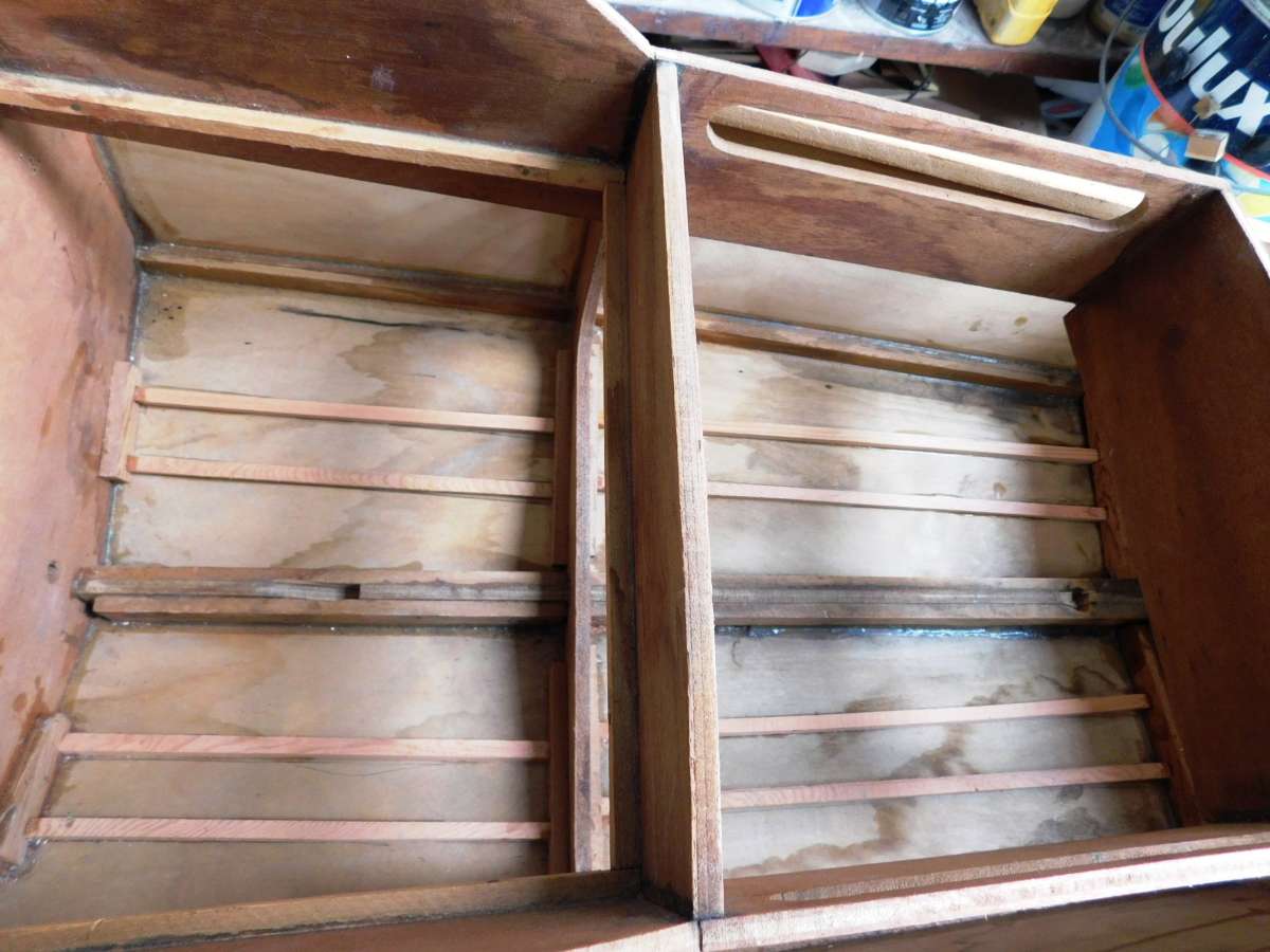

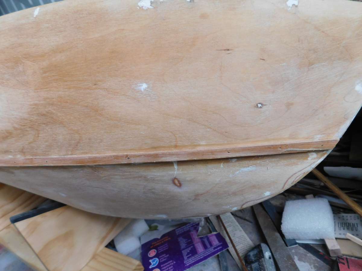

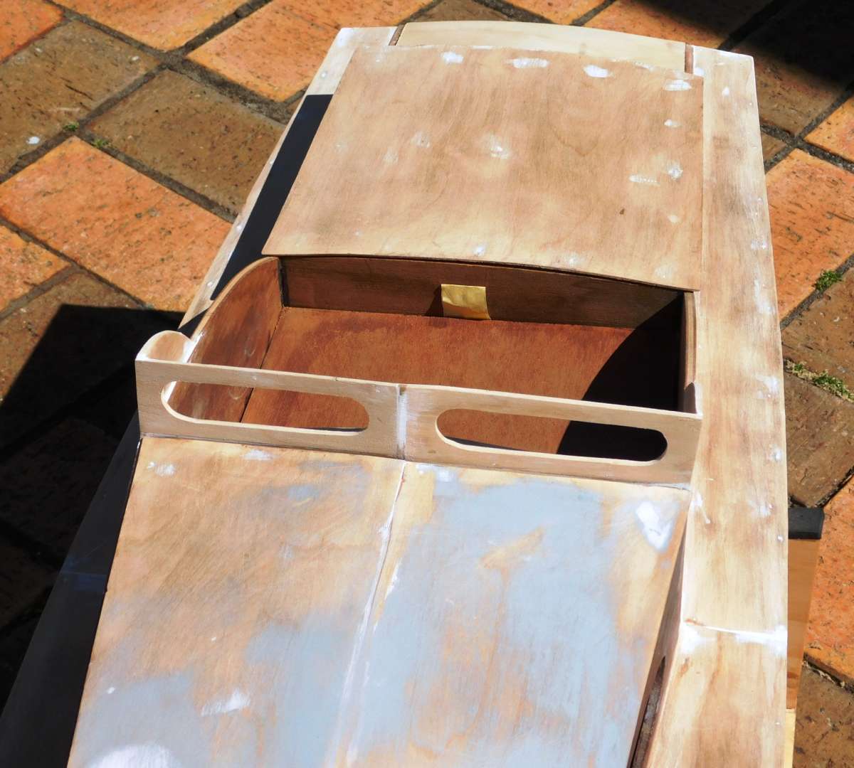

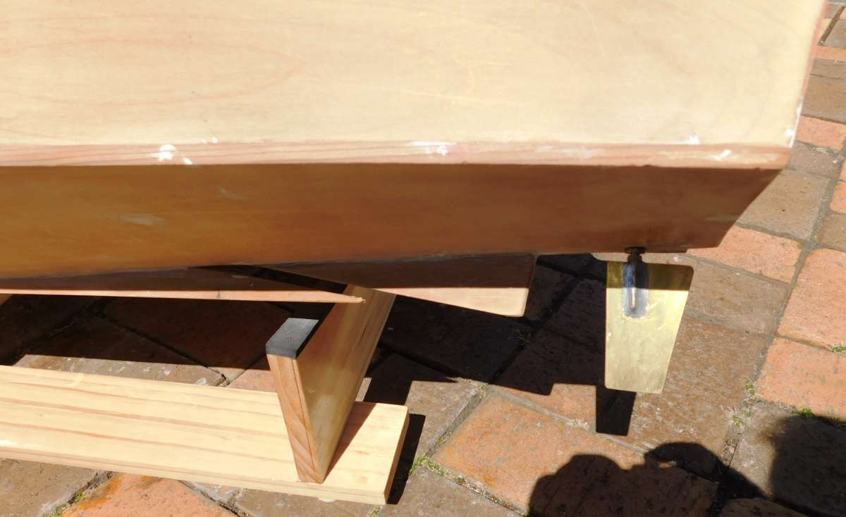

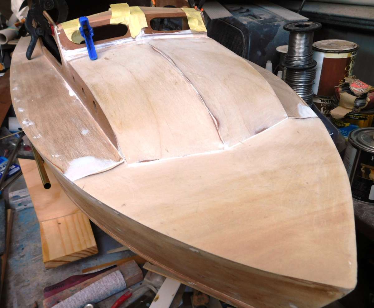

              Hi All
              A bit work on the boat with new forward deck.
              I was not happy with the forward cabin fixed roof, so I am making new ones.
              The stern bottom skins look a bit flexible, so I have add double stringers to the last two sections.
              The rudder hole is far to big, so that will be filled in and re-drilled later.
              HarryStern 2Bow 2ForwardCabin RoofBow 3Stern 1

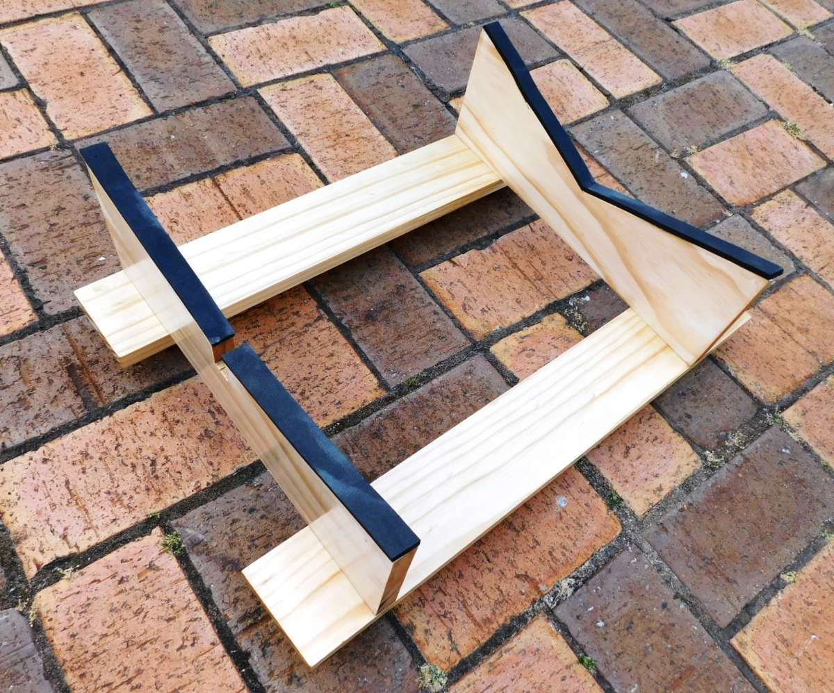

                  HI Richard
                  This one was just at the right point for finishing/restoring.
                  Only some damage to the bow.

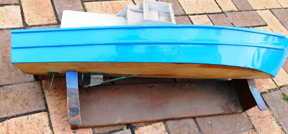

                  So I added chine rails, new forward deck, new stern deck(missing) and new  boat stand.Boat StandStern Deck 1Bow 4Chine Rail 1

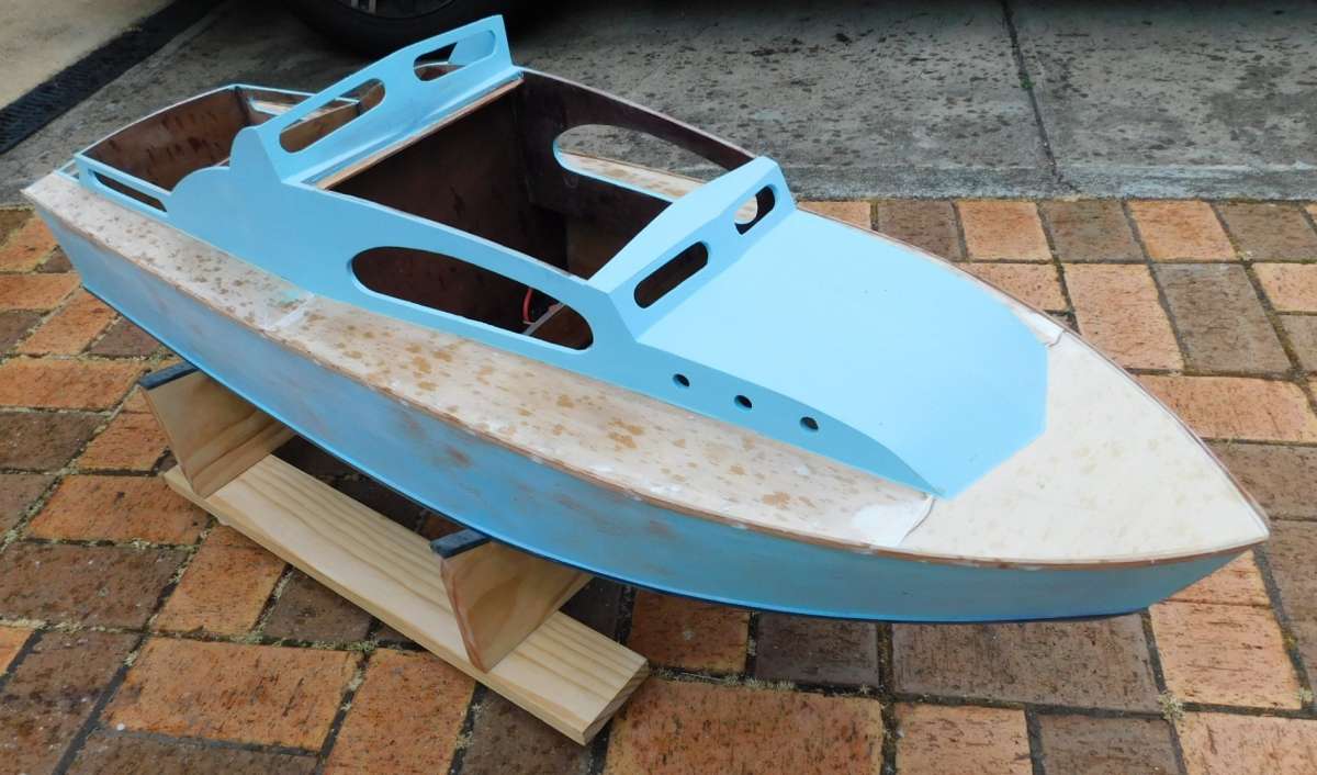

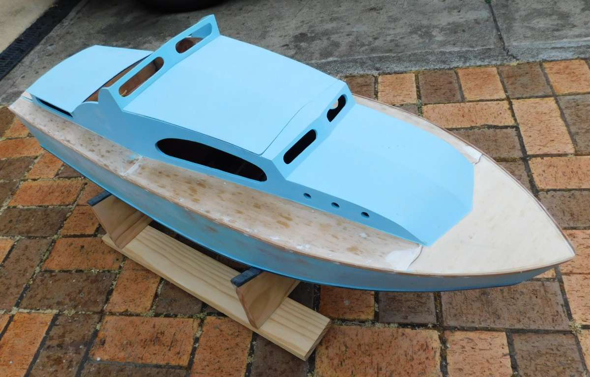

                  #128170

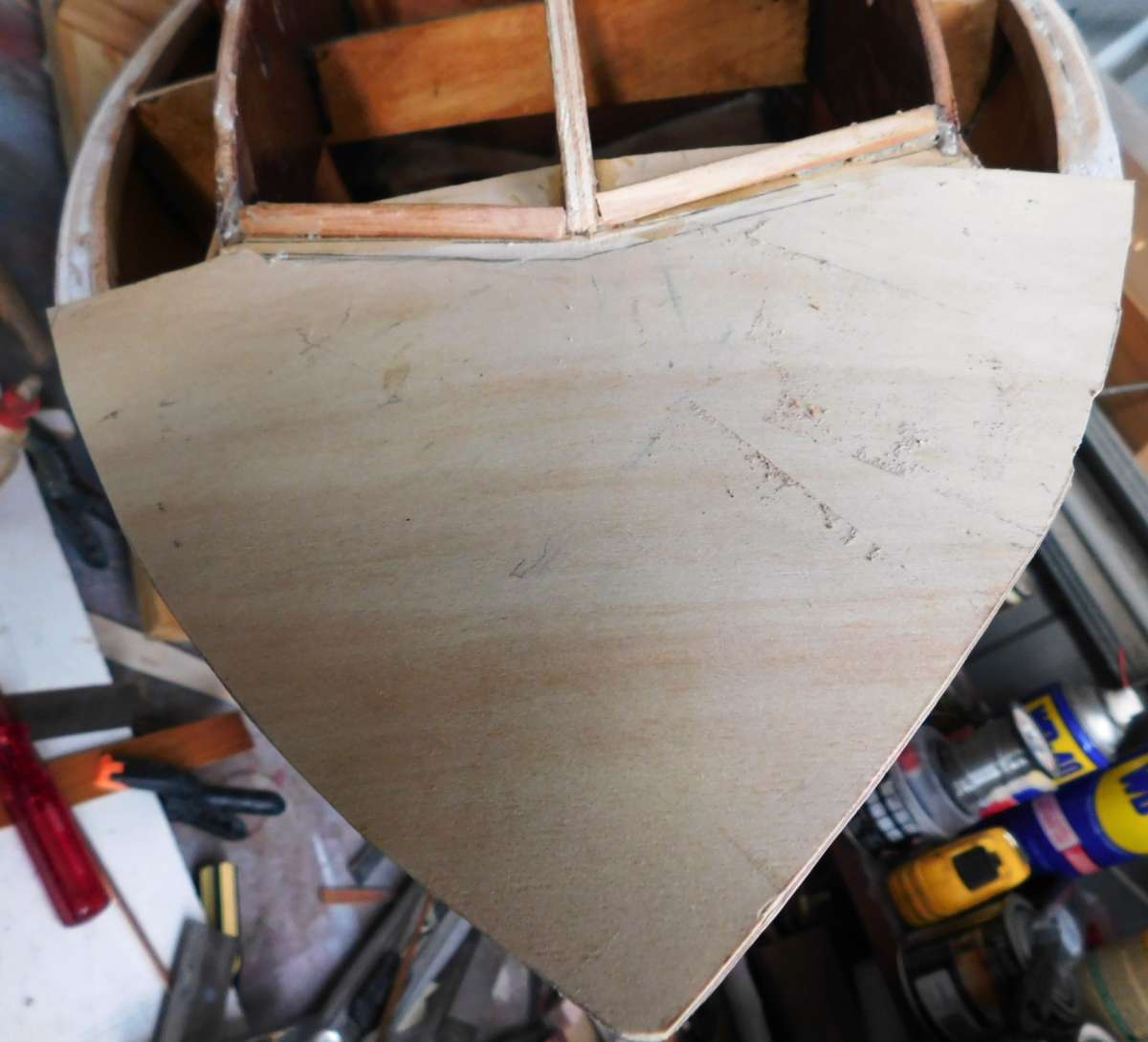

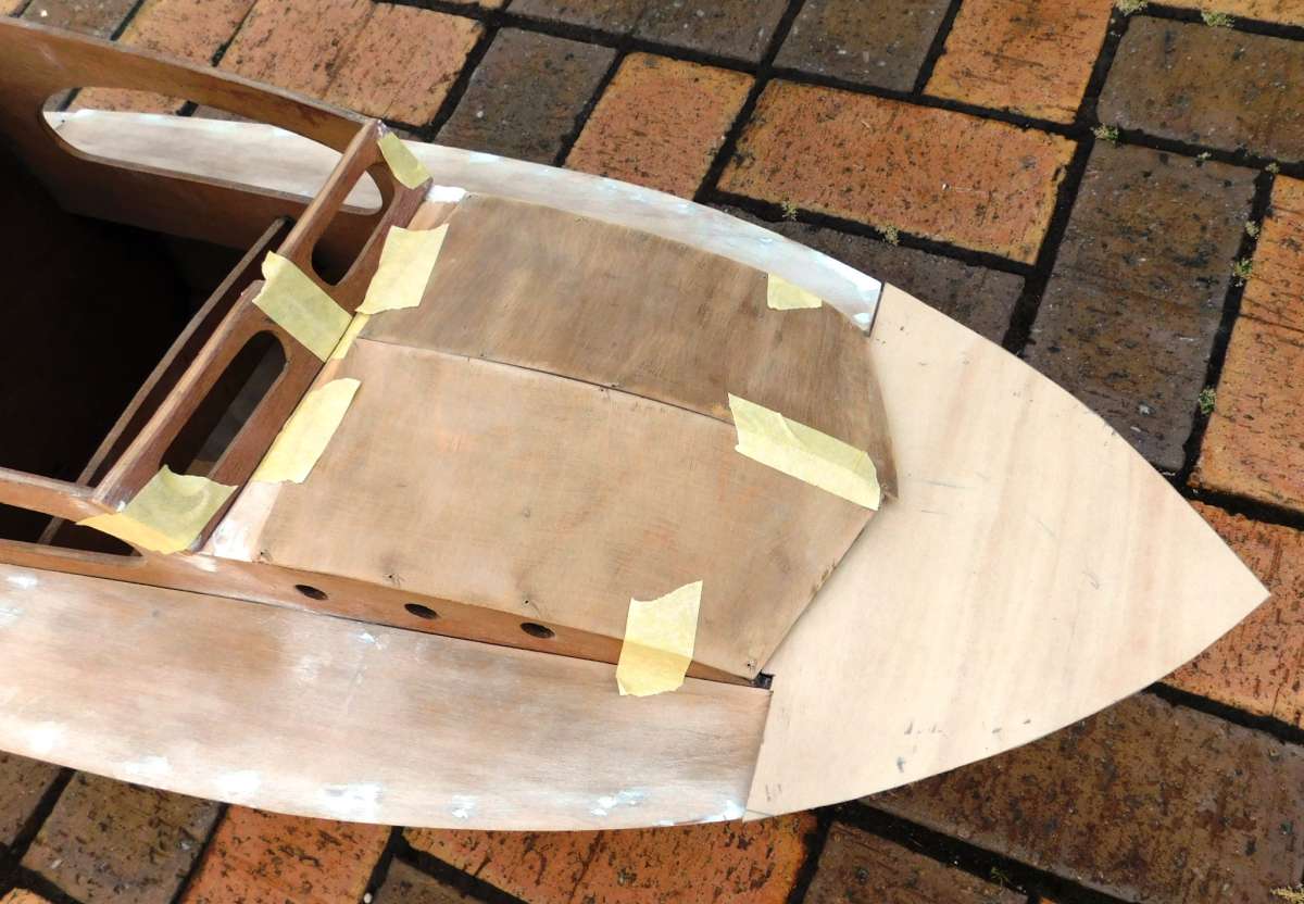

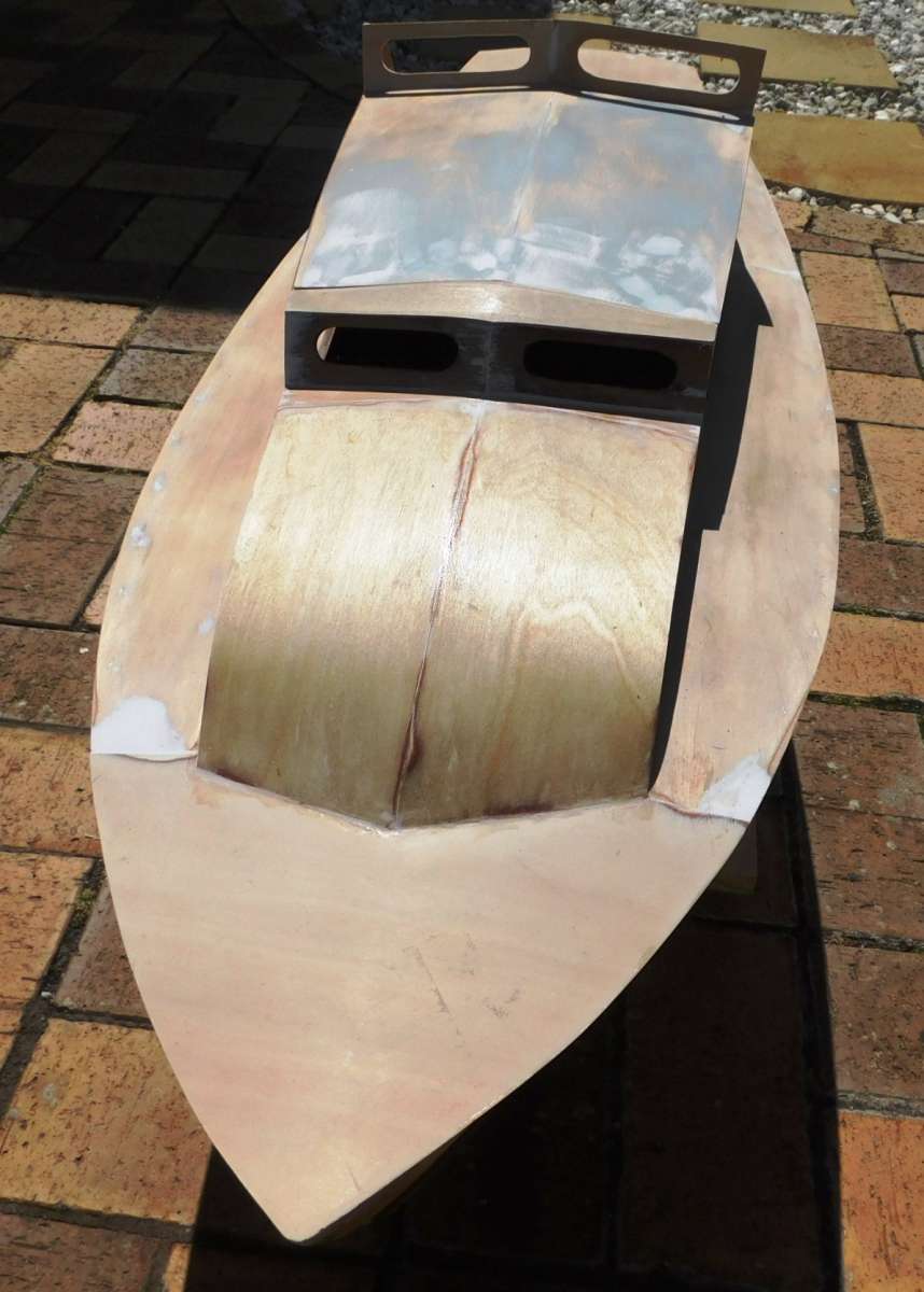

                    Hello Me Lads
                    As I have finished my number three Spearfish which is up and running.
                    It’s back to the old girl !!!
                    All the decks are back on and the forward cabin roof finished.
                    The middle cabin roof has had new skins with a little modification.
                    The roof finished in a Vee to match the wheelhouse window frames.
                    So it’s onto the wheelhouse window frames including the side support window frames.
                    HarryBow 5Bow 6

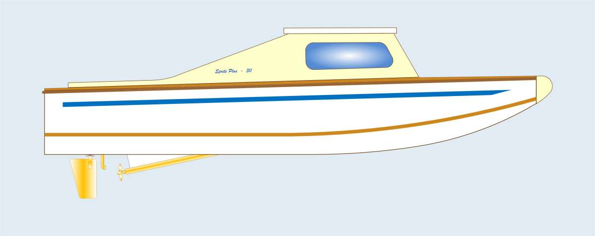

                          Hi Harry
                          I’ve produced some drawings for a bigger Sprite called the Sprite Plus for Bob/Zooma which he is at the painting stage now. I did think about building one with an outboard but have shelved that for now and might build one with a traditional prop but smaller as our lake isn’t that big.
                          Side View - Bobs

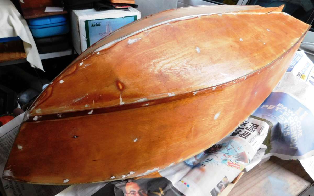

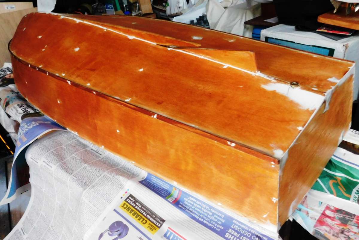

                                        Hello
                                        Well a baking hot 10C in Tasmania !!!!

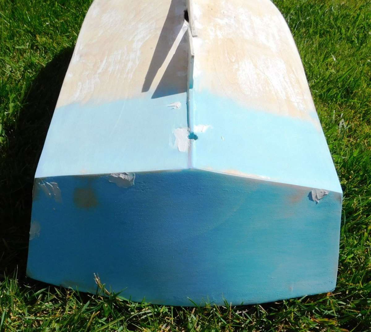

                                        Time to fiberglass resin to bottom and sides of the Sea Queen
                                        HarryHull Bottom 1Hull Bottom 2

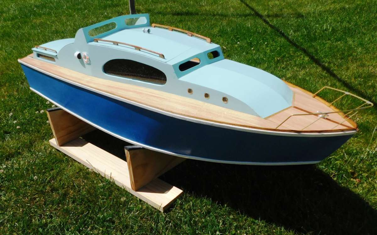

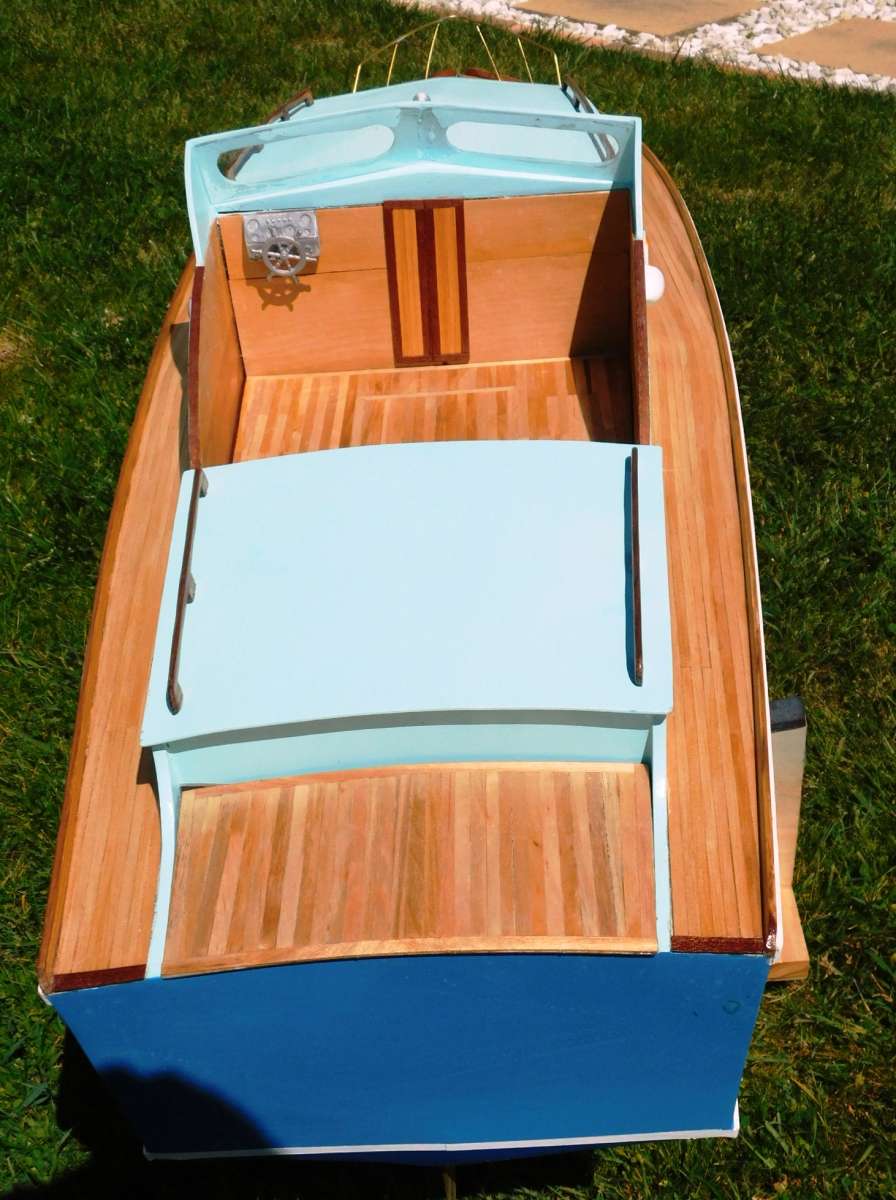

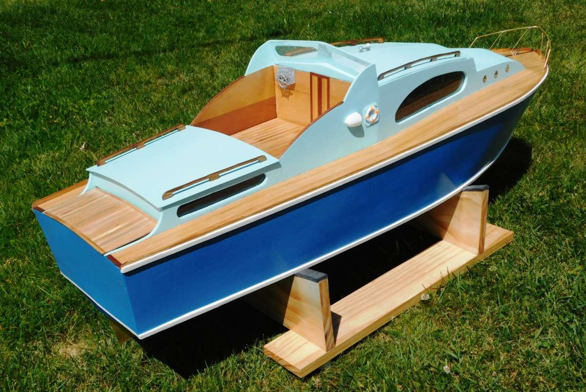

                                            Well the Sea Queen is finished and had its first run in very choppy water in the canal.
                                            Outside in the bay was white caps on the water.
                                            The lapped up the conditions with the chine rails working great.
                                            The boat turned both ways very well.
                                            So its going to get a workout is summer that has started in Tasmania.

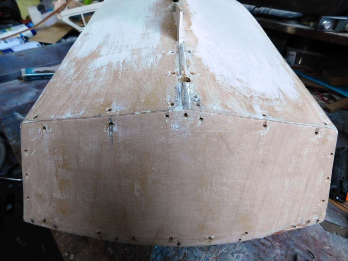

                                                Next Project is a Lesro Sportsman which has taken me a few years to find.
                                                This one has more nails in it than my coffin !!!!!
                                                HarryDSCN5136DSCN5143
