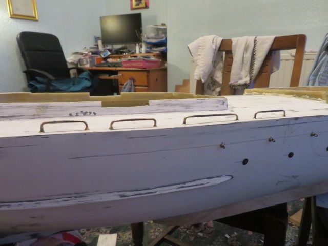

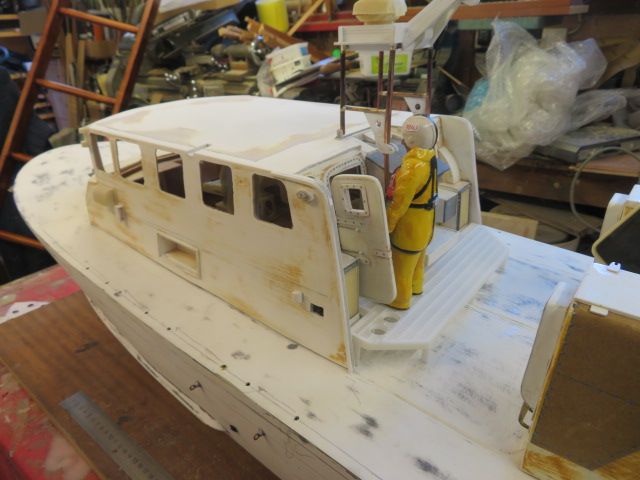

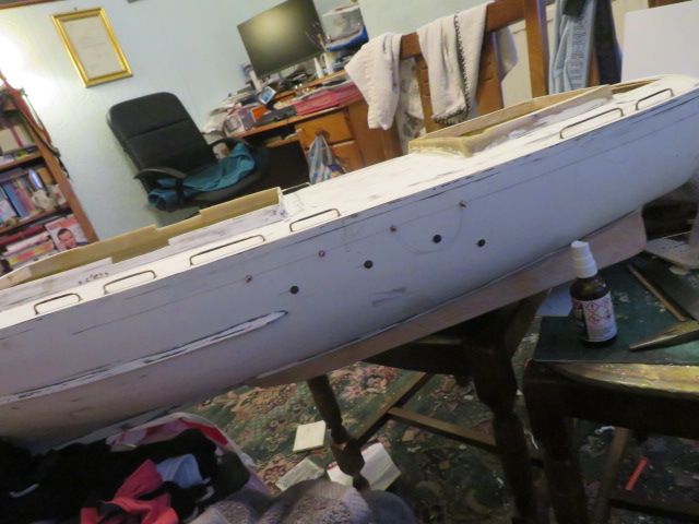

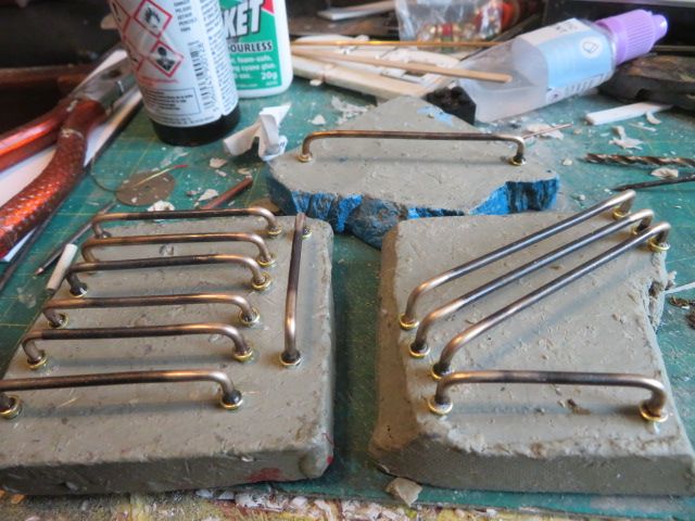

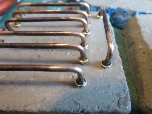

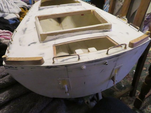

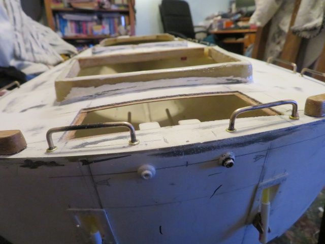

          small detailing is what goes to make a big impact.
          the toe rails have had their "feet" fitted. I used small grommits that come with servos in accessory packs…………..never use them on servos so collect and use for just such events.
          then o marked and drilled the deck to take them port and starboard. they are NOT equidistant as they follow the positions of the stanchions.
          however, just looking at the pictures of the real boats……………..I have missed two across the stern of the boat………so will rectify that in the next hour.
          #91106

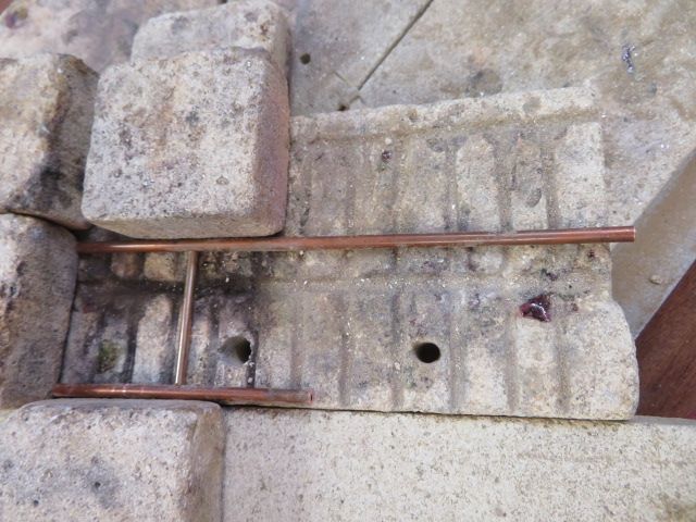

            that didn't take long………already had the brass rod annealed and ready to go.

              Excuse me, Sunshine
              Am I missing something here?
              Your handrails are absolutely stunning!
              But the hull is looking like a Destroyer thingy?……`ish
              I`m easily confused there days
              Nice workmanship BTW

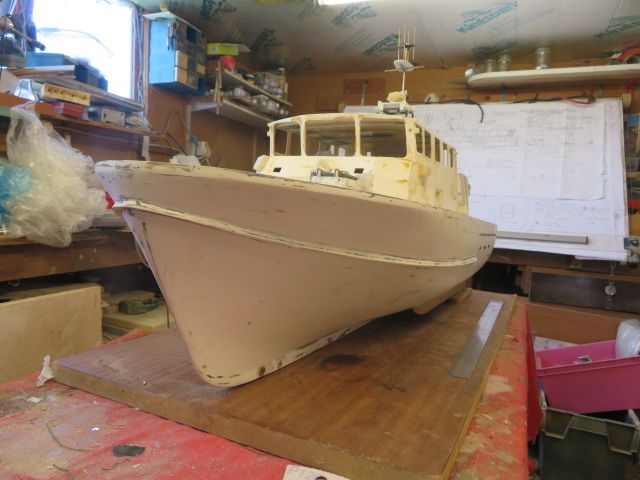

              #91111
                cant help the way the hull looks Bob………..they were built to withstand hurricane force weather, and did many times in their lives.

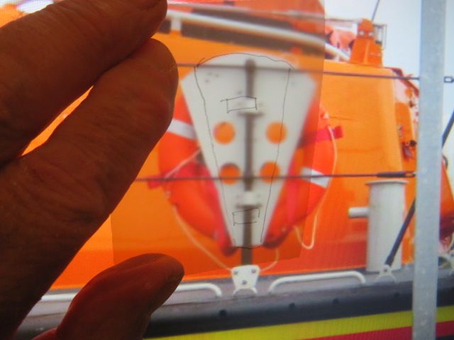

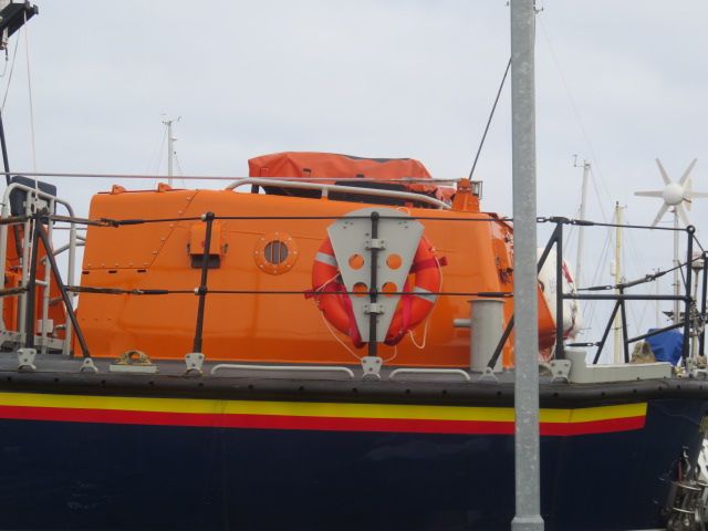

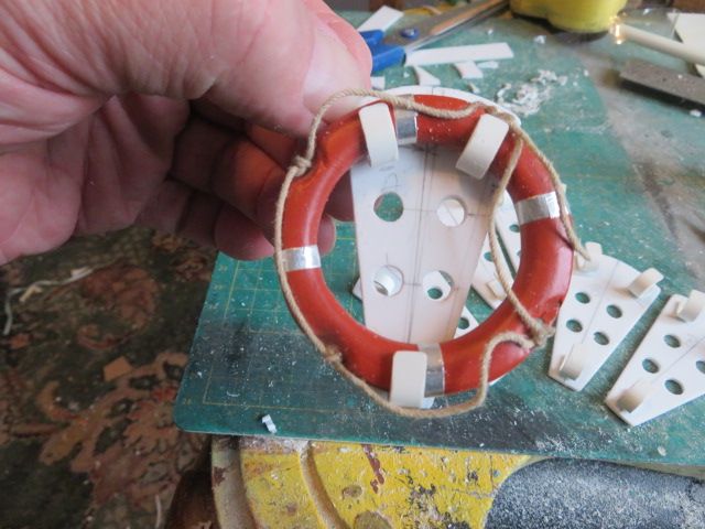

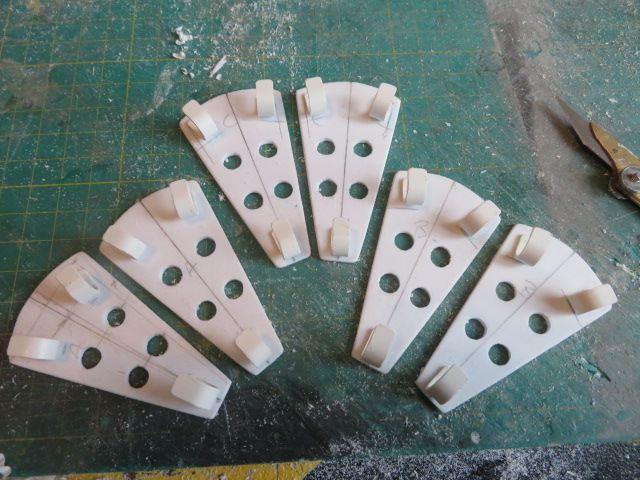

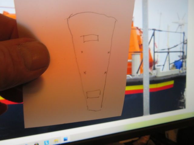

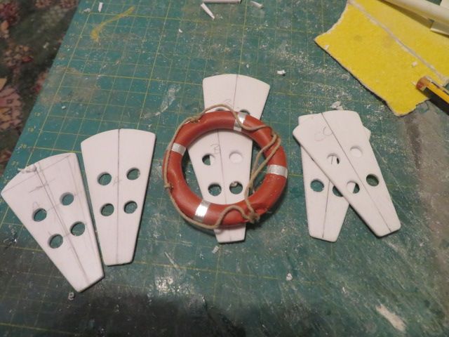

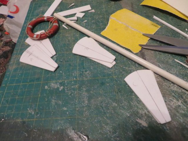

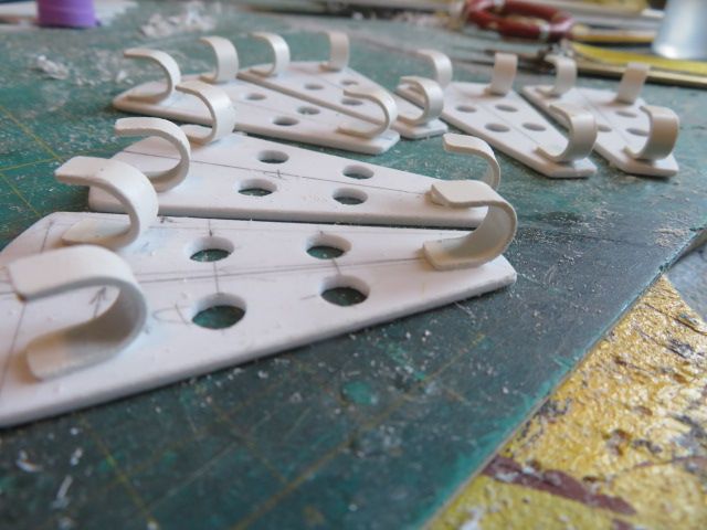

                  plasticard out tonight……
                  made the backing plates for the life ring brackets which attach to the stanchions.
                  you might think I have gone mad making 3 pairs………..NO lifeboat of modern fast era carried 6 lifebelts as far as I know, on deck….
                  NO!!!
                  Seeing as certain modellers have worked a fast one on me and I am now building [ or should I say renovating] a certain members Mersey class lifeboat, and another person of repute[or should that be ill-repute] has asked me to fabricate the rear end of his new cabin as well, I thought I would whilst making one set, make all three sets.
                  took a rough tracing from the plans I had and then offered it up to a picture of the plate from a Tyne that I enlarged on screen.
                  marked the positions of the holes, and tomorrow I will find some tubing to use as the brackets which hold the life ring to the plate.

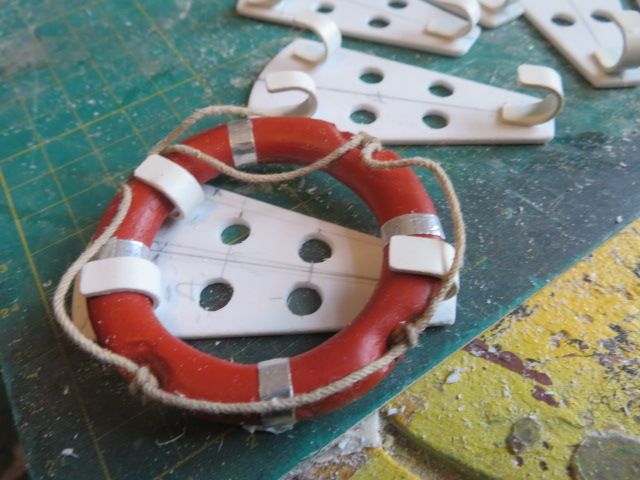

                      the plates are now sporting the new brackets. these were made from slices of the plastic oval tube that comes as a weight in the bottom of a roller blind…………the exact size to locate the life ring.
                      like they say on Blue peter……..here's a life ring I made earlier.

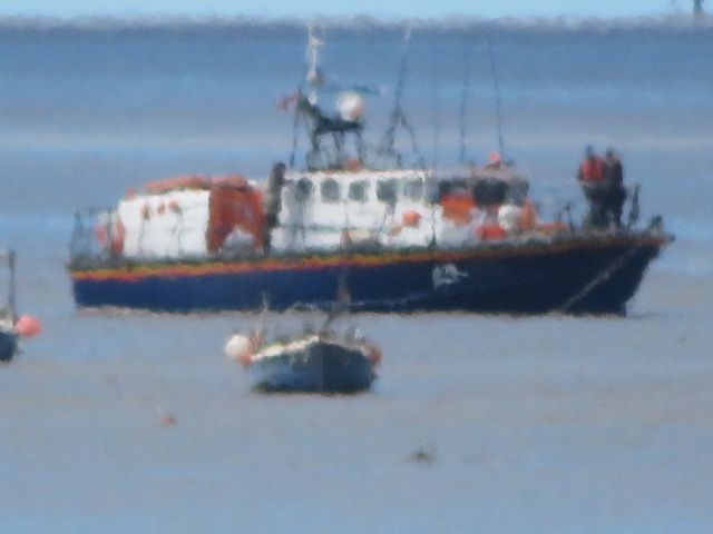

                        the lengths one goes to for photos to build………and all things go tits up.
                        on Friday, I went to Glasson Dock to see if the Tyne lifeboat had gone in to the water yet…….errr NO!
                        Last night a picture appeared on Lifeboat Enthusiasts, showing that she had gone back into the basin either Friday afternoon or Saturday [ yesterday].I have asked permission of the poster if I can put it on here, and waiting for a reply.
                        so this morning to get some deck level and possibly even inside cabin photos of her.
                        pulled up at the spot where the photo of her was taken yesterday……….the old girl had done a disappearing act,,,,,,,or were my eyes and brain deceiving me and I hadn't seen the photo last night. got around to the marina, parked up and started walking to the marina office when a guy said to me pointing to the Mersey emblem on my fleece…………"one like that went through the locks and out to sea about 90 minutes ago"…….
                        jeese….. I couldn't believe it, 18 bloody months i'd wanted to photograph her deck level.so went to the docks marina office to ask where she had gone.
                        "Lytham" was the answer.."to the museum" they said.
                        so, I thought……..trip down to the creek at Lytham…….she might be tied up against one of the berths…….
                        drove down to Lytham and the "creek" was all locked up behind steel gates.
                        the RNLI Lifeboat station I thought, there's a small jetty there, she might be berthed up against that!……..of along a visitor packed prom and parked up close to the station, where [I thought] fortuitously the main doors to the station were open, and I thought I would ask. one guy was busying himself detaching the charging leads to the D TYPE as I started to chat, and he said can't talk now mate……….as I realised they were on a shout.[hope you guys got there in time and I didn't hinder you too much].
                        so I went up on the prom and looked out towards the estuary entrance to find the Voluntary Worker being tied up to a river mooring.
                        thwarted again…….will I ever get photos of her fore cabin aft section and interior!……..what a waste of motoring time and diesel.
                        so all I managed to get was her mooring up at the mouth of the Ribble, in a few distant shots.
                        the quality of photos isn't the best, but she was about half a mile from where I stood, with only a little cannon point and shoot camera

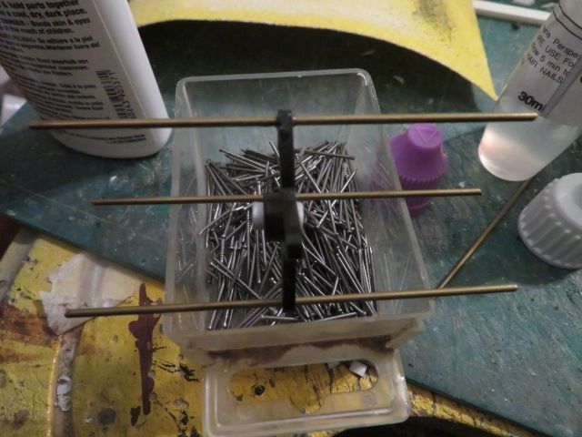

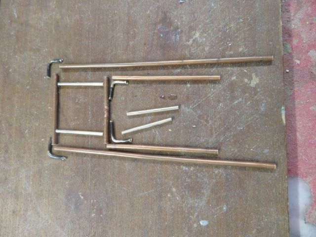

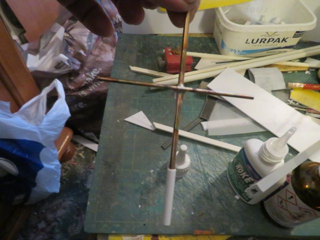

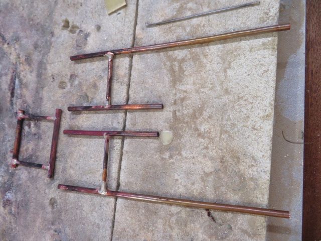

                          today, I set too, cutting the tubing and solid pieces for the main mast on the tyne.two and a half hours cutting and filing to length and just 15 minutes to silver solder all parts together.I'll finish it tomorrow by fitting the brackets and lugs to take the rams for folding down, and then on to the radar and light platforms
                          img_6261.jpgEdited By neil howard-pritchard on 31/08/2020 21:24:54

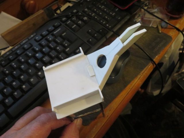

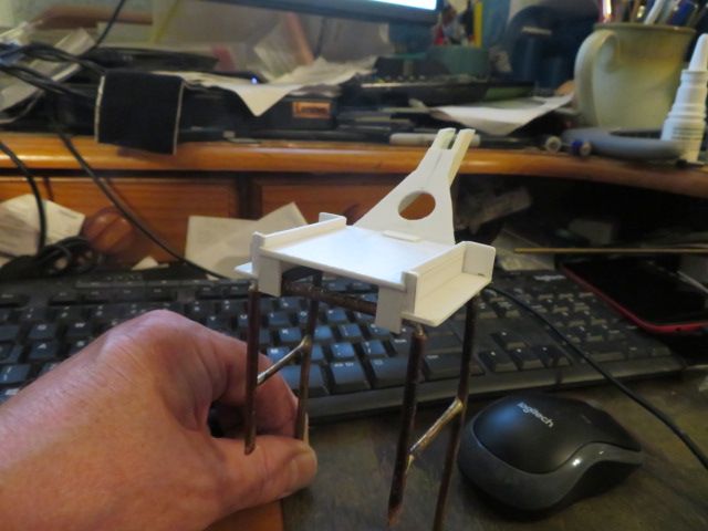

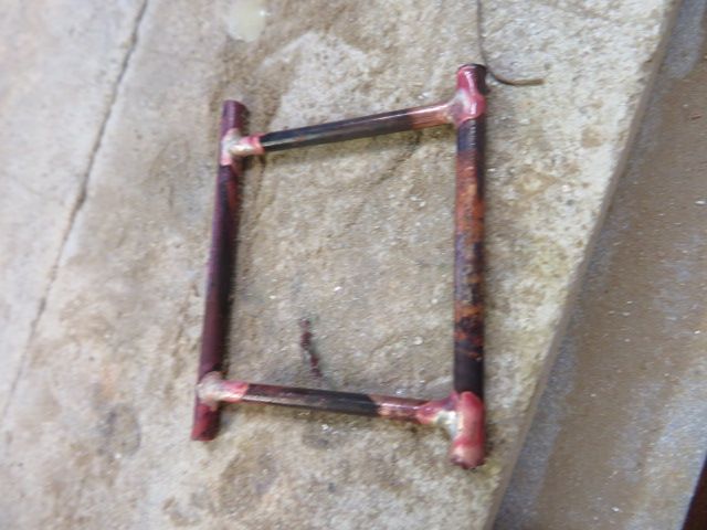

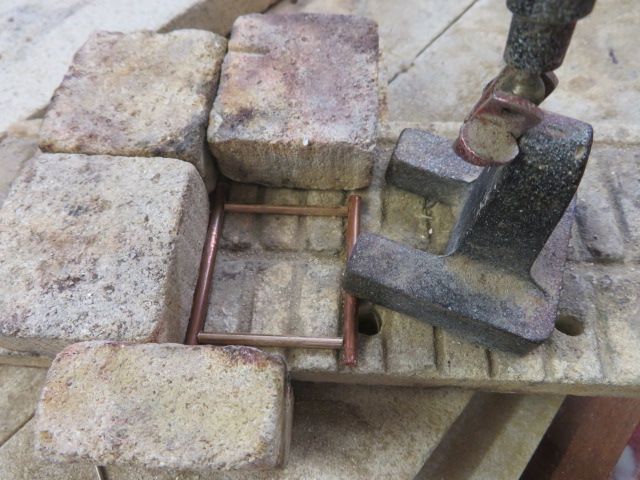

                                the main mast including the "backbone" for the main mast have all been soldered together now.
                                on with the radar platform and the main mast light platform tonight.
                                #91237

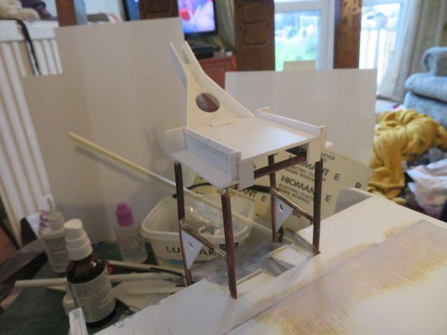

                                  radar platform, light platform and mast are on their way to being fabricated…..these will be finished tomorrow

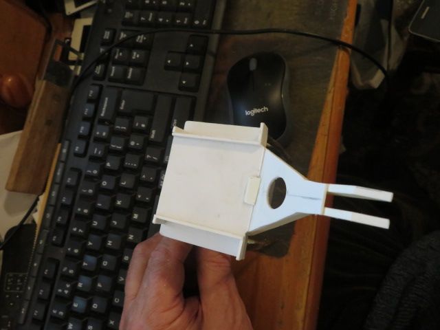

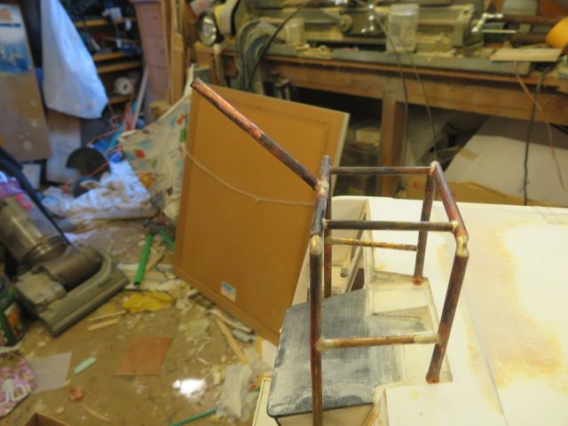

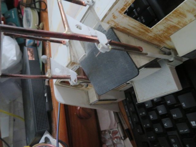

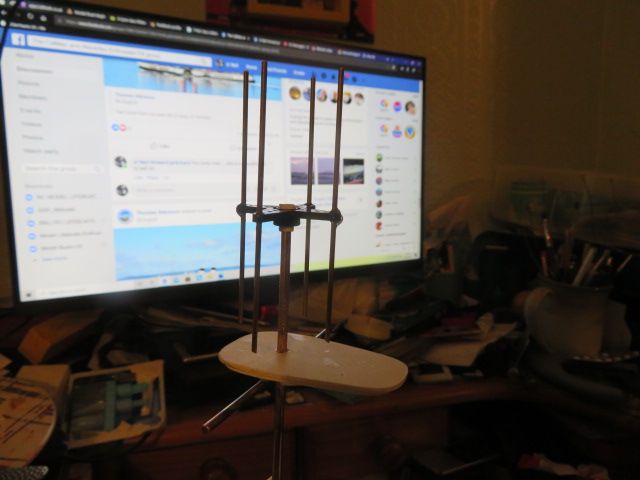

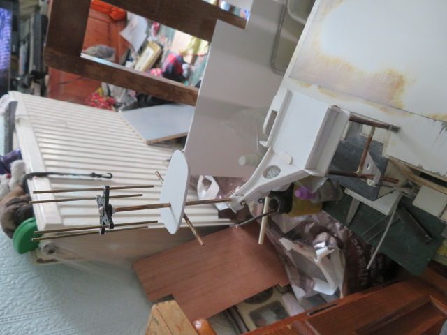

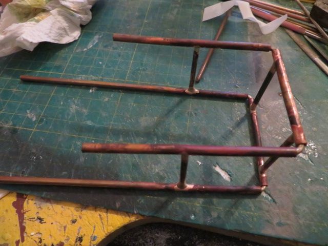

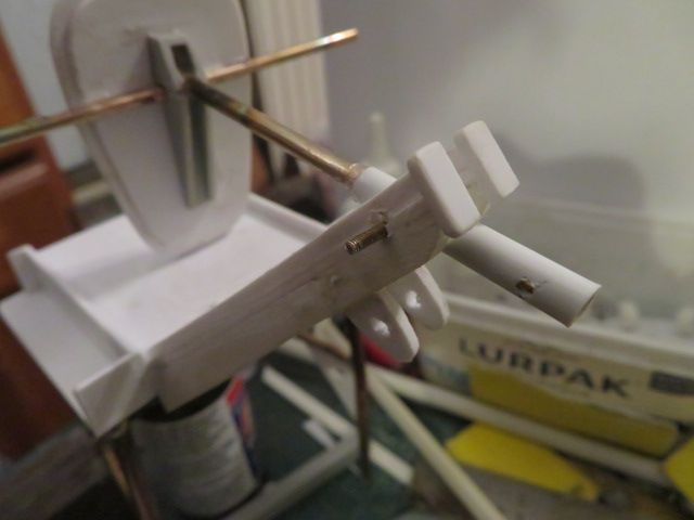

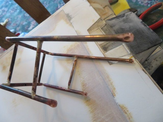

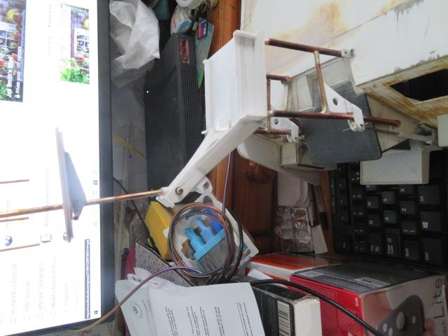

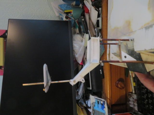

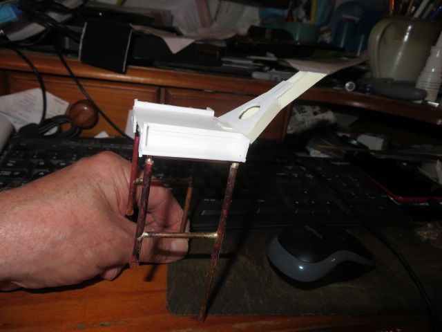

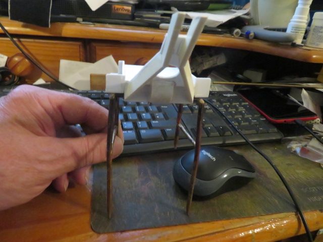

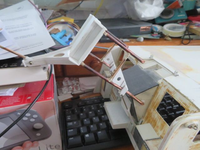

                                        The TYNE folding mast has come on a bit since the last set of photos of the basic radar trap.
                                        I'll just show the progress in photos except to say that the main mast was constructed using brass tod, plastic tubing preformed plaststruct square section moulding, and the pieste' résistance was an inspiration of Neil Huyton which was the cross bar for the DF arial.It was made from Neil's idea of a star servo arm. The holes I will fill with plasticine [ it paints very well and doesn't need sanding flat like filler.And the receiving aerials will be cut to length before gluing in place. The mast will, once I fit the brackets for the hydraulic rams, be completely folding.img_6281.jpg
                                        #91268
                                          #91273
                                            Very nice and tricky, Neil
                                            What is that illuminated wall chart thingy?
                                            It looks like a scene out of a James Bond Film?
                                            #91276
                                              just my computer screen Bob………..nothing MI6 or anything like that lol.

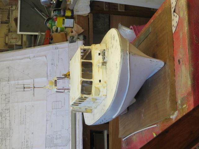

                                                the main mast for the TYNE is now structurally complete with the brackets fitted to support the top ends to the hydraulic rams that raise and lower the mast.
                                                however,. I will NOT be motorising it as a special effect….too much hassle for the small WOW!! effect that it might bring………….lights will be good enough for my lack of electrical capacity, lol.
                                                the mast can now be separated from the main cabin and painted and eventually wired up for the lighting.
                                                the cabin and hull are ready for going to Dave Stavros Jones when he is available to meet, and I will get on with some casting of fittings for my boat's fittings.

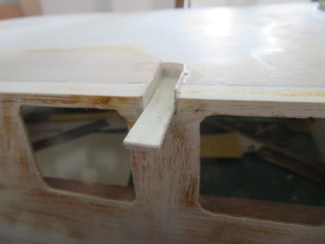

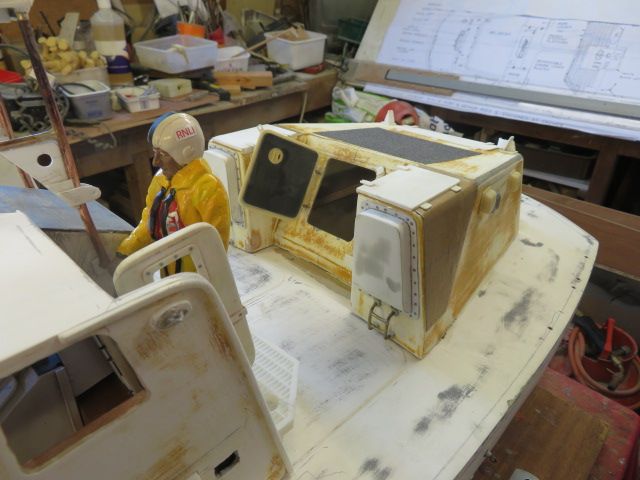

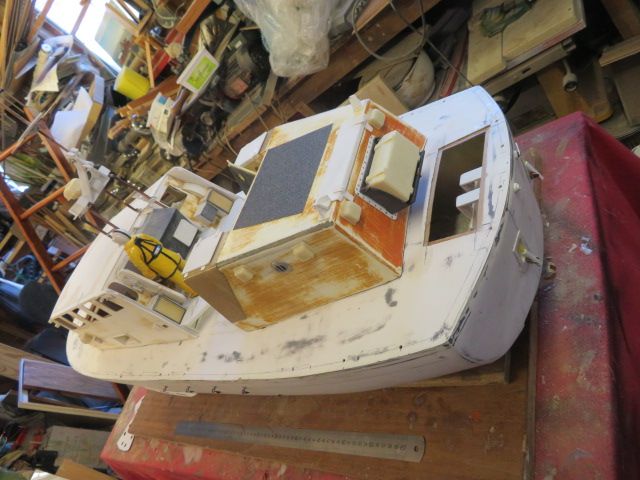

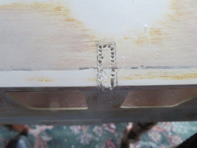

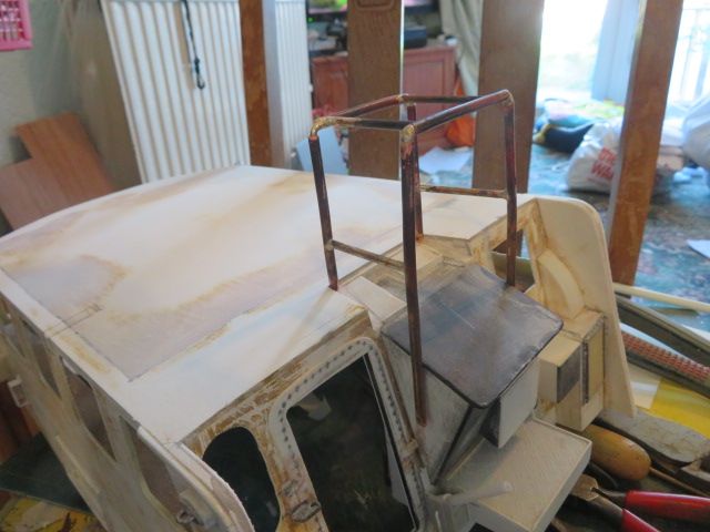

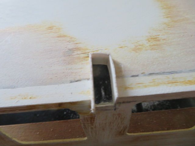

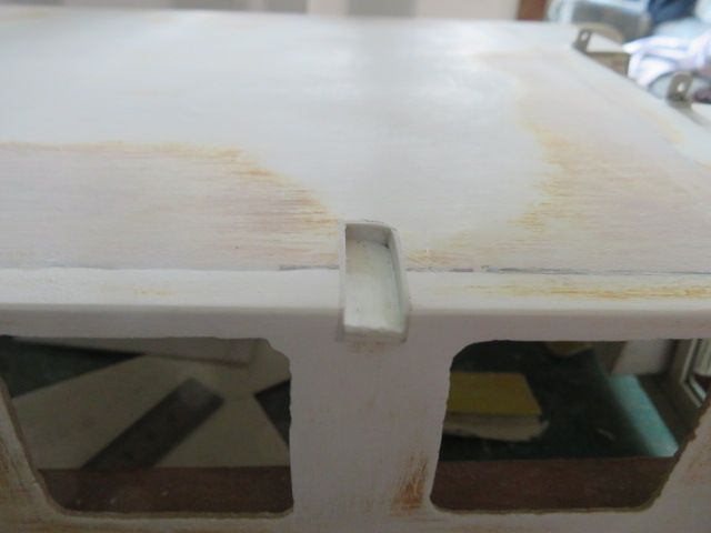

                                                  as I am building a model of our own lifeboat at Fleetwood I want to try and get the model as close as can be to our old boat.
                                                  one of the little quirks is a cut out in the top of the superstructure on the port site……..
                                                  I don't know what purpose it serves, as all I can see is a DF aerial set into it, and yet all other aerials on the boat are just set onto the roof of the cabin.
                                                  I have also noticed that this same cut out is on some of the class but not on others as far as I can see.
                                                  I cut out the top, filed it to shape including the curved corner on the rear straight, but 90 degree angle on the forward "wall"
