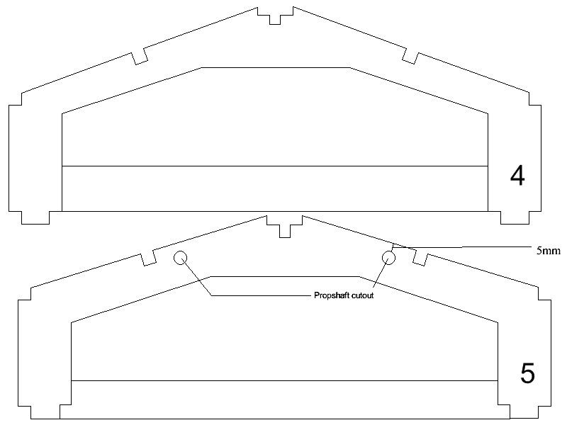

        Which former is showing the proptube emerging from and how far from the hull floor is it?
        #58167
          Here you are Bob
          These are the drawings for Frame 4 and Frame 5, you can see the propshaft holes in F5 and the clearance is 5mm

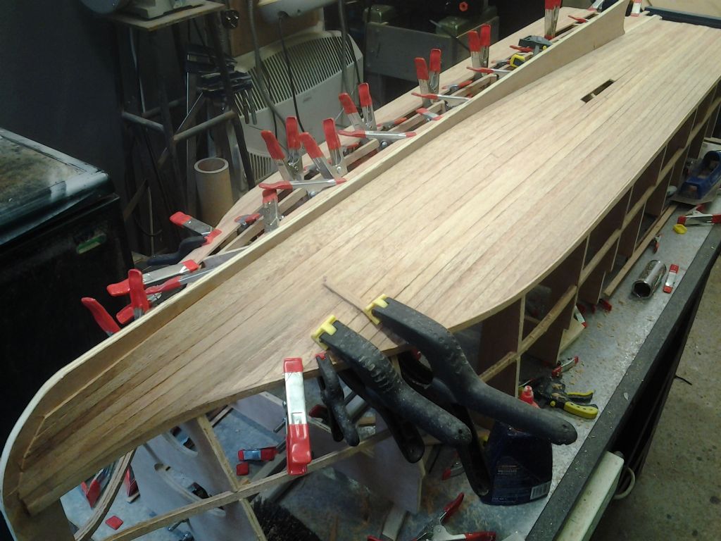

                    Ralph Pinch
                      @ralphpinch41762
                      Now the problems start, fitting first of the side planks and "snap" ,try again and "snap" even when its been in a steam tube for ten mins,
                      then I made this tatty jig and steamed the plank as I slowly bent it around, problem solved but very very slow, should have Siadwell finished for Haydock……………2016.
                      #58219
                        Ralph
                        Try soaking the planks in hot water [not boiling] for 5 minutes.

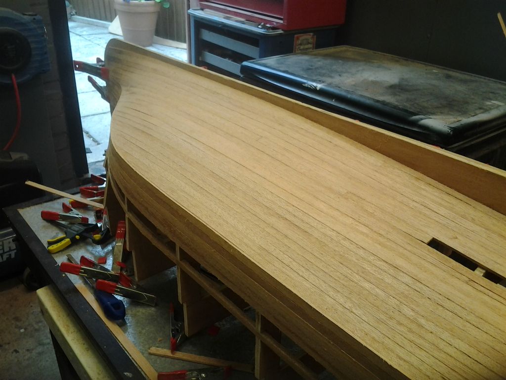

                        Ralph Pinch
                          @ralphpinch41762
                          Starting the side planking, this batch of planks are very brittle and snap very easy, slowly,slowly, catchy monkey.

                            Very nice, Ralph
                            I can see the need for a lot of filling and rubbing down……….If you intend to paint the hull
                            A varnished finish would hide the planking lines better…….How did you finish your MSC hull?

                              Ralph Pinch
                                @ralphpinch41762
                                Hi gents,
                                the planking todate, is coming along nicely looking better as I start the sides, its not easy but very rewarding.
                                The planks are quite even but as you say Bob will require sanding, as of now there are no area's that will need any filling, Paul's plan has worked perfect and the hull has beautiful contours, just needs me to blend together.
                                Sanding to me is therapeutic and will be done the old fashioned way by hand, once spent three weekends turning rough cast BMW bike engine and gearbox case's into highly polished show piece's for a 50's bobber, so I am used to repetition.
                                Planking is not easy and slow but very, very satisfying and yes if I paint the hull the plank lines will show but to be honest I quite like the idea of this, it is as the original was made and would possibly add authenticity.
                                Varnishing would be too much I think unless the super structure is white.
                                Slowly, slowly, catchy monkey is and old colonial expression, soldiers of the empire used to try and catch the animal's to keep as pets but lacked the patience and agility, they had to be shown how by the native's

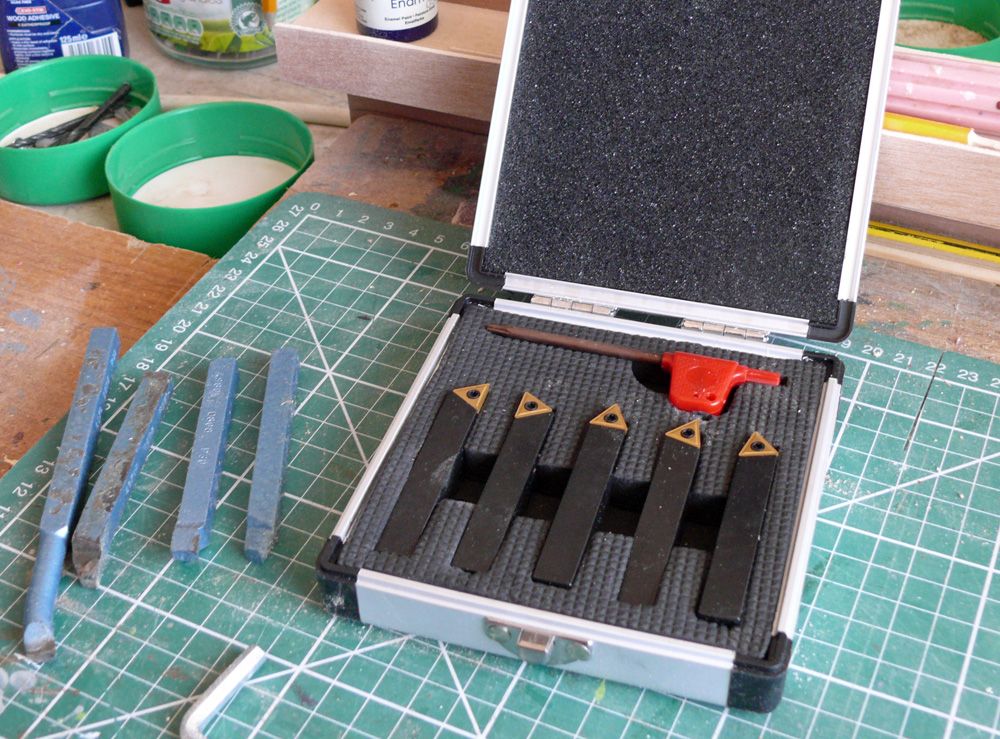

                                            These lathe tools with loose tips are nice to use
                                            £48.00 from Amazon……..May be cheaper at the Chester Show?

                                              they look good Bob, what shank are they and are the tips readily available, will be taking a trip to Chester to see what's on offer, did you get your linisher from there?
                                              #58322
                                                Hello Ralph
                                                The shanks are 10mm square
                                                The tip a are bound to be plentiful
                                                I bought the Linisher from B & Q about 10 years ago……An essential piece of workshop equipment
                                                I use 36 grit belts
