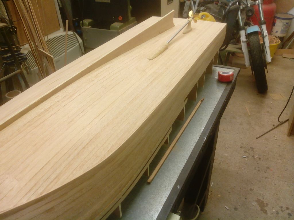

        Hi Bob, having problems with my PC, hoping its fixed now.
        Working on the propshafts now.
        #58753
          Nice quality workmanship, Ralph!……..Well done
          I really do like the planking too!…………..It seems a shame to paint it!
          Show us some more please?

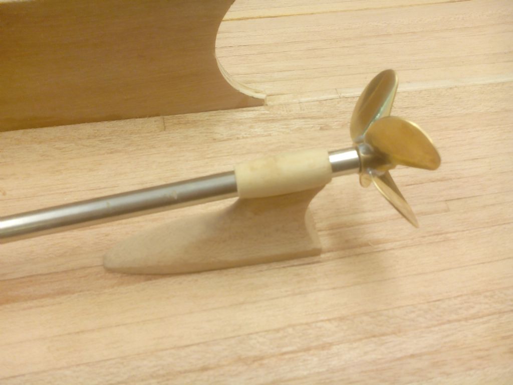

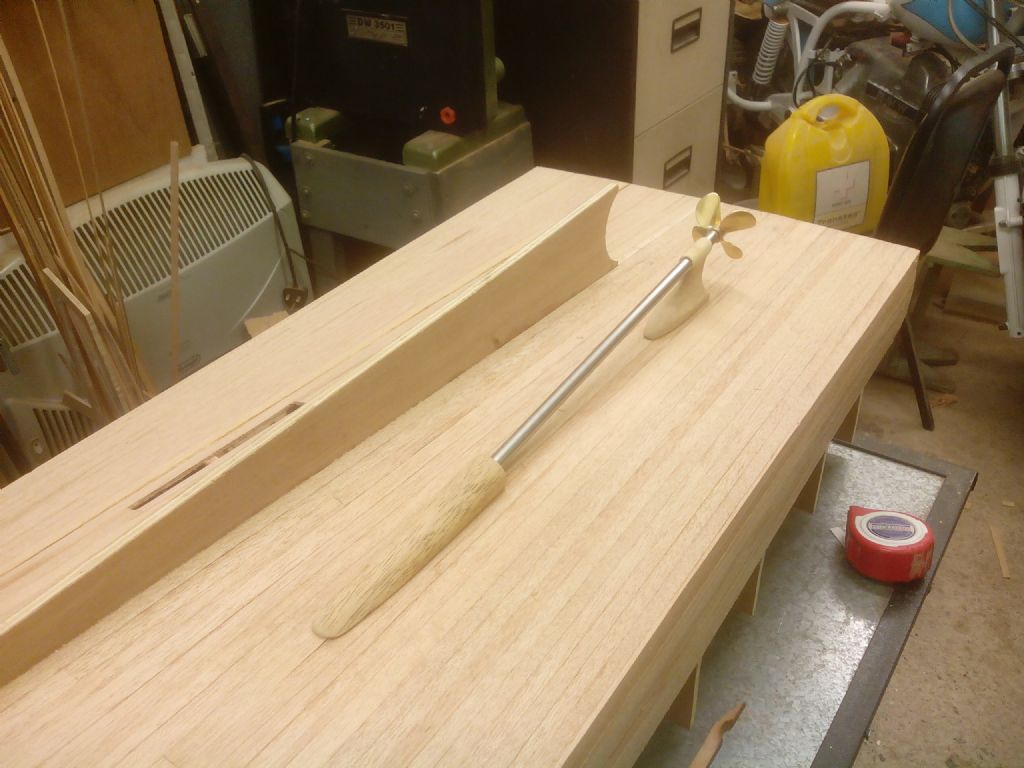

            img_20150627_081846.jpgthanks Bob, here's a couple more,img_20150627_081853.jpg
            #58760
              Thanks Ralph
              Very nice too!
              Are you using handed props then?

                kind of you Bob, it will be a shame to paint the hull, I will see how good the planking is after sanding and decide then, if I varnish, if it looks wrong when completed I can still paint the hull but not the other way.
                I am using opposed props, there seems to be very little difference to either setup so just got left and right as both were the same price.
                Good luck for the first outing of Lady Joyce today.

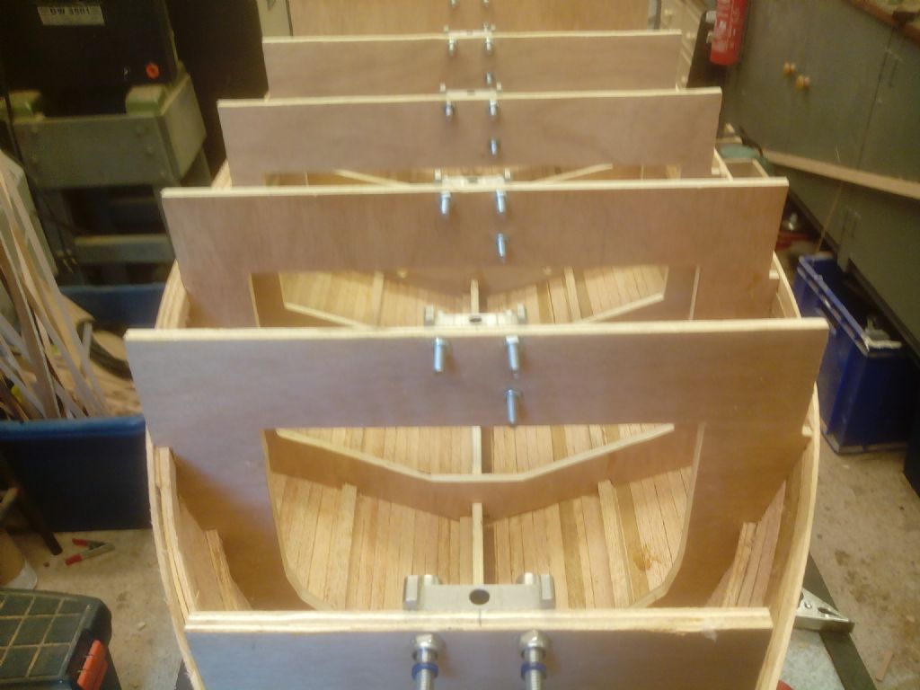

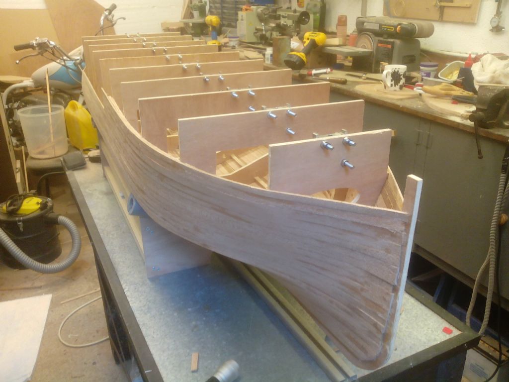

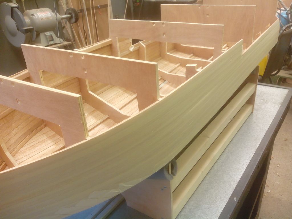

                    img_20150711_104454.jpgWell its update time, planking is now complete and Siadwell is sitting on her cradle, overall happy with the finish but I don't think that it's good enough to varnish, now I will be sealing and strengthening the hull with a coat of clear epoxy resin on the inside, then its the big rubdown.img_20150711_104438.jpg
                    #59050
                      Well done, Ralph…..You've got over the biggest hurdle and it's all plain sailing from now on
                      Cutting the former tops off is great fun too, as the weight rapidly drops off
                      I covered my hull with wallpaper backing and there was no filling required
                      Any thoughts on the power plant?
                      A big steam engine would be very attractive………Coal fired of course?

                          img_20150713_125617.jpgJust before I started to apply the resin a precautionary task was required, epoxy resin can be a nightmare to rub down so I have sealed the hull, I covered the hull with masking tape to stop any bleed from hairline gap's between the planking, 10 mins now can save a load of aggravation.
                          #59084
                          Ralph Pinch
                            @ralphpinch41762
                            Edited By Ralph Pinch on 13/07/2015 13:10:59
                            #59090
                              Ralph
                              I think you'll be pleasantly surprised at how easy modern epoxy laminating/coating resins are to sand. They don't need de-greasing like the old ones did, and if you use a decent abrasive paper (like silicon-carbide) then the whole process is a relative doddle. I use Z-Poxy resin, by the way.
                              The added benefit from your sticky-tape ruse is that the resin will creep into any small gaps between the planks and set up hard to seal them – although I think anyone would be hard-pressed to see any gaps in that planking! I shall now go out to my workshop and look at the obechi planking I did on my Victory tug – and silently weep………………….

                                Dave your a trove of information, it was a while ago since I have used any resin and it was a nightmare, would not use any on my bikes because of this, as for the planking, had a little titter at your closing remarks, but you will be surprised to hear that yes the planking looks good in the pictures and superficially in the flesh BUT I upturned the hull and checked all of it with a flashlight.
                                The comments I have in mind cannot be used on this Forum, nicest possible one was used frequently on my school reports many years ago "could do better".
                                The Hull would make a great lamp shade lol……………slit's of light every ware…………."must try harder" is another frequent report comment that springs to mind.
                                So I will join you in the silent weep.
                                Footnote………..whats even worse is that I asked for epoxy resin but got polyester and never even noticed.
                                #59093
                                Ralph Pinch
                                  @ralphpinch41762
                                  Have just removed the masking tape and to be honest there is very little bleed, the flash light just magnifies the smallest slits that you would not see normally, but the masking tape has highlighted one thing……… what I thought was a smooth flat hull is anything but. this would not be apparent until paint was applied, thinking of skimming the complete hull with Bondo to smooth the lines before I spray, just like the old days with my bikes………lol
                                  It should be watertight then!!!

                                      Early in my married life I very quickly unlearned how to wallpaper, if she see's this boat with wallpaper even lining on it she will have me decorating the house, there goes my modeling time so wallpaper is definitely out.
                                      Cards……well that's too much like wallpaper and the said repercussions.
                                      The Bondo I use is not much like P38 filler but more flowing, bit like icing a cake lol……. used more to contour and level than fill ,
                                      So its the Bondo dog I think.
                                      Ralph.

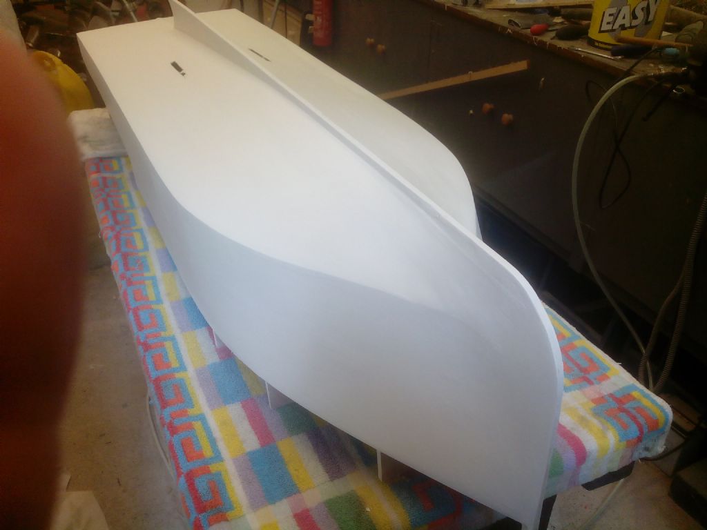

                                        Hull with first coat of primer
                                        #59287
                                          Hello Ralph
                                          It looks all white to me!…….Get it?

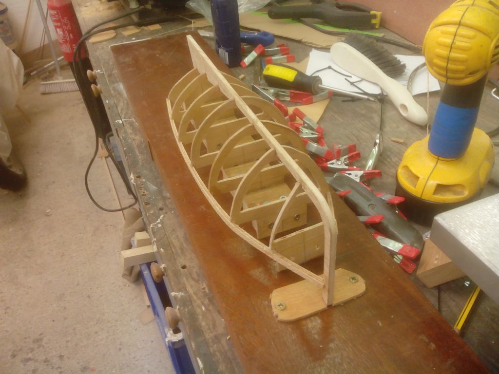

                                              just taking a break from the sanding, started Siadwell's tender.
                                              #59444
                                                Hello Ralph
                                                Are you doing a clinker build?
                                                I was surprised to learn that every plank has it`s own shape?
                                                Will watch with interest
