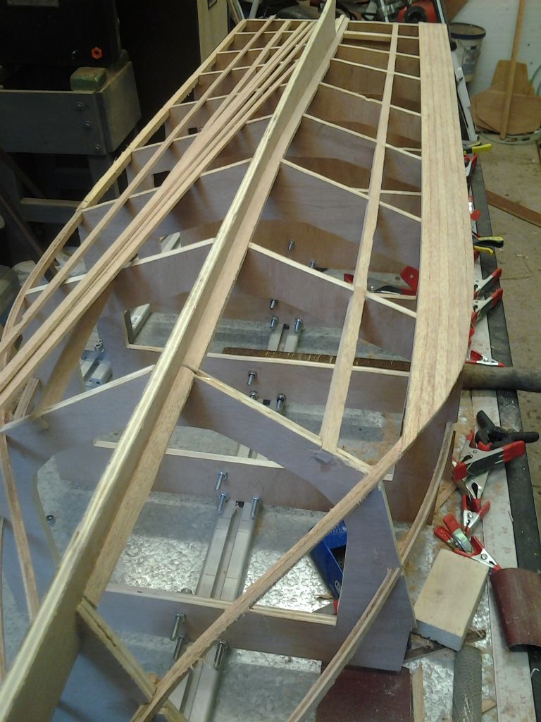

                #57859
                Ralph Pinch
                  @ralphpinch41762
                  Well decision made, Paul will be pleased, 20150519_182231.jpgat last one of his designs is being planked
                  #57861
                    Hi Ralph
                    I am very pleased with your decision to plank the boat and look forward to seeing your excellent joinery skills being put to such good use.
                    #57862
                      Well, you`ve done it now!
                      So far so good, Ralph………Looking good
                      You could probably use wider planks for the top layer?
                      Keep up the good work
                      #57863
                      Ralph Pinch
                        @ralphpinch41762
                        Hi gents, yes I have done it now, once its all done and I can turn it over, I will re-enforce the bow framework and plank joining area with extra gluing strips to increase the contact points.
                        there is an ulterior motive behind my decision to plank the hull, my Grandfather and Great Grandfather were both master mariners, Great grandad was the master of the Snowflake of Runcorn a twin mast top sail schooner built in 1880.
                        After the Siadwell is finished I hope to start to build the Snowflake, she will be a big model as well, got any plans for them Paul? LOL.
                        Ralph.

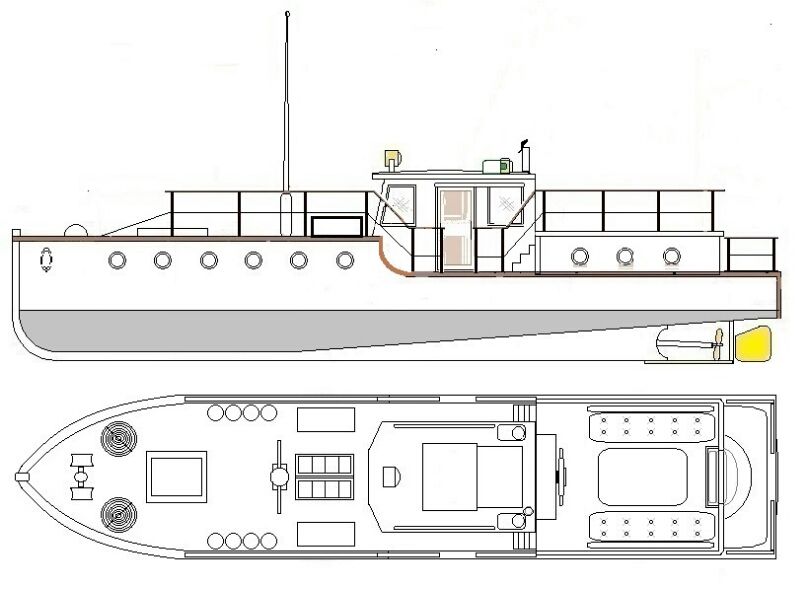

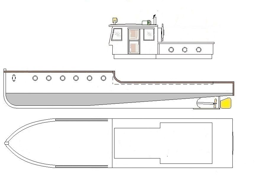

                                #57928
                                Ralph Pinch
                                  @ralphpinch41762
                                  siadwell concept 2.jpgDiede,
                                  sorry for the delay in replying to your post, working my 4 days on so not much time to spare after work, thinking of making brass bushes to run and seal the drive shaft in, cut a recess for an "O" ring and thrust washer to keep it water tight, not sure if the ring would wear quickly?
                                  Planking is coming along slowly, have started on the other side as you suggested.

                                    Hi Ralph,
                                    Drive shaft-wise I only have experience with commercially available units of the cheap kind, from Robbe and Graupner, and they tend to rely on the lack of room between the end brass bushes and some grease in the tube alone. I use teflon grease with good results. (yes, teflon GREASE, not to be confused with the sprays).
                                    However, for self-made, water-lubricated shafts I have seen a design here in NL where the shaft was supported on the wet side by a simple brass bearing, but on the motor (dry) side by a ball bearing – which in turn was protected from the water by a lip seal. Lip seals have a very low friction on the shaft and being specifically designed for this type of load, they are a natural choice. I think I would consider these instead of a plain O-ring which is more designed for static seals.
                                    I quite like your deviation from the original model, it gives the boat a more rugged, serious appearance. We in holland would call this a "bakdekkruiser" I believe.

                                    #57972
                                    Ralph Pinch
                                      @ralphpinch41762
                                      Hi Diede, yes your right the "O" ring would not be suitable for purpose, will go along your with your advice,
                                      This model is very similar in styling to my first model MSC sprite but much grander (I do like this style), I have a tendency to over engineer things and the Sprite turned out to be top heavy requiring radical surgery to correct, one of the reasons was that I clad the superstructure in 2mm mahogany planking and solid brass fittings, looks great with 16 coats of clear varnish…….yes 16……..see what I mean lol,
                                      As I will be cladding Siadwell with the same but 1mm this time, the new incarnation of Siadwell has a greatly reduced superstructure, so I should not have the same problem, whilst Paul's design is much classier,the new version does look beefier, well it does to me,
                                      Beefier is possibly not the right word but you get my drift.
                                      Ralph.

                                          Hello Ralph
                                          I think that your version looks more streamlined rather than beefier.
                                          #57982

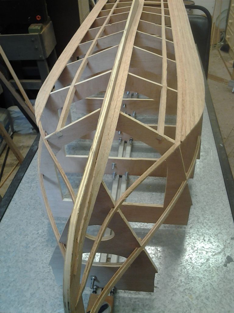

                                          Ralph Pinch
                                            @ralphpinch41762
                                            Hi gents, thought you would be out to see the three Queens today!………… well not a lot of progress due to work commitments and this planking lark is very slow,
                                            still here is a picture of the build so far.
                                            #57983
                                              Looks very nice, Ralph
                                              Might be a good time to think about the prop shafts, while you can still have easy access?
