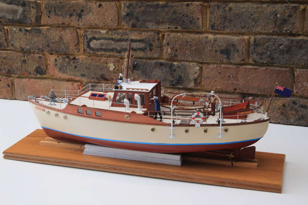

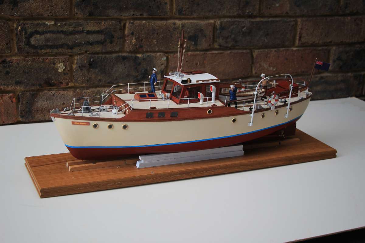

          Really great build  looks great from all angles

            Couple more photos.

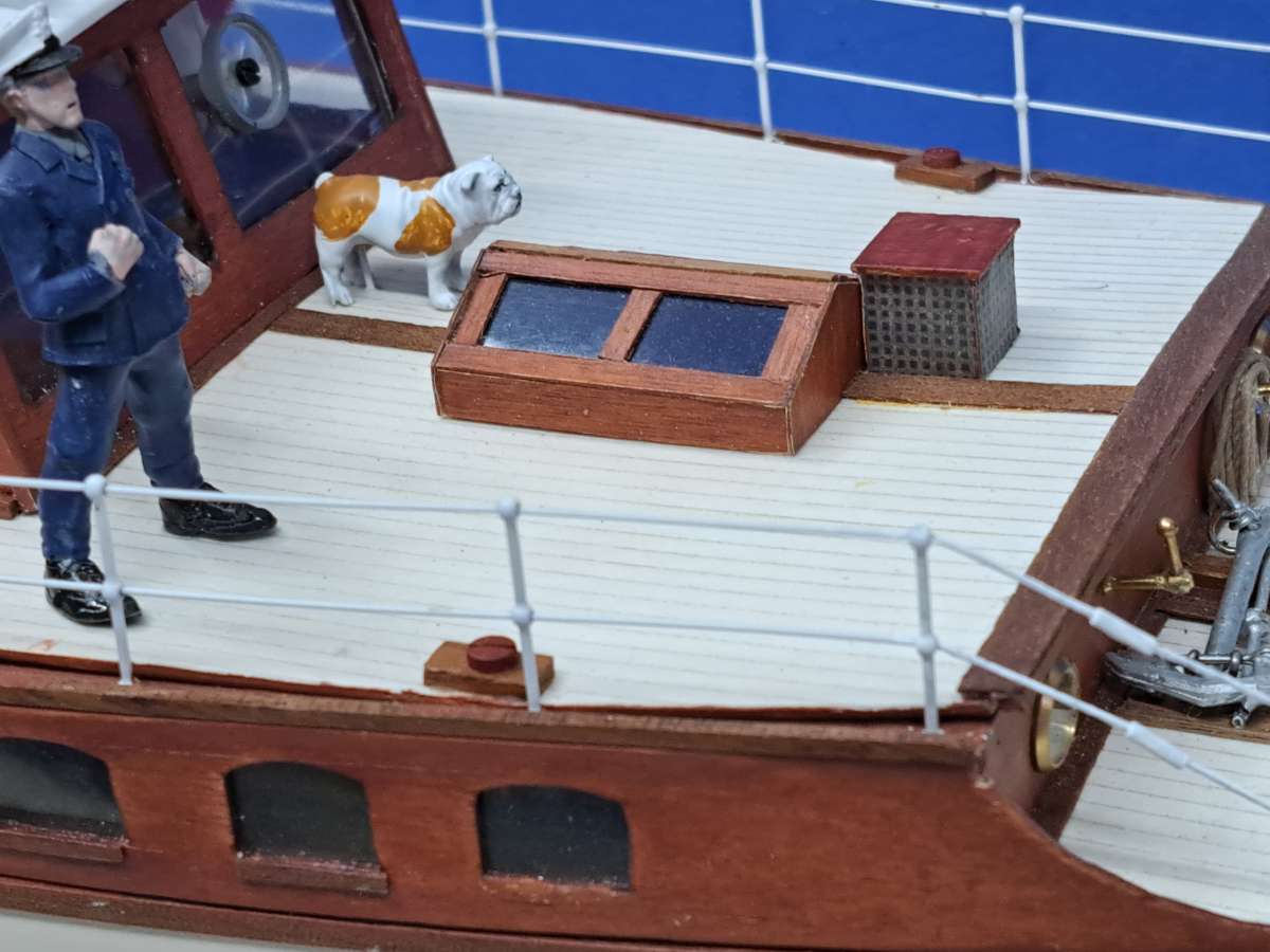

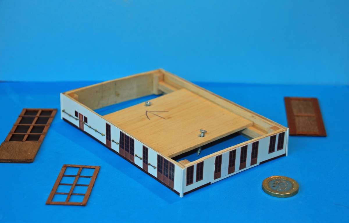

                                      Although Silver Shadow is essentially complete now, there was one missing fitting. Boats like this need lots of mooring lines and these have to be stored somewhere handy. A common solution is a ventilated rope box with sides made up of fine gratings.
                                      Like cowl vents, gratings are always a bugbear for scale modellers, particularly in very small sizes. You can sometimes buy them but constructing your own can be virtually impossible. My Bilsdale paddler needed a grating over the rudder gear at the stern and the solution was to find a suitable image online, import it into MS Word and then resize it as required before printing it out and sticking it to a thin ply underlay. It looked pretty convincing.
                                      In constructing Silver Shadow I needed a deck grating on each side of the model where people would come aboard and resized my Bilsdale grating and mounted the print onto a plywood base. Again, the this looked very effective.
                                      So it occurred to me that I could take this one stage further and reduce the grating to match the sides of the 1cm high rope boxes I wanted on Silver Shadow, one forward and and a second one aft. The prints were simply stuck on a section of 1cm square wood and topped off with a thin ply lid. A very quick job and looks just right as per the photo below.
                                      I have used this printing technique on my unfinished 1:150 scale liner and am very happy with the results. (2nd photo)
