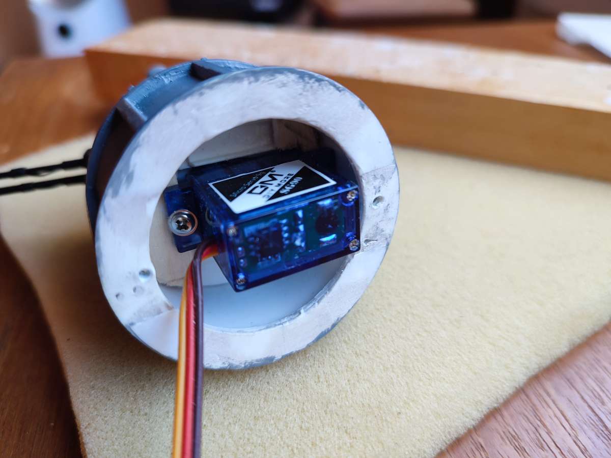

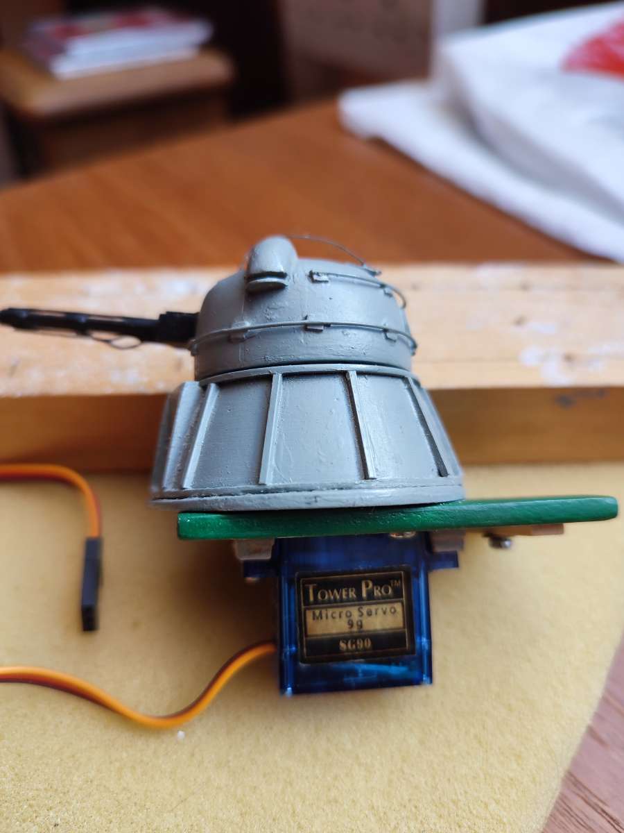

      I have two identical servos in a model of a Russian OSA 1 boat. They are turning the gun turrets at the bow and stern. One works very smoothly, the other tends to ‘jitter’ .  Both are controlled by the same channel on the transmitter.  At present I have taken them both out to investigate.
      The servos are the small SG 90 type.
      Anyone have any suggestions. I think I will initially try a different servo but I think I have tried that before.
      Tim
