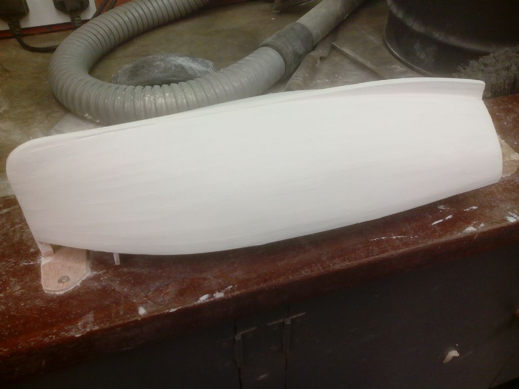

      #59568
      Ralph Pinch
        @ralphpinch41762

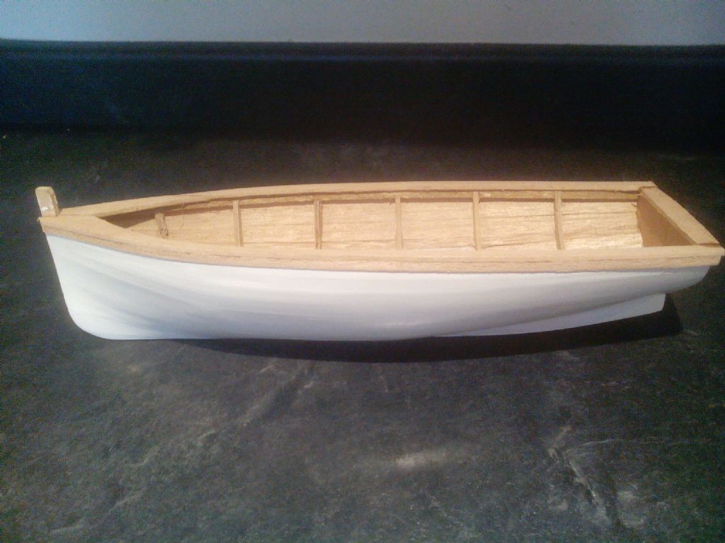

        Tender ready for gloss now
        #59570
        Ralph Pinch
          @ralphpinch41762
          Some advise please, do I use white gloss, satin wood or something else on Siadwell and the tenders hull?
          #59572
            Hello Ralph
            I think you need a few bilge keels and a stiffening strips round the top edges
            Just for appearance?
            #59574
              Hello Ralph
              The boats from that period tended to have bright white gloss with a deep shine.
              #59577
              Ralph Pinch
                @ralphpinch41762
                Hi Gents,
                Thanks for coming to the rescue Paul, that is what it will be then, one thing I'm pleased about is that you can still see a vague shadow of the planks through the paint on the sides.
                Hi Bob,
                would a rowing boat have bilge keels?
                the stiffening strips will be stained mahogony and will be attached after the painting is finished cos I'm not very good with paint,
                thanks; Ralph.
                #59585
                  Hi Ralph
                  Seeing the outline of the planks through the paint adds a little authenticity to the build and looks so much better than a perfectly smooth grp type hull.
                  #59589
                    Ralph
                    If you can pick out the plank lines, it may be worth while exaggerating them?
                    And adding a hint of muck!

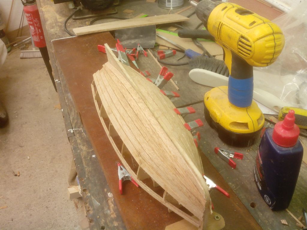

                    #59626
                    Ralph Pinch
                      @ralphpinch41762
                      Starting to come together,

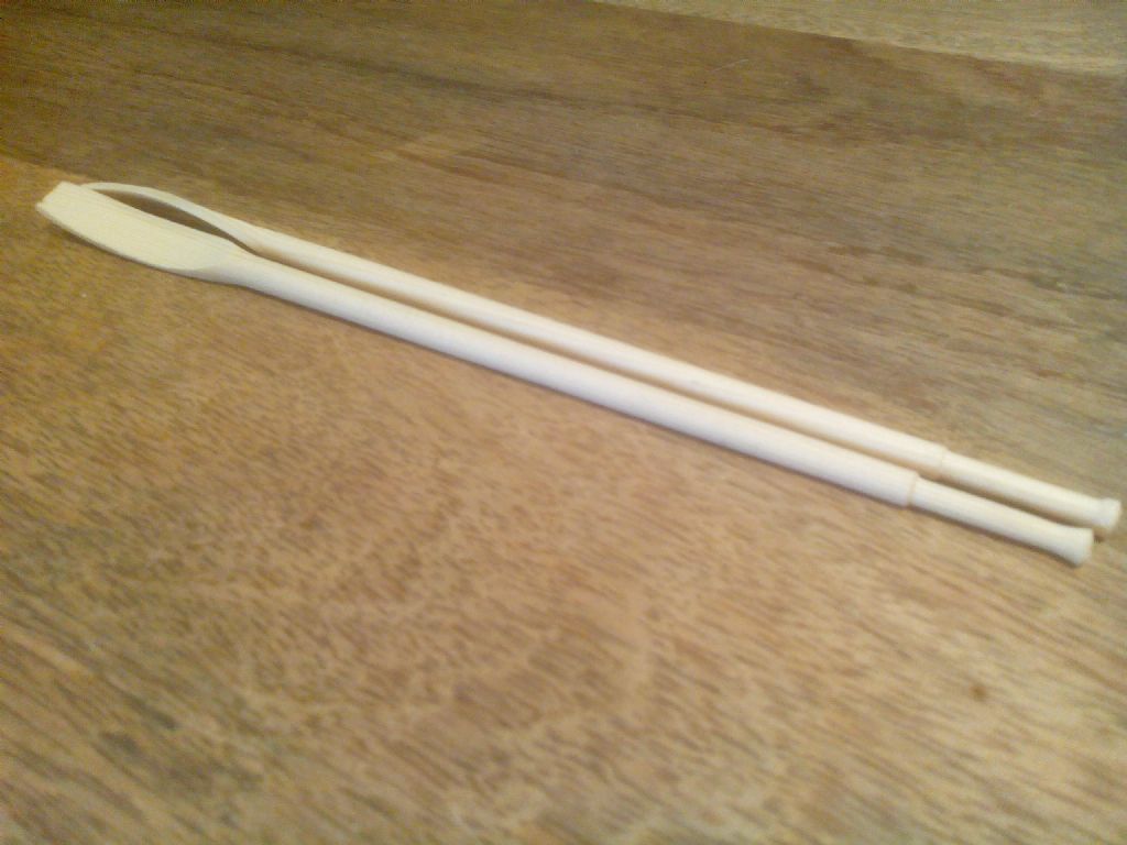

                                #59654
                                Ralph Pinch
                                  @ralphpinch41762
                                  Hi all, knocked these up this morning for the jolly
                                  #59659
                                    Nice paddles Ralph
                                    They look like Ivory?………What wood have you used?

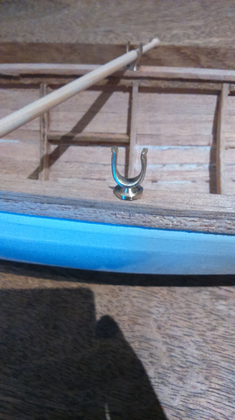

                                    #59667
                                    Ralph Pinch
                                      @ralphpinch41762
                                      Hi Bob,
                                      Hope you had a good time in welsh wales, the wood is common or garden B&Q 12mm dowl, it has very tight grain so machines well.
                                      Had a rowlocking good time this morning, have a look at these! made from some scrap brass I had about.

                                        #59670
                                        Amy jane September
                                          @amyjaneseptember49770
                                          Hi Ralph,
                                          Those rowlocks look great!
                                          Drill, saw and file?
                                          (I make jewellery from solid metals this way, so your rowlocks really appeal to me! Should make a pair as earrings….)

                                            #59675
                                            Ralph Pinch
                                              @ralphpinch41762
                                              Hi Amy Jane,
                                              Thank you for your comments, yes turned a goblet shape out of an old piece of brass round bar, drilled out the center and cut out the sides with a junior hacksaw, then used needle files to get the shape right.
                                              Glad you liked them.

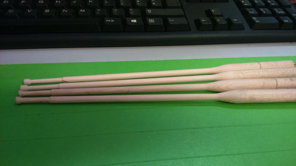

                                              #59676
                                              Ralph Pinch
                                                @ralphpinch41762
                                                tmp_23570-dsc_022239320979.jpgGood day Mattias,
                                                Yes the Jolly old things turned out quite nice what!! lol.
                                                Turn out 4 blanks from 12mm dowel then gave them a spoon shape with the linisher.
                                                The rowlocks took a bit of time but they exceeded my expectation and look good on the jolly,
                                                Thank you for you kind comments, here's the blanks before shaping.

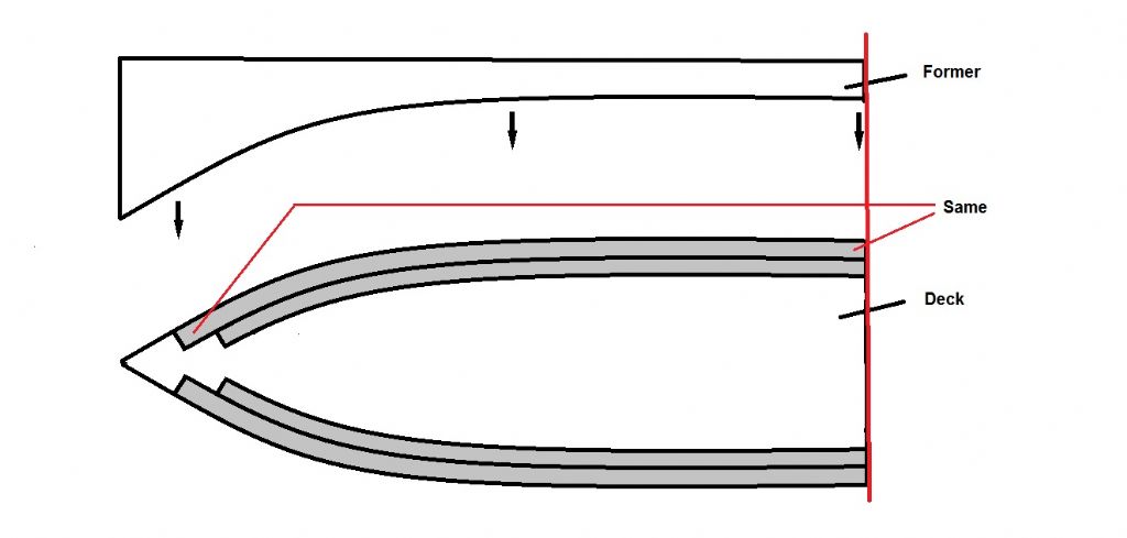

                                                  #59743
                                                    Looking nice, Ralph
                                                    How did you actually scribe the lines?………..Must have been a tricky job, with diminishing radii etc !
                                                    #59744
                                                    Ralph Pinch
                                                      @ralphpinch41762
                                                      Hi Bob,
                                                      Not as bad as you would think,
                                                      1. Make former the same shape as the hull edge.
                                                      2. Using the former, mark out the planking on the deck with a soft pencil (lightly)
                                                      3. Go over the pencil lines with an engineers scribe (maintain the same pressure)
                                                      4. Sand out the pencil lines.
                                                      5. Varnish the deck, the varnish enters the scribed line and darkens the line more than the deck surface.
                                                      Edited By Ralph Pinch on 16/08/2015 11:12:41
