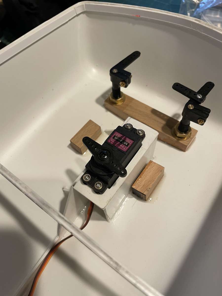

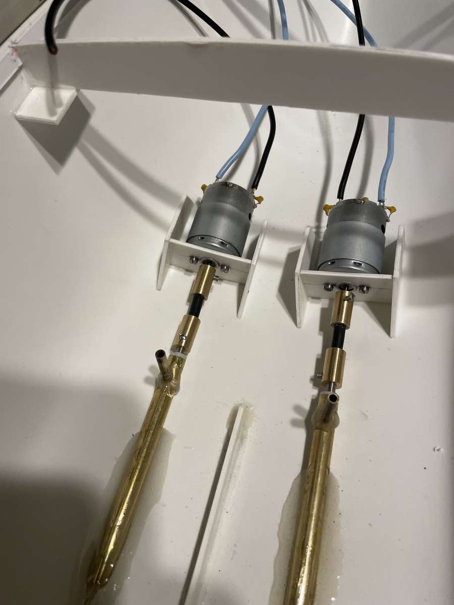

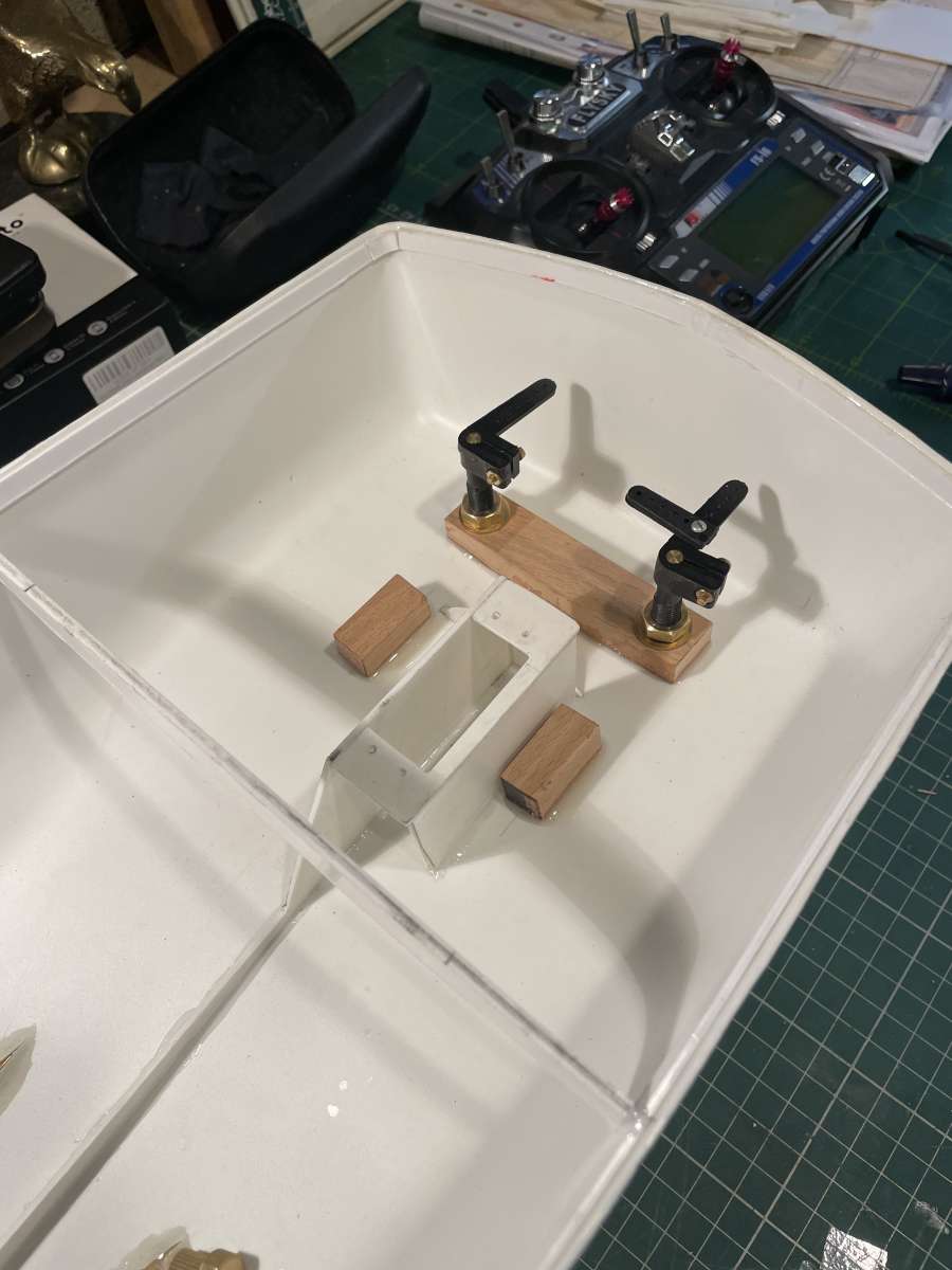

      I seemed to be adding my build to others threads and I thought a new thread dedicated would be better.
      Having been on the build for 22 months or more it’s a slow burn.
      I first of all had to get to grips with the moulded hull and after a lot of cutting and sanding ended up with something I was happy with. The moulding still has a twist in it – but I can live with that.
      The hull is ready for the deck – but I am finishing the rudders and drives first.
      we all know about the drives him ho.
      I will be making a couple of couplings that flex enough for me to leave the shafts as is. I may end up as Ray says taking them out and starting again though.
      The cabin is also started.
      IMG_8051IMG_8065IMG_8070IMG_8066IMG_8084IMG_8085IMG_8088
      A few pictures :-

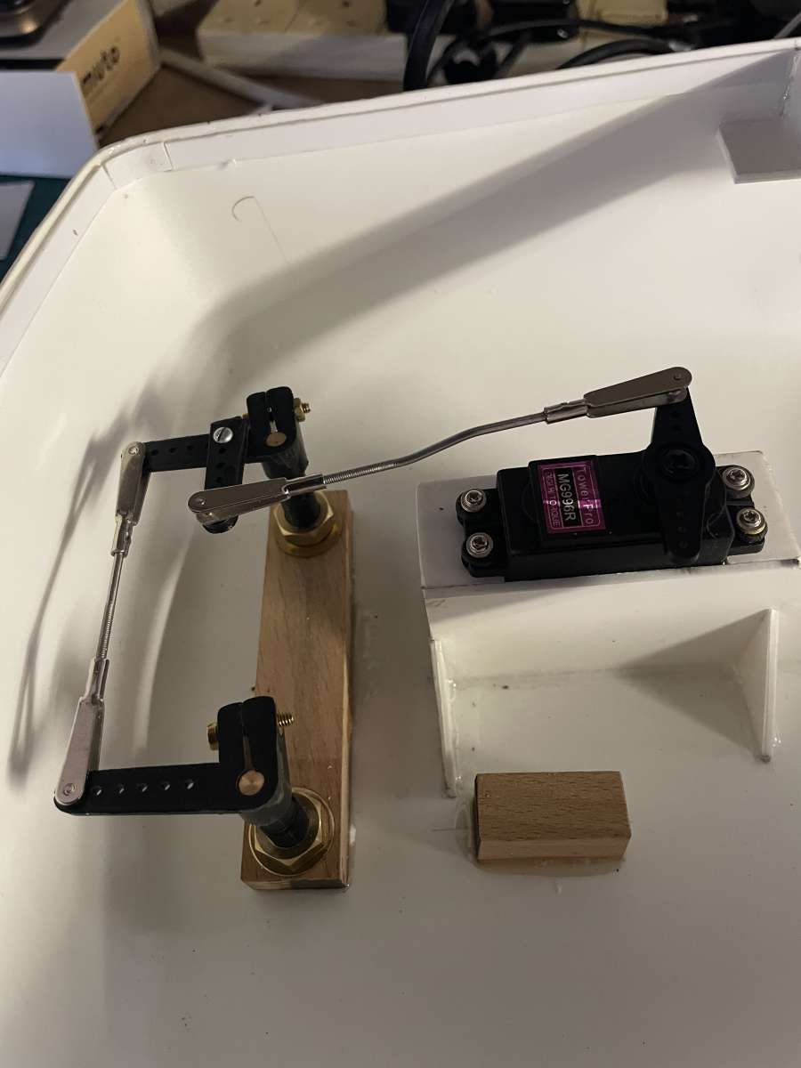

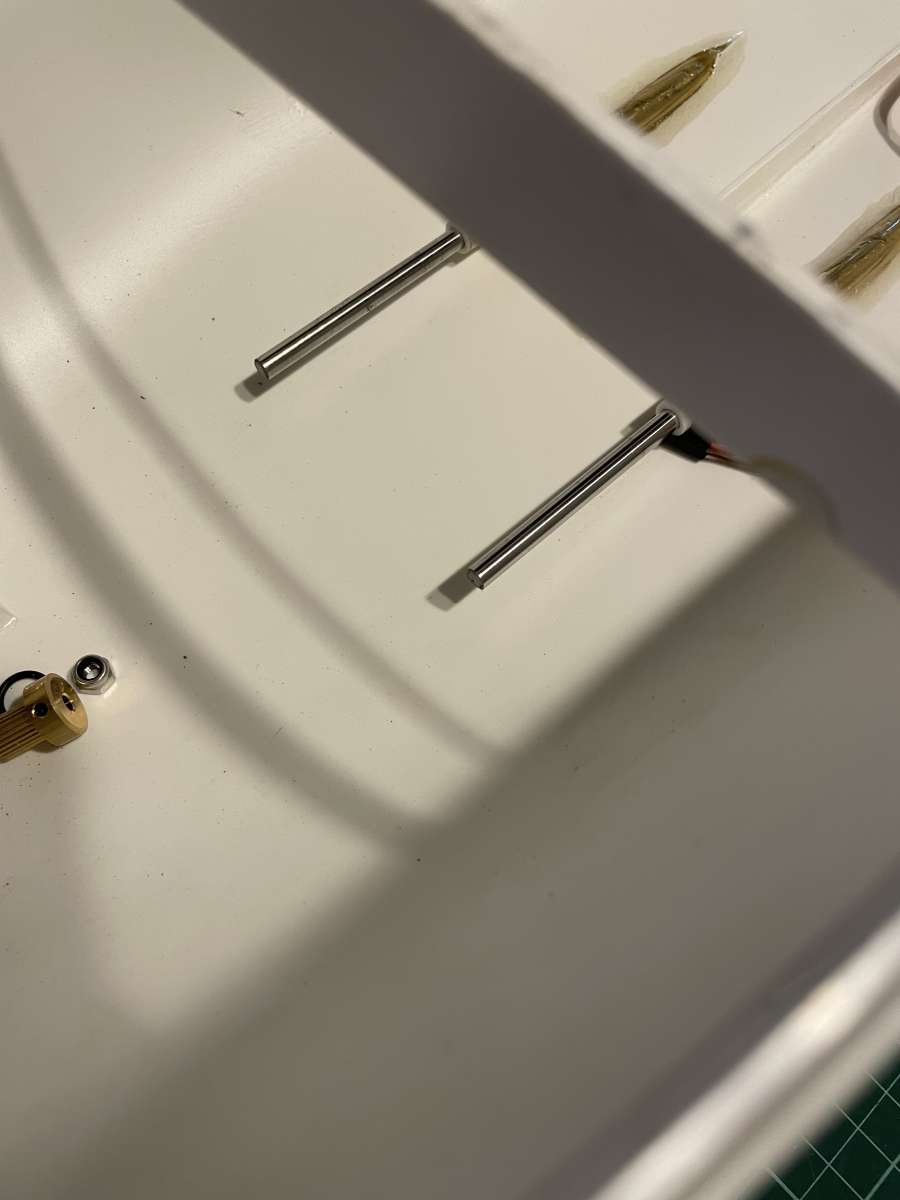

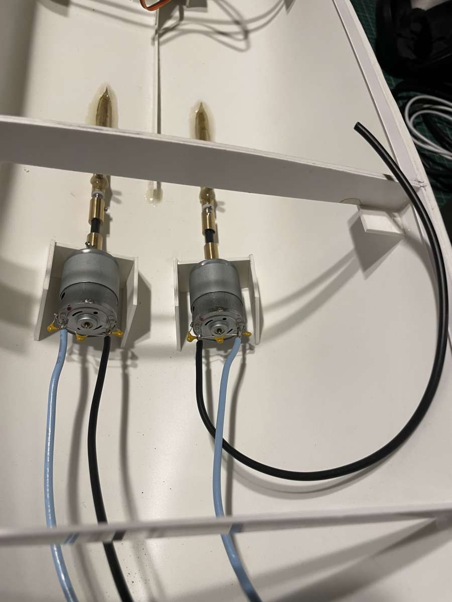

        After what seems like ages I finally solved my low shaft problems.
        I made my own couplings to suit the problem. They turn over quite nicely. It took me a while to find a suitable o ring to cut the sections out off. I wanted ones with as large a radius as possible.
        I want to control the motors separately. Do I have to use two separate channels on my tranny? Or is it possible to mix them from one stick. I have Flysky fs i6x radio.
        IMG_8363IMG_8364

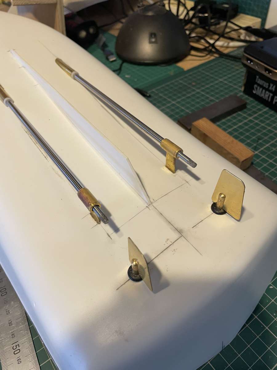

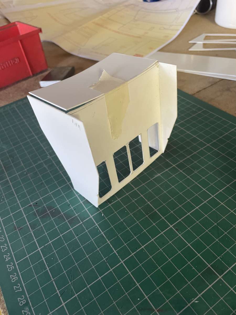

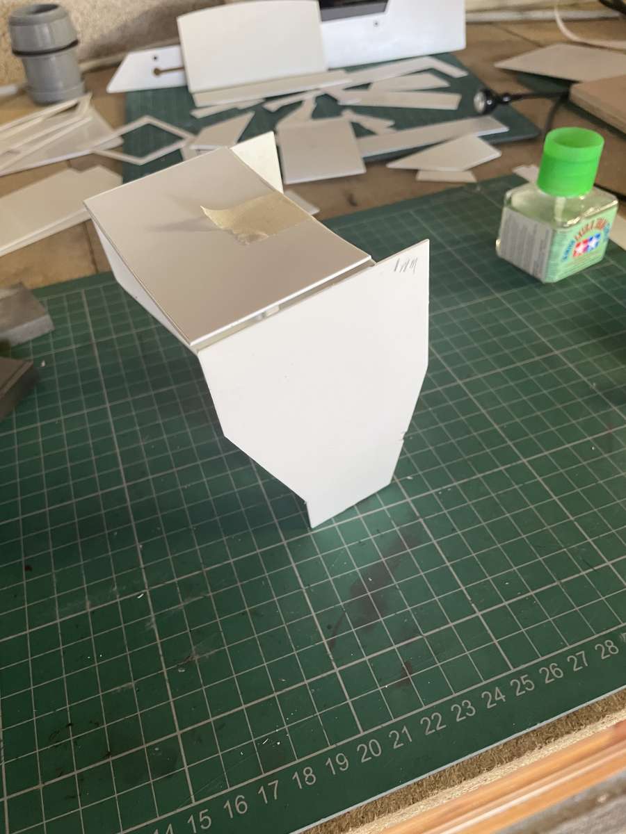

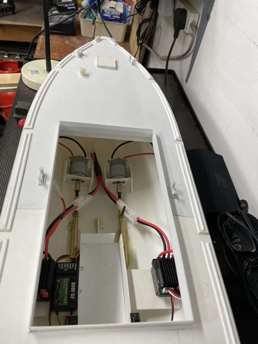

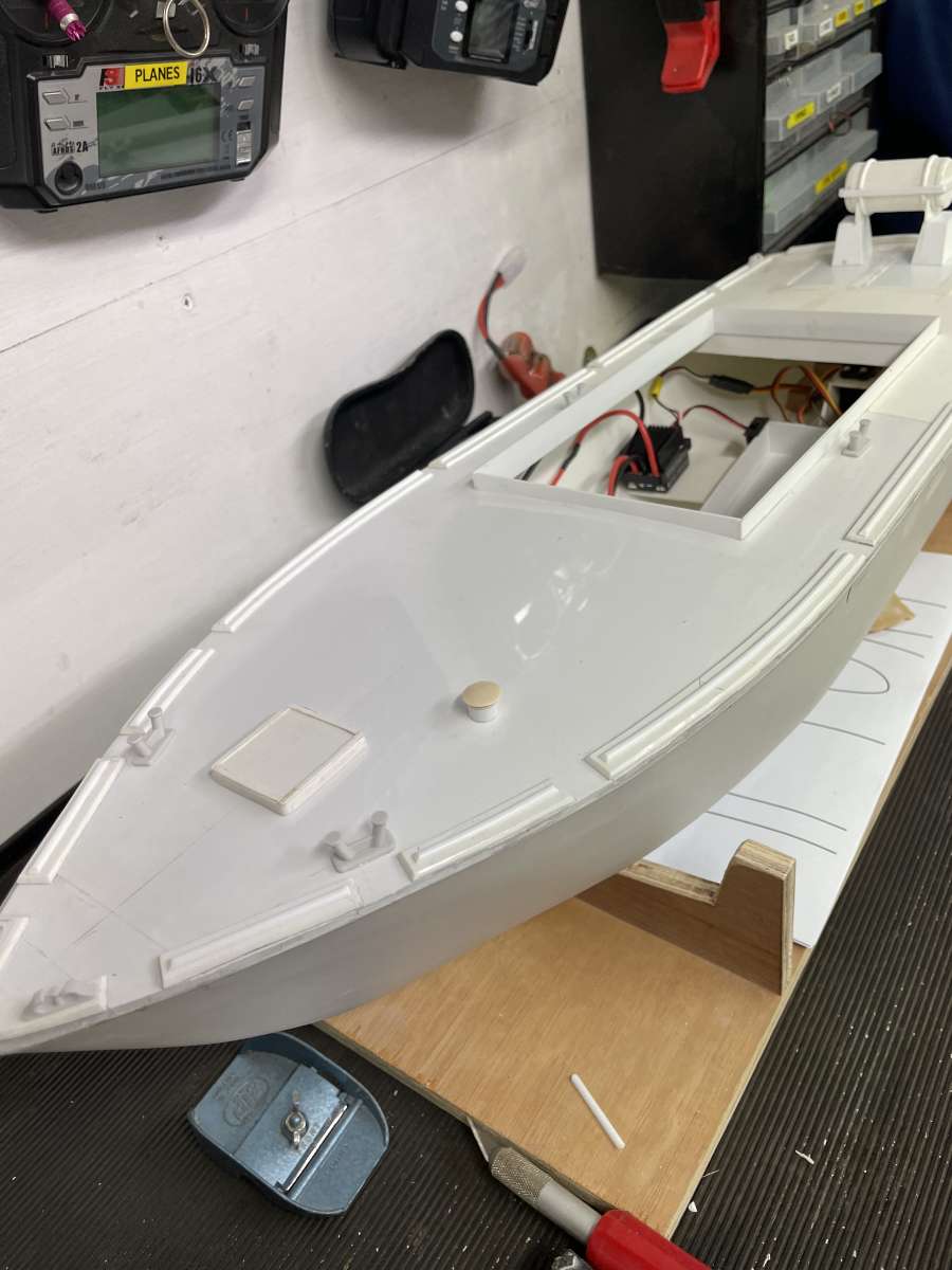

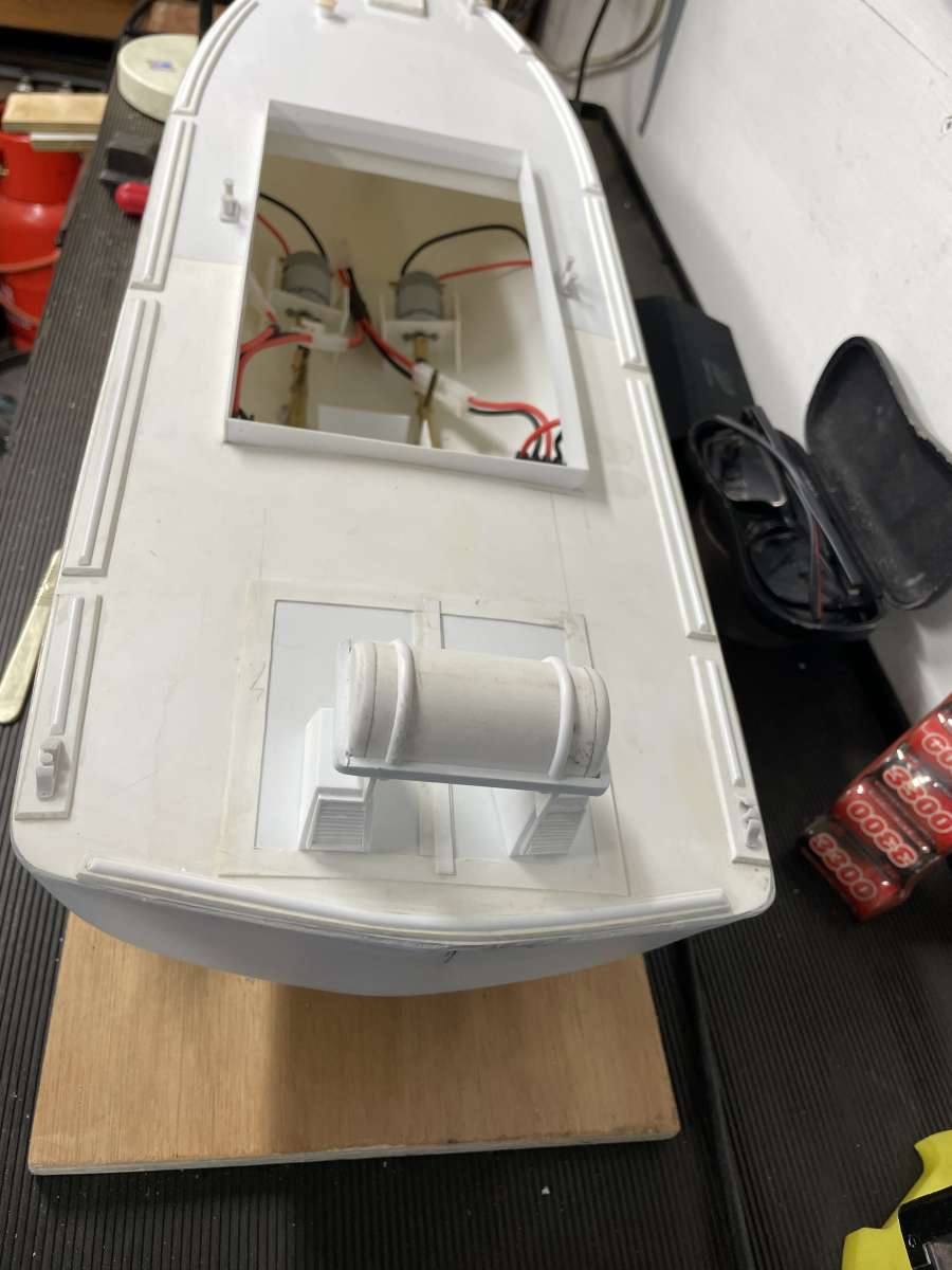

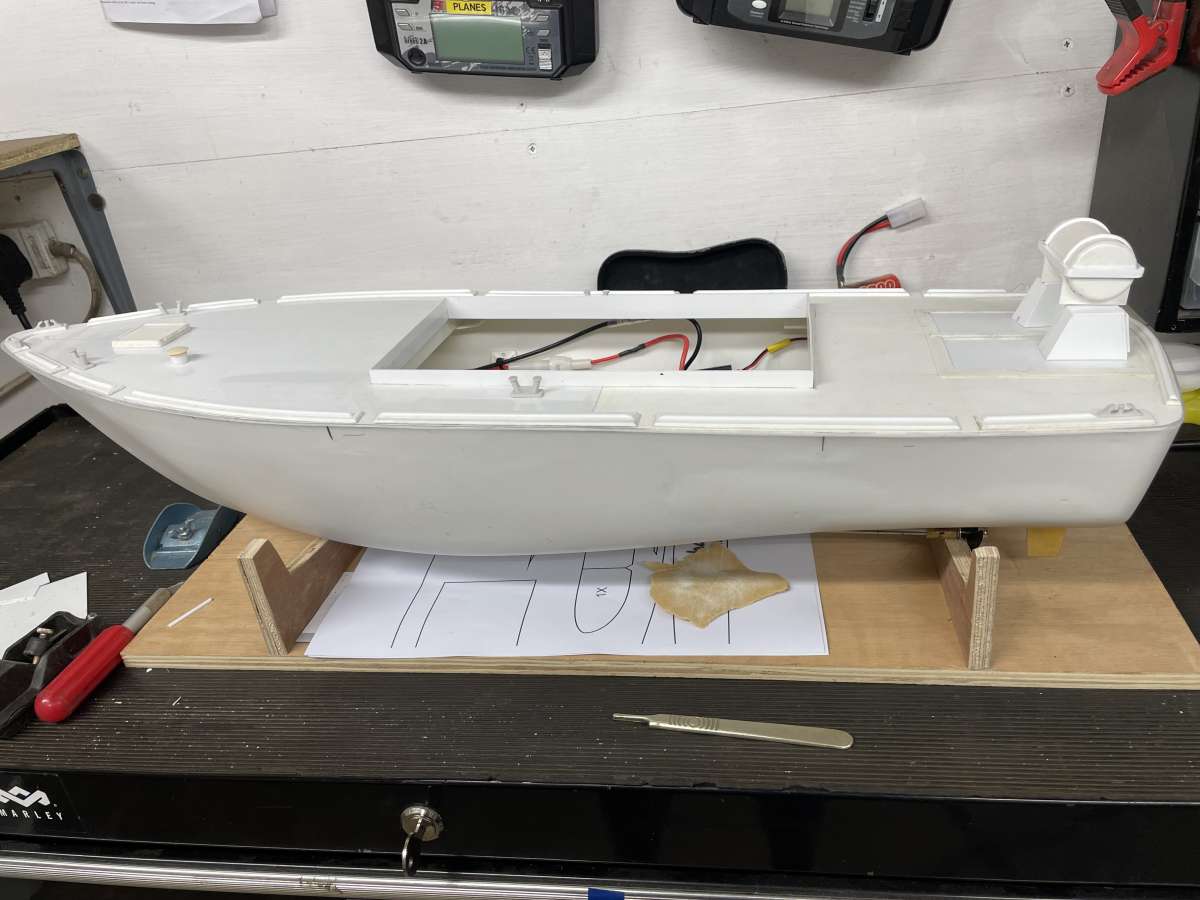

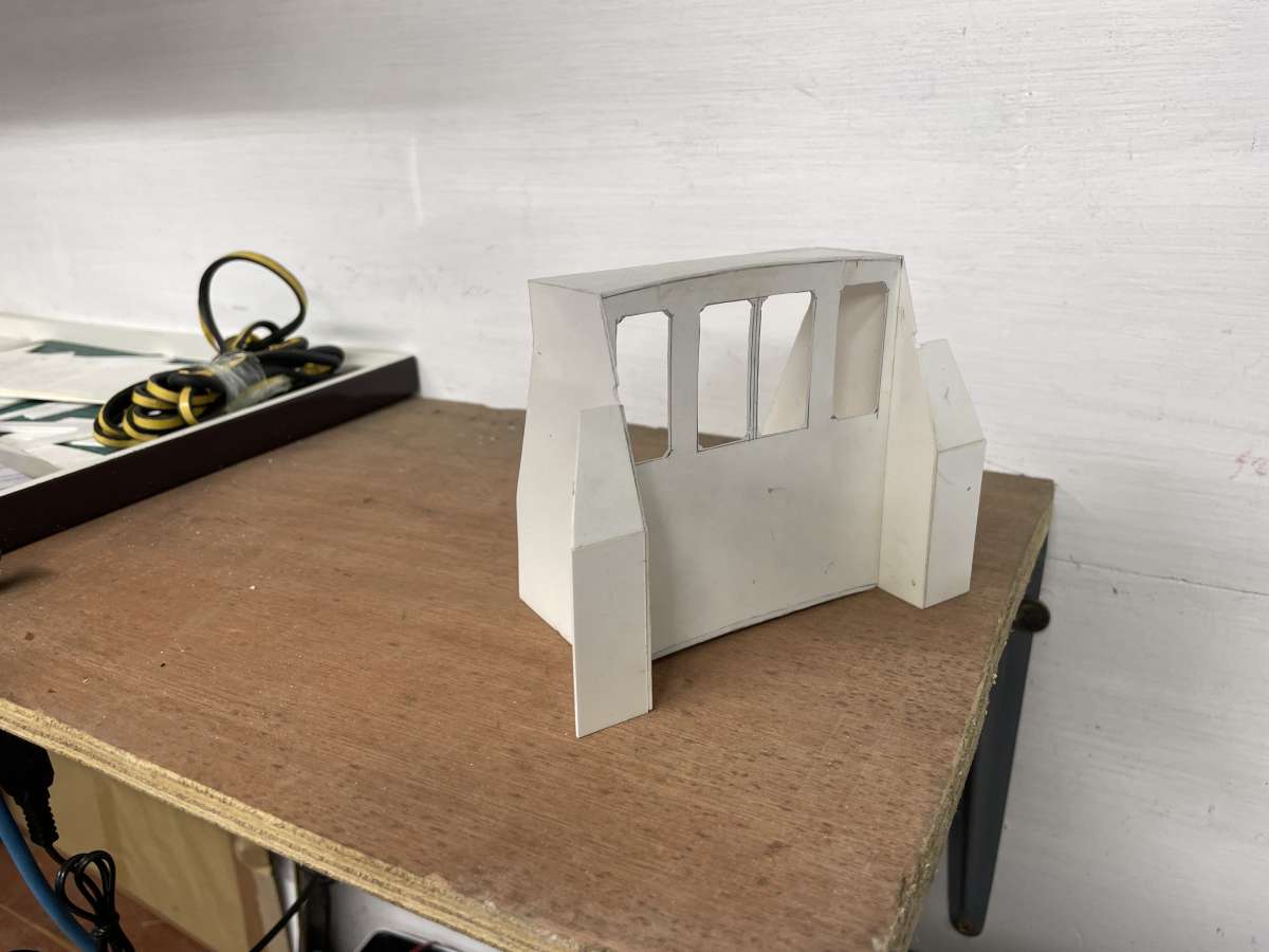

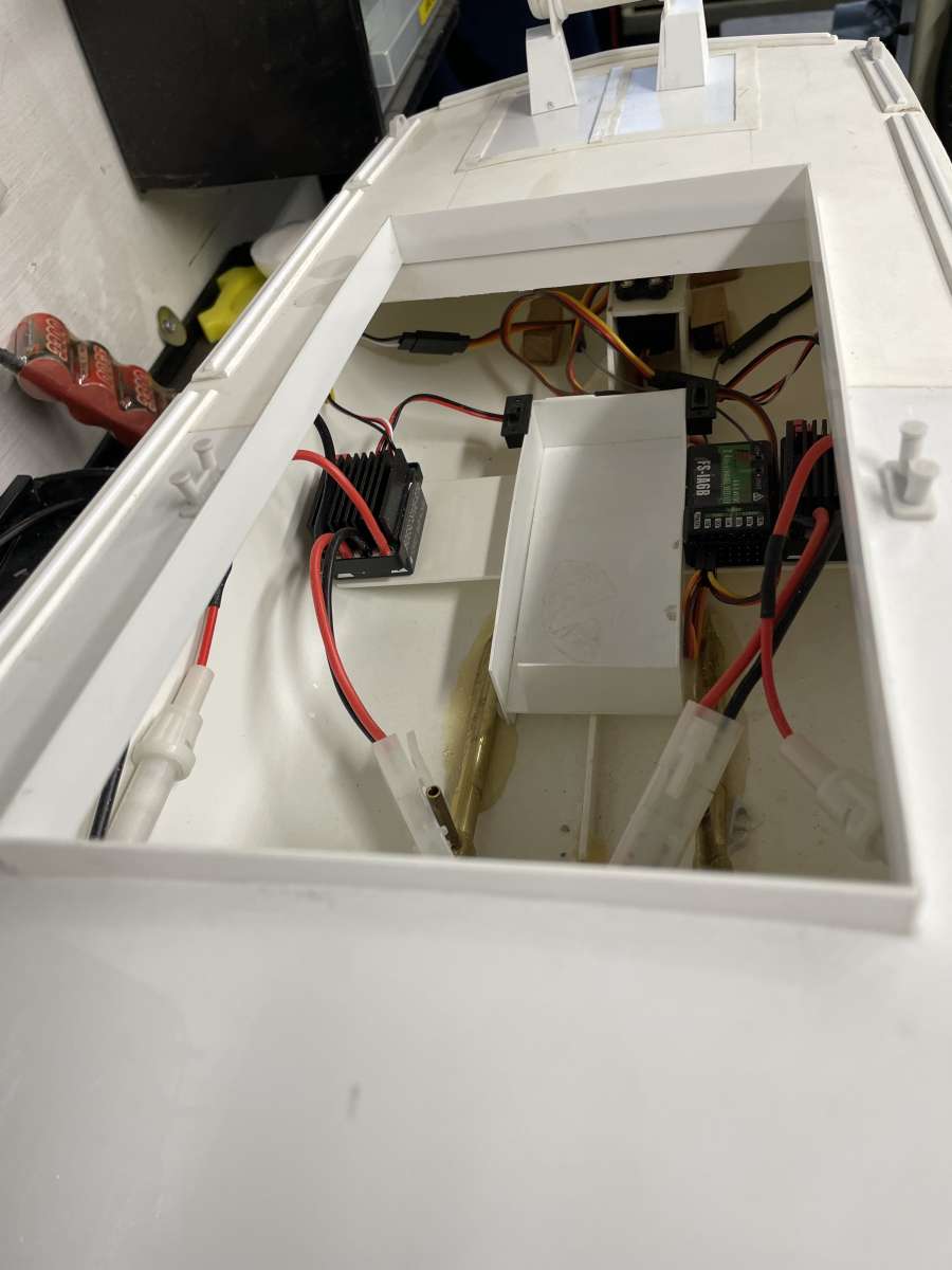

              I certainly was not joking when I said slow build!!
              After the disappointment of the misshaped hull mould I am now on fitting out the deck.
              I want to get this finished so that I can crack on with the wheelhouse which is quite a fabrication in itself.
              IMG_0302IMG_0303IMG_0304IMG_0305IMG_0306IMG_0307
