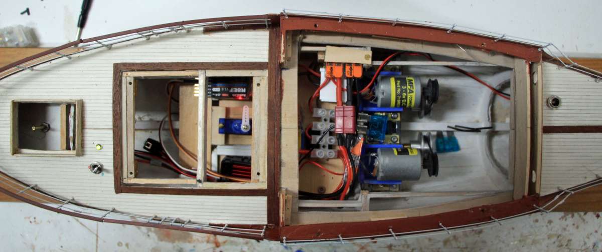

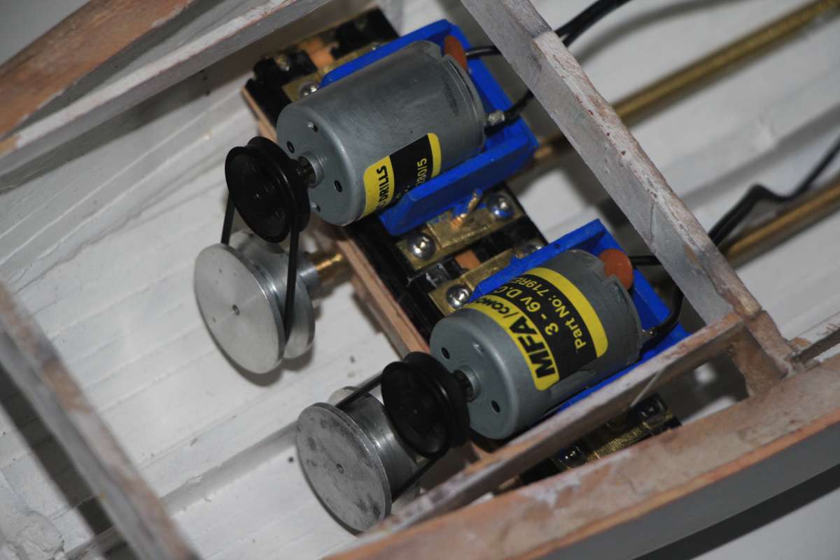

        I am currently building a motor yacht based on Vic Smeed’s Silver Mist (see separate topic). It is only 21 inches long and  is fitted with two MFA 360 3-6 volt motors driving 25mm 3 blade props using 2:1 reduction pulley drive. Initial domestic tests have shown it trying to climb out of the bath on a 7.2volt battery! Photo below.
