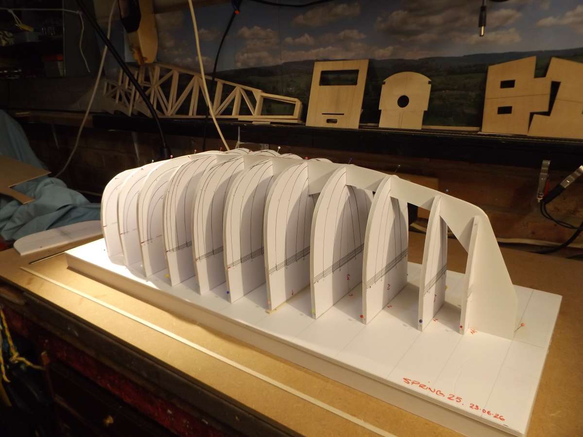

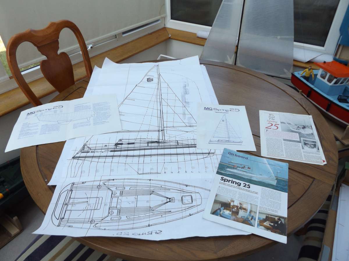

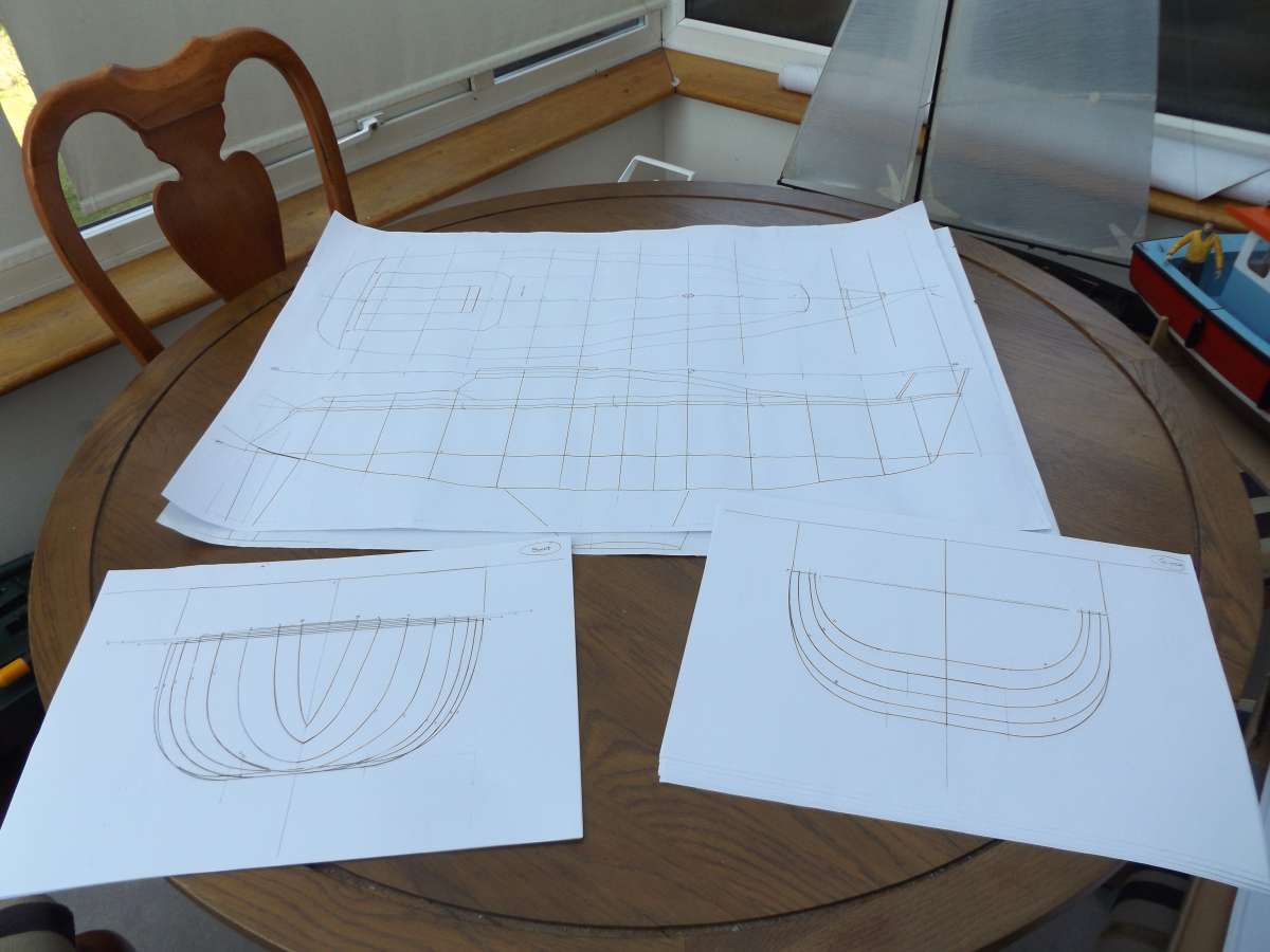

      Well the next sailing cruiser design is on it’s way, the Fictional character Tom Howards boat to save the boatyard in the 1980’s series Howards Way must be considered a classic from the designer Tony Castro, I will do my best 🙂 I made the big investment a while back with the DF95 carbon fin and bulb !! what’s £125 so far to re create some history 🙂
      As I have drafted the lines so I’m making a full scale foamboard mock up , watch this space
      Regards  Ray

          Very nice Ray, I hadn’t realised how broad the stern was. Also an interesting comparison with the internal layout compared with my Jaguar 25. Looking up photos on the internet, I think maybe the Jaguar had a better layout as the fore cabin was separated from the saloon by the heads compartment and wardrobe space. The Jaguar only had a single berth under the narrower cockpit and my boat had an outboard which saved on internal space. The Spring was the better sailer though and a more modern boat.
          The wing keel and twin rudders should make for an interesting sailing model.

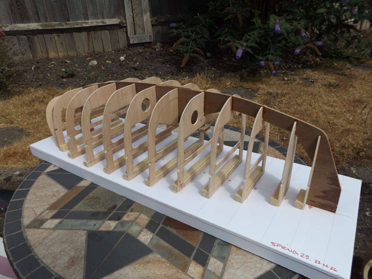

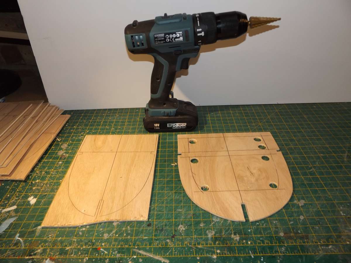

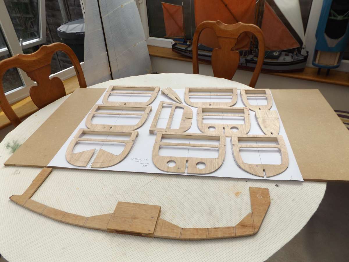

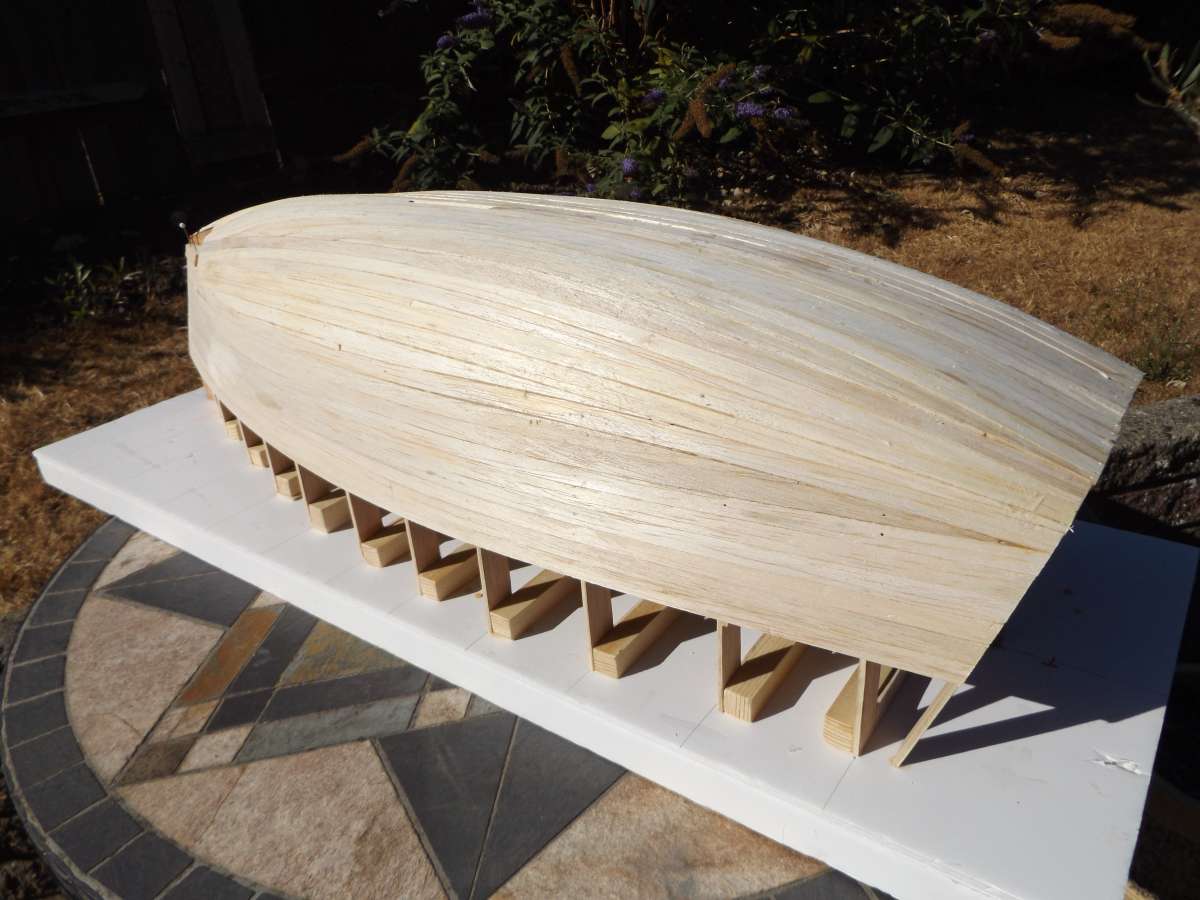

                          After a few days away in Wales I’m back on the Spring !!
                          All the main parts cut out lots of time saved with the stepped drills which are marvellous 🙂
                          Regards  RayDSCF3221DSCF3220DSCF3229
                          #128695
                            The Spring is ready for the planking now, it’s my usual format of build so I’m not surprised there are few comments , always good when I’m planning the two builds after this one 🙂

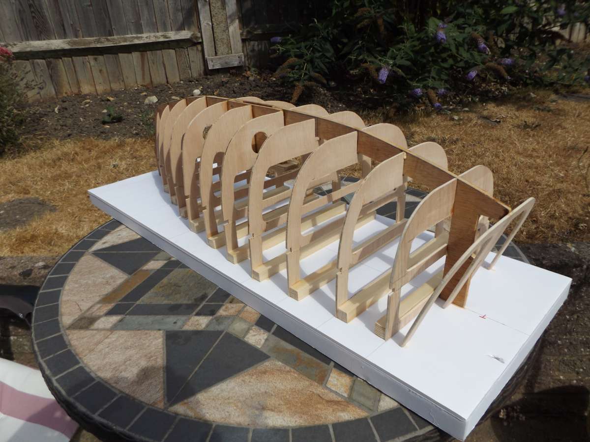

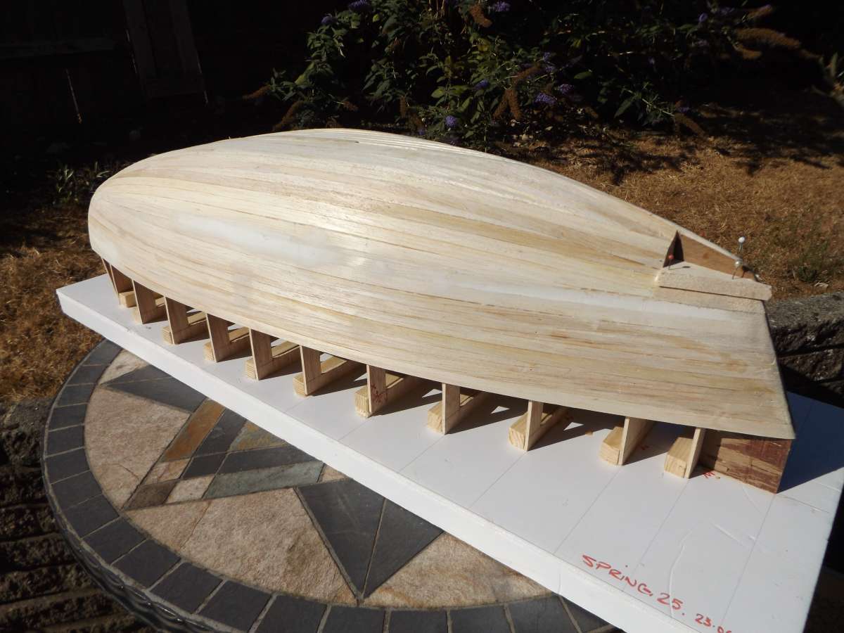

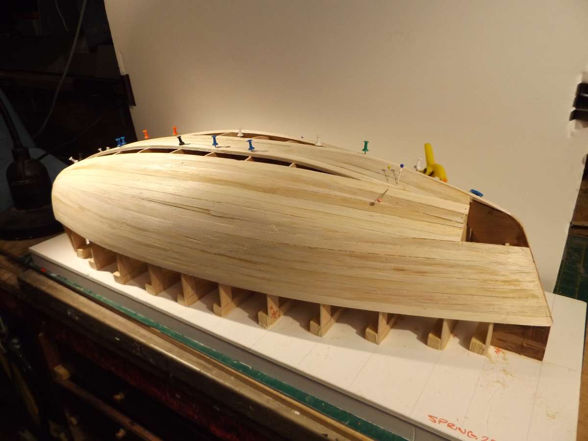

                                    Still plugging away at the Spring and I seem to have a hull almost ready for final  filling and sanding before the glass cloth and resin, I thought it would be easier while she is still on the building board, the foam board base has been a great success 🙂
                                    Regards  RayDSCF3242DSCF3244DSCF3246

                                      Another lovely planking job Ray. Does it really need glass cloth? It looks like resin would be enough.
                                      #128816
                                        Hi Colin,
                                        Yes the lightweight  glass cloth really gives the balsa a strong surface and quite ding proof , only water based resin but many coats 🙂 Like Ash has found with his destroyer it helps prevent the joints opening up .
                                        Regards  Ray
