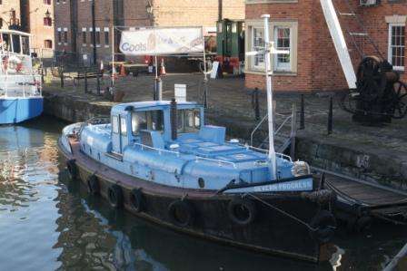

            Stephen Garrad
              @stephengarrad28964
              Hi Tim
              Thanks for your interest I have seen that website, all the pictures are of her moored in Gloucester Docks as a floating exhibit at the museum. She is actually moored against the terrace at Wetherspoons so I think I will have to go and do some research!! I’ll certainly be able to take plenty of pictures of the topsides.

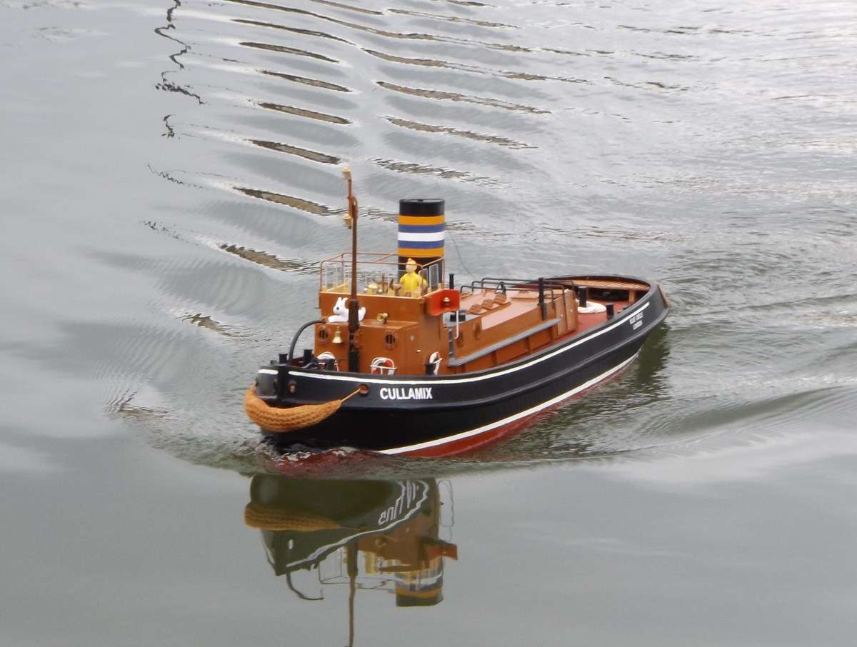

                  Hello guys,
                  The hull shape and lines are a dead ringer for Cullamix , smaller obviously and the waterline mark etc 🙂

                          Hi Stephen,
                          The change of forum format meant all the old albums were lost  ( I think), I built her plank on frame one of probably my best quality builds to date but at 35 lbs was a real chore to lug around !! so I soCullamix Bluewater 300624Cullamix edit 120626ld her to a club mate at Chantry club they are keen as mustard on tugs, I’m actually drawing up a set of drawing for Cullamix 22″ long as she is a favourite of mine watch this space.
                          Regards  Ray

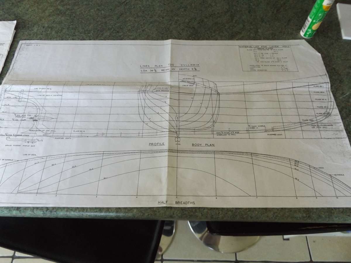

                            #128323
                              Stephen,
                              The plan shows the hull lines which represent the outside surface. The bottom part of the drawing can be used for bread and butter construction as is. The Body plan in the centre of the upper part of the drawing can be used as the basis for frames but you will need to redraw it to allow for the thickness of the planking. If you are using 3mm thick wood then make each body plan section 3mm smaller than on the plan.

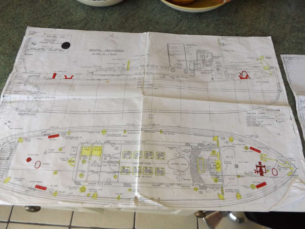

                              #128324
                                Hi Stephen,
                                These are my smaller prints of Cullamix at 22″ I used to mark off the fittings as I made them, brilliant drawings from back in the day 🙂
                                Regards  RayDSCF3215DSCF3216
                                #128325

                                  #128326
                                  Stephen Garrad
                                    @stephengarrad28964
                                    Hi Ray, that’s exactly what I need I think, the second picture that is.
                                    Stephen
