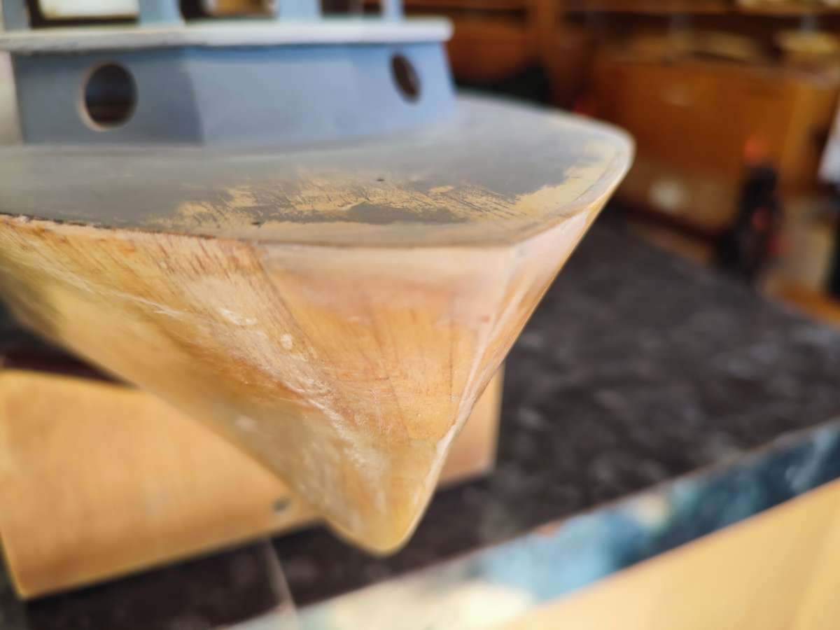

      Bow and some cabin roofs repaired!
      Little bit of Isopon P38, rubbed down with 120/ 240 grit nail files (Amazon) and 800 wet and dry.
      Think I can get back getting ready to spray the hull.
      Tim

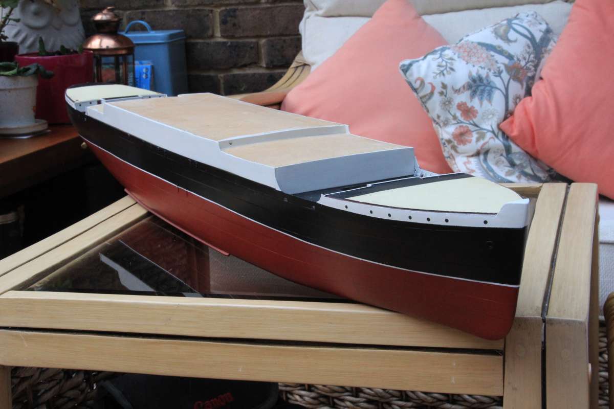

            Halfords do a matt black rattle can which is very good and is intended as a top coat. It has a very faint sheen which looks great on a model. I used it on my still unfinished ss Almeda liner – see below.IMG_0317
            Hycote sell exactly the same product but cheaper.
