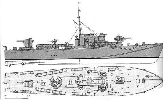

            now that we have mastered and built a good seaworthy boat, by the looks of it, triple screw – you are thinking about quads.   Different ball game again – couple of ships I can think of to model would be, warship, passenger liner, or hows about a dog boat/rather large MTB – they had 4 screws.   Just remember that the two forward screws rotate in opposite directions to each other and the 2 rear screws rotate in the opposite direction to the forward screws – also think about the space for the motors.

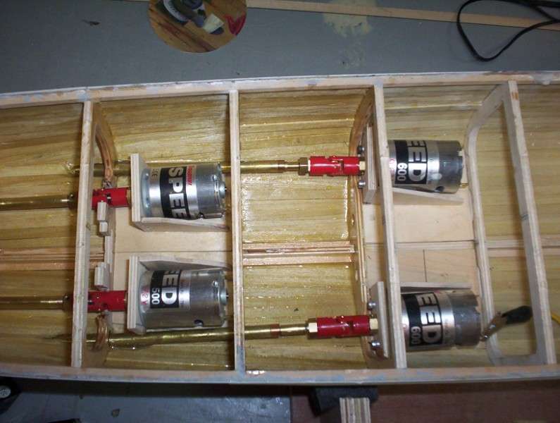

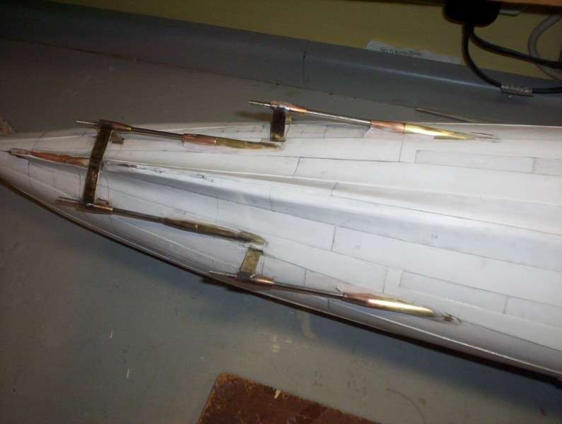

            Couple of pics  – one of HMS Exeter setup and one of the dog boat.
            John006 [800x600]003 [800x600]7a091e264a4c4c30d55e16239b12d757
            #126109
              Question John, why are the two outer motors Speed 600s and the two inner motors Speed 500s?
              #126110
              John W E
                @johnwe
                hi there Richard,
                Answer 🙂 the photograph was taken whilst I was trialling a fit of the motors in the mounts in the hull, along with couplings & etc.   So, they were (at the time being) the motors that I had at hand – as they are both the same basic size for the screw mounts holding the motors.  Now there are 4 x 500’s in the hull of the finished model 🙂
                John
                #126111
                  There’s me thinking it was something deep and technical that I hadn’t come across before! Thanks John.
