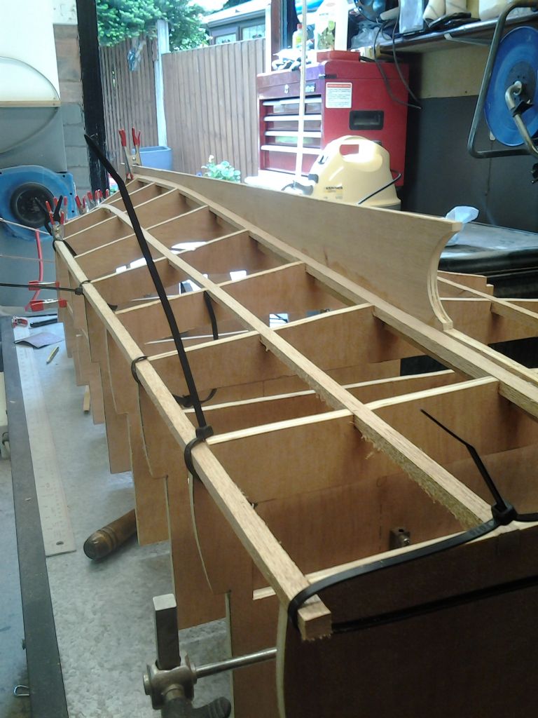

            Bottom stringers fitted and glued into place, small repositioning of inserts was needed to stop any potential lateral 20150513_142741.jpgtwisting, any voids in the stringer insert after adjustment were plugged with wedges from same material as stringers.
            #57718
              So far so good!
              Bear in mind that the keel tapers to a knife edge………Not so easy
              I bought a Power sander knife from B & Q…….About £40 and was a great help

                Hello Ralph
                Just bear this photo in mind when you start work on the Bows end
                Edited By Bob Abell on 14/05/2015 17:52:18

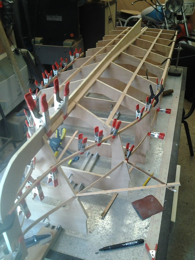

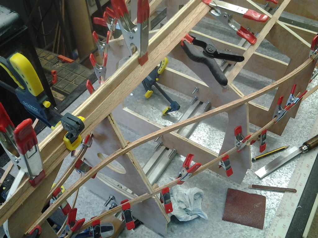

                    20150517_153438.jpgHi Bob,
                    Not yet retired so I still need to work worst luck, as I work 12hrs and travel 1 1/2 hrs a day nothing gets done on work days, BUT here's my days off !!!!.
                    Have progressed a little! more 50% of the stringers are now glued in place with no problems, found the old Karcher steamer I thought I have dumped, works great with 2mm mahogany stringers laminated together.20150517_153401.jpg
                    #57788
                      Sorry to pester you Ralph…….But your build is very special interest to me
                      I like your laminated stringers……..What a great idea?
                      Well done

                          Hi Gents,
                          Yes great idea the laminated stringers! wonder where I got that from? LOL
                          Thanks for the kind comments.
                          Bob your not pestering, I'm glad of the input, it's nice to see someone interested, now don't shout but I'm going down the planking route, planks will be 10 x 4mm mahogany, or might double overlap planks 10 x 2mm, need your advice on this, even if it's you must be crazy!!!
                          Will go down to my local builders merchants on Tuesday to get an offcut 6ft stench pipe to make a steam tunnel.
                          Ralph.

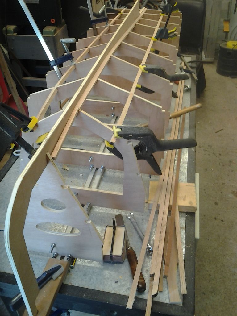

                                  Had a dry run with 2 off 10 x 2mm mahogany planks, Bob your right no steaming needed but would 2mm be strong enough?

                                    Hello Ralph
                                    Two layers of planking, with all that glue and filler etc would increase the weight considerably…….Think about that!
                                    Don't fancy the idea, myself……..Have a little practice first?
