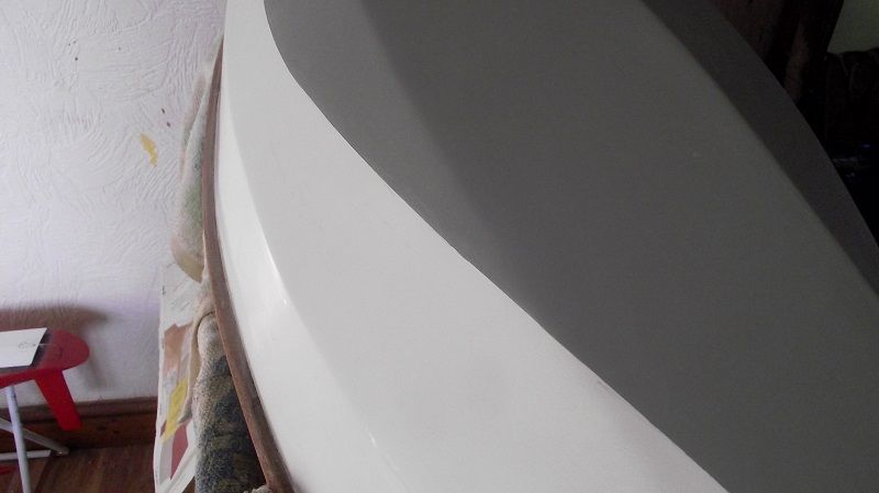

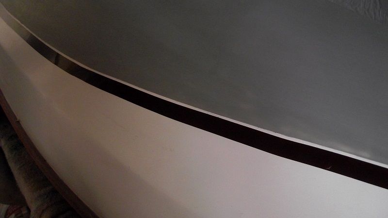

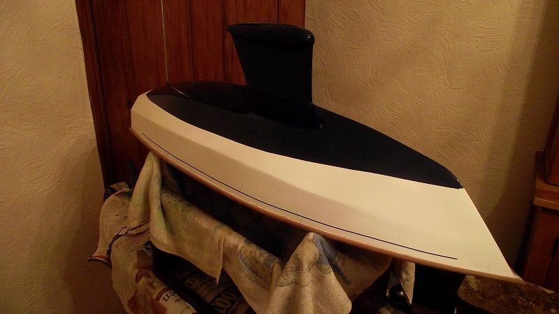

                      Have been busy with the paint brush! After several coats of grey primer/undercoat paint the hull is finally ready for the dark blue below the waterline.
                      I re -positioned the masking tape to about 2mm. away from the primer so that I could feather edge the paint ready for the top coat, so that the paint was not so thick at the edge.
                      The final coat has been applied, it is a dark blue, not black as it appears here, a pin stripe has been added just below the rubbing strake, again in the same dark blue. It only remains to tidy up the varnish were needed and to assemble the mast and she is ready for the water,cheeky although she will remain upside down for a while to allow the paint to harden.
                      Eddie.
                      Edited By Eddie Lancaster on 28/03/2018 21:35:09

                          Looking good, Eddie. Did the coach enamels come out as well as expected? What undercoat did you use?
                          Derek.
                          #76531
                          Eddie Lancaster
                            @eddielancaster
                            Good morning Ray & Derek, thank you both for your comments once again, the first boat that I built was the Varmint DF 65 so I am aware of its sail control etc. and I will be using those ideas as they are the only ones that I know at this stage of my boat building/ operation!
                            The undercoat was B&Q acrylic for metal and outside use, the first three – four coats rubbed down with 800 grit wet and dry, used wet, the following coats were rubbed down with 1500 grit and continued until the colour was solid all over. The craftmaster paint is easy to apply using a soft brush, and three coats applied, the first two rubbed down with 1500 grit, the final coat is rubbed down with 2500 grit until the whole surface is matt with no brush marks showing, everything is then polished using first a metal polish then a good car polish. A bit of a faff but you get a good smooth finish with a nice sheen.
                            Regards to you both.
                            Eddie

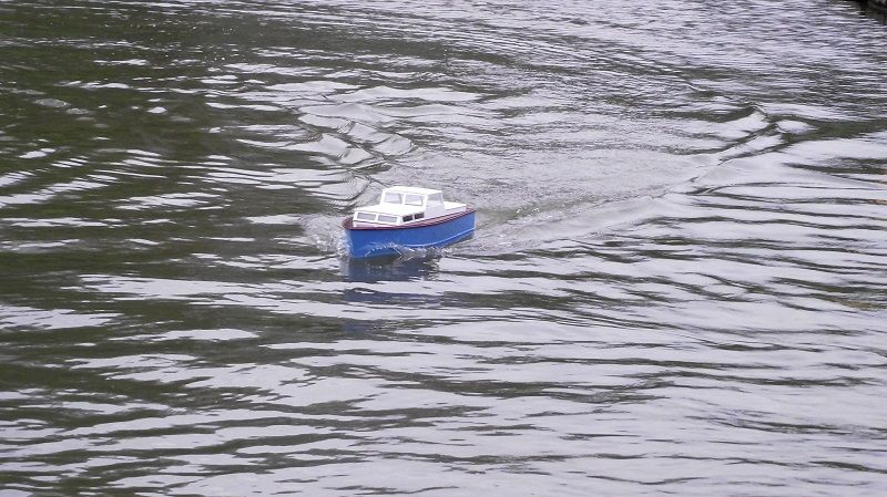

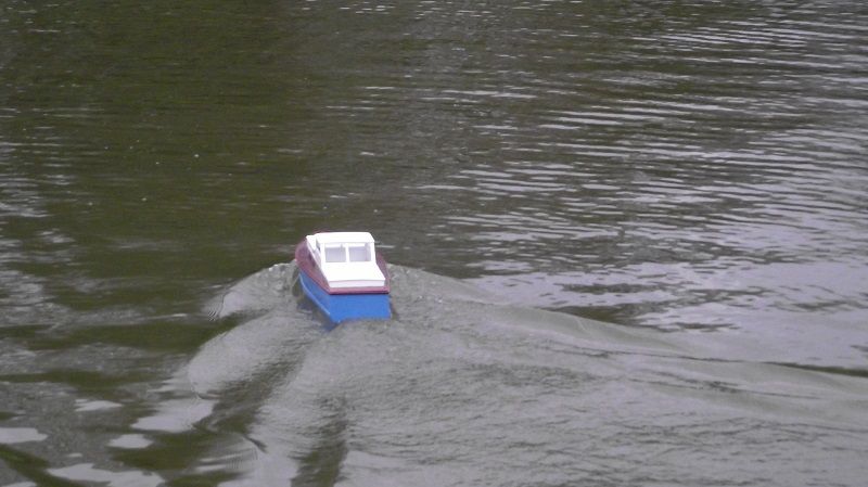

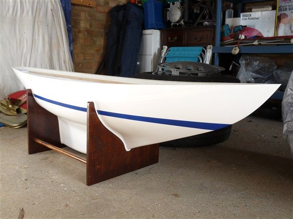

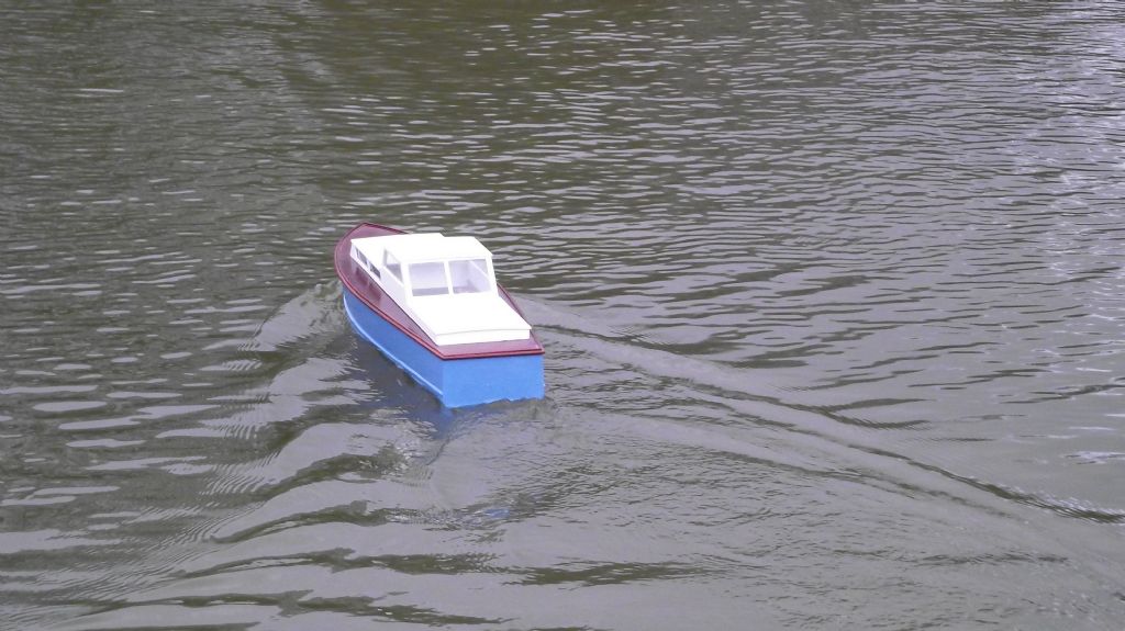

                                Got out with my Grandson today with his boat, Vic Smeed's Moonglow, this was the first outing for both of them!
                                The boat went well and my Grandson enjoyed it, so more of the same next week. perhaps with Ardent.
                                Ardent all ship shape and ready to gocheeky.
                                Will keep you posted!
                                Eddie.

                                  Ardent looks absolutely brilliant. Looking forward to the sailing trials.

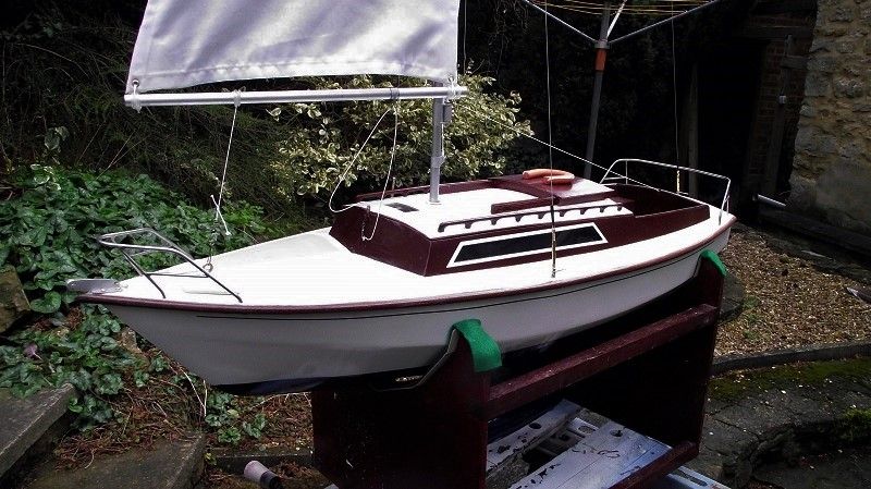

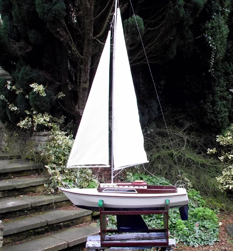

                                                  Below is a yacht I built on a Bob Underwood 'Folly' GRP hull about 4/5 years ago. It was a beautiful boat, 58" oal and, as mentioned previously, I very much regret selling it.
                                                  Derek.

                                                    What a lovely boat, I can see why you want to build Ardent to a larger scale.
                                                    Eddie.

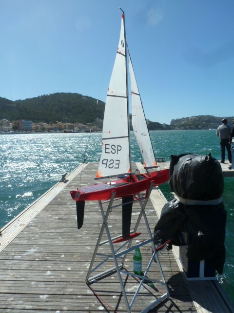

                                                      @timrowe83142
                                                      Derek
                                                      ​What to us is a light breeze will be like a roaring gale to a model yacht. Lengthening the keel as you are planning to do is not very efficient in achieving a good righting moment and neither is it particularly efficient hydro-dynamically. I understand why you are wanting to compromise on the draft and I would get the tallest wellies you can, but it is now going to be especially important to get the weight down a low as possible.
                                                      ​Here is a picture of my International One Metre (IOM) and these boats are highly efficient. The weight is concentrated very low and the foil has a high aspect ratio.
                                                      ​Mine is the red one on a medium rig in what would scale to storm conditions.
                                                      ​I would suggest, if you can, make a lead bulb that is attached externally. Easily done by casting in two halves and bolting through the keel. It is easy to estimate the volume (size) required to get the 3.6 kg suggested by Eddie. You could always aim to be slightly on the heavy side with the bulb as you can reduce its weight by shaving off material or drilling holes and filling with a lightweight material. A hollow keel is going to be a bit more difficult to construct and if not completely filled, water has a habit of finding its way in somehow.
                                                      ​Another important factor when limited by draft is to keep the weight of the rig as low as possible. Every gram saved will count.
                                                      Tim
