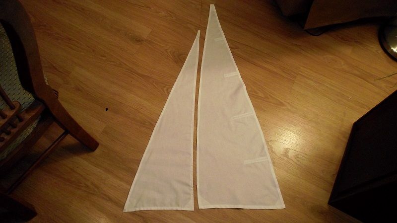

          The resident seamstress/sail maker cutting and sewing the sails for Ardent.
          The finished sails, after some time sorting my leech from my luff and warp from my weft! They may not be perfect but as long as they drive Ardent along I can then get a better set made later if needed.
          We are off to the Ramsgate club sailing site this morning for coffee and maybe a bacon sarny if we are lucky!

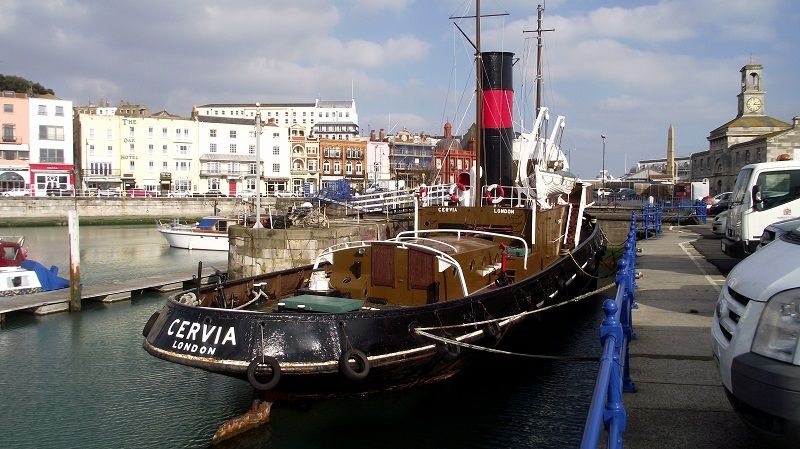

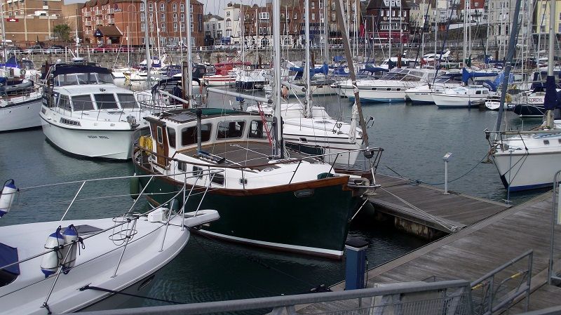

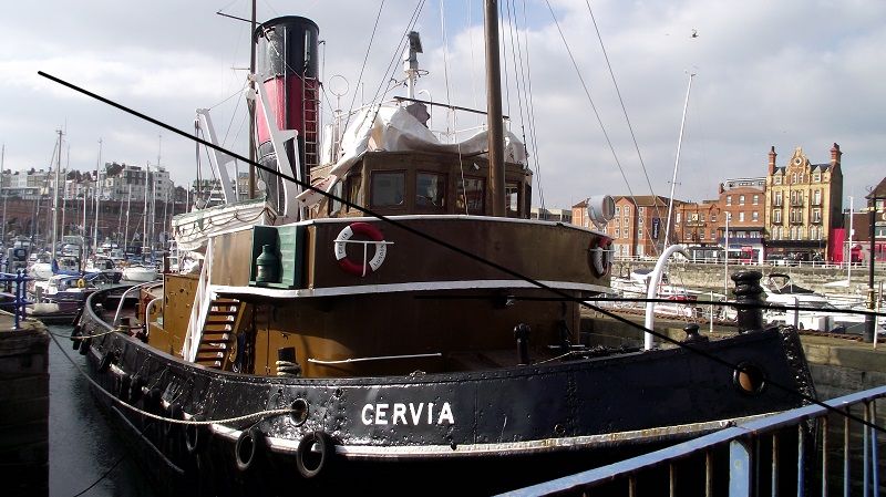

            Been down to Ramsgate harbour today, 4deg.C but felt more -4deg C. A plethora of cruisers both sail and motor to look at colour schemes and fittings Cervia is also moored here.

            Derek Bradley
              @derekbradley32270
              That brings back many memories, Eddie. The last time I was in Ramsgate was many years ago when I made an overnight stop with a Cobra 750 yacht I had bought at Hayling Island and was on way to a mooring I had on the River Crouch. Unfortunately, too old for full size sailing now but I quite envy you living on or near the coast. I got the drawings of Ardent from Sarik today (just could not resist them) and, in addition to the excellent drawings, they included a copy of the original article from MMI, May, 2003.

              Eddie Lancaster
                @eddielancaster
                Hi, Derek. I don't live here I am just visiting my friends for a few days, the photo's of Cervia remind me of the time when I was going to build it as a model, we were visiting the same friends when Cervia was in service with the Sally Line ferry, operating out of Ramsgate, my wife got me an invitation to go aboard were i had the chance to see the engine and boiler room.

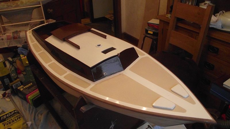

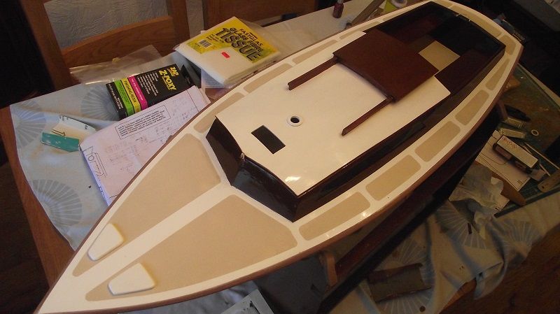

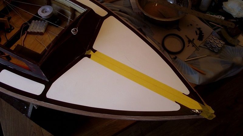

                            The deck of Ardent masked off ready apply the anti slip areas.
                            I used Sandtex smooth masonry paint in the end, although it says it's smooth there is enough texture to look about right at this scale, two coats gives a thickness that stands above the base paint,
                            The next job is the keel weights,I have made the pattern so that I can cast them as soon as we get a dry day, they need to be 4lbs. in total.

                            #76227
                            Derek Bradley
                              @derekbradley32270
                              Eddie,
                              I like the way you have done the non-slip areas – they look most realistic. Your build has certainly come on a long way since your last photos. Keep up the good work.

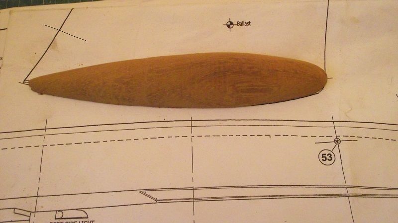

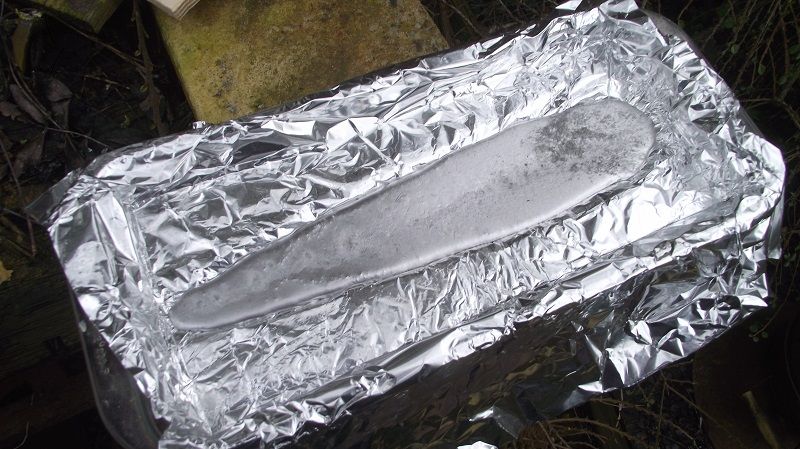

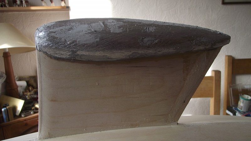

                                      I got out in the garden yesterday afternoon and cast a couple of weights for the keel, using the pattern that I had made earlier I made an open mould in soft sand.
                                      The first casting. I wanted a 2lbs. weight, this one was 2lbs. 2 oz. just right after a bit of fettling. The second one was 5oz. light so that went back into the pan, re-melted, and a third one poured, this one turned out OK.
                                      The next job was to fix them to the keel, this was done using epoxy glue and two brass pins through every thing, clamped together and left overnight, a bit of filler here and there and it will soon be ready for painting.

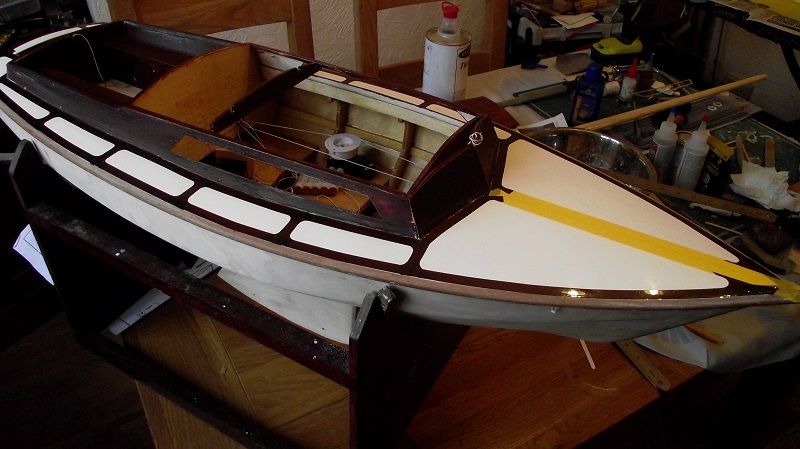

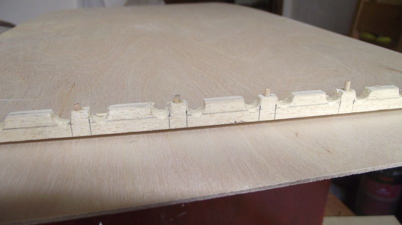

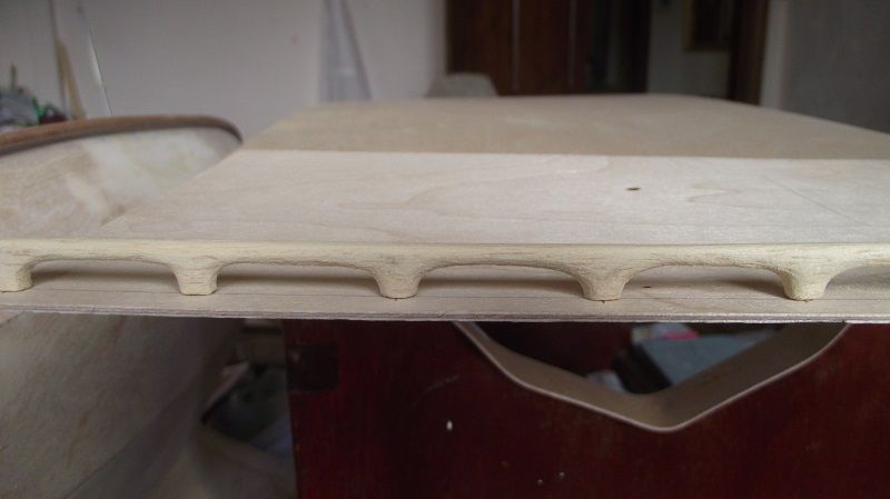

                                        Started to make the hand rails for the cabin top today, this one is ready for staining and varnishing.
                                        This is the embryo of the second, the pegs are pieces of cocktail sticks glued into holes drilled where the supports will be, they not only locate the rails on the cabin roof but they also strengthen the supports. The finished rail is mounted on a piece of scrap ply, this will then be used as a jig to drill the holes in the cabin roof, better to get the holes in the right place on a piece of scrap first!
                                        Eddie

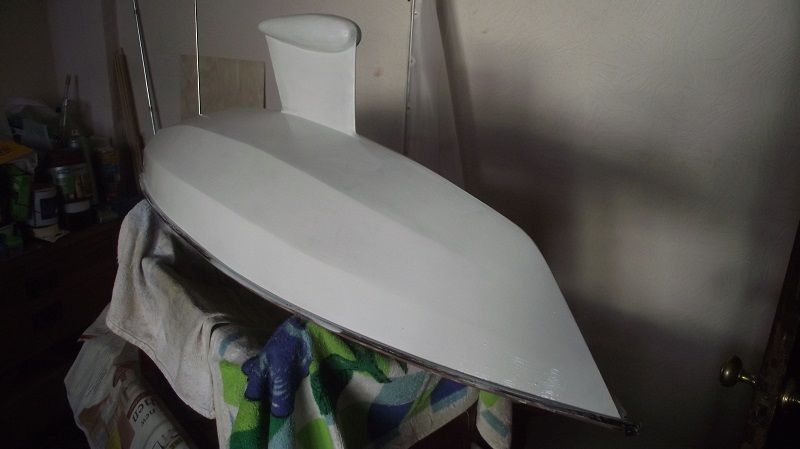

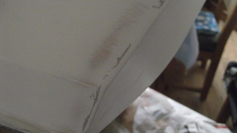

                                          Ardents hull after the first five coats of primer/ undercoat, the first four coats were rubbed down with 240 grade wet and dry paper, used wet, this may sound a bit drastic but I like to rub the first coats almost back to the wood, in fact the wood does show through in places, after each coat has been rubbed down I check for any areas that may need filling, by the time you get to painting, the imperfections should be small and only need a smear of filler, I like the Humrol filler as this can be sanded back to micron thickness, the next few coats will be rubbed down using 800 grade and then finally 1200 grade paper before starting on the topcoats.

                                            Eddie, that looks nice.

                                            Eddie Lancaster
                                              @eddielancaster
                                              Hi. Derek, thanks for your comment, all I need to get now is some decent paint for the top coat,I want either Craftmaster coach paint or International paints. I think I can get them from our local marina, well fairly local,you can no longer get this type of paint from our DIY stores.
                                              Eddie.

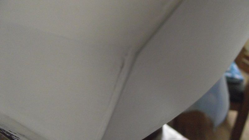

                                                #76341
                                                Eddie Lancaster
                                                  @eddielancaster

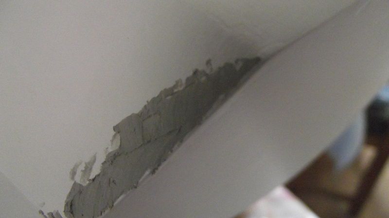

                                                  Hi, Derek, I have ordered my paint from Craftmaster paints at Cambridge, they do a range of paints especially for the the vintage vehicle and steam fraternity.
                                                  Even after eight coats of undercoat and you think you have eliminated all the blemishes another one pops upsad.
                                                  So on with some more filler! It looks like far too much but it was a bit the size of a good match head.
                                                  After allowing to dry for twenty to thirty minutes a quick rub down with the wet and dry and it's back to the paint tin.
                                                  Even after eight coats the paint is not that thick, you can just see were the wood is showing through.
                                                  Eddie.
