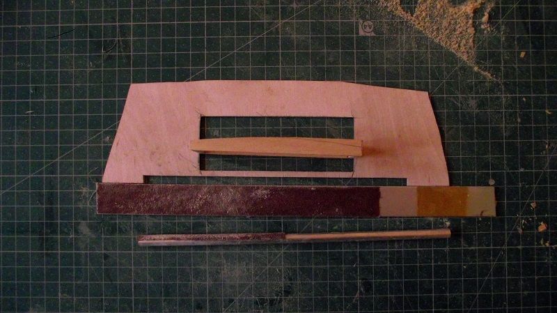

      I'm not sure if the following is of interest or help to anyone, but having to look after the pennies I have made my own abrasive tools.
      I bought a roll of Norton expert cloth backed sand 'paper' it is 115mm. wide x 5mt. long, (enough to last a lifetime, well mine anyway!) from B&Q it costs about £14.00. It comes in various grades mine is 80 grit, it is easy to cut from the back using a stanley knife to whatever size you need, this is then super glued to a piece of aluminium, the flat piece is 20mm x 2mm. x 260mm. long, the round one is 6mm. dia. tube. I have been using them for the Ardent build and they show no sign of wearing out yet. In the foreground of this photo is the side of the frame for the rear hatch over the rudder.
      It will fit into the rectangular hole cut in the rear deck cover, and is curved to the camber of the deck.
      Eddie.

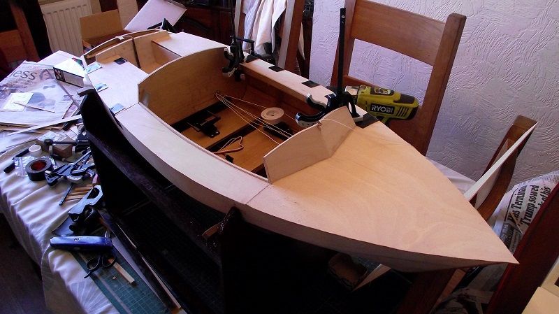

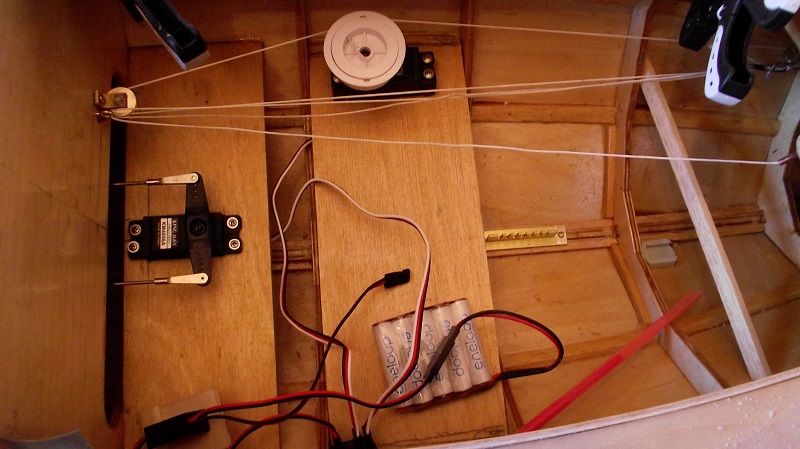

          With Moonglow finished, apart from deck fittings and railings etc. I can now get back to Ardent.
          I have now put the sail winch, rudder servo and associated gear back in the hull, with room to spare! I had to remake the original pulleys I had made as the ones from Poland were not suitable, I made the groove for the cord deeper and brought it out to a near knife edge at the rim, this then allowed the cord to stay on the pulley if it went slack for any reason, it all seams to work fine now.
          With the radio gear in place I have now started to fix the deck sheets in place, as I have varnished the underside of these pieces I am using epoxy glue.
          The next job will be to make the eye bolts for the mast stays ant fit the mast, I will also have to start thinking about a colour scheme.

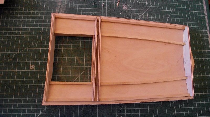

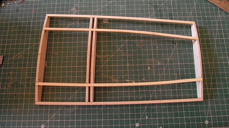

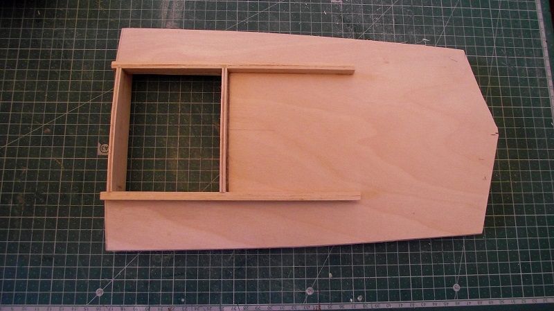

                          Cabin top frame ready for the top to be glued on.
                          The top fitted, and rails for hatch added, I am hoping to make the hatch operational so that I can switch the radio on and off without removing the whole top, if that does'nt work, plan b is to connect a wire to the switch and bring it out through the back of the cabin, perhaps making the end look like a door knob!
                          I have now got to start thinking about staining, varnishing and painting, and what needs doing first, before assembly.

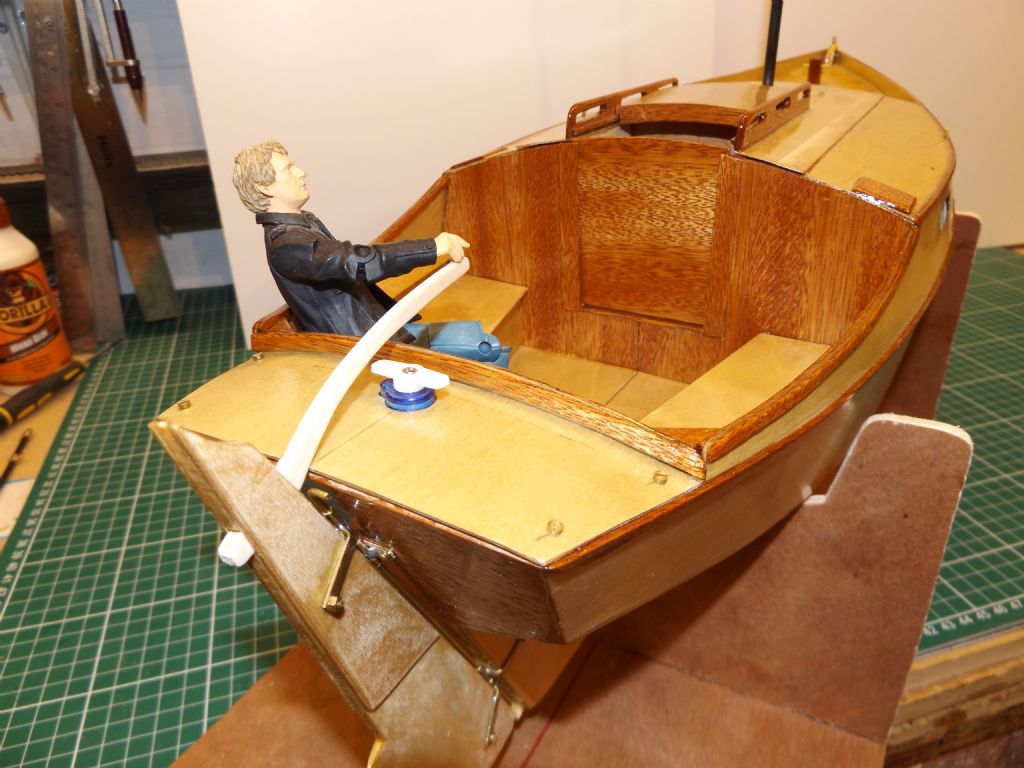

                                I was not happy with back of the cockpit, the back is formed by the last frame that is 5mm. thick, the half round coming on top is 8mm. wide which was going to leave an unsightly overhang, had I spotted this sooner I would have added a thickening piece before I built the cockpit so I decided to add it now, it consists of two pieces of 3mm. light ply, this is easy to cut with a stanley knife to get a good fit.The first pieces that I cut I regarded as a pattern for the final ones that fitted to my satisfaction, it had to be in two pieces because of the mainsail sheet tube The thickness of the cockpit back is now the same as the coming and should look much better, and the tube is within the back.
                                The piece in the backround is the second half.
                                Eddie.

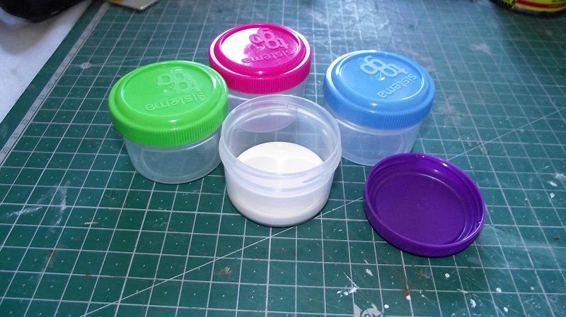

                                      Just been to Dunelm, it's Thursday so that means coffee and toasted tea cake! found these, 35ml. pots with srcrew top, ideal for paint mixing and storage 1.99 for 4.
                                      Eddie.

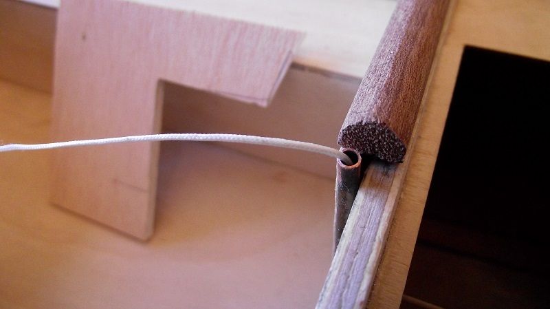

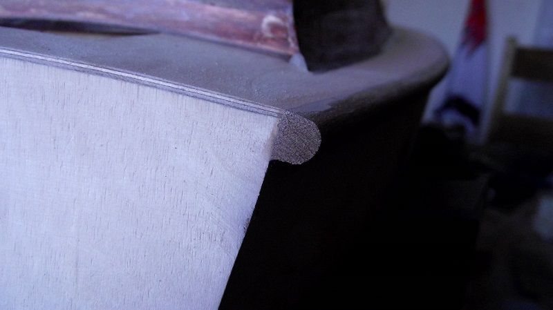

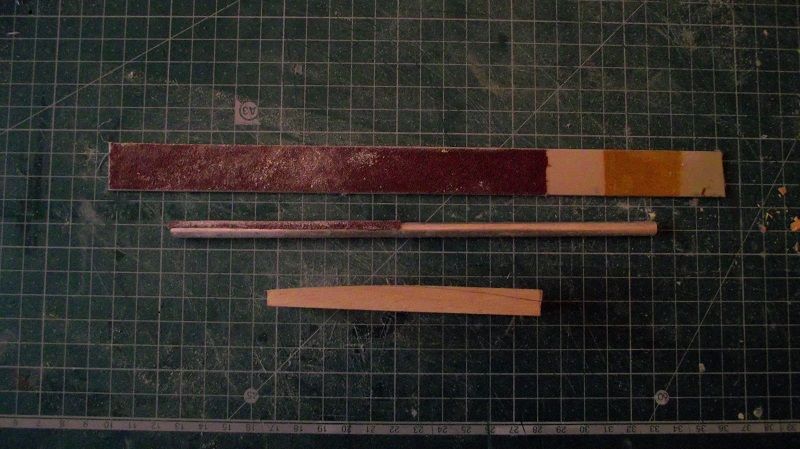

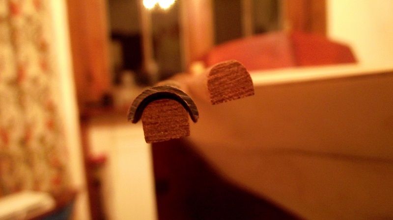

                                        I don't think you can get half round mahogany strip so I had to make some, the drawing specifies 8x 8mm. half round but I could only get 10x8mm. I planed this down to 8x8mm and added 150mm to the end as 36" was not long enough, I then planed it to roughly half round and then finished it with my home made sanding tool,
                                        This is a piece of 12mm OD aluminium tube cut in half length wise and then a piece of 80 grit cloth backed emery glued inside, I then used this to get the final shape.
                                        This has now been fitted to the hull ready for final prepping before varnishing.
