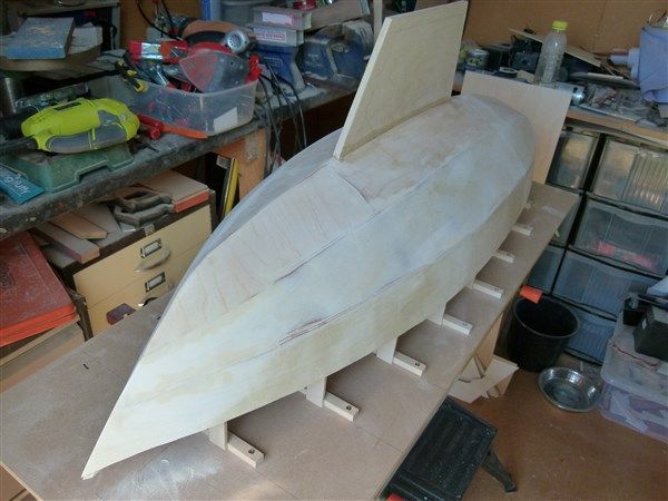

            #76935
            Derek Bradley
              @derekbradley32270

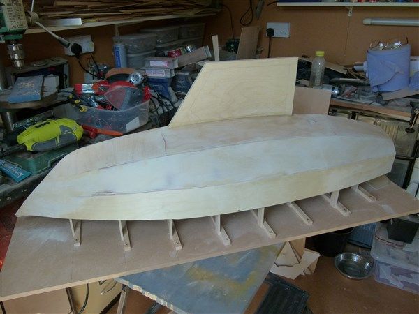

              At last – beginning to look like a yacht. Some may notice that I have increased the length of the keel (fore & aft) but not the depth. I am considering cutting out the centre of the keel, filling it with lead and adding 1.5mm ply panels each side. I know that that amount of lead will be insufficient but, when nearer completion, I can ballast the hull down with more lead and then fit it as a moulding at the bottom of the keel or as a wing keel. At least those are the thoughts at the moment.
              Derek.
              #76937
              Eddie Lancaster
                @eddielancaster
                Good morning Derek, as you say it is beginning to look like a yacht, you are getting on well with your build, it's difficult to see that it is larger than the original from the pictures but the lines are just the same of course.
                That sounds like a good idea to put some lead into the keel and then add more later when you can see how she sits in the water, it is always difficult to know how things will turn out when you deviate from an original design.
                I am looking forward to the next stage of construction.
                Eddie.

                    #76949
                    Derek Bradley
                      @derekbradley32270
                      The deed is done – one keel with one big hole. Now to get some lead sheet to fill it.
                      Derek.

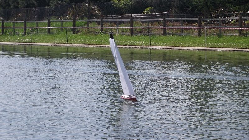

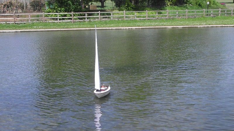

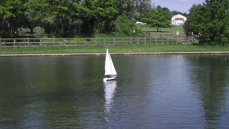

                            #77163
                            Eddie Lancaster
                              @eddielancaster

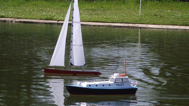

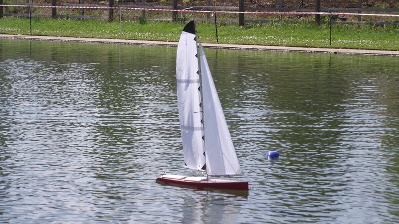

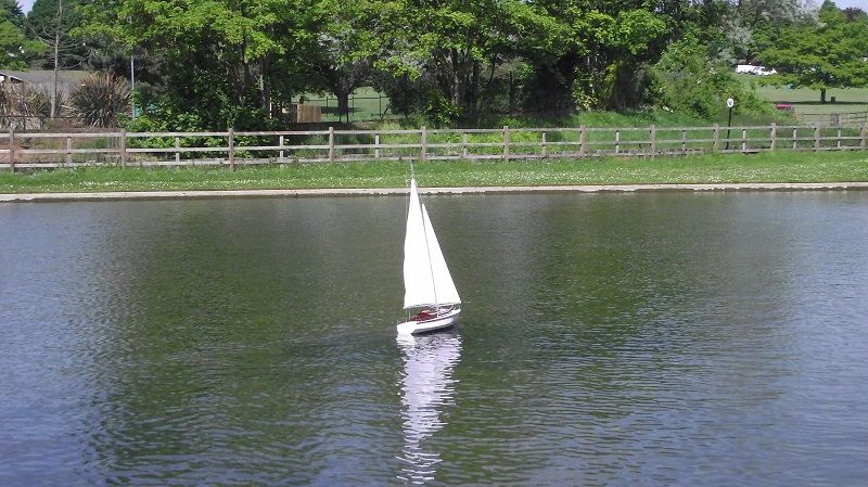

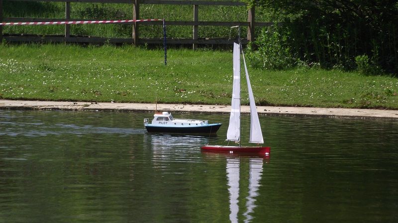

                              Ardent on the water at Wicksteed Park with my new club.
                              Racing Sparrow out for the first time.
                              Sailing in 'formation' with a pilot boat
                              That's all for this week, until Thursday and the the following weekend is Model boat Mayhem I hope I may see some of you there.
                              Eddie.

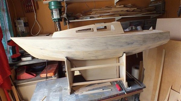

                                        #78180
                                        Derek Bradley
                                          @derekbradley32270
                                          Well, as you can see, things have moved on but rather slowly – my normal build rate!!! I am now working on the cabin but the temperature in my workshop is ridiculous – so hot that it is only possible to stay in for no longer than a couple of minutes. I want to fibreglass the hull but that is impossible at the moment. I have got the mast and boom sections and, hopefully, have collected all of the other bits and pieces for deck fittings, standing and running rigging. Sounds ridiculous but I wish that things would cool off a little.
                                          Derek.
                                          #78184
                                          Eddie Lancaster
                                            @eddielancaster
                                            Hi Derek, I have been thinking about you and progress with your Ardent, she is looking good, I do like the shape of the hull.
                                            I have been sailing at least twice a week with mine and I am trying to fine tune her, I am now on a third set of sails and have another main sail on the dining table at the moment.
                                            the main problem has been her coming up into wind, especially during gusty winds, she would spin round before I could let the sails out, I have now moved the mast forward by about 1 inch which has improved things and I am hoping a new main sail slightly shorter in the foot will improve things even more. If I need to move the mast any further forward I will have to fill in the forward cabin roof light shown on the drawings and alter the mast foot fixing inside the hull.
                                            Eddie.

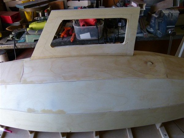

                                            #78334
                                            Derek Bradley
                                              @derekbradley32270

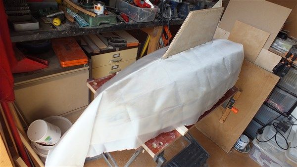

                                              Thanks for your comments, Eddie. Glad you are enjoying your sailing. I have now got one step further – I have given the hull a coat of epoxy resin and, unfortunately, I ended up with a rather bad orange peel effect so I had to do a lot of sanding. As can be seen from the photo, I am now ready for a coat of glass cloth and it is draped over the hull ready to go, but that means another very early morning rise to get the epoxy coat on before the temperature gets too highsad. I think that I have now got all the spars and fittings in hand ready to fit. I was hoping that a club member was going to make the sails for me but he does not make them for groovy masts, which mine is, so I have ordered them from Nylet.
                                              #78335
                                              Derek Bradley
                                                @derekbradley32270
                                                Hope it's not ominous but that looks rather like a shroud.sad
                                                #78337
                                                Eddie Lancaster
                                                  @eddielancaster
                                                  Hi. Derek, don't worry it will soon change when you get the resin on to it.
                                                  Over the past few weeks I have slowly got Ardent sailing better, I am now on my 4th. or 5th. set of sails! some larger some smaller, I have moved the mast forward about 1" to the back of the roof light in the cabin roof, I did this to try and improve its tendency to spin into wind if hit by a bit of stronger gust, this helped and the current suit of sails with a slightly reduced mainsail area and increased jib sail has made it much easier to handle, I have also moved the pivot point of the jib boom right to the end of the boom and anchored about 1" back from the point of the bow, all of these changes, made one at a time, has made her more responsive to the rudder and will sail gull winged before the wind and with less tendency to round up into the wind when on a tack.
                                                  Regards.
                                                  Eddie.
