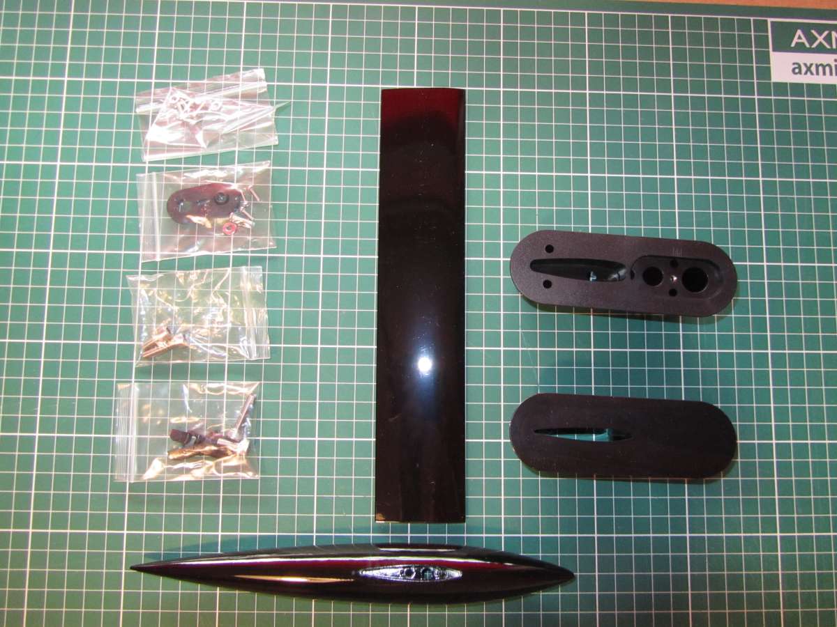

                                            Still not being able to spend much time on the boats but this evening I decided to have a look at the keel box. Having decided that as I’ve bought them I’d see what I can do with the DF parts.
                                            So drastic action was taken with the hacksaw, Stanley knife and file! Plan is to glue the upper and lower dagger box parts together to make a watertight whole. The bottom will be epoxied in place flush with the bottom of the hull keel and a fabrication made to which the DF top mounting part can be fixed to. I shall leave it in place but I won’t be using the recess for the mast as in the Fisherman the mast is further forward.
                                            I shall now see how this fits in the design of the model. If Ok I can then modify the drawings ready for printing and cutting wood before too long!

                                                  Thanks chaps. Hoping I can get a watertight join between the two pieces of plastic otherwise I will have to build an outer box similar to Ray’s example as a second line of defence.

                                                      Sorry if I’m misunderstanding, but the plastic parts effectively form a tube from the underside of the hull keel to the top of the daggerboard where you bolt down into the top of the keel, so you can’t have anything inside the tube as the keel is in there. The top of the keel is therefore restrained as is the part passing through the hull keel and so the plastic tube is mainly to stop water ingress and to line the inside of where the drop keel passes through the hull keel.
                                                      However I’ve been doing some drawing and have started off with a keel box to support the top of the daggerboard but I’m now thinking to just position the joint in the tube inside the hull keel, wrap the drop keel in clingfilm and epoxy it in like we do with the prop shafts etc. as the idea initially was to avoid having a keel box and it’s an area where water could get trapped if you are not careful. The dagger box that Ray and Tim use in their builds is simple and effective for the design of boats but I have the added complication of a significant protruding keel (ballast keel on the full-size) which I’m using mahogany for and I don’t want any joints in it below the hull, so the drop keel needs to pass through it.
