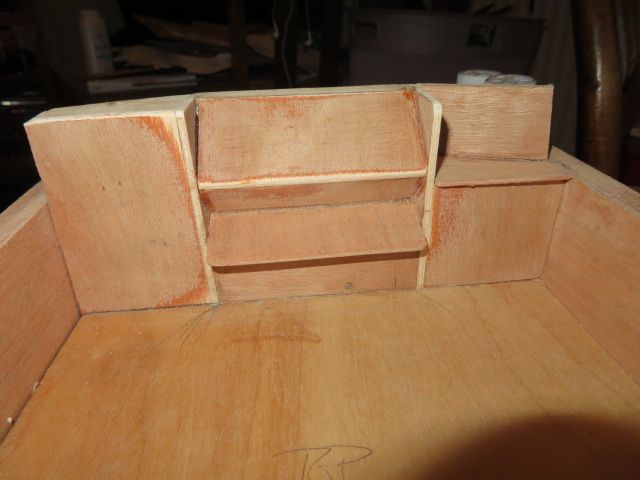

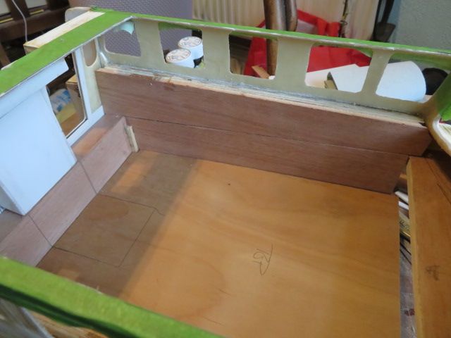

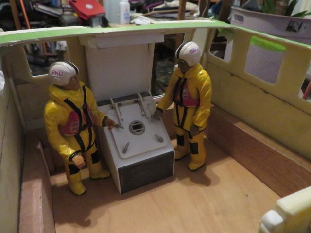

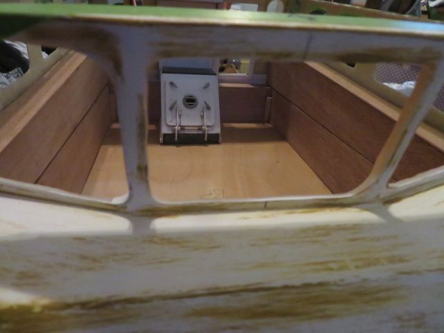

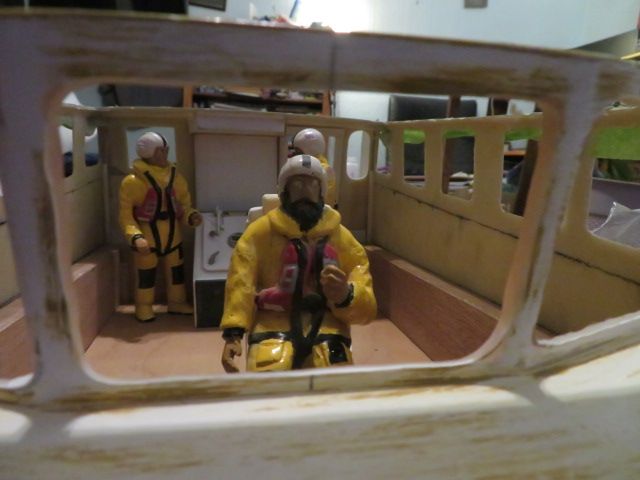

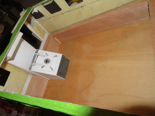

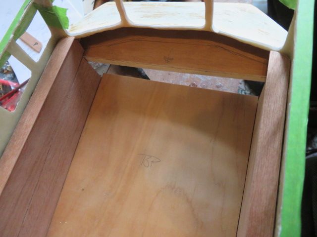

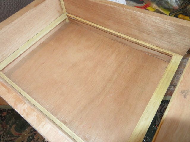

          i'm glad I had a little "play" with my toy lifeboat men last night……..because I realised that the floor was too low..
          it was too low by an inch…..a foot in scale terms….from one extreme to another, and looked rather silly.
          so tonight I fitted a false floor to begin with by putting some beading in, and then fitting a false floor. that raised it to the correct dimensions as taken from the plans.

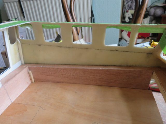

          #89992

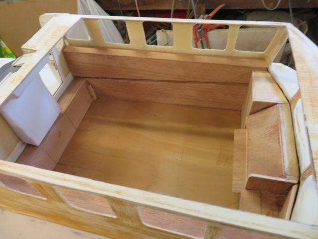

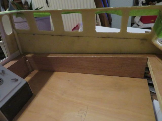

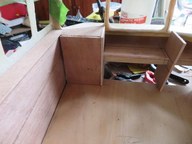

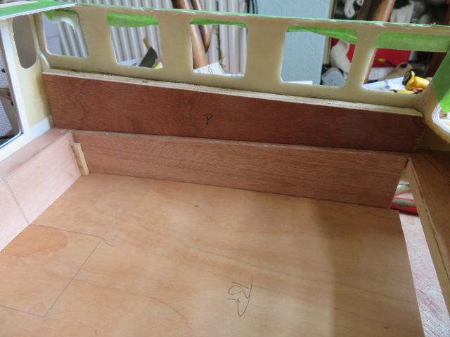

            I then, fitted the panelling to the rear of the cabin to line up with the engine room companion way.
            Tomorrow the side sills, which slope downwards from the bow to the stern of the grp cabin,and have been marked both top and bottom lines will be brought level just under the window line, which will allow the air conditioning outlets to fit onto the ledge. I re introduced my little fellows at this point and they could now see over the bottom window line, lol………success!!!
            it will be then, that I will feel confident enough to tackle the forward bulkhead.

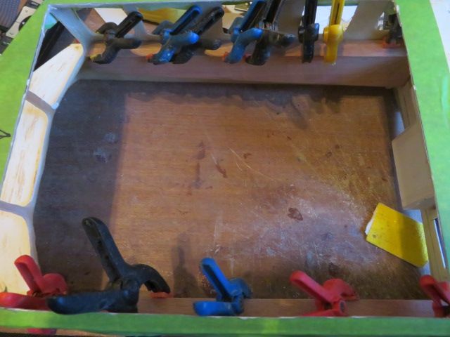

            #90014

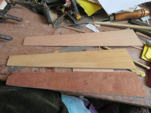

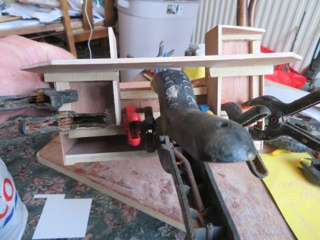

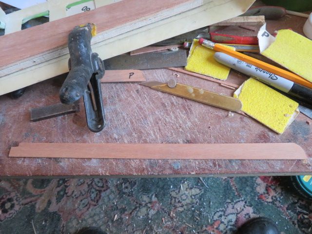

              This afternoon I made the side fillets for leveling up the window "sills" for putting the air conditioning units onto.
              They were made of three pieces of plywood, measuring the needed 15mm thickness, and contained a total of 11 plies of timber, all glued together with aliphatic resin. the final pieces with capping tops will be glued to the grp cabin walls with 30minute epoxy.
              I don't think they will twist anytime soon,

                Sorry Neil, but have missed something, why is the floor sloping?
                #90017
                  an optical illusion Bob………….the floor isn't sloping but the roof of the cabin is……sloping to the bow, which then gives the measurements all a kilter on the sides attached to the cabin…….
                  but if you wait about an hour until glue has dried, all will be revealed as nice and straight.

                      Oh no bob, not at all, and all will now be revealed.after the layers had set they were held in place whilst the top capping rails were measured up and cut to fit, and
                      the side panels were glued in place using 30 minute epoxy. Once set and cleaned up the capping tops glued on with aliphatic resin…..and now left to set.
                      And here is the result of my labours.
                      #90021

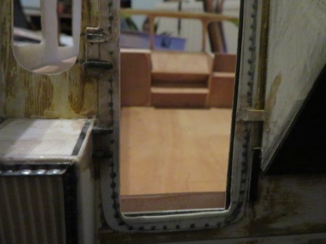

                            #90052

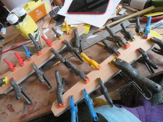

                              last night I saw the dawns early light whilst watching the old film, Day of the Triffids, and fabricating the port side compasnionway for the W/T door into the lower bow survivors cabin, heads and other stuff, plus I made the starboard side partition between the helms controls and the radar screen…..coming on slowly……all in a rough state but need to be filled and sanded down later.
                              and then this afternoon, started to put the parts into position, using aliphatic resin.
                              a few clamps needed, lol.

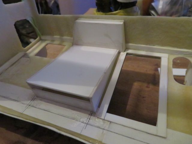

                                    oh right…….well there is a small problem there Bob in that the inner cabin deck doesn't fit into the receptive hole in the deck at the moment, as the raised combing that the inner cabin rests on needs trimming down, and I haven't been too bothered to do that until the main fitments are made in the cabin.
                                    however as those will hopefully be completed by late tonight, I will "attack" the combing tomorrow with a grinder lol.

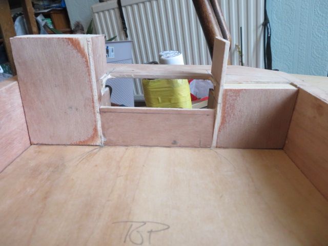

                                    #90060

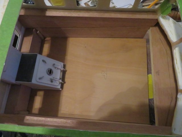

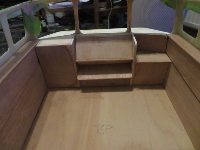

                                      and I had to finish it before I got under the duvet..

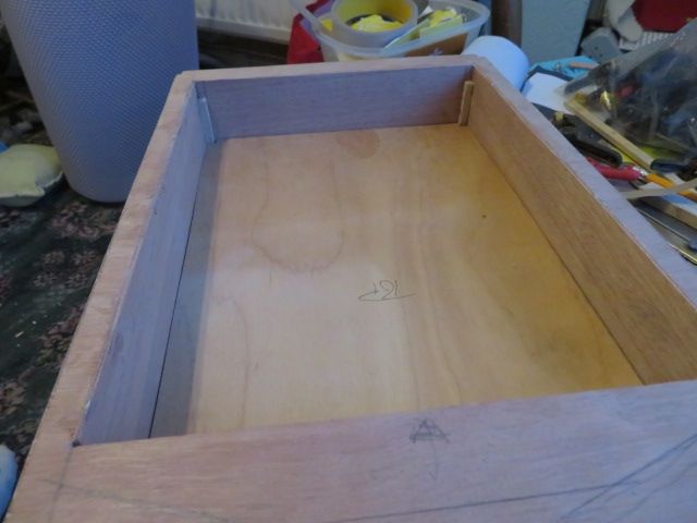

                                      the forward bulkhead in the main cabin has been fitted.
                                      i'll get the stands for the 6 seats done next.

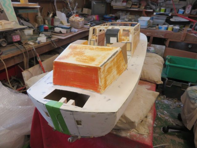

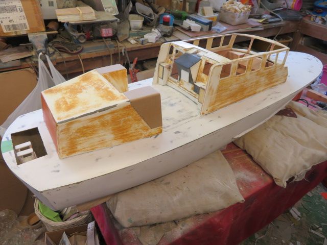

                                      #90071

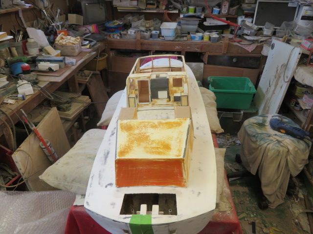

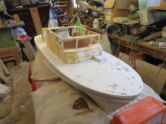

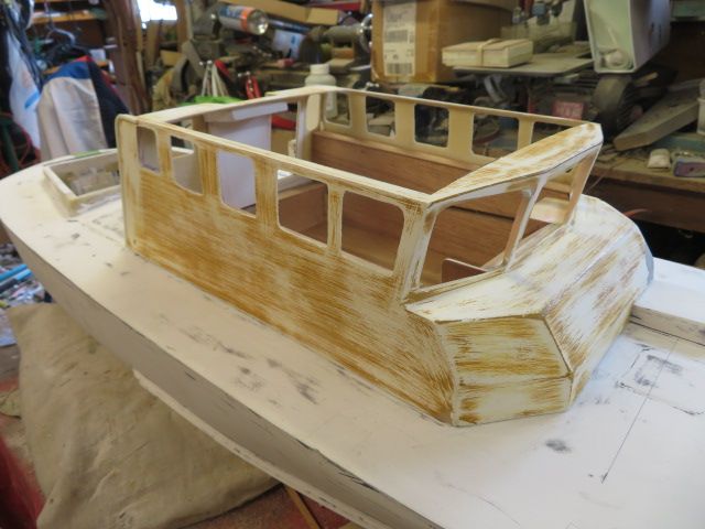

                                        just for you Bob, some general views of the boat so far
                                        #90072
                                          img_5797.jpgI finally got round to trim the combings down so that the inner cabin tray could fit in.
                                          I then offered both the cabin and the iner tray up to the boat.
                                          slight discrepancy in the measuring, and the cabin fits down to the deck, but the inner tray sinks lower onto the combing leaving a gap down the sides, the rear of the cabin and just above the fore bulkhead meeting with the front window frames by about 6 mm.
                                          as such I will fill those with a small fillet of cherry tomorrow
                                          not a big deal in the grans scheme of things.
                                          but this evening as I had said to myself last night, I made the tapering pedestals in two different heights for the 6 chairs for the cabin.
