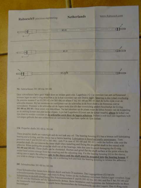

                                          Len Morris 2
                                            @lenmorris2
                                            Alasdair,
                                            Have a look at the prop shafts used on model submarines (it’s a bit hard to keep the inboard end above the water line!).  I think the most common are the Dutch Raboesch water proof type.  Expensive but good insurance.
                                            P1050511
                                            Note the instructions tell you how to shorten the shafts to suit your model exactly.
                                            Len.
