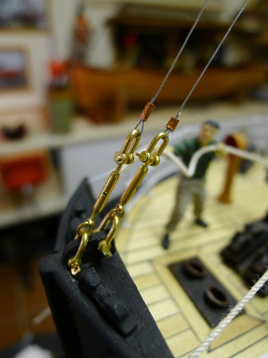

          Alasdair, you are quite right to be concerned as regards the suitability of kit supplied white metal components in rigging.  Frequently they simply are not strong enough to take any sort of tension and either deform or break.
          I tend to replace all white metal bottle screws with brass working ones so you can tension things properly.  These should be connected in a way that reflects real practise, frequently with running rigging ropes ended in a loop fixed with a short length of black heat shrink to simulate a tarred canvas cover over a splice and standing rigging wires ended in a loop with a short length of heat shrink painted grey to simulate a swaged thimble.  Bottle screws should be connected with shackles and eyes where appropriate.  I get my eyes from chain links.  I fix things into bulwarks with threaded eyelets, screwed into a hole drilled into the bulwark at such a size to enable the thread to cut into the wood, but wiping the thread with epoxy before screwing it in.
          For mast fittings if there is no loading then I might use the kit supplied part but, for standing rigging anchors I might use a scratch built brass ring.
          Two shrouds at the bow:

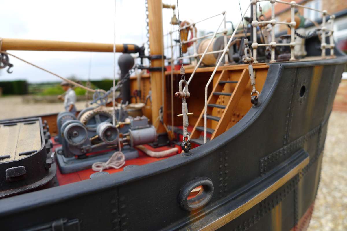

          Two side shrouds painted up and weathered:
          01-05-24-51BenAinConstruction 824

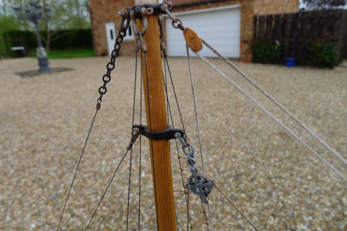

          A mast head arrangement:
          01-05-24-34BenAinConstruction 807

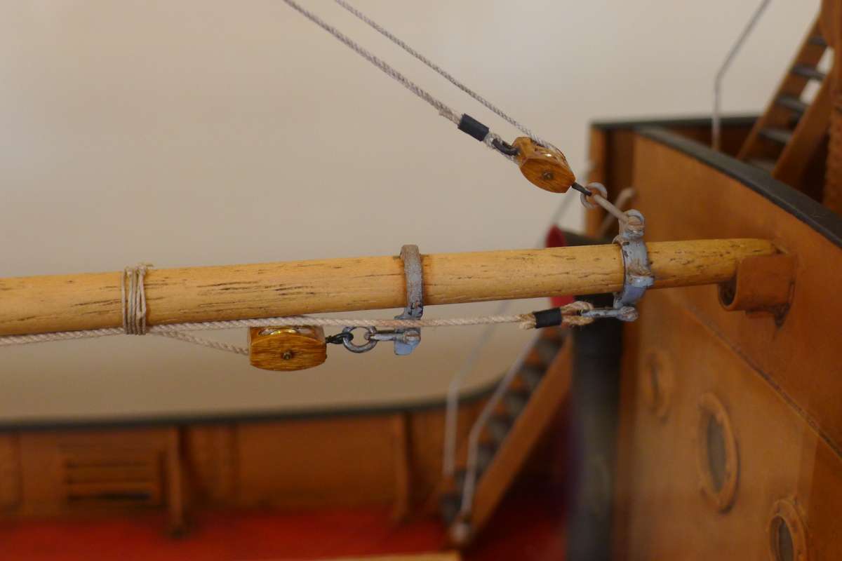

          And some running rigging on the mast:
          05-04-21-07BenAinDerrickRigging1

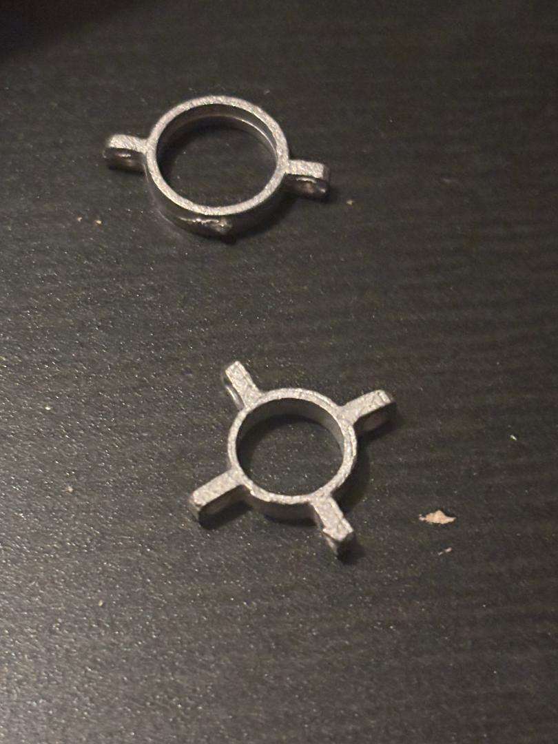

                boom collars

                  Can find brass replacement for most white metal bits except these – have searched for them under boom collars, mast rings etc. Looking for both the two lugged and four lugged varieties! Anyone know where to find them please? Thanks a

                    Something as specific as that may have to be scratch made.  Not as horrible as it might seam at first.  The easiest starting point is to find a brass tube of the right internal diameter from which you simply cut a slice off the end.  The tabs are made from brass bar stock cut and shaped, drilled and then silver soldered to the brass ring.
                    As I mentioned above though, strength might only be an issue if you are putting a fitting under some tension, as with standing rigging.  If the fitting is to attach running rigging then the supplied white metal fitting may well be fine for the job.
                    Another approach can be to use the supplied fittings but with very little tension on the rigging so they are not likely to bend.  This can be achieved by using elastic cord for the rigging to give a tensioned look without the high loading on the fitting.

                        I had exactly the same problem a few months ago when I was finishing off my puffer. I spent ages searching without success. In the end I did the same as Richard with a piece of tube & small pieces of scrap brass. I also made a pretty passable effort with a drilled piece of tube fitted over the mast with a very small screw eye screwed and epoxied in each of the four holes.

                          Thanks Stephen- I am quite surprised that these fittings are not available. Will look at the option of using screw eyes – hadn’t thought of that!

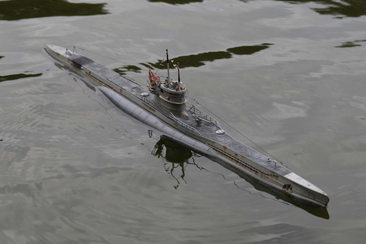

                                Elastic cord certainly has a life but I rigged my Revel U-Boat with it in 2006, so its nearly done 20 years and it is still fine.  I used black cotton for the two stern lines and elastic cord for the bow line to provide the tension.
                                09-09-07-07WiltonParkRevelU-Boat20

                                      Exactly the situation on the U-Boat.  You can just see the hook on the front of the insulators in the rigging.  Unhooking the elastic allows me to remove the deck and bridge unit.  Rehooking simply tensions the rigging again.
