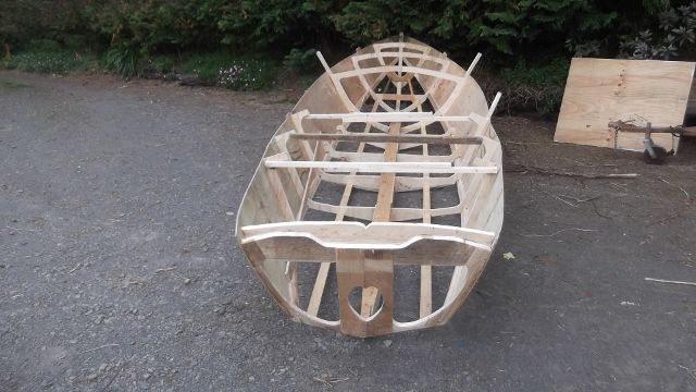

        Well, between mowing the lawn, doing the washing, and throwing the neighbour's stupid goat back over the fence (and then fixing the fence) I got some work done on the boat. All shear webs on the keel are in,
        the stringers are fitted, and the whole thing faired up, ready to fit the bottom.

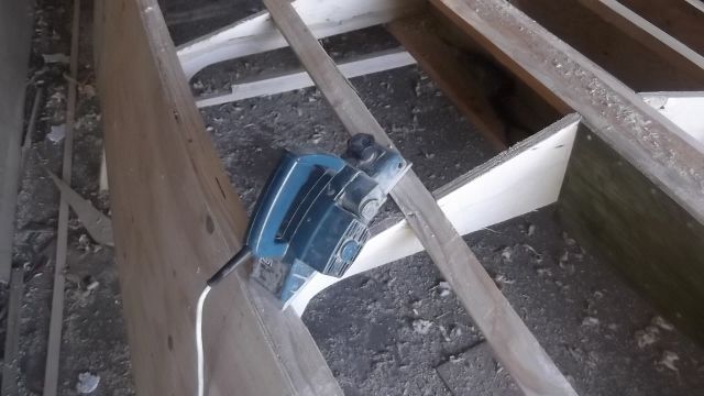

        Whilst a lot of my work is some what rudimentary, when it comes to fairing up I'm rather fussy. None of my boats get fibre glassed, and I pride my self on none of them leaking a drop. My first step is to get it close with the power plane.
        That's a cheap (NZ$30) Chinese job, that's more than ten years old, and has built 3 or 4 boats!

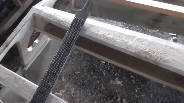

        That's a farriers rasp, (used for dressing horse hoofs). Some 14" long by 2" wide. I work this athwartships to get the bevel bang on.

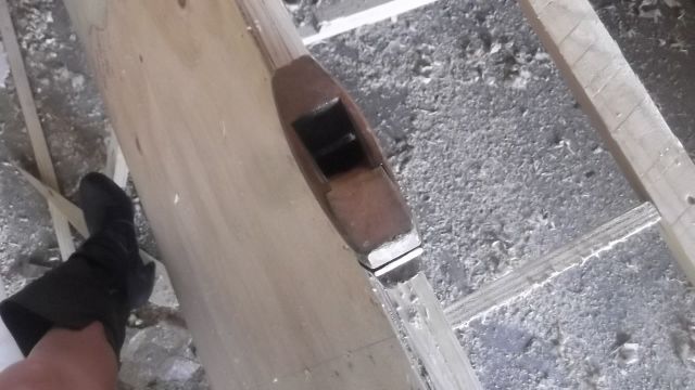

        I then go over the top fore and aft, with the smoothing plane, to take out and humps and hollows, being very careful not to change the bevel.

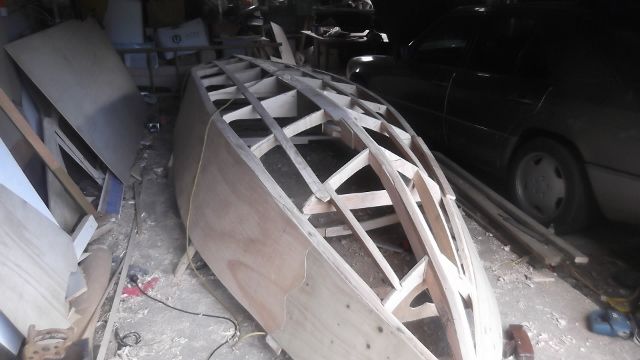

        The owner came over to check out progress, so I dragged the boat out and flipped her over so she could have a good look.

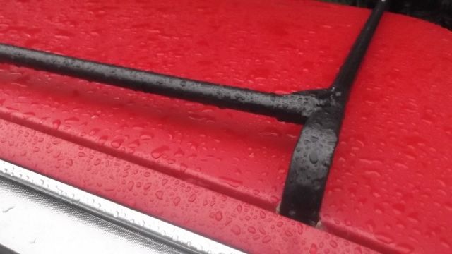

                ….oh and the roof rack is welded up out of discarded weed eater shafts….

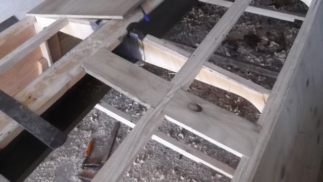

                The paint is also super fast drying too.

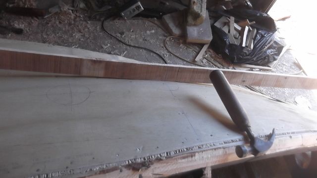

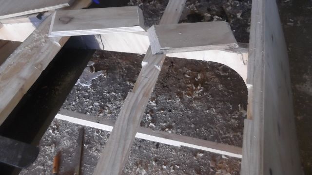

                The butt straps for the bottom panel joins are mitred in.
                This locks them in place and means they can stand the hammer blows of driving in the nails.

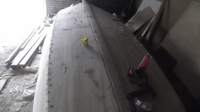

                      More of annoying the neighbours today with whinning power planes, loud hammerings and the occasional sweet and gentle expletive…(mind you the neighbour was making his share of noise too)

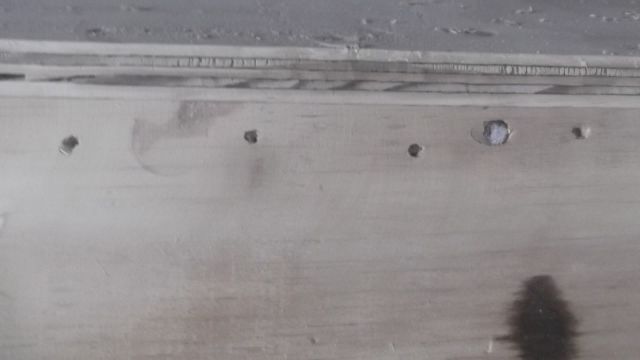

                      Transom ply on. By overlapping the ply bottom, a bigger gluing and nailing area was gained.
                      The gap between the bottom panels was filled in with a strip of timber…..
                      …..and a capping strip of 1/4" ply glued and nailed on top. The bottom was planed and sanded back flush with the sides, and nail heads punched and filled.
                      The reward for all my fussy fairing up….
                      nice tight seams…

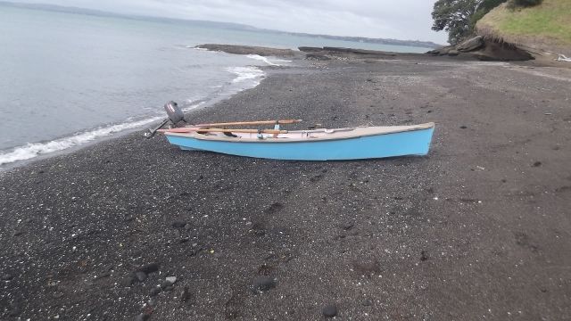

                          This is the biggest I've built to date.
                          I built this 14' skiff earlier in the year.
                          Aj

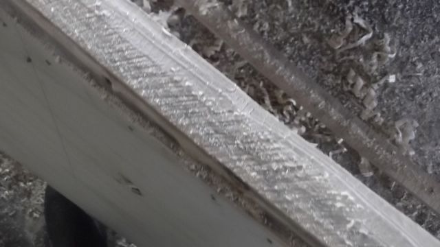

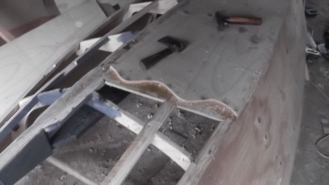

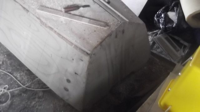

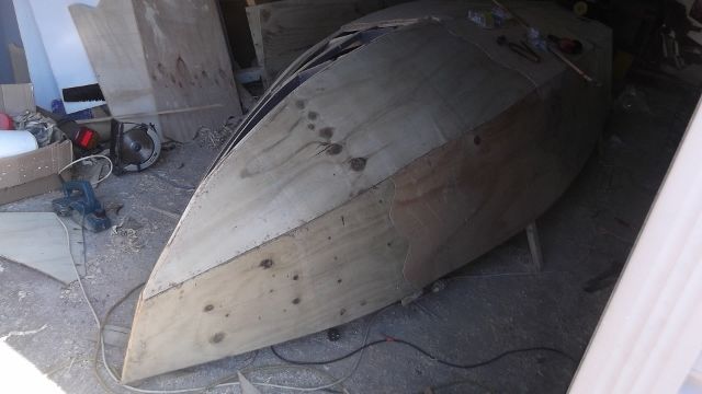

                            Well the first bow panel is on…
                            I've opted to use two layers of 1/4", rather than a single layer of 1/2", to save an awful lot of struggle!
                            Getting a good fit along the chine is a bit tricky, as there is quite a bit of 's' curve in the panel edge. Seemed to go all right though, thankfully.
                            Many will tell you that you cant put a compound curve in sheet ply, but you can, to a greater or lesser degree, depending on the stiffness of the ply.
                            Now to repeat the whole operation three more times…..

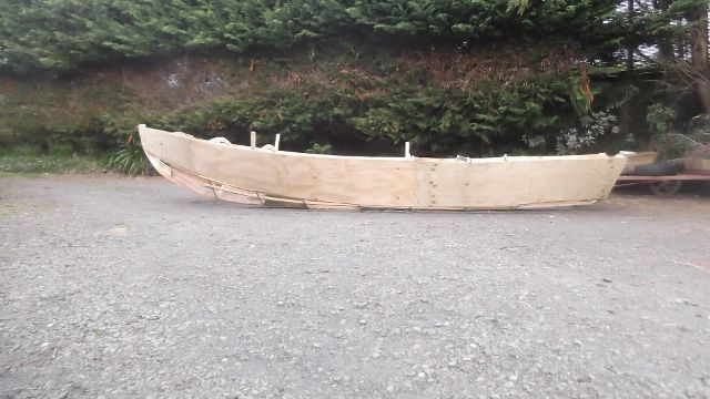

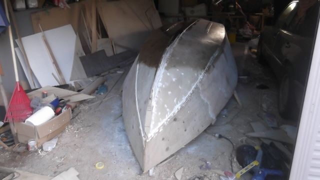

                                  Well the hull is completely planked, lower cut water laminated up from my scrap ply, and the spray rails are on. All the nails have been punched and filled, and the bottom sealed ready for painting. Once painted I'll build a cradle for her, and flip her over…

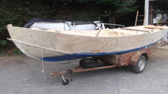

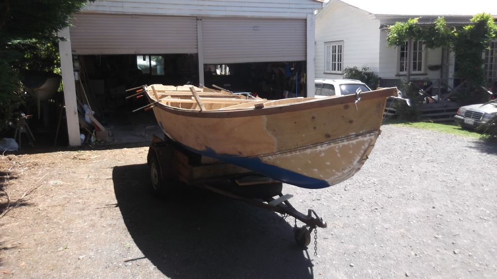

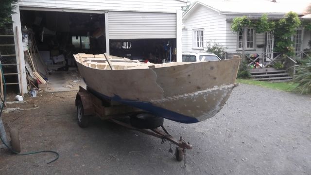

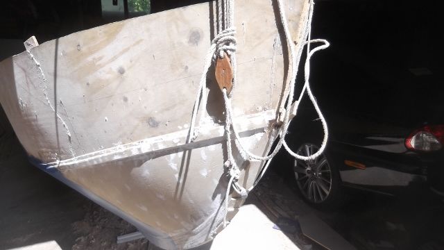

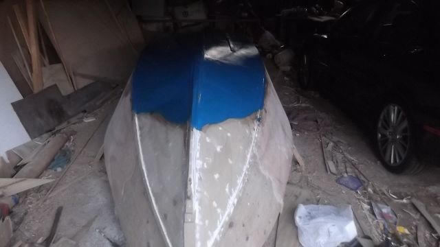

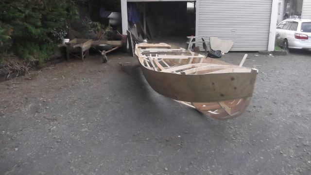

                                      Very blue was requested. I have yet to find a suitable blue pigment. ( it would seem that ground cobalt is not available at my local hardware shop) so acrylic house paint it is. 4 coats of sealer, 4 of paint.

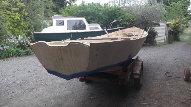

                                      The hull has been turned and put on the trailer.

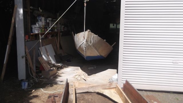

                                      A suitably placed coach screw in the transom and stem, and a handy billy on each end,
                                      Lift one end then the other, and she just rolls her self upright. Roll the trailer under and lower away. Easy.
                                      Because the shape of the stem, and the line of the sheer has such an effect on the boats appearance, I like to get the boat out of the shed so I can eyeball it from every angle to get it right.

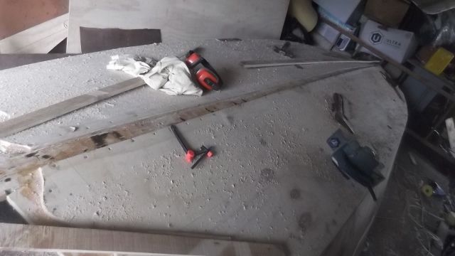

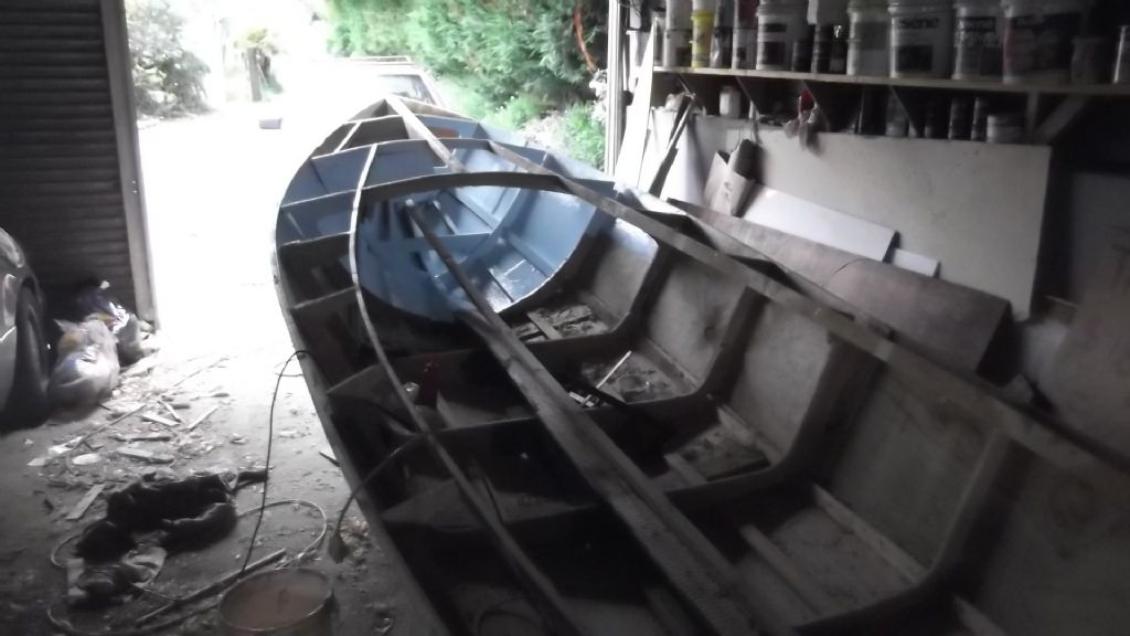

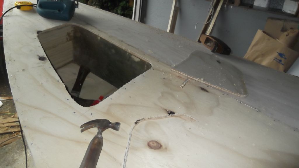

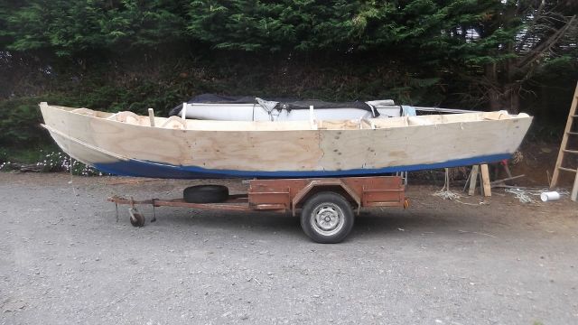

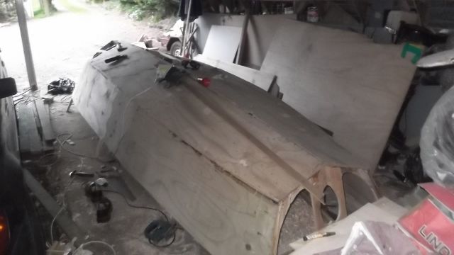

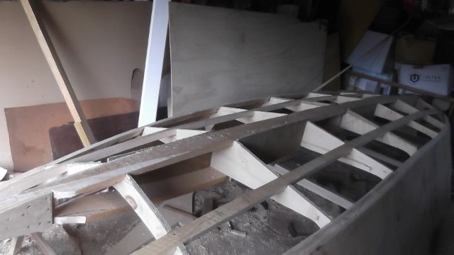

                                                    Well the weather has been awful here for the last couple of days, so a good excuse to shut myself in the garage!
                                                    Had enough fine weather to get the sheer line sorted first though…dscf6766.jpg
                                                    Then it was back in the garage, and off the trailer, to get her to a decent working height.
                                                    All the deck framing in, and anchor well built.
                                                    Foredeck on
                                                    The underside of the deck was given a few coats of sealer first, as the underside of the decks is always the first place to go, if a boat is going to rot.
                                                    #61518
                                                      Anchor well indeed…its the tinnie store surely ! Are you having a hatch on the 4X well or just a combing?
                                                      Looking good on top, nice curves. Are you fitting internal buoyancy (polystyrene/gallon plastic containers or what have you) at the bow/stern/wherever or no?
