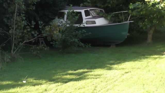

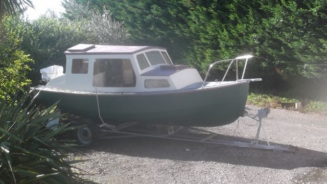

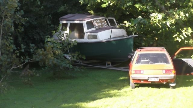

        My little cabin cruiser is an unfinished project on long term hold. She is currently being used as a sleep out, is taking up space in the drive way and hogging a perfectly good trailer. I decided to put her in a more suitable location and lift her off the trailer, and put the new girl on.
        so it was off down the lawn

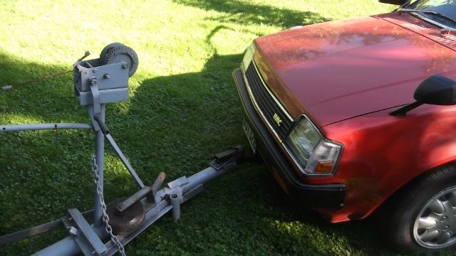

        Hitching the trailer to the front of the car is the way to go. I can see what I'm doing, and the weight over the driving wheels gives enough traction to stall the car with out spinning, even on the soft grass.

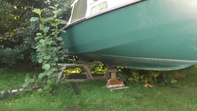

        Getting her off the trailer wasn't easy. Nothing over head to hoist on, soft ground, single handed and only one car jack….no excuses though…
        …job done

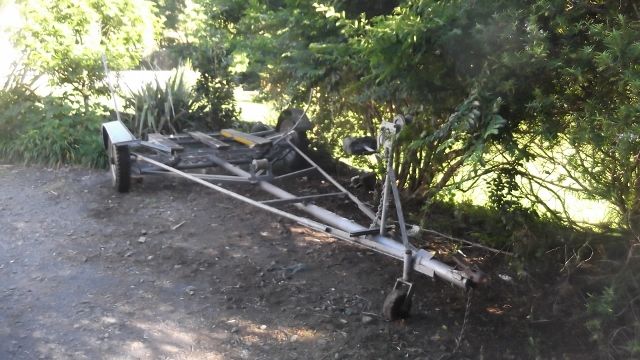

        Lowered down to her final resting spot.
        The trailer ready for it's new occupant. (BTW I built the trailer as well)

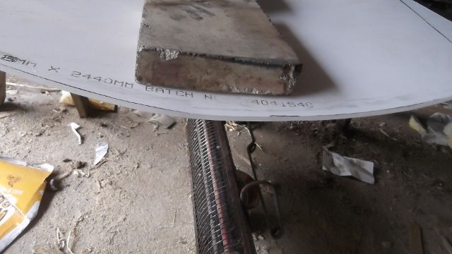

            Time to finish the windscreen. I decided to use a bit of 1/4" perspex for the front. The problem being I had to bend it to fit.
            Plan 1 was a waste of time….
            Plan 2 was marginal, a few more bricks and the heat gun. Got the job done though.

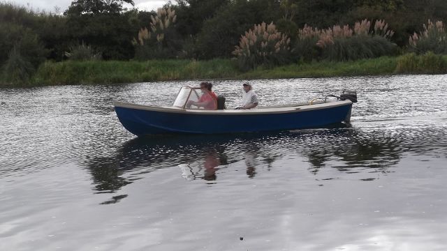

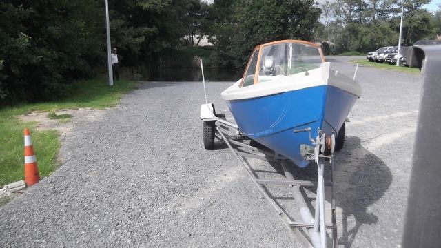

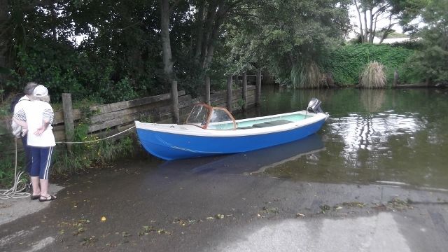

            So she floats…

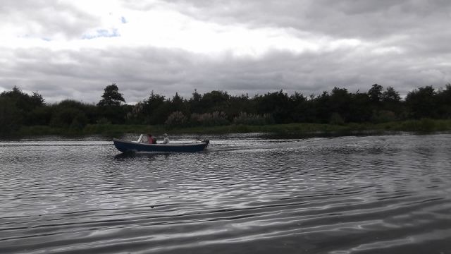

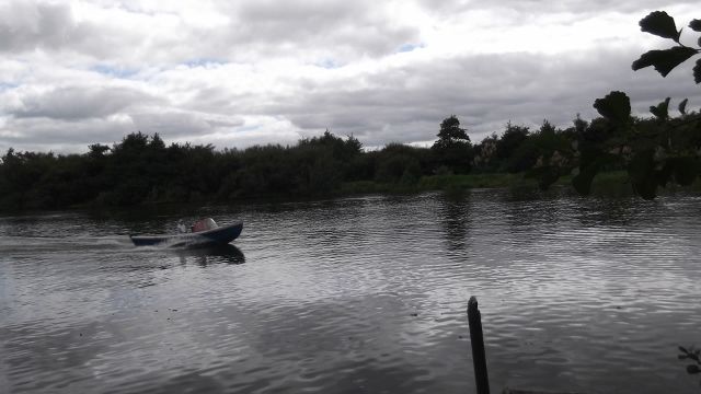

            off for a run…
            She performs well, given only 8hp.
            All the controls worked well, no problems at all, other than having to clear the prop of weed a couple of times… The centre line seating worked out very well. Running cost worked out at $4 per hour, so cheap enough. Building cost around $400.
            Yep, I'm happy enough.
