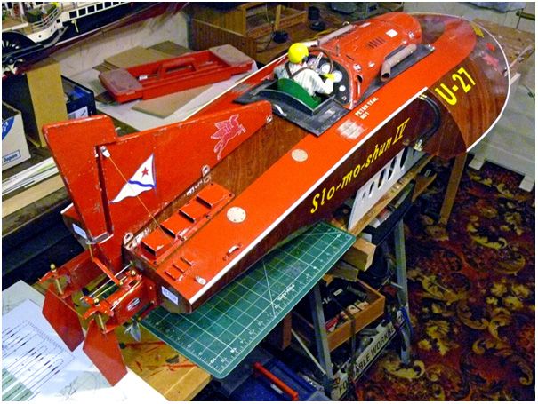

        That`s it chaps!…………………Just waiting for Spring now!
        The workshop has finally ground to a halt!………Quite sad really, got nothing to do!
        It feels very heavy?……..Transportation truck required!
        That should keep me quiet for a short time……..Bob

          Thats just amazing Bob and truly a credit to you. Did you satisfactorily work out your new charger? remember the camcorder when you trial her won’t you!

                Hello Rick……..Thank you also for your kind words
                It`s a pity the weather is so bad lately…..(It`s snowing right now, here in Manchester)…..The big sailing debute is quite a time off……at least a month?
                I`m not very optimistic about any dashing about, as it feels very heavy now?
                I`m predicting a heavy bow wave……Which fellow members will find very annoying……..So I had better be careful and considerate, when the time comes
                However, it should be a great crowd puller at the regattas!

                     Me too Bob best make some chocks though or it’ll run away when you test the motors out of the water

                      Looks great Bob, bet you’re pleased with it.
                      #25636
                        Thank you Colin……………………I`m very pleased with the final overall appearance.
                        Only hope the performance is as good as it looks!……..I think it will really?
                        I`ve got a realistic sound unit, I could instal, but the extra weight could be a problem
                        Thank you for your kind comments…..Bob

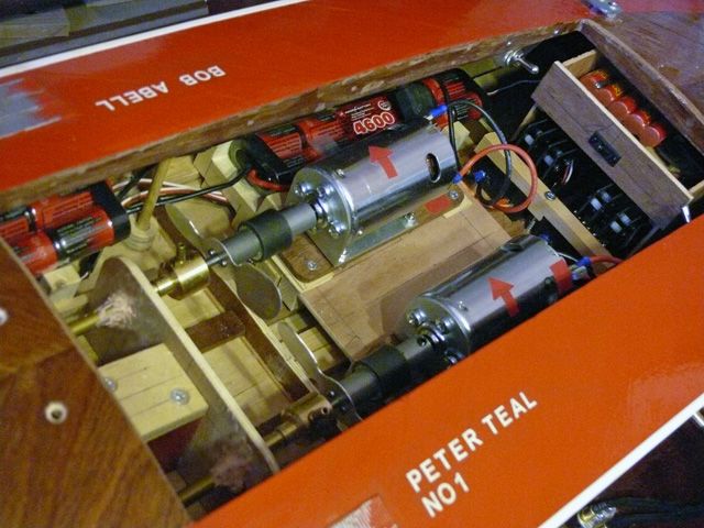

                                  Work in progress……….
                                  At last, a place for everything!
                                  It`s been quite a struggle sorting out a good spot all the gear for easy installation and access, etc
                                  The drawer at the front contains the Rc, battery, Esc In-line regulators and all the loose untidy wiring and slides neatly out of the way.
                                  Haven`t started on the charging process yet……….It`s a bit of a daunting task at the moment

                                    And dont forget gaurds for the 2 circular saws Bob.
                                    Len.
                                    #25759
                                      And don’t forget guards for the 2 circular saws Bob.
                                       Don’t worry, Len. When Bob sees the effect of the full 24v across those motors he’ll think twice about the wisdom of retaining those paddle-blades.
                                      Bob – don’t forget; no more than 2A charge rate (for 2 3/4hrs)for the first few times. Time-consuming but necessary.

                                        Thanks Len and Dave
                                        If the blades give a problem, then I`ll reduce the size of them first, before scrapping them
                                        I`m looking forward to the first outing………There`s a lot to be learned early on!
                                        Your time mentioned is a bit garbled……….”2 3/4hrs”……eh?
                                        When they get charged…..for 2hrs each say………What then?……….Will this be the first water trial?………..How long a motor run, would I get?
                                        How do I store these batteries, when not in use?………Flat as they are now….or fully charged?…………………..And how can I tell the state of charge after being idle for say, a week?
                                        Sorry to ask all these questions, but I`m sure others will find the info usefull
                                              Cheeky beggar! It’s a little difficult to write “Two and three-quarter hours” in figures on this forum. Does one use 2. 3/4 or 2 3/4 or 2.75? Anyroad, let’s recalculate – three hours and fifteen minutes will do the job @ 2A, after which they will be fully charged. After a few charges you can build up to a charge rate of 5A (for about an hour and twenty minutes) from discharged. ‘Discharged’ for those packs is ten volts on load.
                                              I have no ideas how long a motor run you will get. That is a function of several variables. These include temperature, how long you run at high-speeds, prop pitch/size (aka ‘load’), charge time etc etc. How long is a piece of string? You’ll find out these things with experience.
                                              As for retaining charge etc, hey – I only sell the things; I didn’t invent them! Go Googling, Bob – there’s oodles of stuff out there on NiMH cells.
                                              If you go onto this website http://www.component-shop.co.uk/  and click on the Batteries Explained button then that’s a good start. Our Man Mr Winks has more than a passing acquaintance with them, too.

                                                Thanks Dave
                                                Sorry Dave
                                                I didn`t realise you meant 2.75 hours!……..So it`s that precise, eh?
                                                And then you spoil it all, on the next line and say……3hrs 15 mins!
                                                Now then!………Have you actually had hands-on experience with a boat powered by 24 volts?………Any tips?
                                                I`m running on 7.2 volts at the mo and now running quite smoothly…….I expect that running in water will calm things down……..and should be great fun trying the odd burst for the first time
                                                I`ve yet to finally position the batteries for trim, so I`ve got the chicken and egg situation……getting to the pond with an out of balance setup
                                                Any idea where the boat should balance on the bench?
