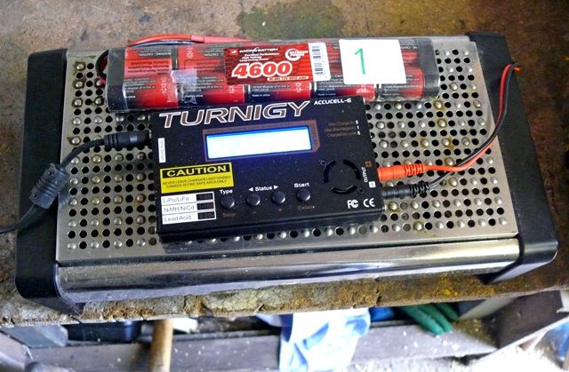

                        Progress report
                        Made a bold start at charging the batteries this morning!……….One giant step etc!
                        Making very heavy weather at the moment!………The charger is far too Hi Tech for my liking……………..Got too many variable settings………..and the jargon is beyond me!
                        I charged two batteries today……..( Well I thought I had )…….3.5 hours each………Only to discover that the charger …….WAS NOT EVEN SWITCHED ON!!
                        Reading the small print, the Start button needs to be held for 3 seconds to start the process
                        So at this moment in time, progress has ground to a stop…………….and would you believe this!……………….the supplier does not accept phone calls!!!!!!!!!
                        Probably, just as well, as I wouldn`t be able to make sense of the advice anyway!
                        A truly sad state of affairs……………Sorry chaps………Bob

                                    Think I`ve got this sussed now…………..Held the button down for 3 secs and all was revealed…………Charging at 2 amps and it`s counting down to completion……reading 14.5 volts
                                    Note the fireproof stand ……….in the garage for safety
                                    Happy again………Bob
