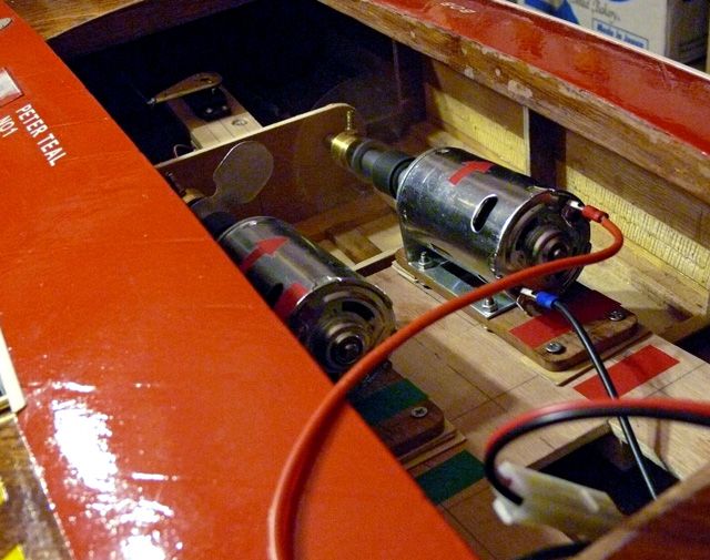

            Just been running the motors on 7.2 volts to check for alignment etc and noticed some annoying mechanical noise in the main bearing area…….with and without the paddles
            The bearings were a bit too loose on the shafts in my opinion and am now beginning to suspect the rubber couplings!……….Each half of the coupling is held apart by a cast in rubber blob and can`t really be concentric?
            Just thinking out aloud…………Bob
            #25525
              On further investigation…….the shafts are out of line, and was enough to flex the extra long slender propshaft and cause it to touch the tube walls!
              Needs to be very accurate, especially with 24v @ 9000 rpm!
              Next job…..Make a precise setting up solid coupling for spot-on alignment
              Don`t like the look of this!………….Bob

                Lined up the motor and shaft…….and to my utter delight……t was miles out!…….Gradually, a smile returned to my gaunt stressed features as I put away my sodden hankie….snif snif…….And added another 1/8th fore an` aft to bring it into line!
                Re-assembled it all back together……..Switched on…….Purrrrrrr……..Zooooom………Roarrrrrrrrrrr…………Perfick!…….Smiles all round!………Even kissed the wife!
                Laughing hysterically and with insane rolling eyes…….I fished out my beloved fans and screws eventually and lovingly reassembled them back to their former glory
                Swtched on……..Purrrrr…..Swishhhhhh……..Hisssssss!…..windddddd…….dust everywhere………Hysterical laughter……..Then a knock on the door…….men in white coats……….Come this way Mr Abell………

                                        The motors are running on 7.2 volts at the mo and over the full range of the mechanical spectrum they run……Nice….Smooth…..Rough…..Rougher……..Smooth ………as though going through stage barriers….could be something to do with …Critical vibration?
                                        It could also be the Double Bass sized hull resonating………..What does ASH the Bash say about that?……..Since he`s a Pro musician!
                                        Luckily, they run smoothly at top speed!
                                        Anyway, there`s nowt to be done at the mo….. `till the 24v comes on stream
                                        There`s still no rush……..It`s absolutely perishing out there!……….Bob

                                          It may well be because of resonance in the hull. That sort of thing will get damped out once in the water, also to bear in mind is thay are not running loaded up.
                                          More Cello sized, I would have said….
