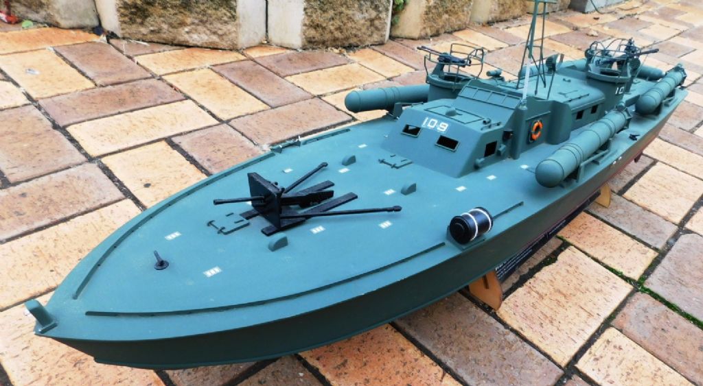

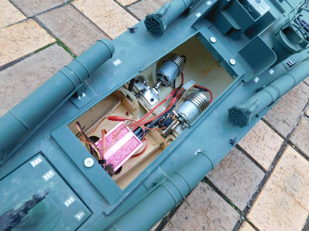

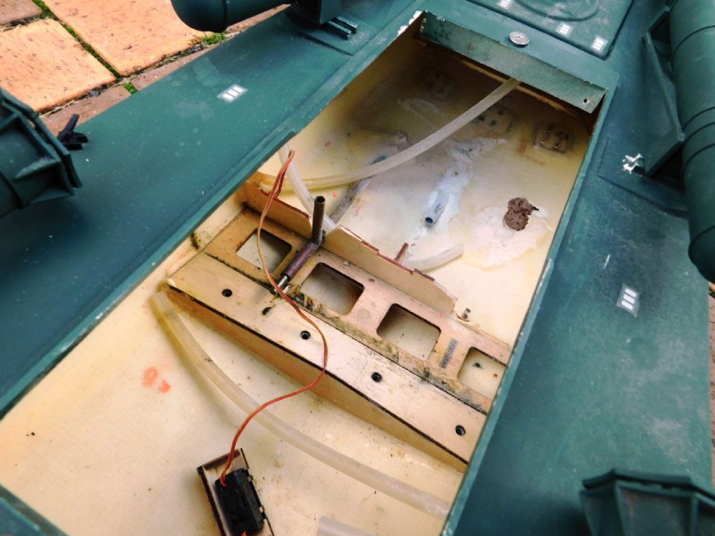

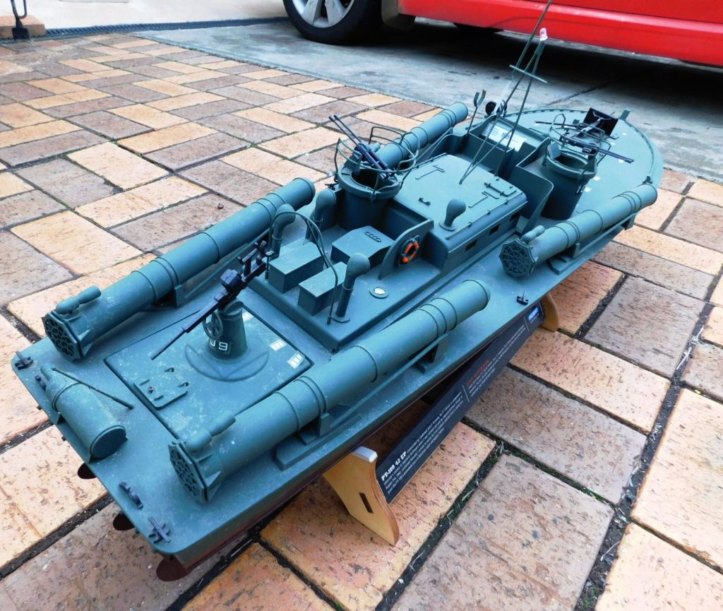

        I bought this boat from a deceased estate with radio, charger and two 3300mah NIMH batteries.
        No props which turned out one shaft totally seized.
        Turns out the shaft is standard steel.
        So I ordered new shaft kits and some nice bronze 37mm props.
        Having removed the motors and ESC started cutting out the prop tube.
        The plan is to replace both shafts and install new setups with Teflon lower bearing and roller bearing in the upper end of the shaft.
        Replacing the 555 motors with 35mm 1250KV brushless motors and twin 80Amp ESCs.pt 7.jpg

          By changing to brushless motors and Lipo batteries will drop the weight by 585 grams !!!
          This allows me to add more fiberglass to the very thin hull.
          The boat has a dummy center prop shaft with no prop, but still has three very oversize rudders.

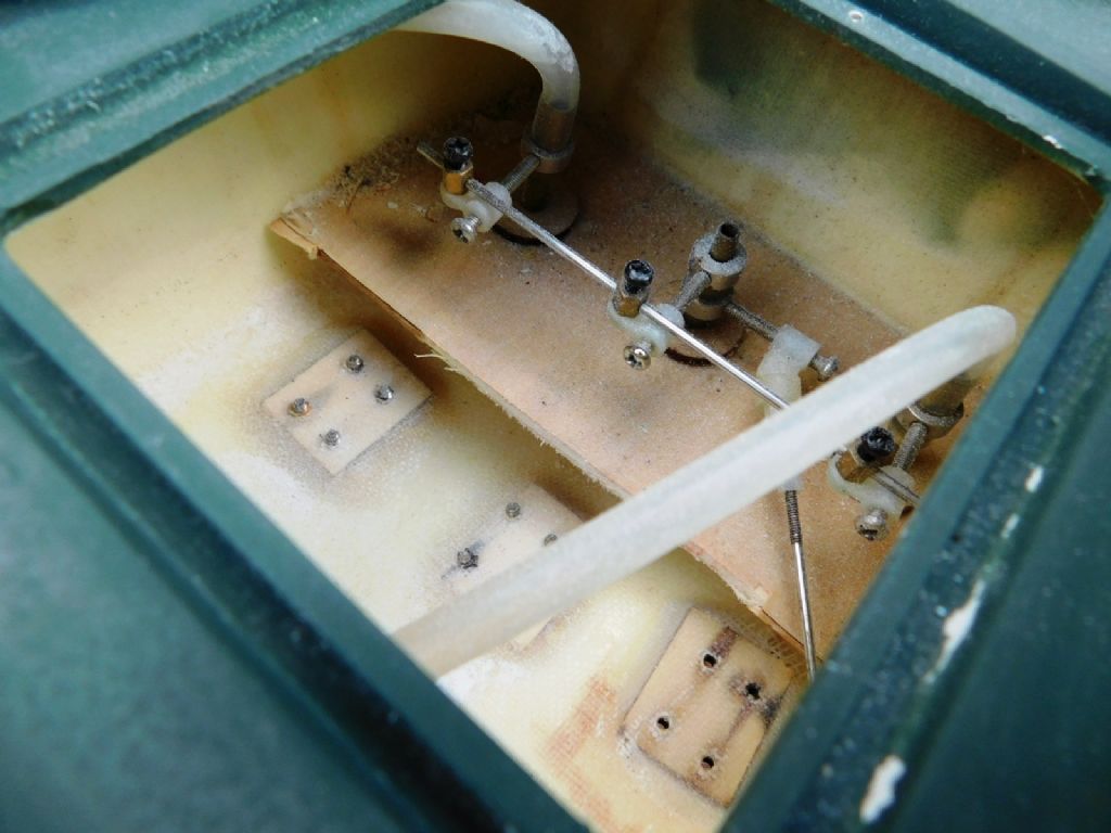

                                      I have dry set up the replacement drive line with the hole for the oiler drill out.
                                      I have spare 1450kv motors(same size as the 1250kv on order) so waiting on solid couplings from my mate.
                                      I may have one but I will have to check the spares boxes.
                                      Harry

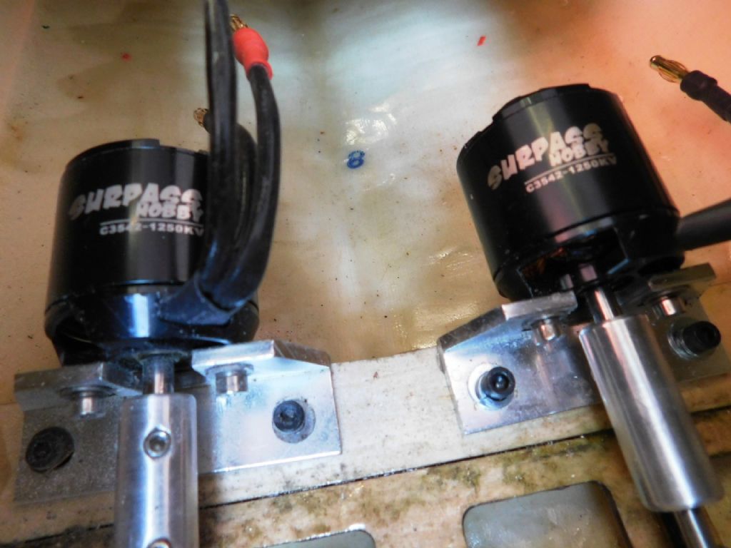

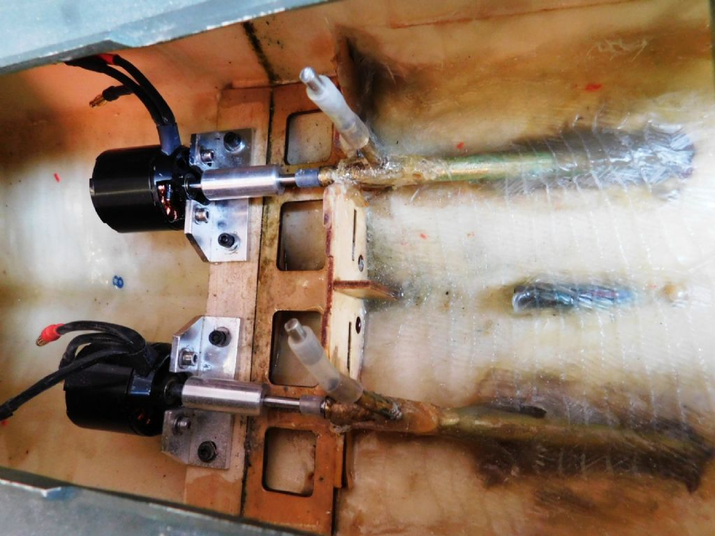

                                      #105312
                                        Hi All
                                        Finally one shaft installed with the new 35mm 1250kv and solid coupling.
                                        Soldered in an oiler plus adding some expoy glue around it as well.
                                        Started filling around the shaft exit in the hull.
                                        Next is remove the other shaft and install a new one as well.
                                        Harry

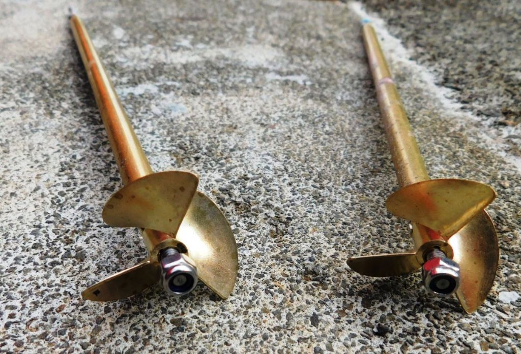

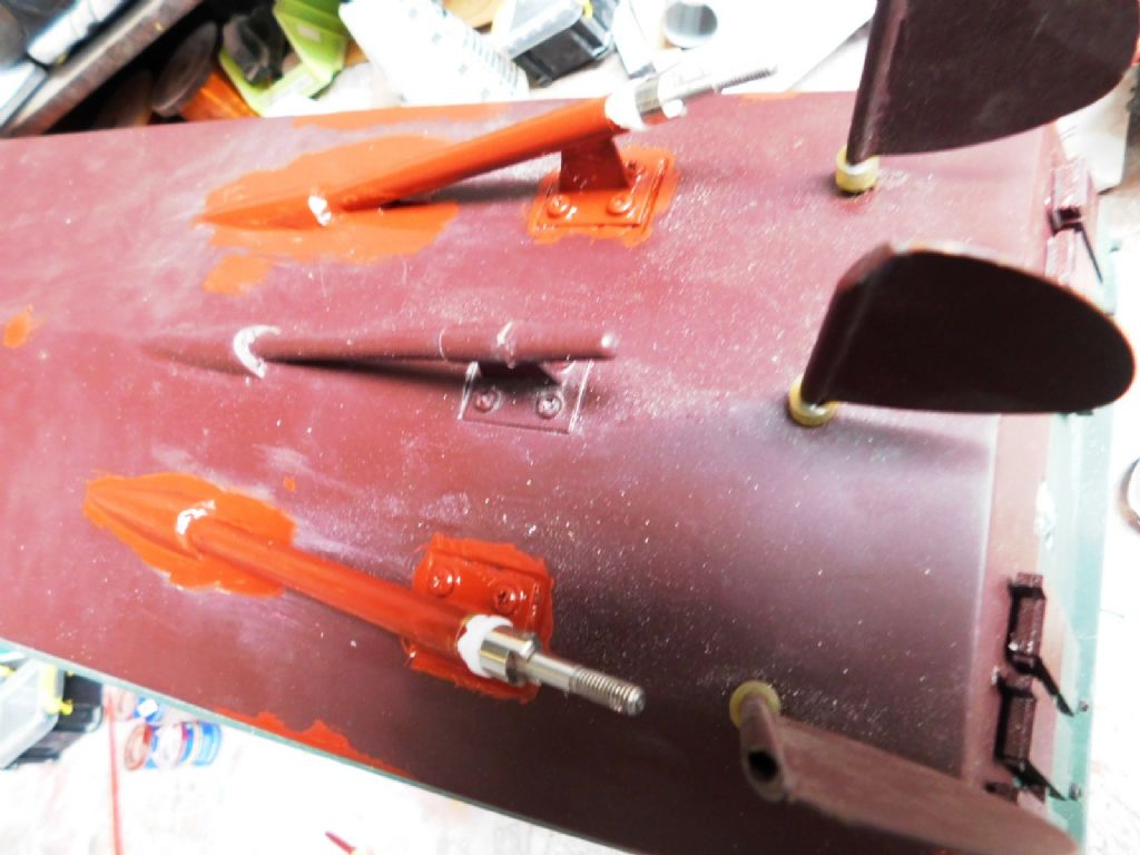

                                            #105360
                                              new prop shafts 1.jpgnew prop shafts 2.jpgnew prop shafts 3.jpgHi All
                                              Lovely Winters day and 17C !!!!
                                              Finally installed the both motors and drive line setups!!!
                                              Also added 2 ounce fiberglass matting between the motor mounts and rudders.
                                              The hull is thin fiberglass , also poured in some resin in the motor mount plywood frames.
                                              I have block off all the water inlets and outlets, not required.
                                              Next job is the rudder servo mount.
                                              Only getting a few hours per day, too cold in the shed !!!
                                              Harry
