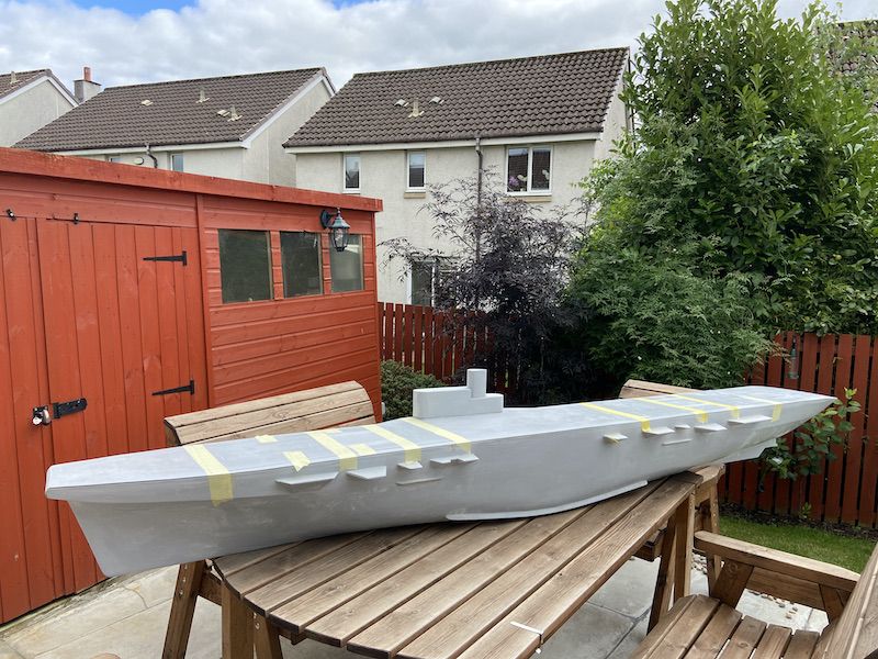

      I thought I would share my latest build… its been slowly plodding away.
      it is a 1/72 scale model of the light fleet carrier Glory.
      the model is 9' 8" long I acquired the hull and mouldings from a company in England. when it arrived I was at work and the delivery man asked my wife if we ordered a canoe.
      The original plan was to build HMS Ocean but after some input from my wife it became Glory or as she calls it Gloria….
      these pictures were how i got the hull.

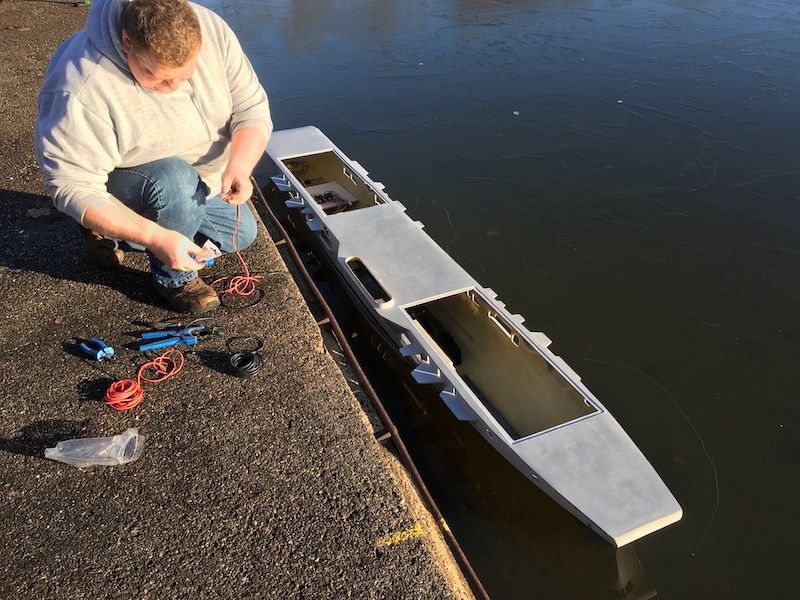

      I decided to install 2x Brushless motors in it. I needed to add about 70Lb of ballast made up mostly of steel square sash weights to make it easier to fit at the pond side.
      on its first outing to see if the ballast was enough but there was ice on the pond from the night before

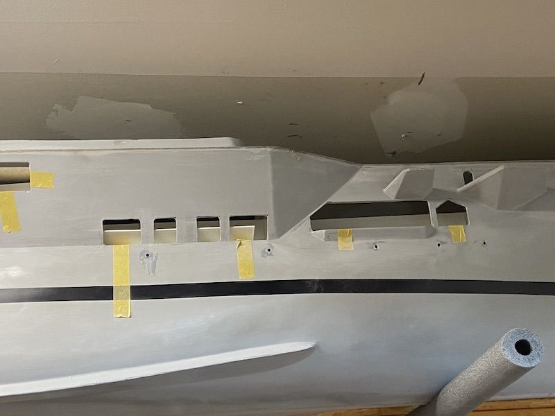

          Colin Miller
            @colinmiller68338

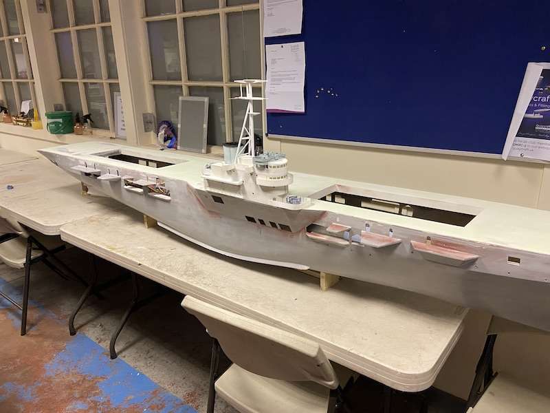

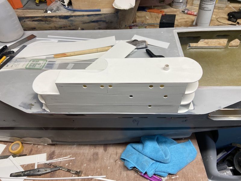

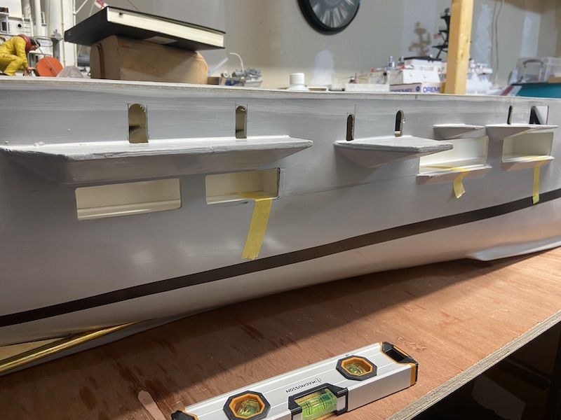

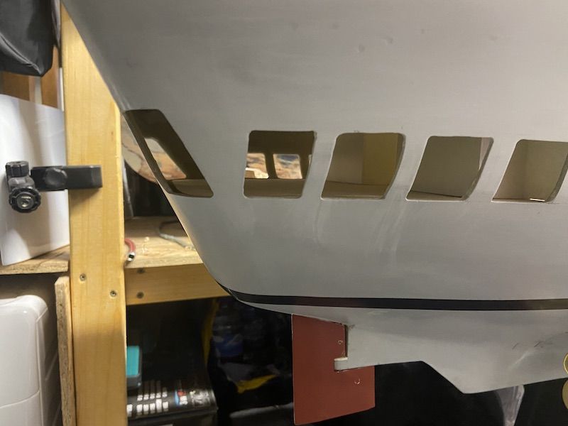

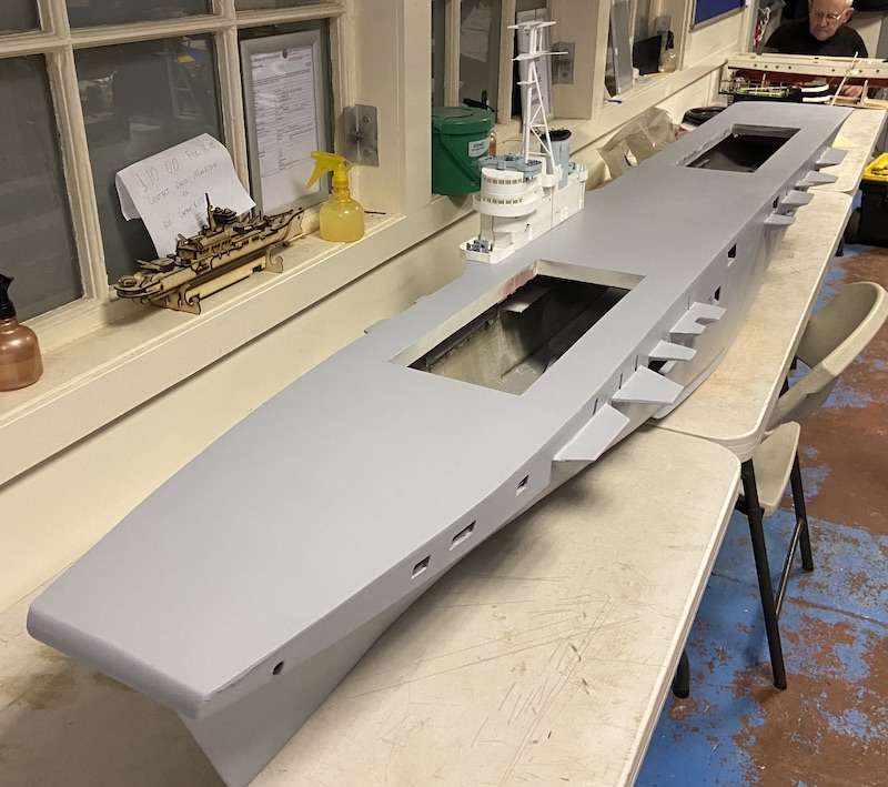

            I needed to cut out the openings around the hull, some for ships boats others for walkways and the quarter deck
            the black line was for guidance when I was ballasting it, it isn't the final waterline.
            I found that the superstructure moulding was not correct.. I decided then to build my own
            you can see the difference between them here.

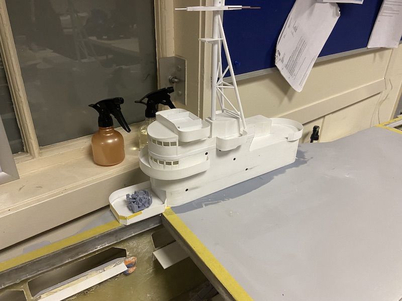

                the superstructure build moving slowly on…
                from the flight deck the top of the mast will be 23"

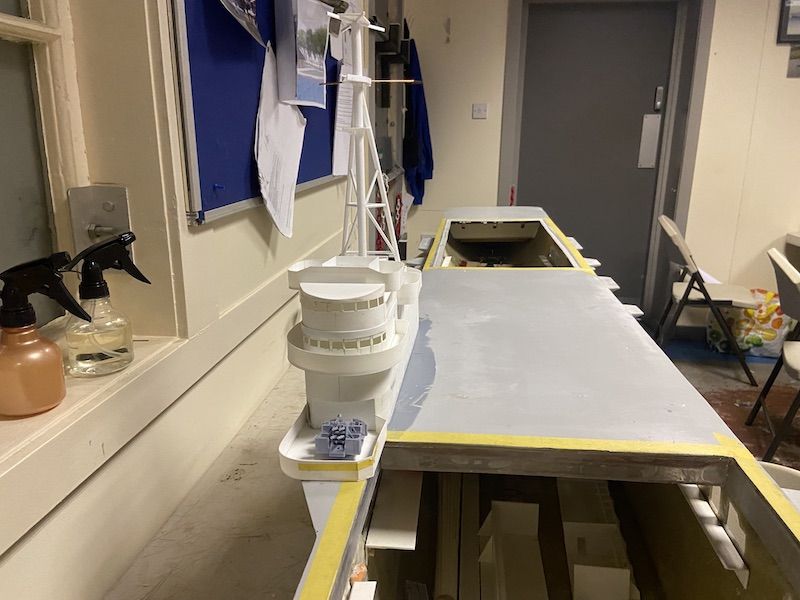

                  #112870

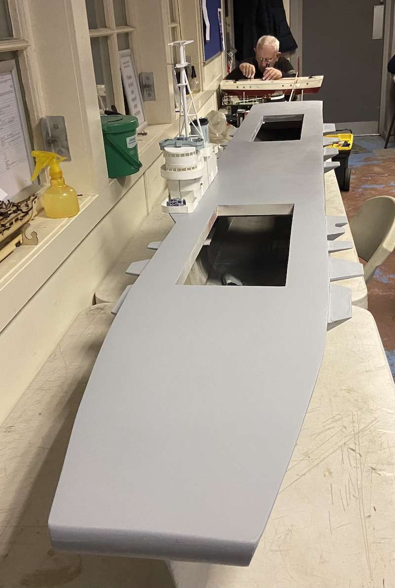

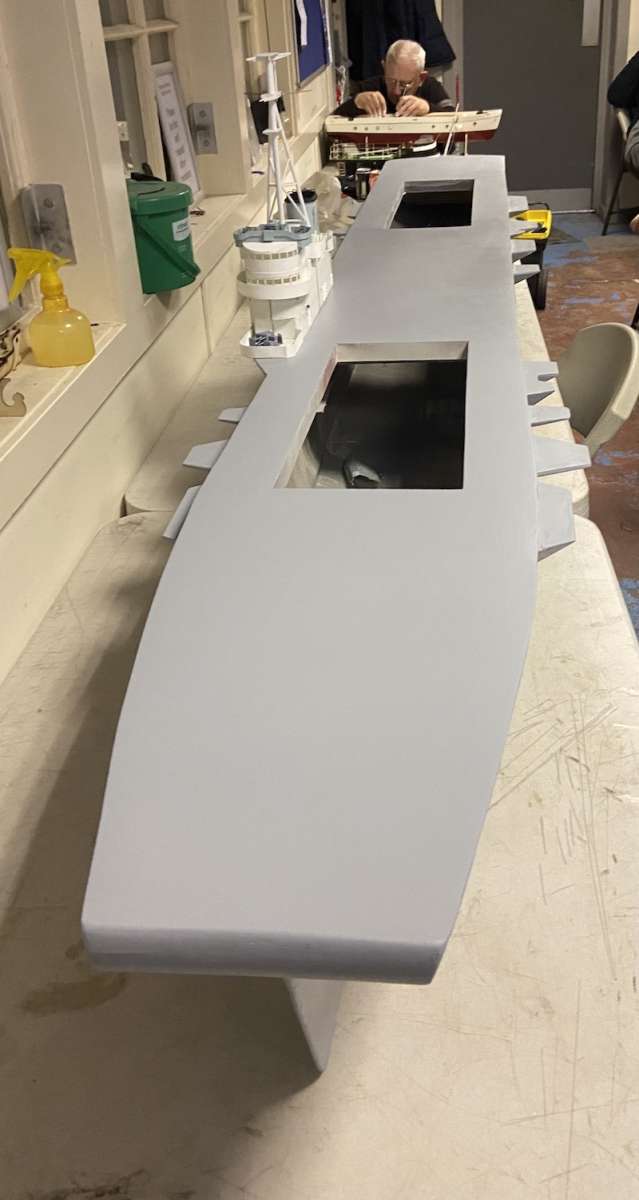

                  Colin Miller
                    @colinmiller68338

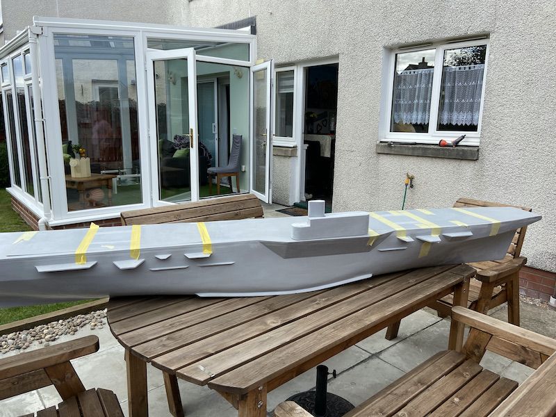

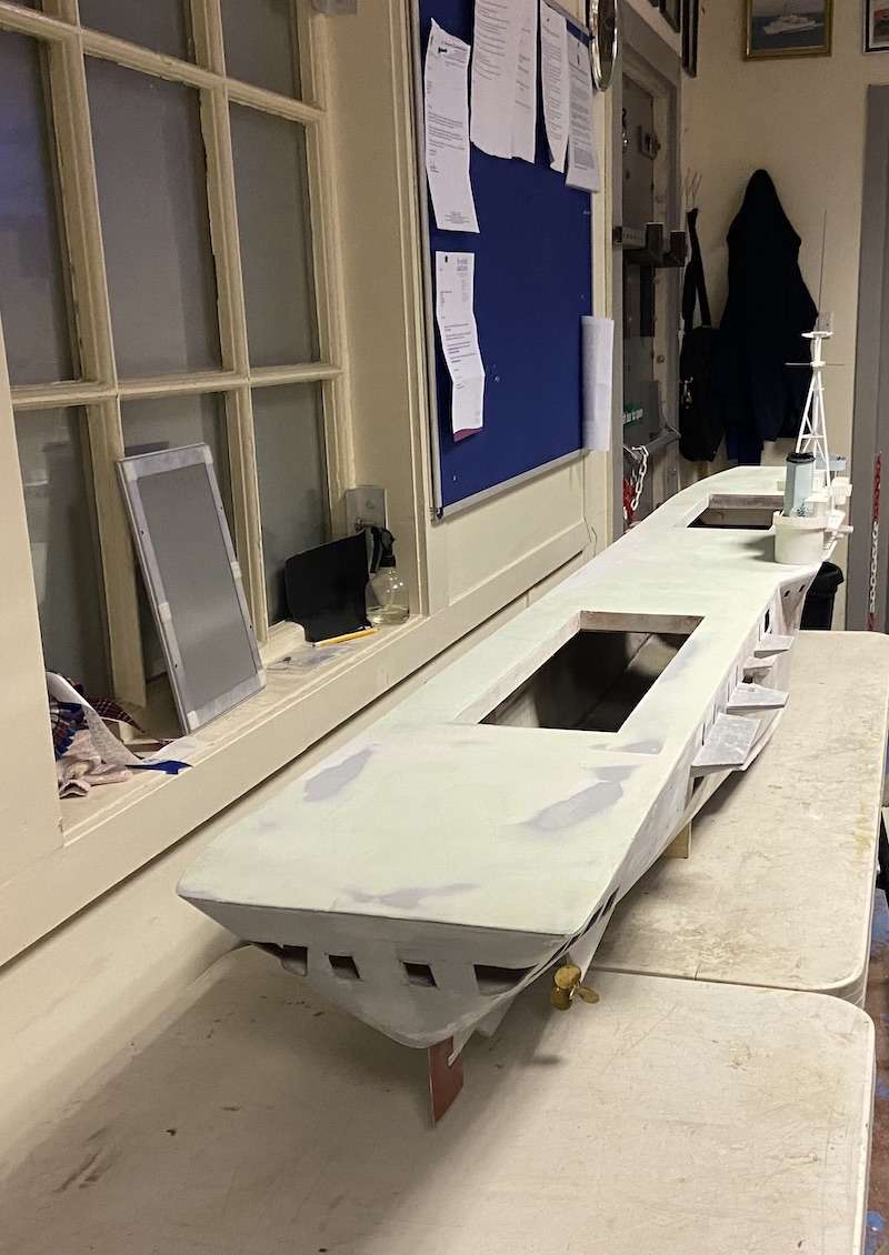

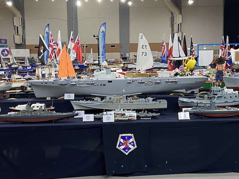

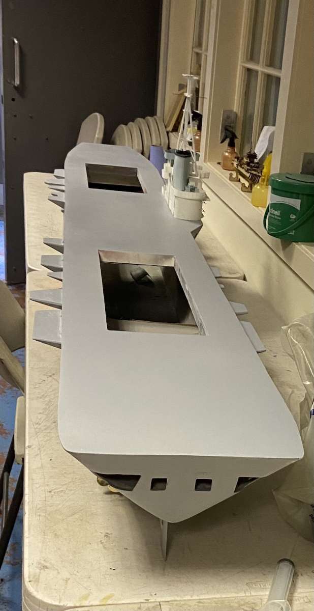

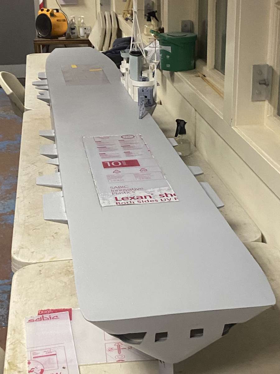

                    After about 3 months and a lot of filling and sanding i managed to level the main deck.
                    its been a bit of a task but I’m glad its over.
                    I also managed to get a coat of primer on it and took it too the Blackpool show.
                    IMG_9610IMG_9611IMG_9637IMG_9638IMG_9639IMG_9640
                    IMG_9687
                    #112887
                      Worth the effort though.  A lovely flat surface to build on with detail and effects.

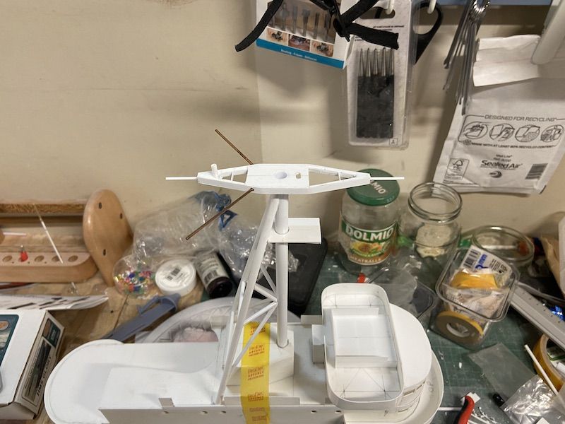

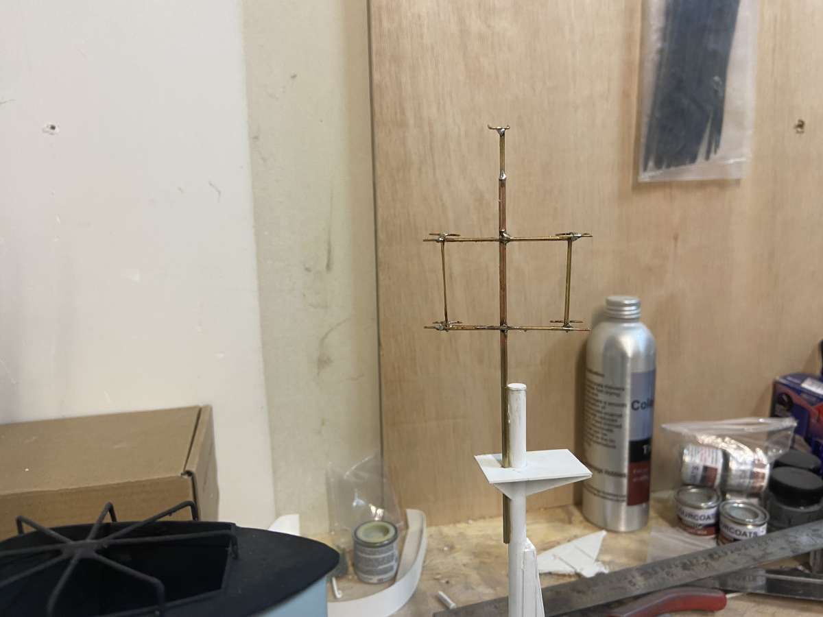

                        Colin Miller
                          @colinmiller68338

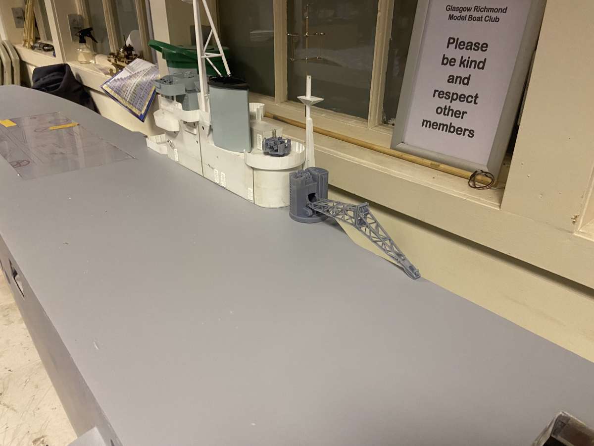

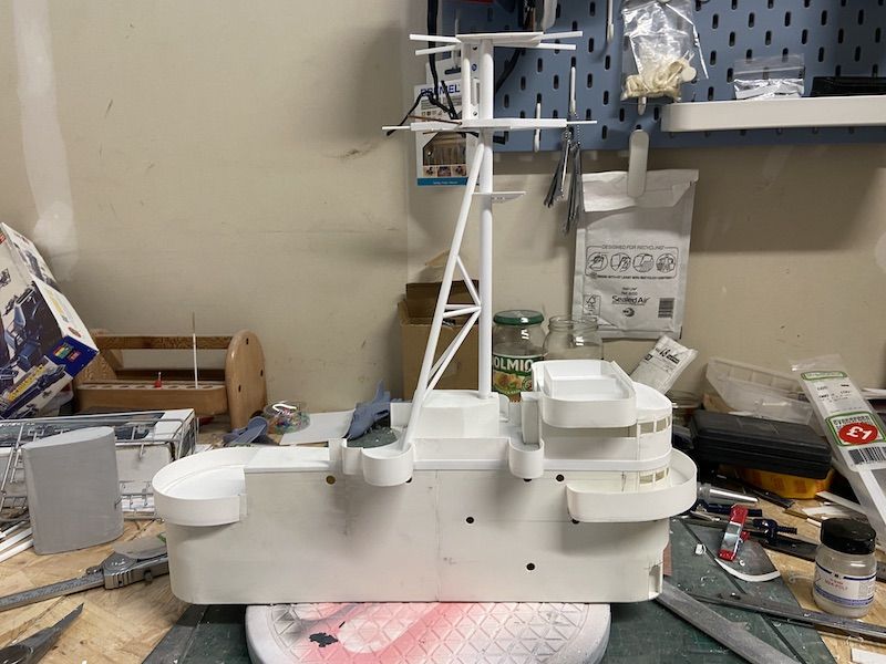

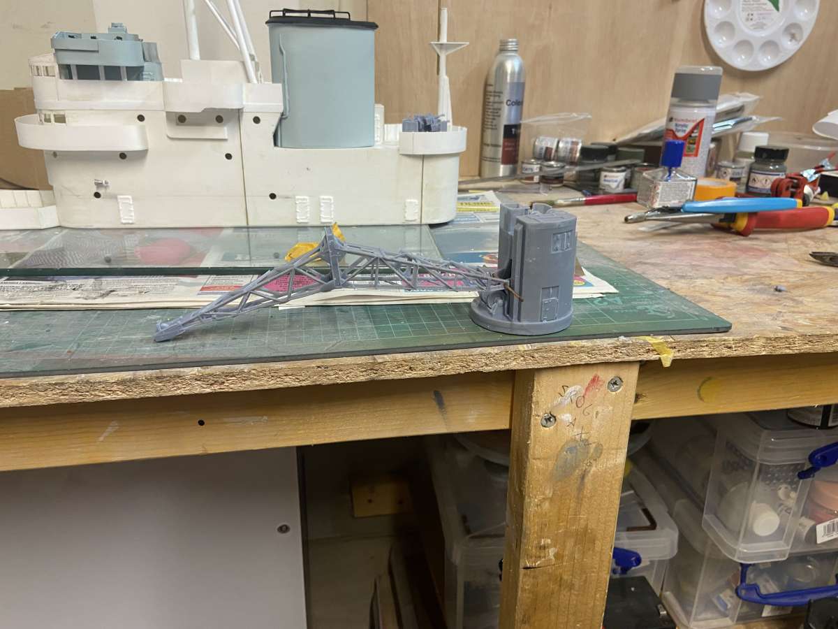

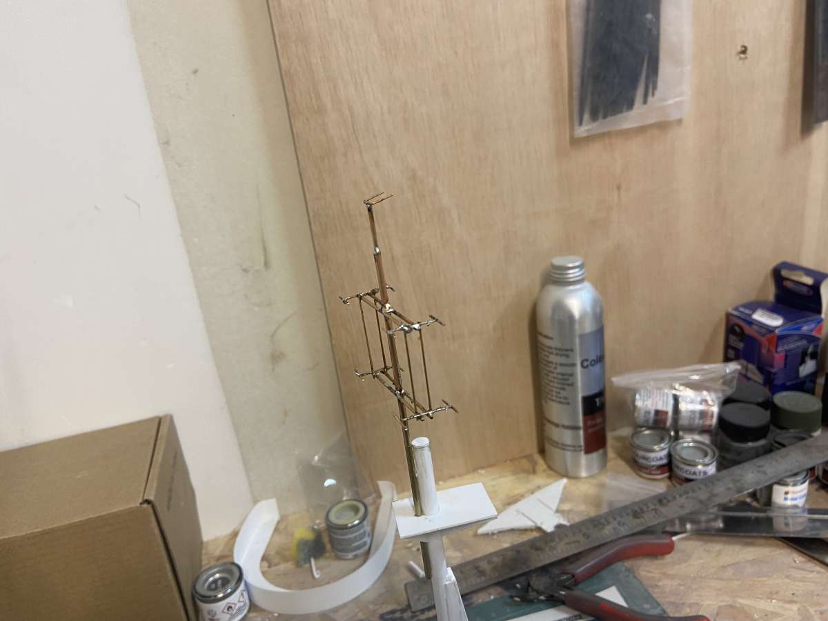

                          I haven’t done as much as I was hoping but I managed to make the 281 radar that sits on the rear mast of the superstructure and cut out the new hatch covers for the deck
                          IMG_0306IMG_0308
                          I also managed to get a 3D file and printed the seaplane handling crane too
                          IMG_0321IMG_0322
                          IMG_0338IMG_0337
                          #117929
                            Lovely detail on that crane and a nice spot of soldering on the radar.  Is that going to have a gauze fitted?
                            #117942
                            Colin Miller
                              @colinmiller68338
                              Thanks Richard,
                              no strangely that is the design of the radar, the U shaped part at the top was an optional antenna for early IFF

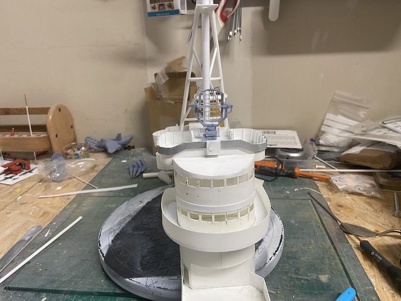

                              Colin Miller

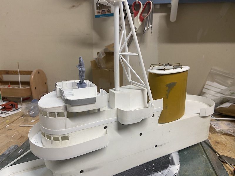

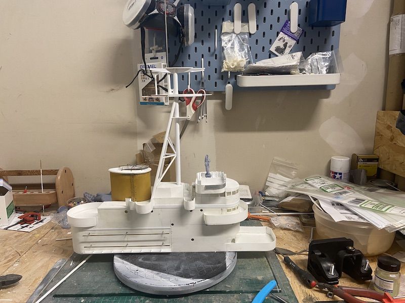

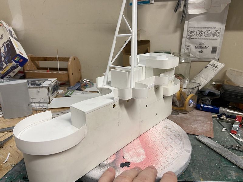

                                @colinmiller68338

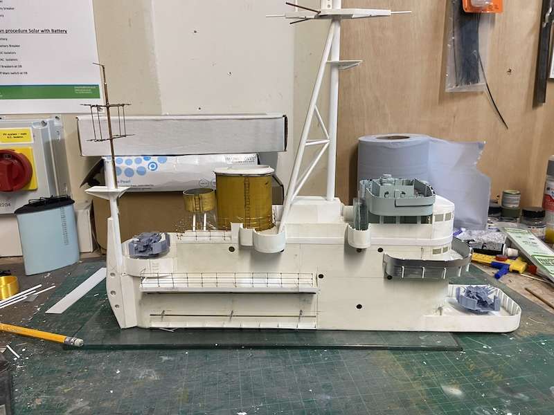

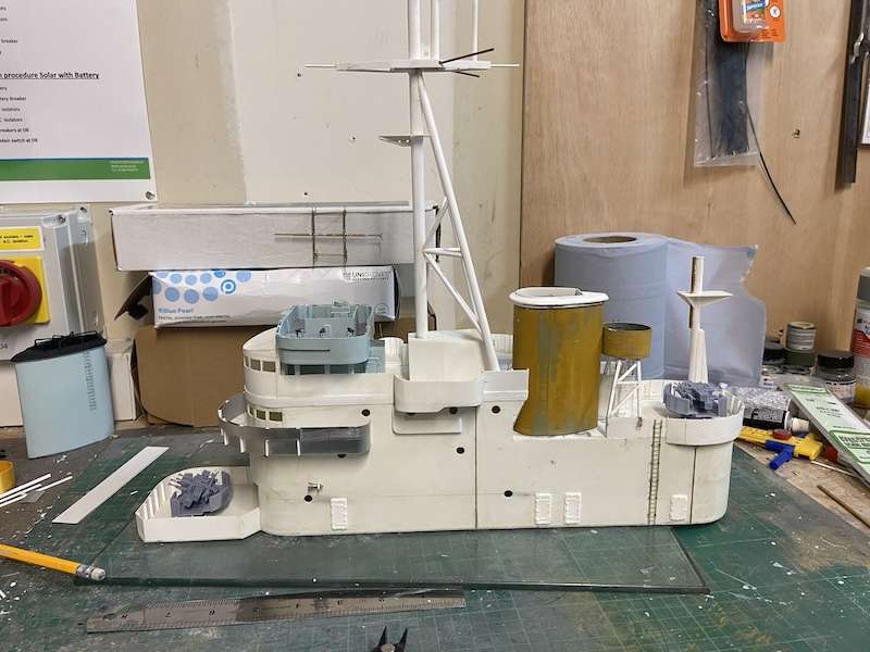

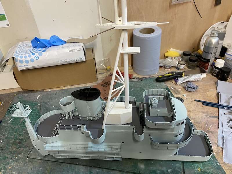

                                a quick up date and I found a bit of a disaster…

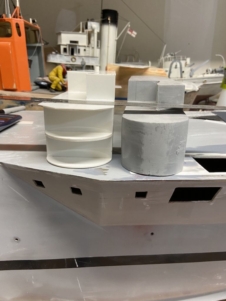

                                the funnel was too big on the length but the height and width were ok.
                                the length was pushing the director tub over the top of the rear PomPom gun and it just looked wrong…. so I a friend print me a new funnel and made the supports for the director tub.
                                I have also started fitting the railings, ladders and other details
                                IMG_0657
                                IMG_0659

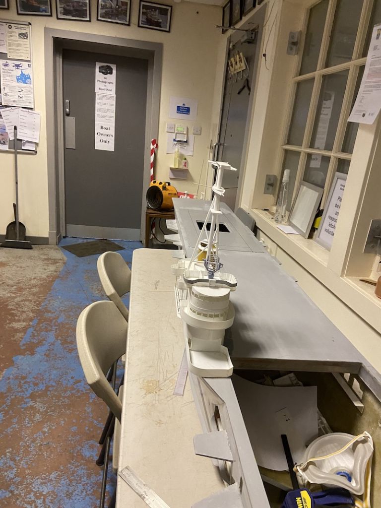

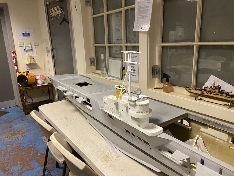

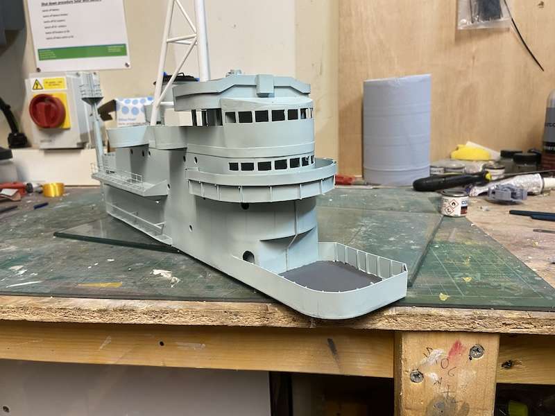

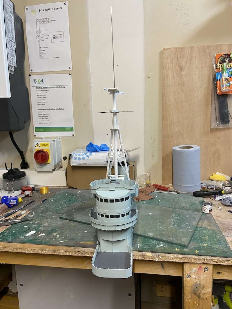

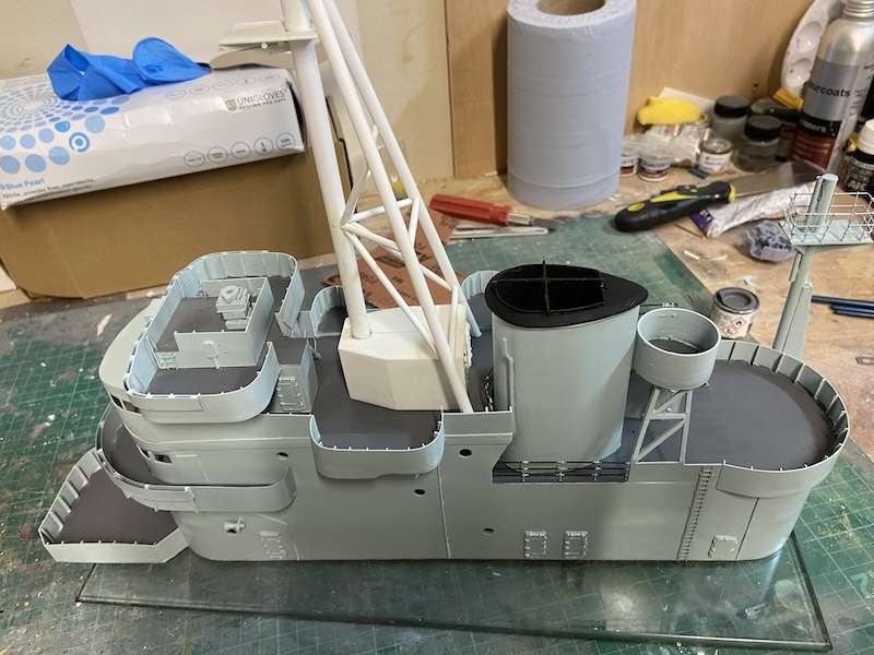

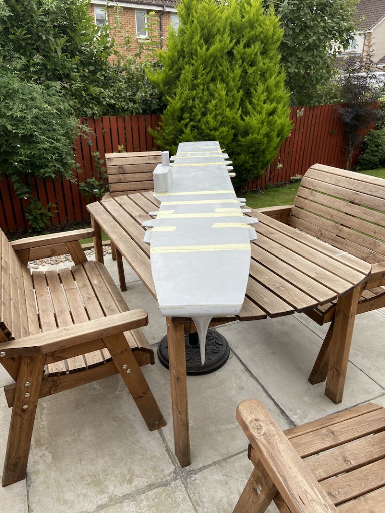

                                Colin Miller
                                  @colinmiller68338

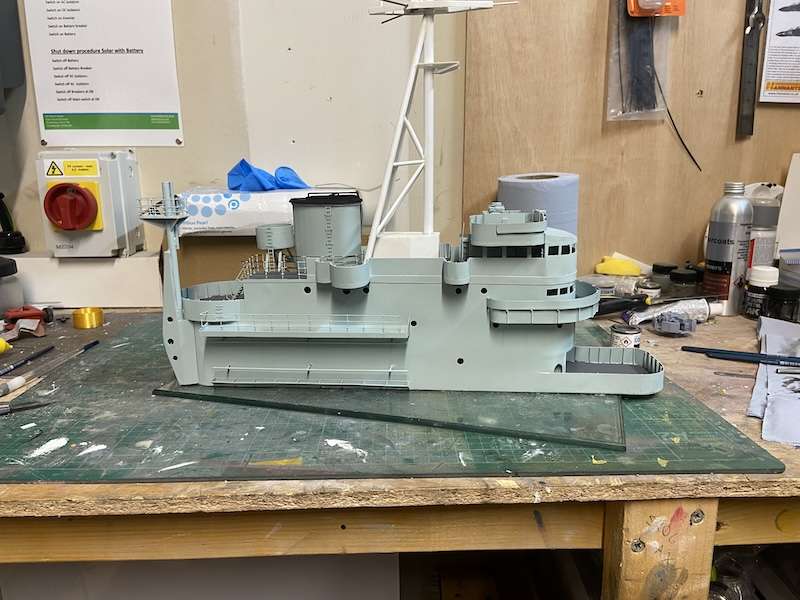

                                  started painting the superstructure and it has the feeling of the model coming together… still to finish the mast but its getting there
                                  IMG_0885IMG_0888IMG_0886IMG_0884IMG_0887

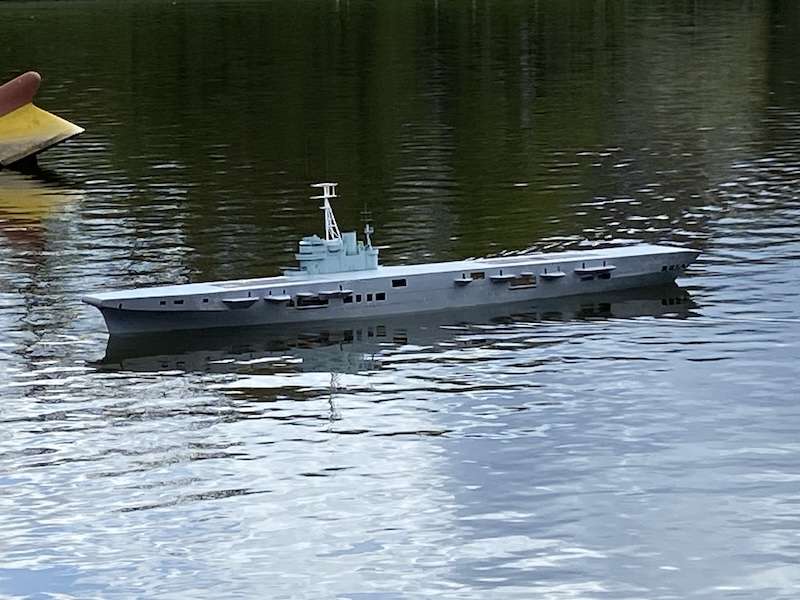

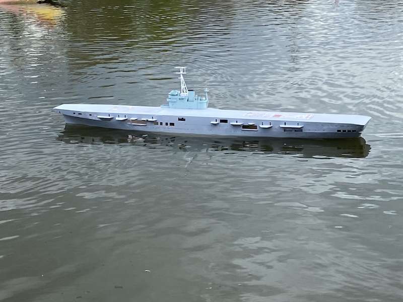

                                  Colin Miller
                                    @colinmiller68338
                                    a bit of a surprise yesterday in Glasgow, it was sunny and no wind so an ideal time to get the carrier in the water for more testing.
                                    IMG_0924IMG_0926
                                    some ballasting adjustmants needed but I will hold off until all the final parts are in place
                                    as there is still a lot of sections to be added to the hull.
                                    so far though it sails like a rock but with the amount of ballast that’s to be expected….
