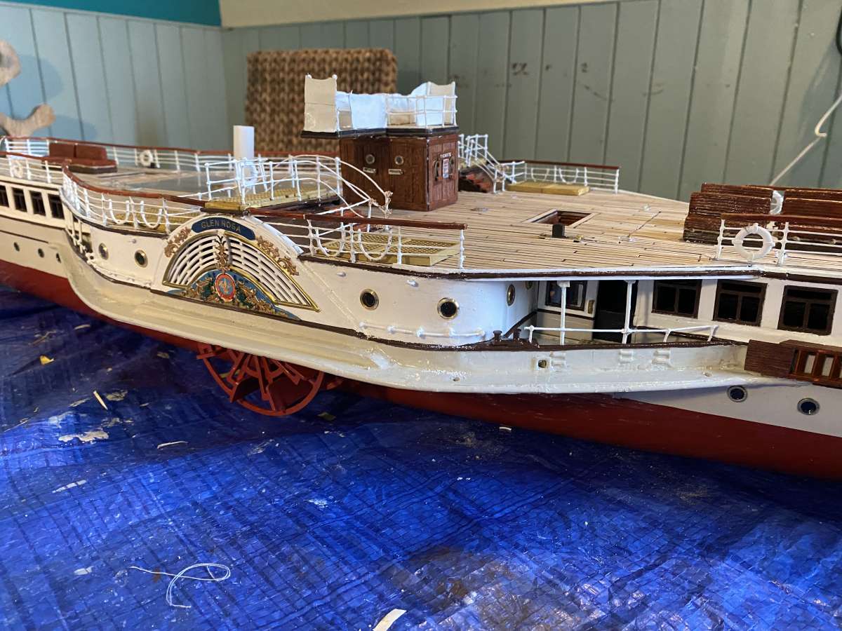

            Hi again (hope I am posting in the right section here). I bought the moulded hull for this and sought out the 2008 relevant copies of Model Boats to set me on the right tracks with this.  As well as being a novice, however, I am a bit of a pedant, so I sought out the actual builders plans from the shipyard (now held by Glasgow University Library as well as varius old photos and have aimed to try to capture Glen Rosa as she was in her first season.
            #118646
            Alasdair Allan
              @alasdairallan37423
              Model is 1:48 scale and I have tried to research  paddle boxes.  not the tidiest job but hopefully well-informed! pbox

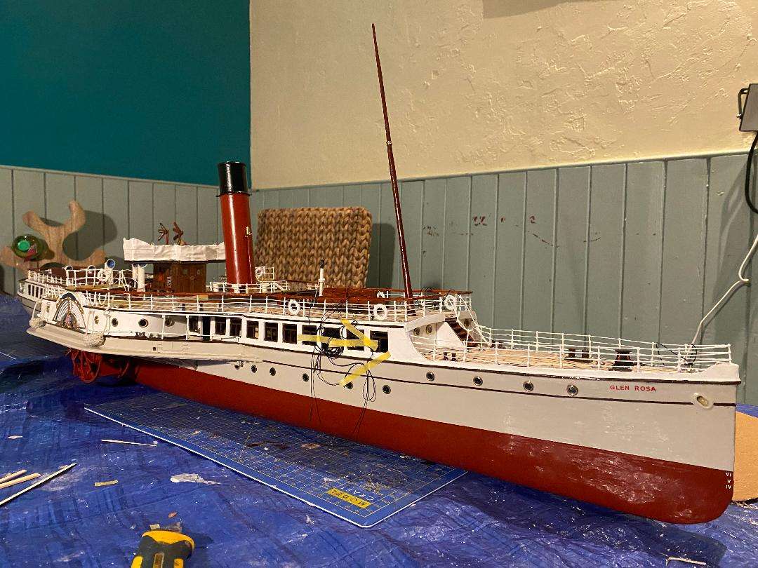

                            #118897
                            Alasdair Allan
                              @alasdairallan37423
                              GR feb
                              #118898
                              Alasdair Allan
                                @alasdairallan37423

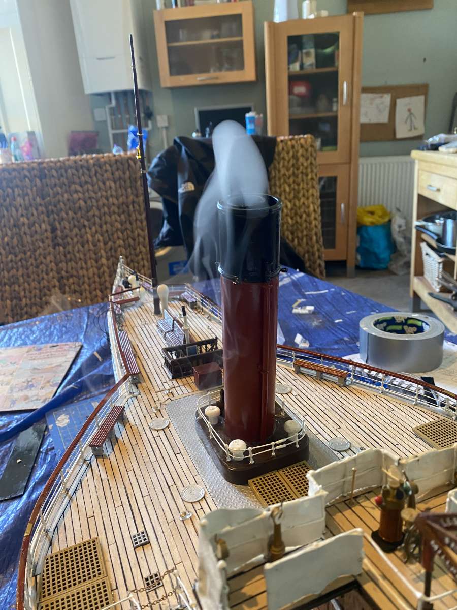

                                Have the funnel on now – working on a lighting circuit, a mast and a smoke unit now
                                #118901
                                  Keep us updated with progress. Have you been able to check the ballasting yet as this is usually quite critical with paddlers.
                                  #118903
                                  Alasdair Allan
                                    @alasdairallan37423
                                    Thanks Colin – yes, just about to trim the ballast again in the bath! I reconditioned an old model of PS Duchess of Fife and it was no easy task ballasting, as I recall.  Suspect this will be the same. Main problem is when goiing astern. suspect i need to move batteries etc from midle of ship to each end to steady the see-saw.

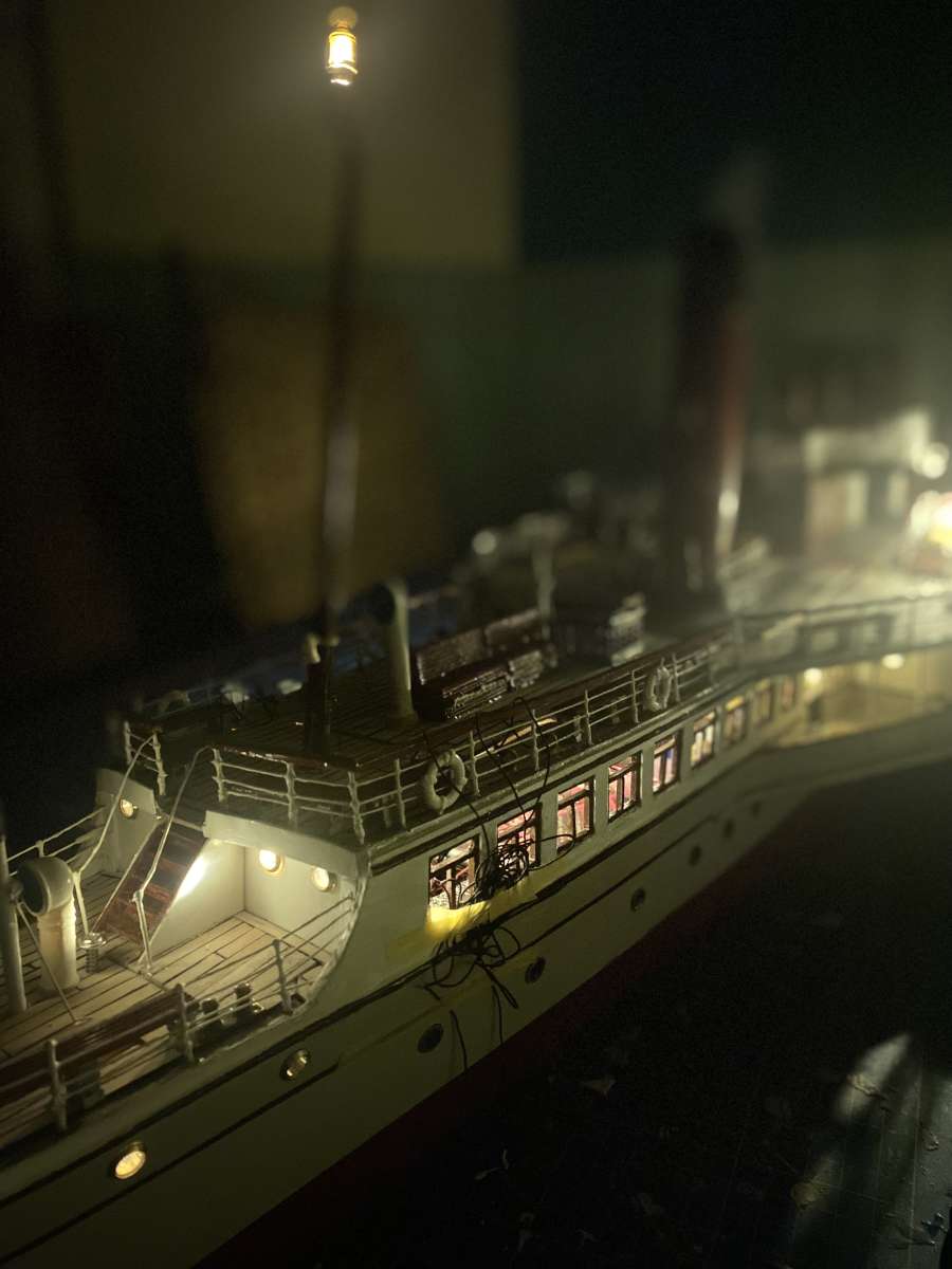

                                    Alasdair Allan
                                      @alasdairallan37423
                                      IMG_9789
                                      #119359
                                      Alasdair Allan
                                        @alasdairallan37423
                                        Not the best photographer, but getting a lighting circuit set up- in honour of the fact that Glen Rosa was one of the first ships in the world to have electric lights!
                                        #119360
                                          Having the majority of the ballast concentrated in one place midships is guaranteed to create a very unnatural and toy like ‘bobbing’ motion as the model goes through small waves.  It is far more effective to split the ballast up and have around a third at each end and the battery, motors and electronics should generally make up the third in the midships area.
                                          This 1/48th scale corvette required 6kg of ballast so I put 2kg of lead shot into the bow, encased in resin, and 2kg of lead shot in the stern.  It looks so much more realistic to see it cutting through the waves rather than bouncing over them.
                                          The lighting looks spot on Alasdair.

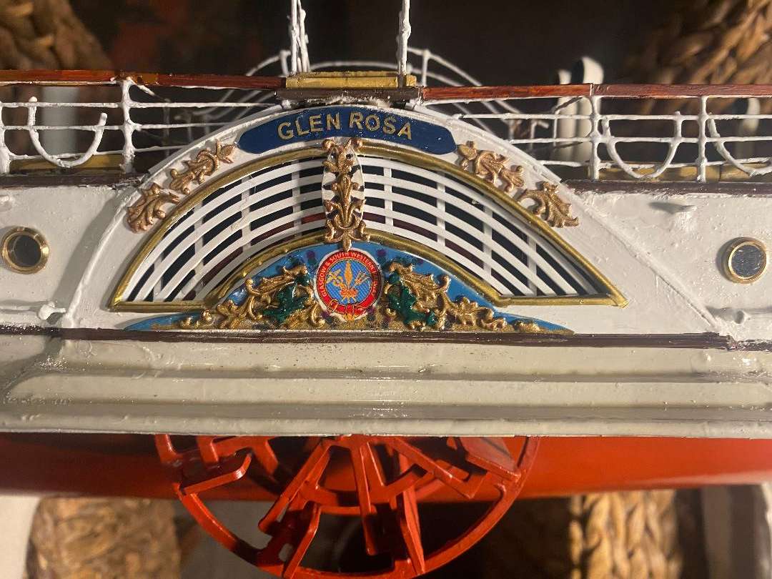

                                              #119370
                                              Alasdair Allan
                                                @alasdairallan37423
                                                IMG_9779
                                                #119371
                                                Alasdair Allan
                                                  @alasdairallan37423
                                                  Starting to make some progress!

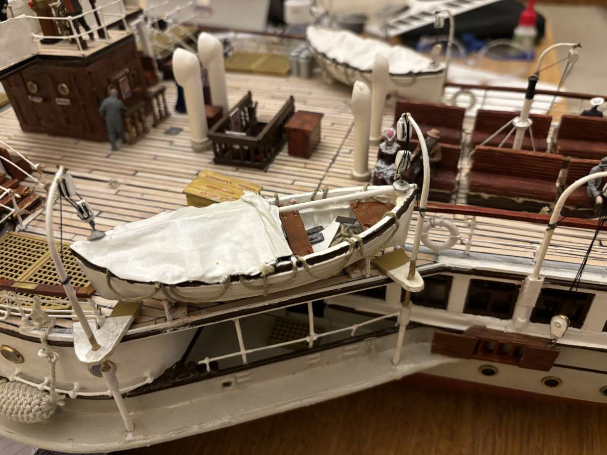

                                                    IMG_9862
                                                    #119642
                                                    Alasdair Allan
                                                      @alasdairallan37423
                                                      getting lifeboats rigged up at last.
