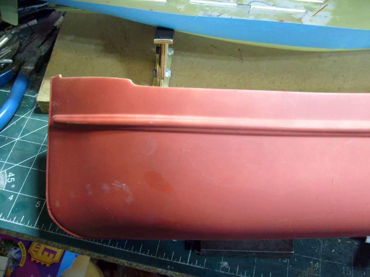

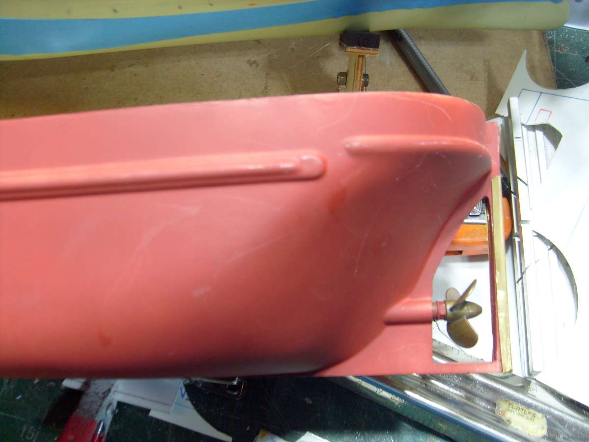

In 1997 I purchased the plans & a vac formed hull from Sarik (MM1410).
Due to the bad weather we have been having on the south coast of late, I decided that now just may be the time to start to build this puffer, also it is just the right size so that I can work on it on the kitchen table, and not in the cold garage.

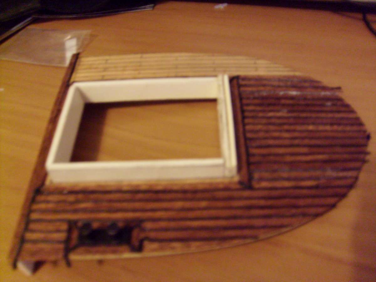

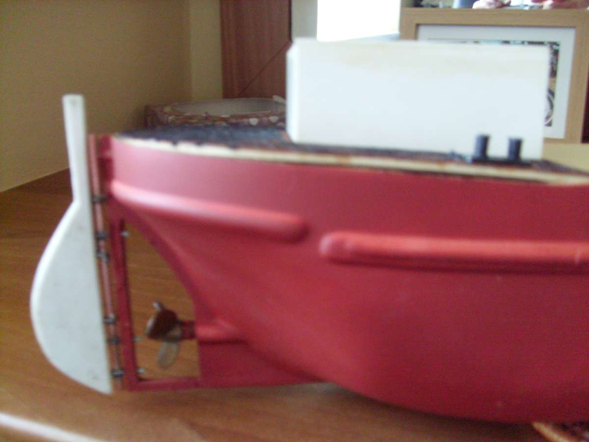

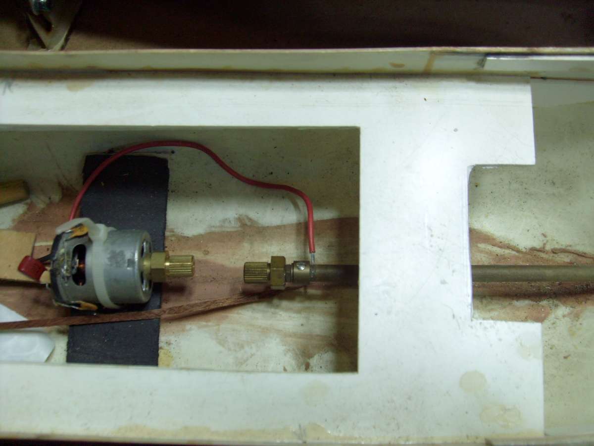

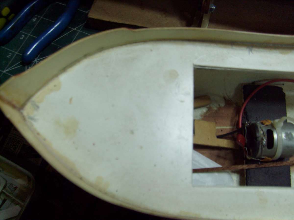

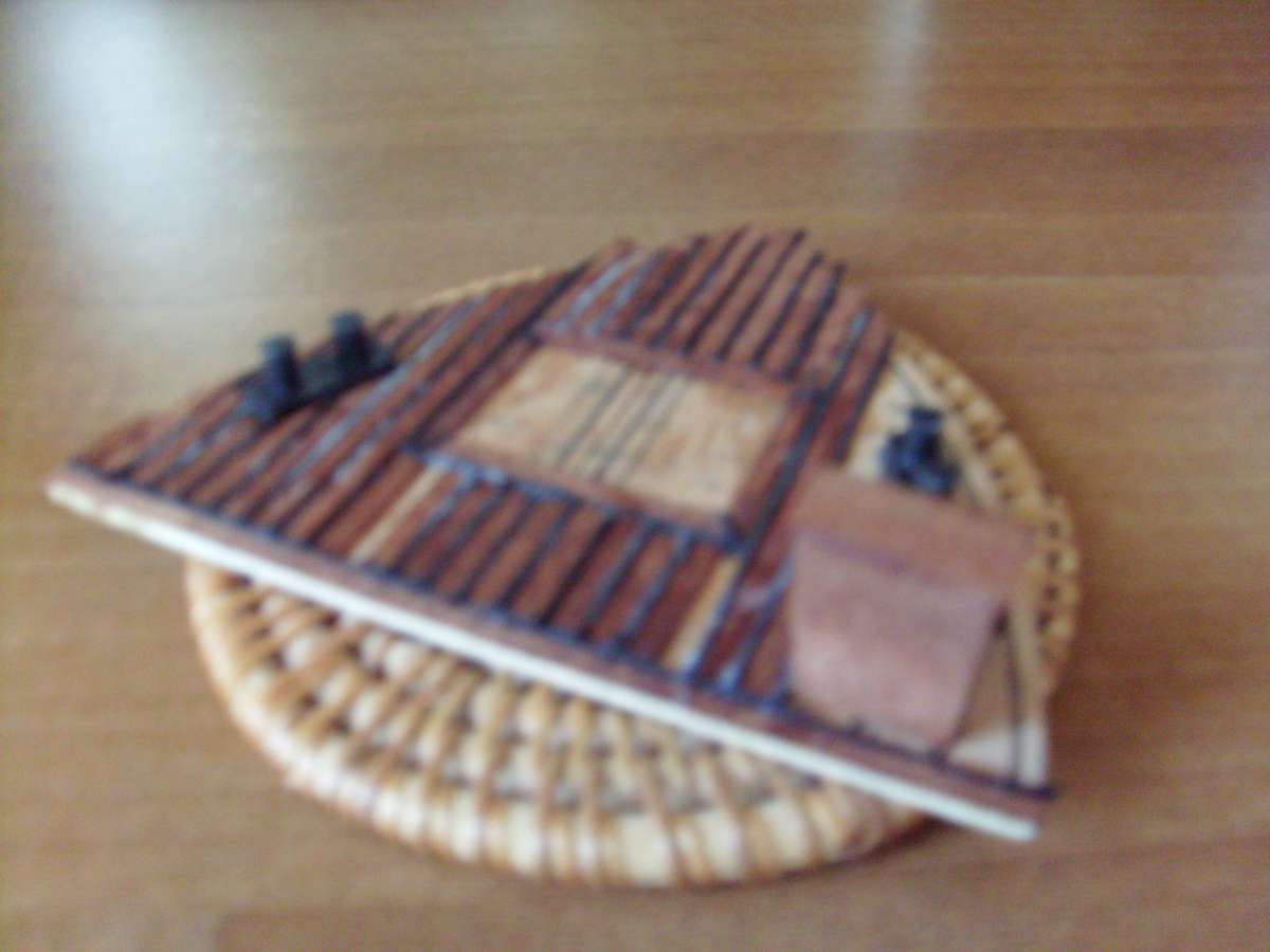

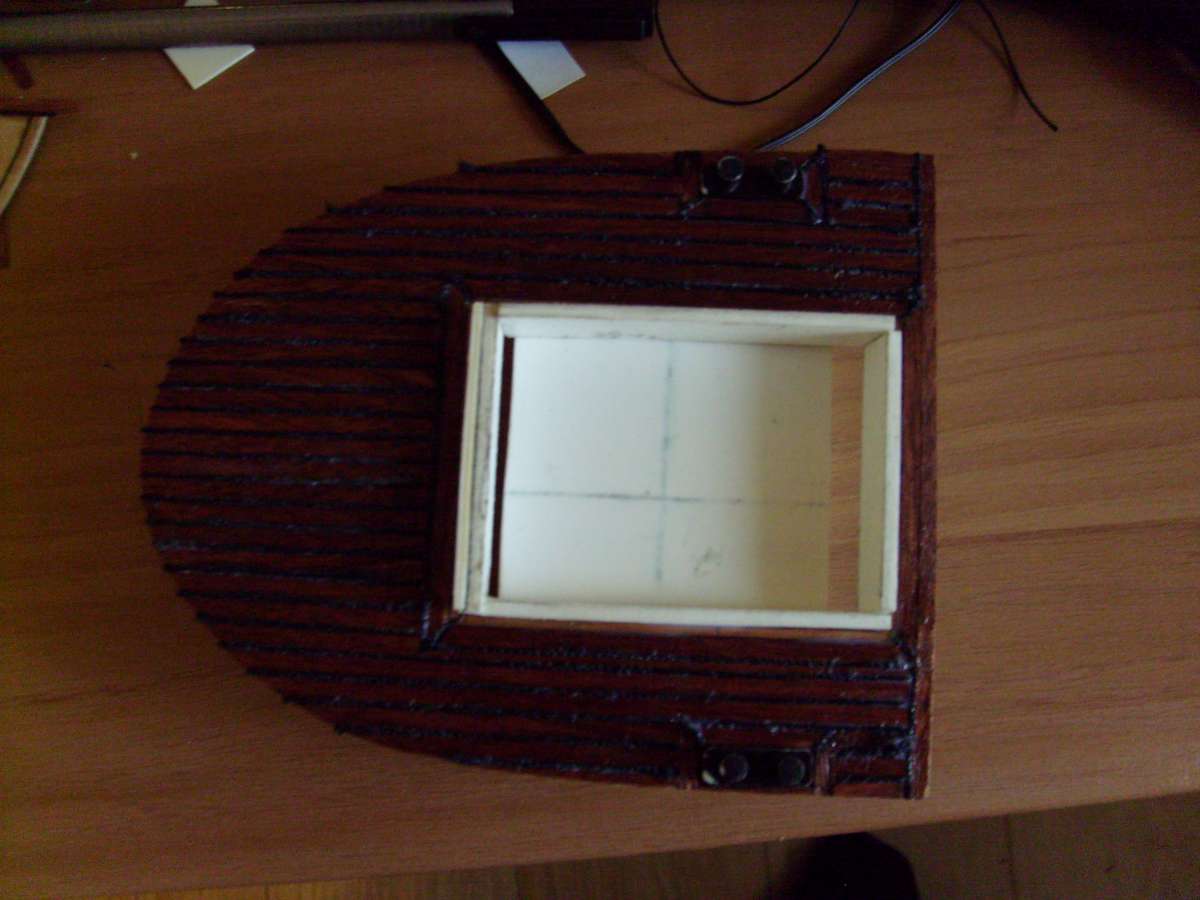

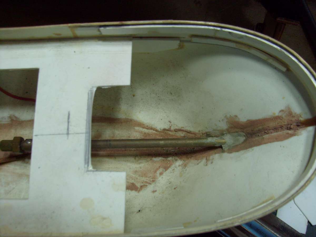

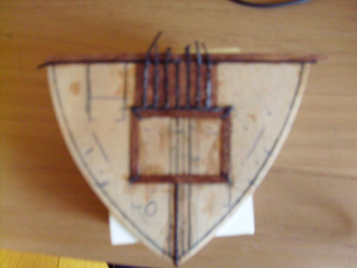

Two week ago I joined the two hull halfs, fitted the shaft and motor along with the deck, now looking at it I think I should make some form of support for the shaft, will come back to that later, in the meantime I started to plank the rear deck with 2 X .05mm stripe, as for the clinkering I used .05mm thread.
