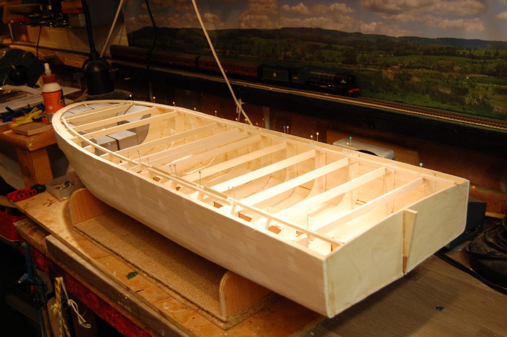

            With the topsides trimmed down to the gunwhale leveldelight 17.jpg , some temporary cross beams from balsa allows me to plot the inside line of the deck and the camber with some thought to the slots required in the deck for the canopy to slid down into

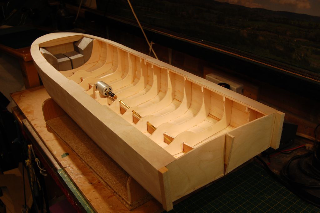

              The autumn feel in the weather has boosted productivity the decks are in place and have an old drill motor 600 in place 16" inch stern tube is in with a bit of butchery of the bulkheads !delight 18.jpg , so it should be finished in a couple of weeks now

                  Ray. You have either a seriously small motor there, or a huge boat…..!

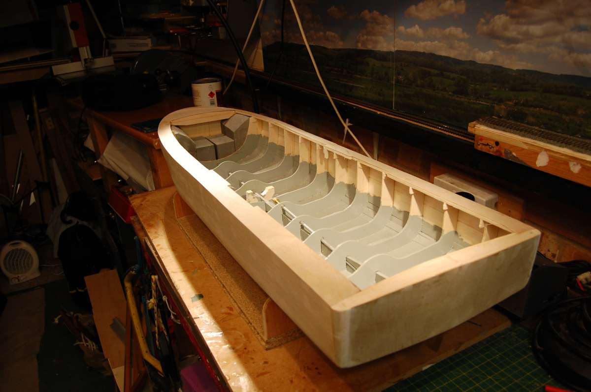

                        Some progress made to Delight, now we have the running gear installed stern tube epoxied in and a brass rudder fabricated, before I tackle the outside of the hull’s final shaping, a couple of coats of International Top Lac to seal the balsa planking, It’s left over from a dinghy refurb, so no monies spent 🙂
                        I have been cutting out the cabin bulkheads and sides as a kit of parts which is the next stage.
                        Regards RayDelight 19 (2)

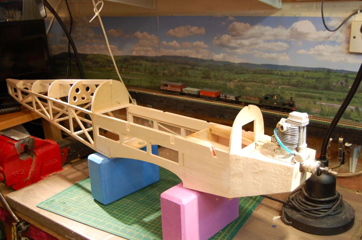

                            So I’m just starting a DH60 Moth 80″ span for a four stroke engine should be a fast build and enjoyable to fly I hope.
                            Get that tug boat sorted !!
                            Best RayDH60 Moth

                                  Delight at the moment, but the DH 60 Moth is coming along for next year 🙂 15cc four stroke in position cabane struts next.

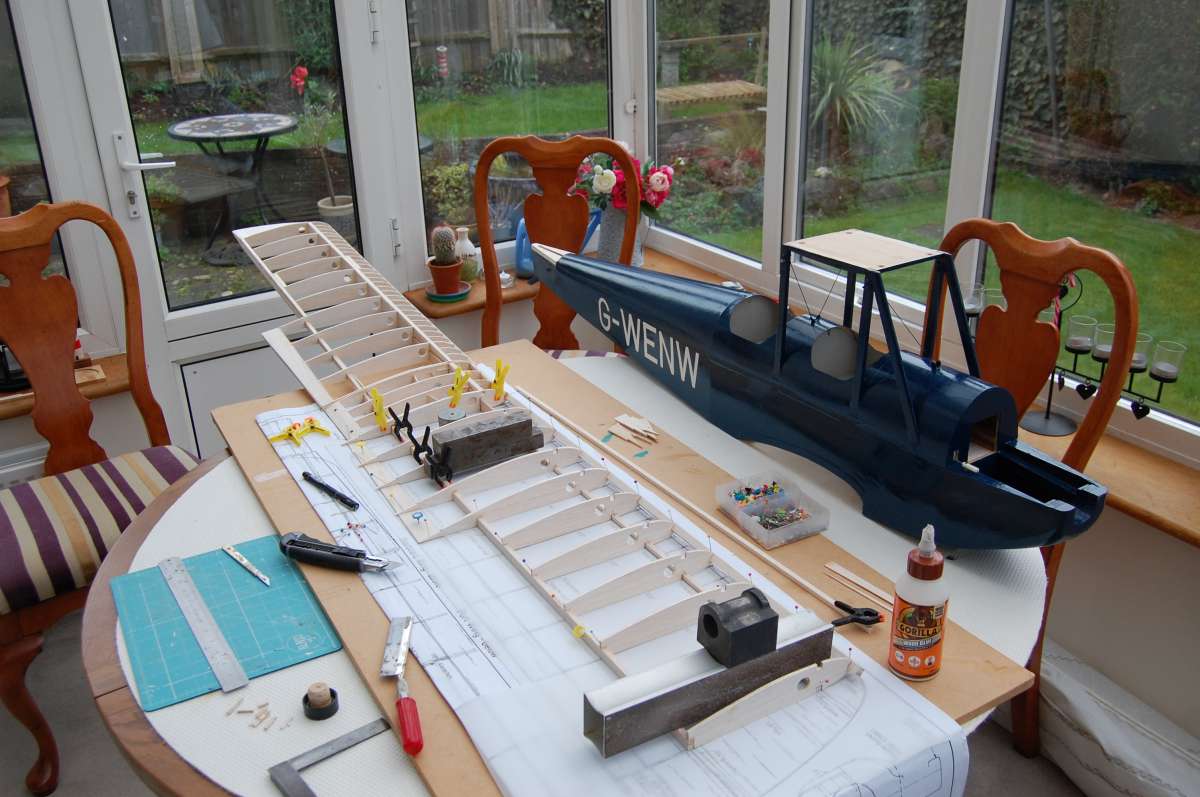

                                          Just to let you know I will be back building Delight when I have finished the Gypsy Moth which has taken longer than expected !! still I’m on the home straight now with the 2 pairs of 80″ wings, fortunately there are only ailerons on the bottom wings,DH Moth 020424 there were a lot of ribs & riblets to cut as it’s from a plan not a kit 🙂
