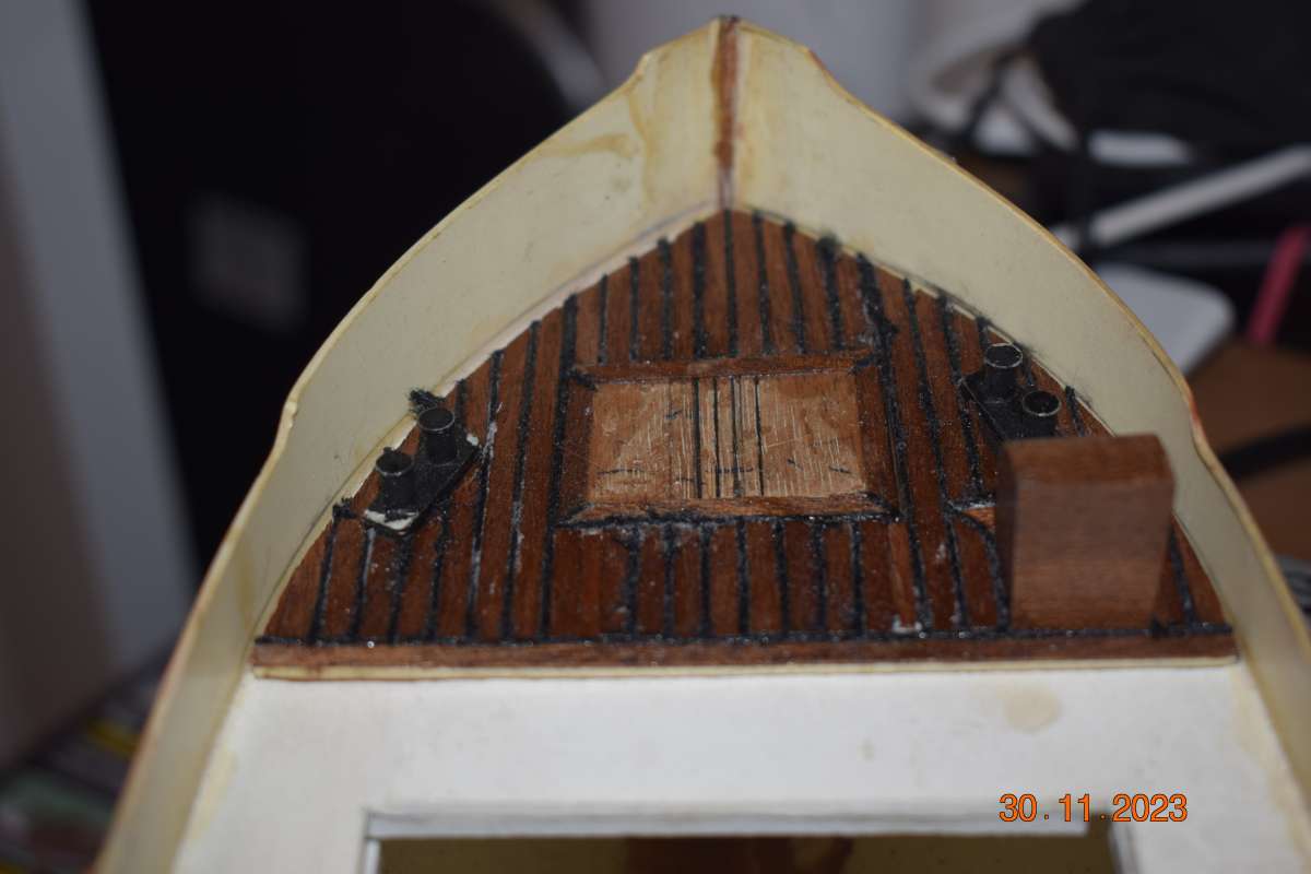

          I have now finished planking the fordeck, and moved onto the steam winch, having looked at photos of the winch, i feel that for me it is going to take some time to make one from scratch, so a quick look around google I found one at a scale of 00 from langley models of Crawley so I am going to give that a try.

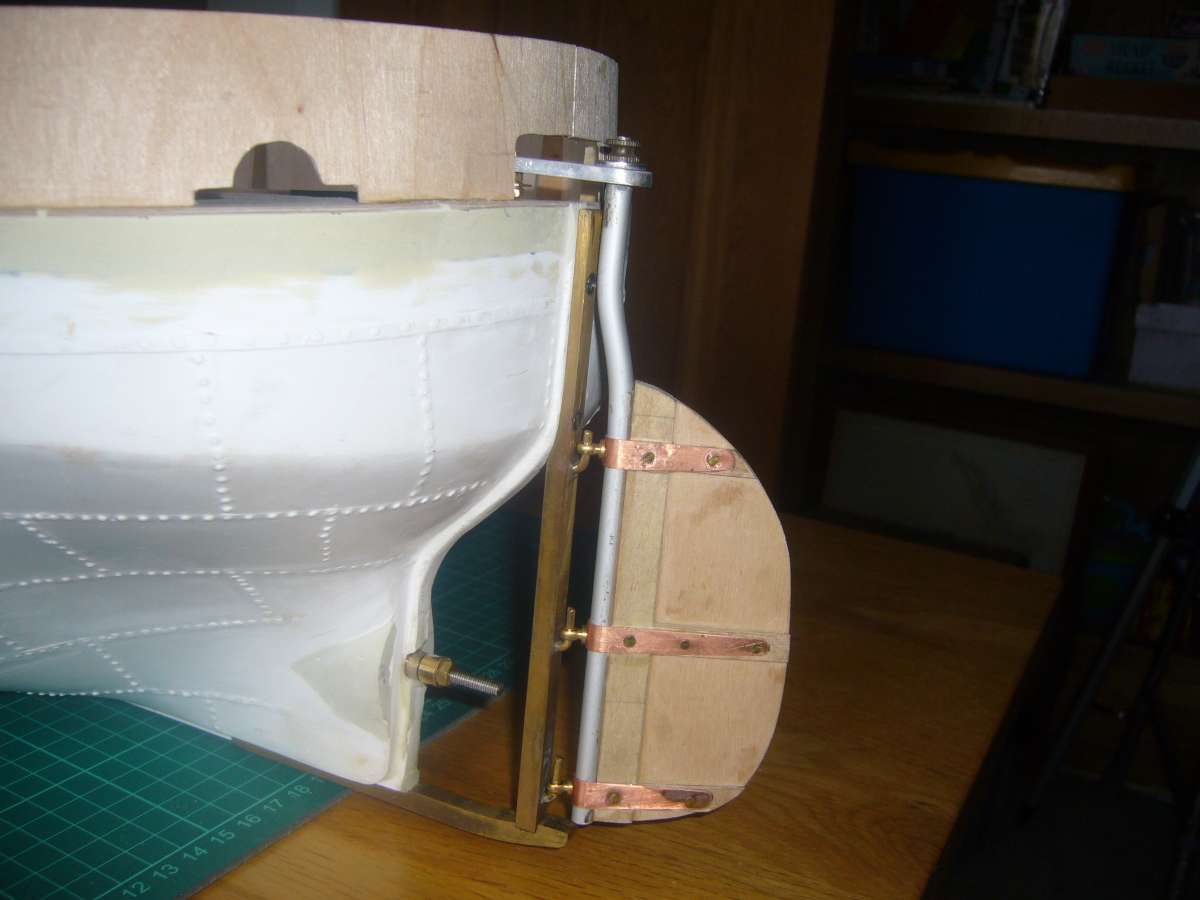

                That’s strange, last night when I did the post there were 2 pictures, the 2nd one looking down from above the tiller.

                  Hi Stephen
                  Now that is how you do a rudder, if I may I would like to use your way for when I do my other Puffer,

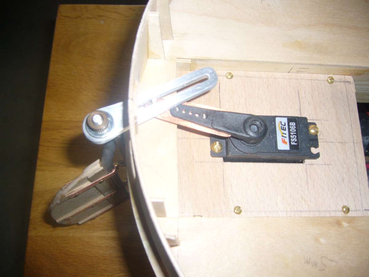

                  Stephen Garrad
                    @stephengarrad28964
                    You’re very welcome Fred, help yourself. Try again with the other picture.

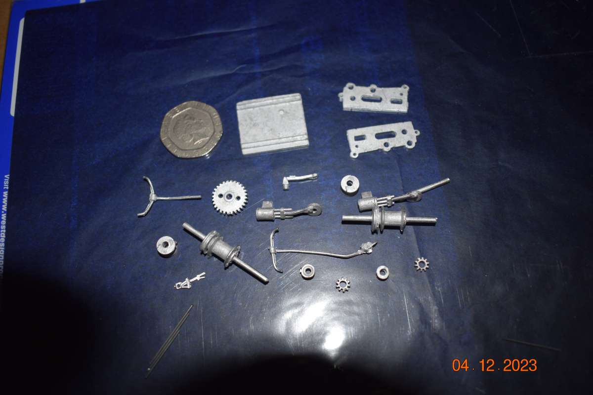

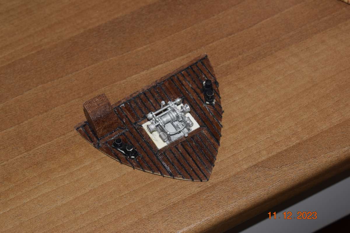

                      So today the steam winch kit from Langley Models dropped through the letter box, I must say it does look good,_DSC4408

                        That should make into a nice little steam winch I should think. I’ve been looking at one myself in 1/24 scale made by a firm called Battlecraft. They do complete deck fitting kits for a Puffer, which is tempting , but I’ll try and make things first, unless it’s a bit too fiddly.

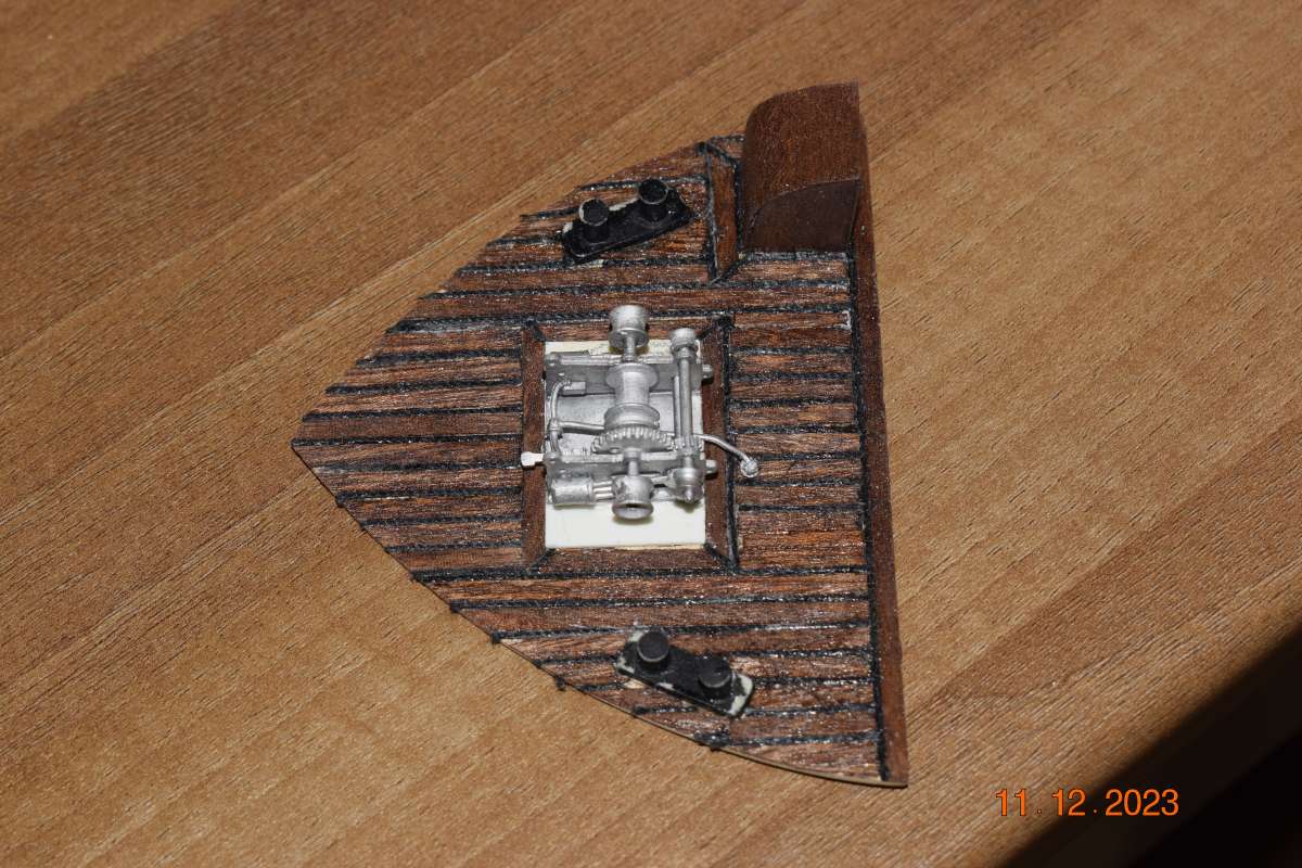

                              I have now finished the winch, just need to paint it and add some weathering.
                              _DSC4413_DSC4412

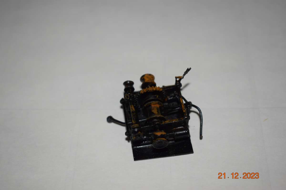

                                        #117287
                                        Fred Ellis 1
                                          @fredellis1
                                          Hi One & All

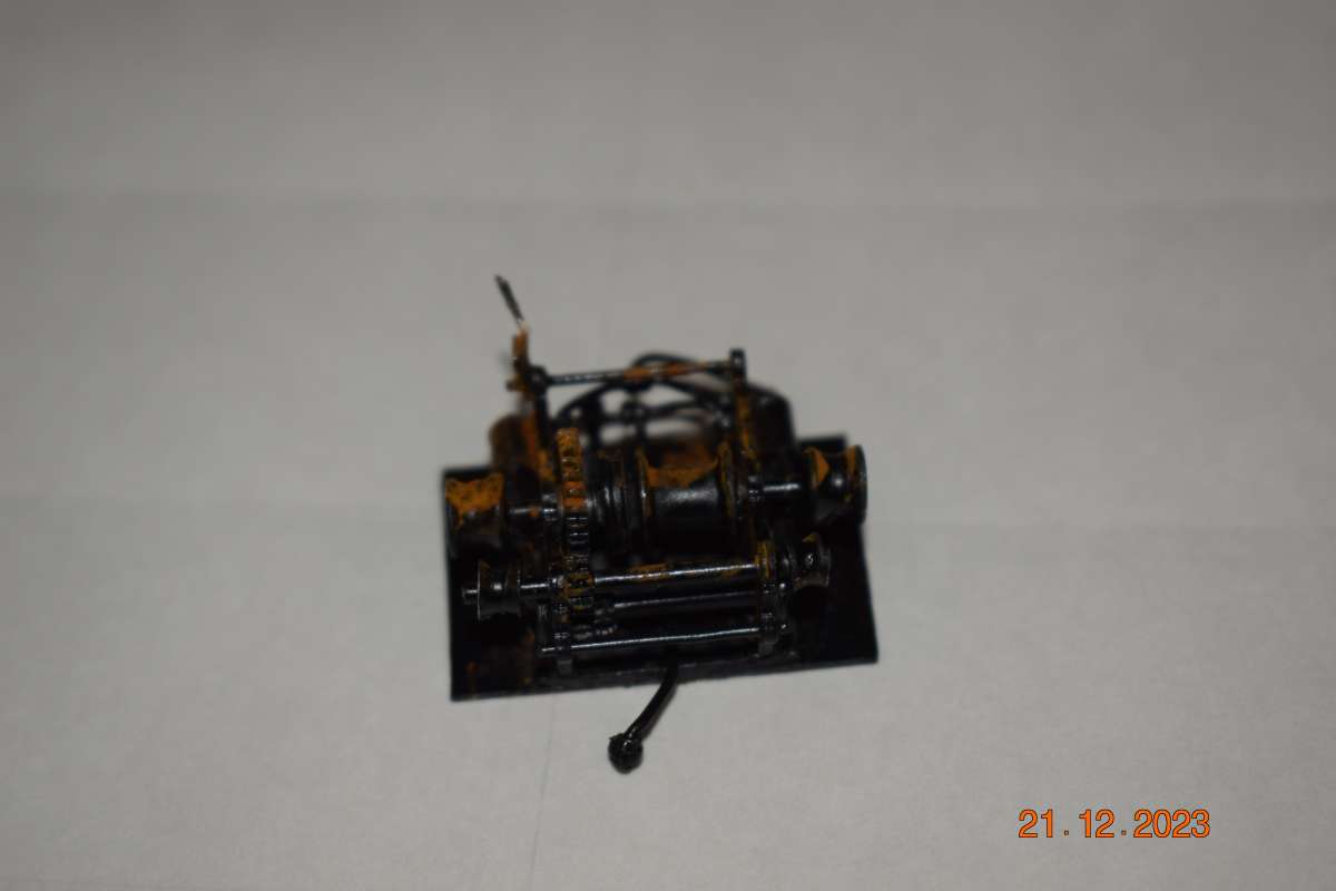

                                          This is my attempt at wreathing the steam winch; all I have done is wet the winch and placed some fine steel wool onto it and left it over night, I will in time spray it with some matt varnish.   _DSC4414_DSC4415

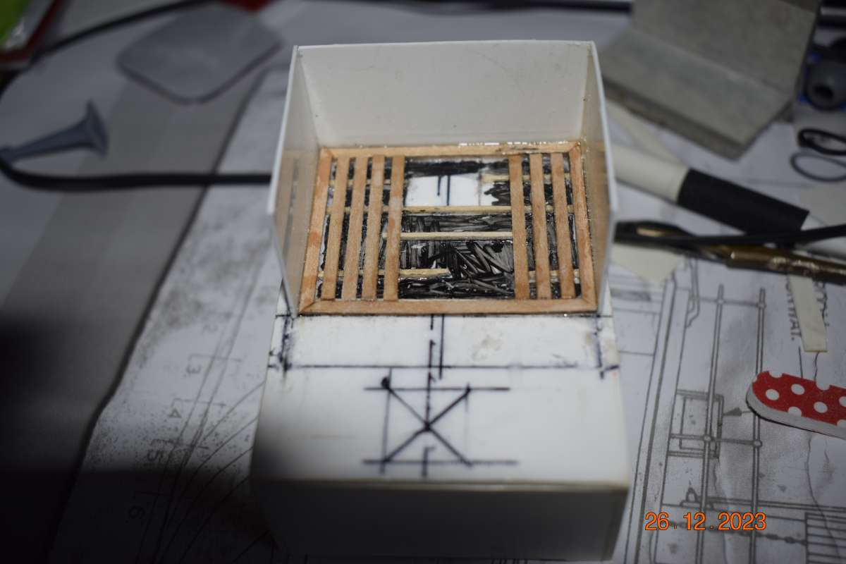

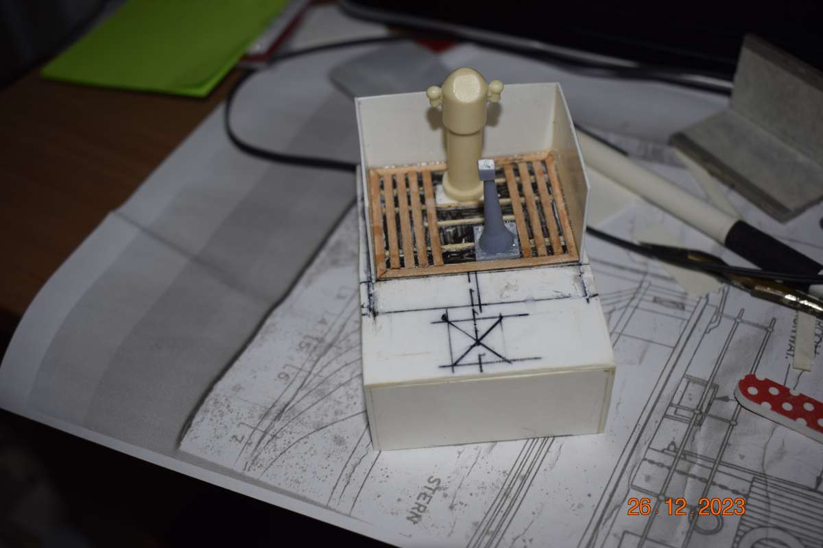

                                                  As I am doing an open wheelhouse I felt that some form of duck board should be in place, just to keep the skipper’s feet dry, I also tried out some wheelhouse fittings just to see how it will look.
                                                  _DSC4420_DSC4419

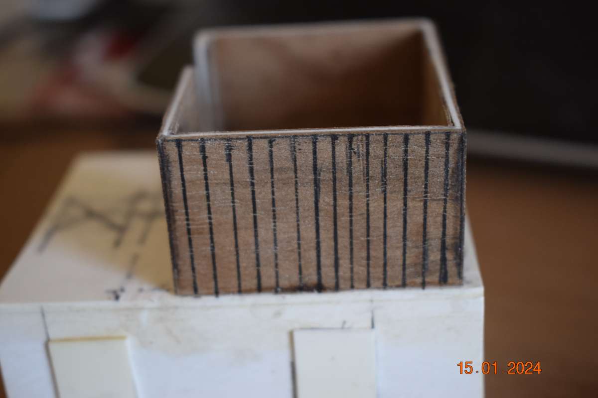

                                                    I have now marked the wheelhouse to look as if it’s been planked, and started on making the funnel, by wrapping some sheet around a pen then powering hot water over it._DSC4444_DSC4446_DSC4447
