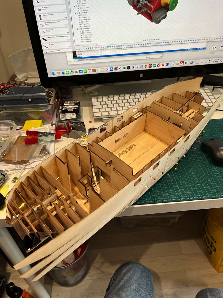

                            small progress report
                            I’ve started planking
                            quality not great but improving as I get more practice!
                            54B4E0FF-D8C5-436E-A2F9-0B08E991A223
                            next question will be what sanding/sealer to people recommend?
                            I’m guessing polyfilla is not the thing to use!
                            thanks in advance
                            cheers
                            Mike
                            #120375
                              Hi Mike,
                              Do the instructions say to plank from the keel with the smaller strips ? I’d advise you plank from the deckline working up for better looking topsides one strip each side to keep the hull straight. just saying 🙂
                              Polyfiller is fine if your going to glass cloth and paint the hull or P38 body filler .

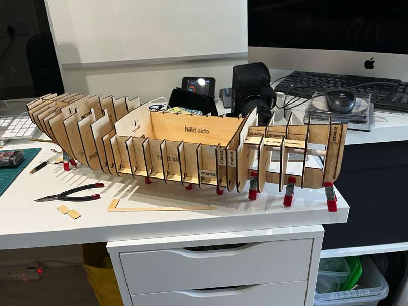

                                hello Ray
                                yes instructions were to plank from keel up, alternate sides to keep it straight
                                the plans also showed much bigger “planks” with clever contours
                                couldn’t get that to work, so abandoned and went with 5mm wide strips instead
                                much happier with the results
                                and thanks for the feedback, I might try polyfilla and also get some P38 to compare
                                apart from being my first build in 50 years, it’s also a bit of a learning curve as so much has changed
                                cheers
                                Mike

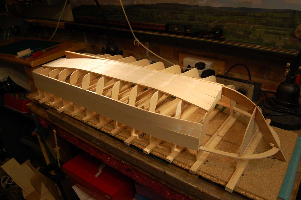

                                  Hi Mike,
                                  I went with 6mm planks on my Puffer. I found it easy to encourage them to bend when needed by just soaking the required section in water for a while,(mainly just the ends).
                                  I also marked the bulkhead positions on the planks and pre- drilled them with a fine drill, and when gluing used office pins to hold the planks in place while the glue dried. I too used Gorilla glue, same as you.
                                  Watching your build with interest,
                                  Jim.

                                      Hi Mike,
                                      Glad to see you’re having some success with the planking. It’s great to see, as you progress, the shape of the hull beginning to form.
                                      I don’t know if you’ve past that, but I made the top section down from the stern deck line in one strip (about 30mm wide). Then planked up to it from the top of the bulkhead curve. Then planked out from the keel to the bottom of the bulkhead curve, then made planks to fit the remaining gap.
                                      I appreciate you may be well past this point, and if so, you won’t need any of what I’ve just said, but it may help.
                                      Jim.

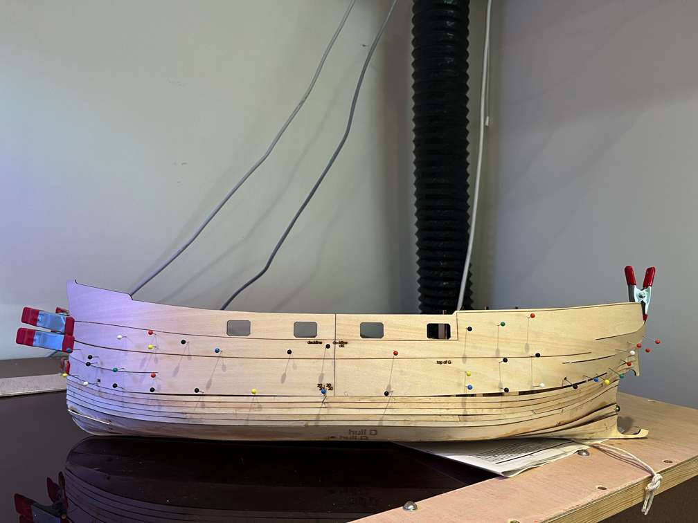

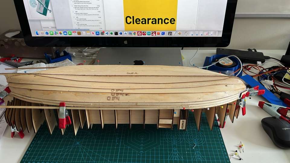

                                              project update
                                              planking coming along slowly
                                              planks2
                                              planks3
                                              have got some P38 in ready for the next step
                                              seems to come in a tin with a sachet of hardener
                                              I don’t think I want to mix up the whole tin
                                              how do people judge how much resin to hardener?
                                              or just guesswork?
                                              cheers

                                                It tells you in the instructions but it is in the region of 50 to 1 by weight but there is a fair degree of leeway.  You can only try to guess correctly.  Just remember that if you put more hardener in than required it will harden faster and if you put less in it will take longer to harden.  Temperature also varies the hardening time.
                                                You are right though, don’t mix too much as you only have around 5 to 6 minutes before it starts to cure and you don’t want to be applying it once it has started to cure as it won’t fill the gaps and key to the wood properly.

                                                    Hi Mike, Your hull is coming along well.
                                                    I must admit when doing mine I found it a bit daunting when you looked at the gaps that had to be filled with carefully sanded down planks to fit. But it turns out ok in the end.
                                                    Myself, I used Ronseal wood filler to finnish off. Are you going to plate the hull? I`d thought about it before it was suggested that it would look a lot more realistic, so I took the plunge and had a go. A couple of false starts before I got what I was looking for. Worth the effort though.
