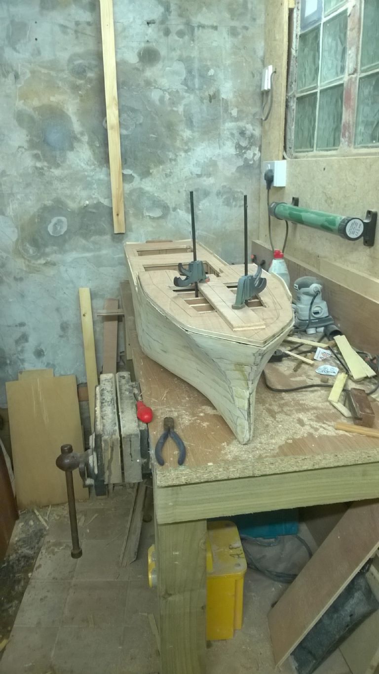

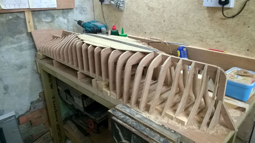

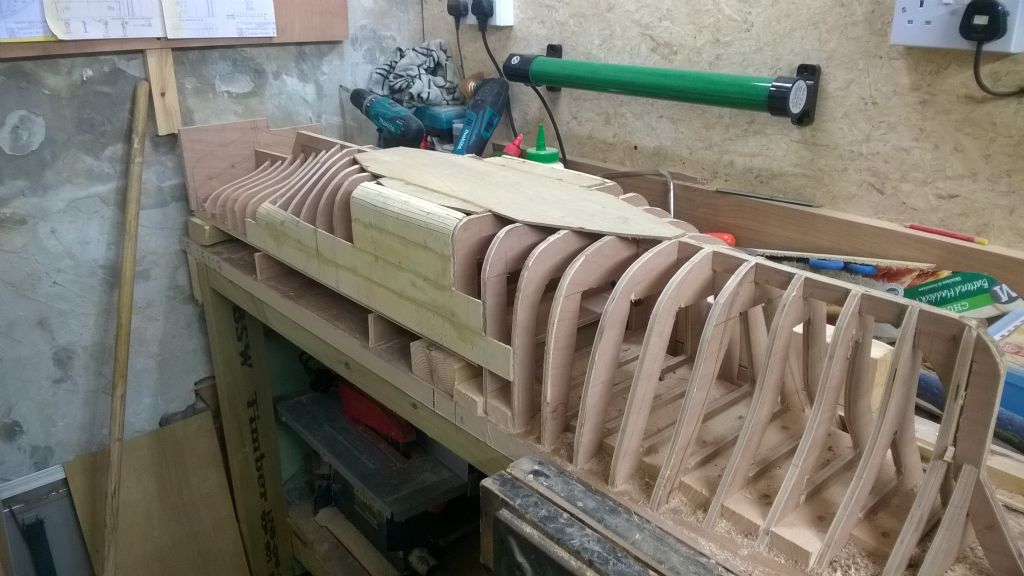

                #63397
                ANDY porter
                  @andyporter91883
                  #63398
                  ANDY porter
                    @andyporter91883

                        The tug hull looks interesting. Lots of challenging planking ahead. What is the type of tug and what scale is it?
                        Haig

                          thank s guys will try with just the lock nut and hope.she will be a ocean going tug when done.as to scale i dont really know the plan i have is at 1/200 on a4 paper downloaded from tinternet.then just measured of plan and x4 with a bit of rounding up or down.sees to be coming together ok planking was a mare
                            #63483
                            Haig
                              @haig
                              Looking good. It will be all worthwhile when complete.
