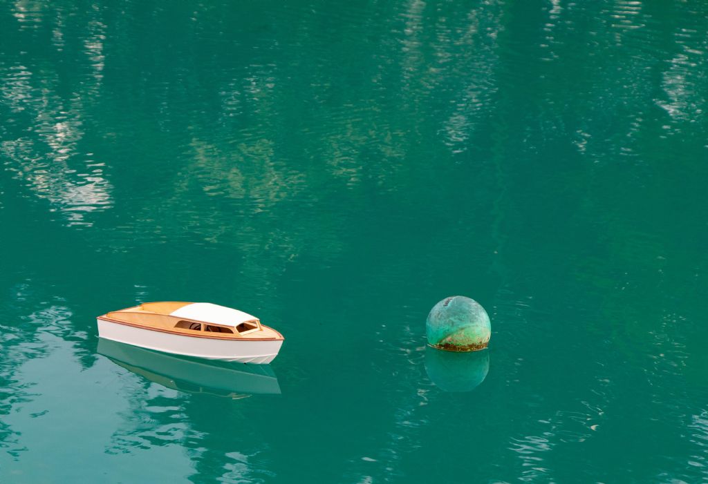

        Very droll Harry! Guess what, I hit one when taking photos, fortunately not hard.
        There are 6 buoys, which we race around, and the percentage of water that they take up is very small but they are like flippin' magnets!

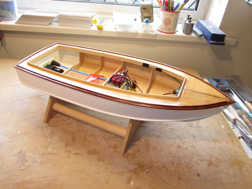

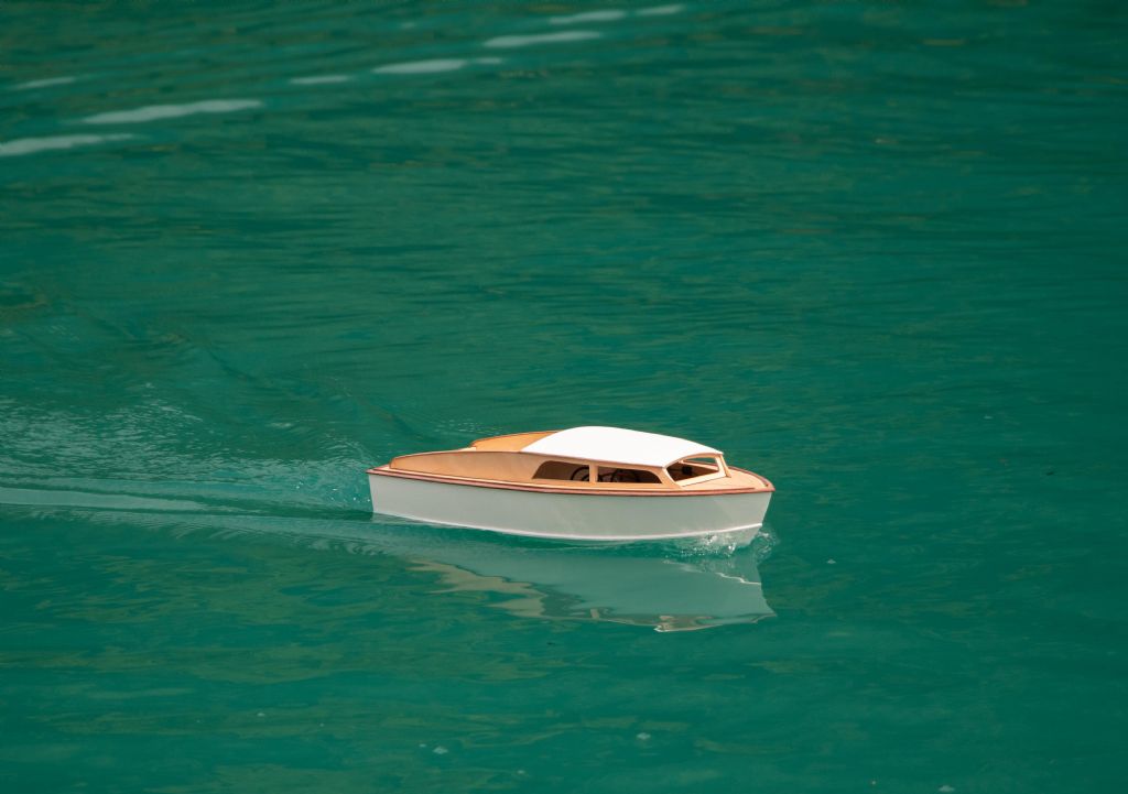

          Lovely day at the lake but not enough wind for my yacht, so a few slow circuits and then put back in the car.

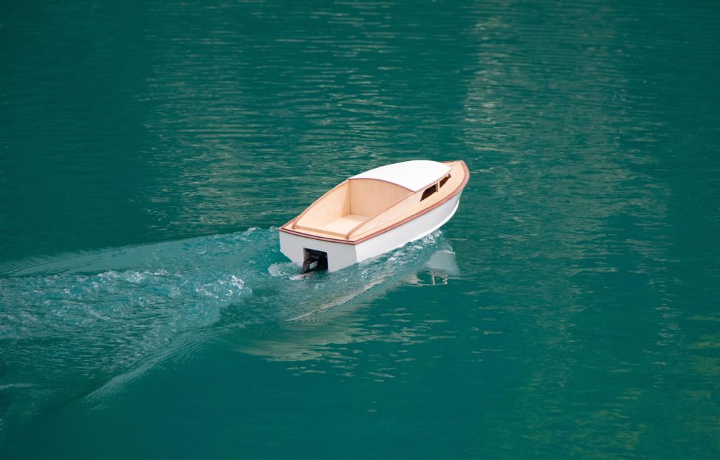

          Then out with the Huntress. Pre-sailing checks picked up that the steering was the wrong way, soon sorted in the Tx. Then onto the water. As said before it pulled away nice and slowly but when working up to full throttle it wasn't going very fast! It didn't sound as though it was revving very high. When setting up the Tx I set the end-point for forward throttle at 100 (sounds logical) but the limit was 150 so I increased it to 140, the highest it would go. That was more like it, nicely on the plane and looked about scale speed, this is on 3S. Maybe a touch more speed would be nice but not essential – I have fitted a smaller prop than the one supplied as it was very tight on the threads.
          I don't build light and with the stern-drive, battery and RC gear this little 23" boat has gotten quite heavy. But I think that is a good thing as it sits nicely on the water, corners in a controlled manner and produces a good wake. The steering throw is about right and it manoeuvres well at slow speed and corners well at high. It even reverses quite well. So no drama when coming into the jetty.
          As you can see no windows yet, but the deck stayed bone dry with the chine rails doing their job. And no water via the stern-drive either.

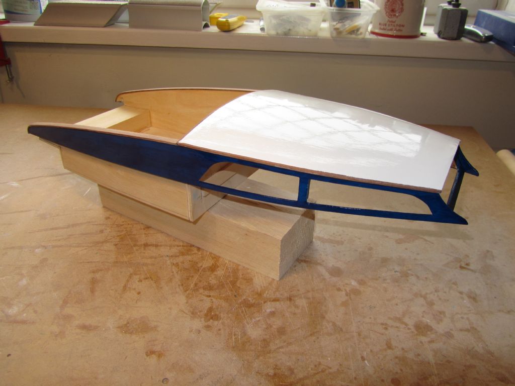

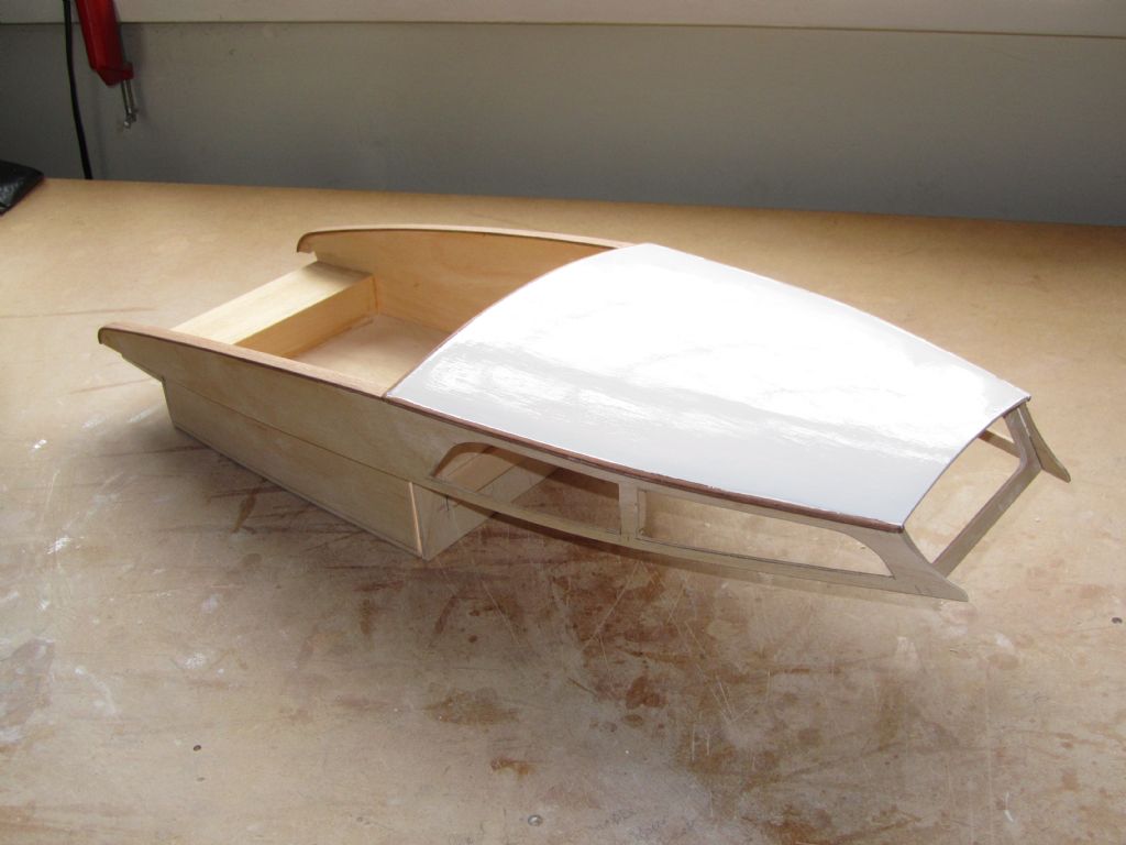

                  As said on the River Cruiser thread the roof looks pretty good, so at last I've put the first coat of blue primer/undercoat on. Will put another one on tomorrow and can then start the gloss.

                    Didn't need another coat so I started the gloss.

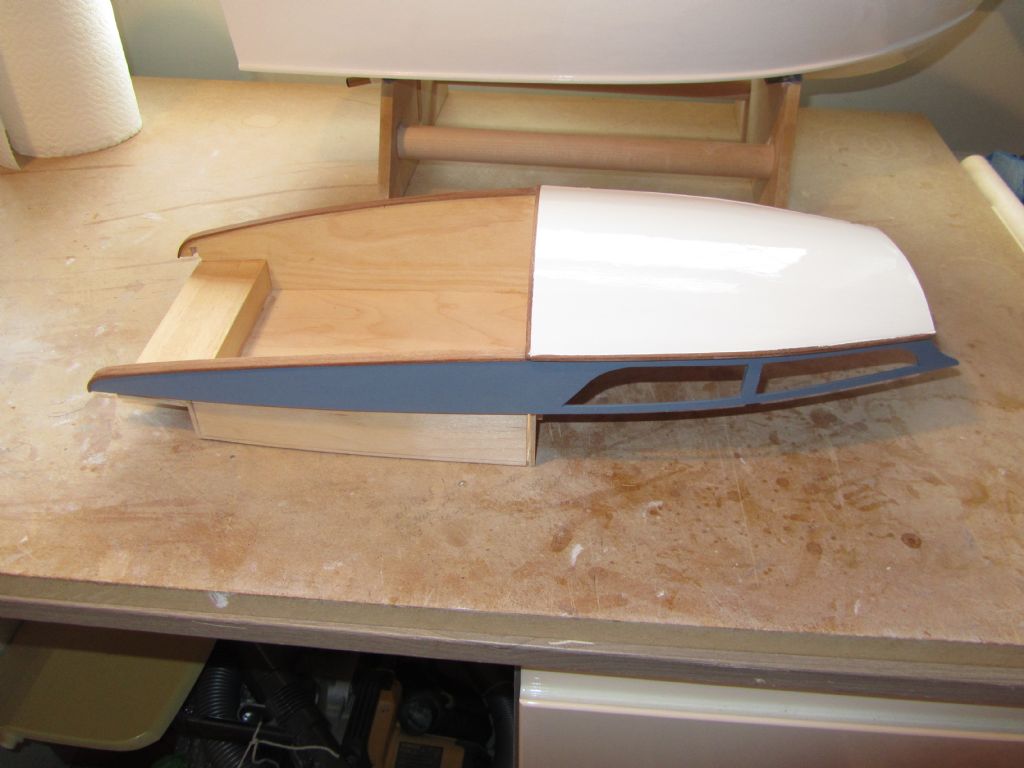

                    Well at least I got this blue right! Full size Faireys are often painted in Oxford Blue but not always, dependent on what the owners want or think is right.
                    I thought it was a bit too dark for my liking so went for Sapphire Blue, which is a bit lighter and more vibrant and is just what I wanted.
                    Three coats on now and it's looking good – going to need a few more though. It's nowhere as dark as in the photo.
                    Also gave the deck a coat of varnish using the foam applicator and that's how I want it now. Used a brush before and put far too much on and it looked horrible. I know decks shouldn't be gloss but there won't be any little people on deck!

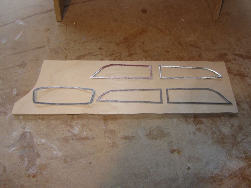

                      Glued window frames to 0.5mm acetate.

                        This morning I cut out the windows from the acetate sheet. Tried a knife but found it easier using good quality nail scissors. I then removed the protective layer and painted the edges of the glazing and gave the frames another coat. Didn't know when ordering but the acetate has a very pale blue tint to it, so goes well with the Fairey colour-scheme.

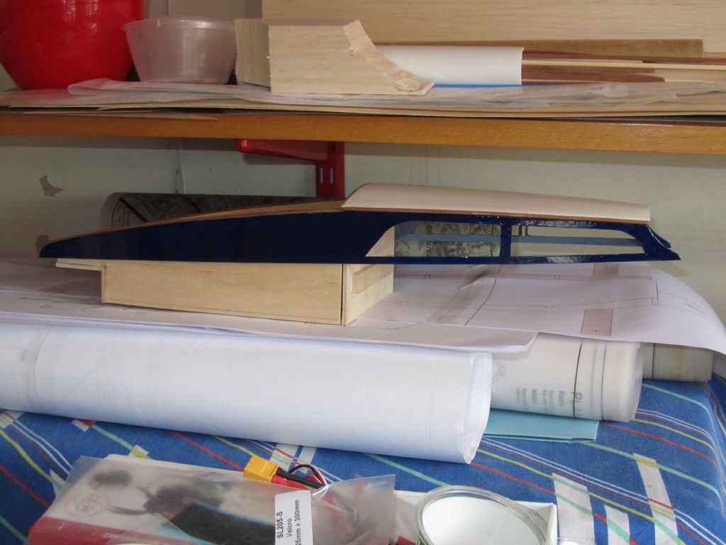

                        #105621
                          Gave the sides another coat of blue yesterday and coverage is pretty uniform now. Inspected it this morning and looks OK but a lot of tiny particles in it, I think from the brush, which has been used a few times.
                          So after a light sanding with micro-mesh, broke out yet another new brush and applied what I hope is the final coat. Fingers crossed! Need to get yet more new brushes.

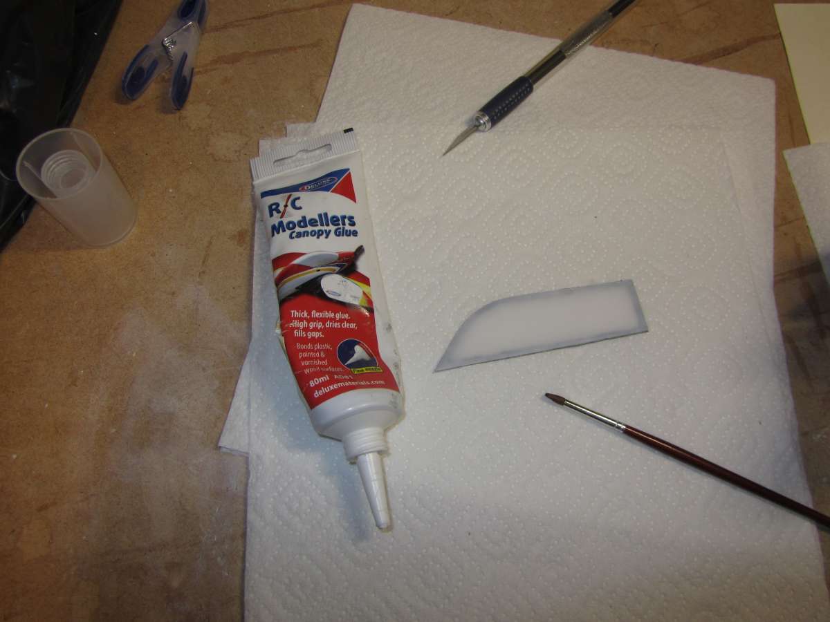

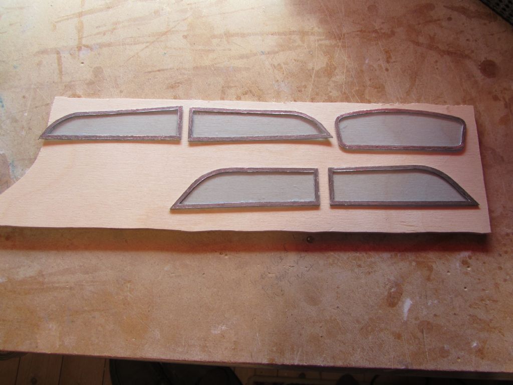

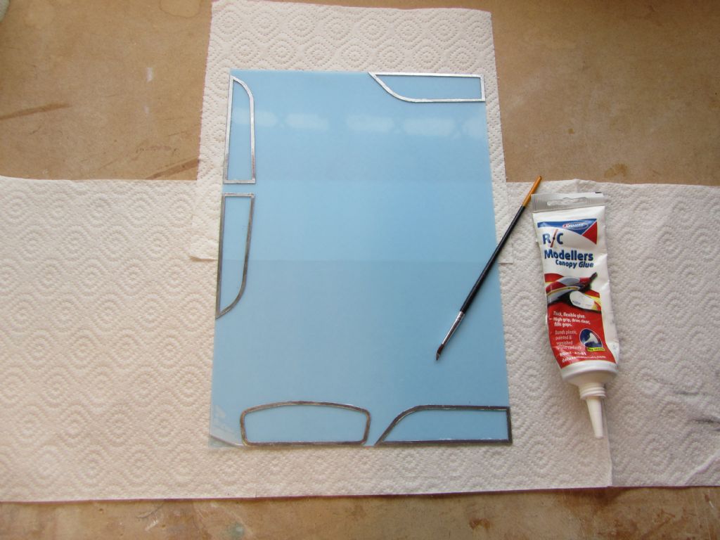

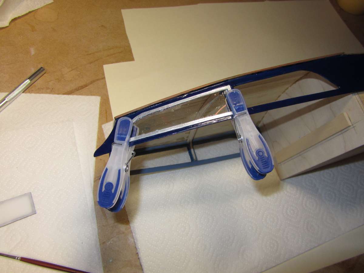

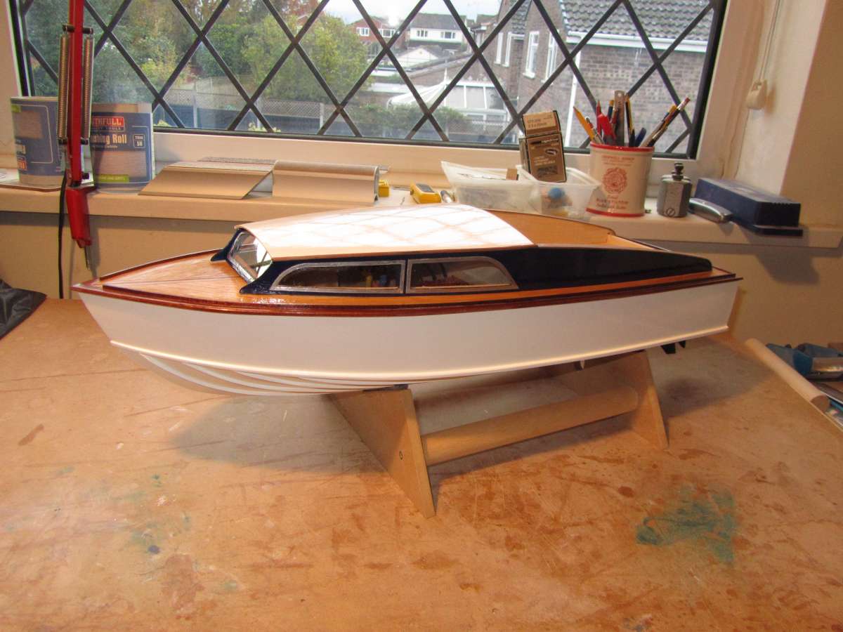

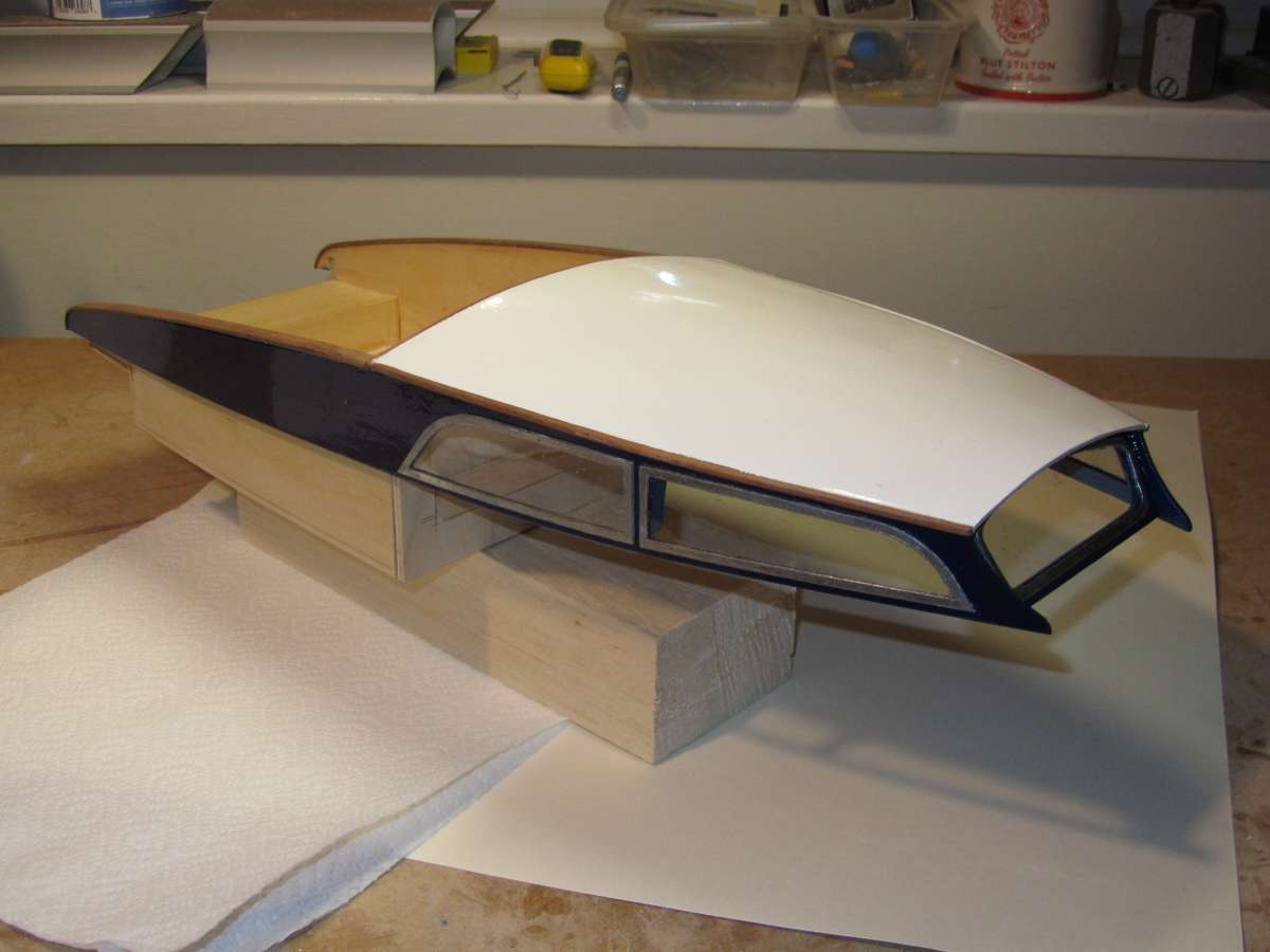

                                Anyway I’ve been a right idiot! Remember me saying that the glazing was a pale blue? Well it isn’t. The colour was due to another protective film on the other side and I’d glued the frames to it! What a plonker! I only picked up on it because I decided to give the frames another coat of paint and so masked around the inside of the frames and noticed a few days later that where I’d masked up the surface was rippled. I’d used good quality 3M tape and couldn’t understand what had happened. Then the penny dropped! The frames was pretty well secured but I couldn’t leave them obviously.
                                So I separated the frames using a finger nail and reglued them to the acetate after removing the blue film! In my defence, they have used white film on white side and blue on the other and they are quite difficult to get off. Yeah, flimsy excuse I know!
                                Making the windows was another one of those jobs I didn’t fancy doing and gluing them in place was another. Didn’t go too bad in the end, though I have managed to get some Canopy Glue on the glazing. I’m hesitant to try and remove it as the acetate is easily scratched. I’ll try a test piece as I do have some special polish I use on my motorbike screen.
