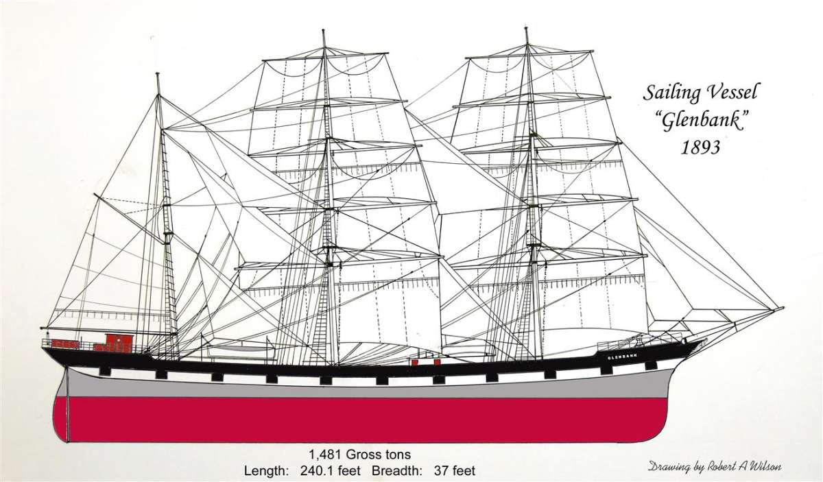

                                I draw my own plans, but do not use CAD or anthying like that, and have had no training in such things.   I draw them on large sheets of drawing paper and photgraph them with a normal digital camera.   I then colour the resulting jpegs in with Adobe Photoshop.    I sell them as downloads on  Payhip.   It is free to join, and they only take their commision when anything sells (5%) and send the profit to my Paypal account.
                                I don’t charge much, but it all adds up and since 2014 when I joined, has now topped the £7,000 mark.
                                Here is my latest, completed today.  https://payhip.com/b/CcVAy
                                Barque Glenbank.

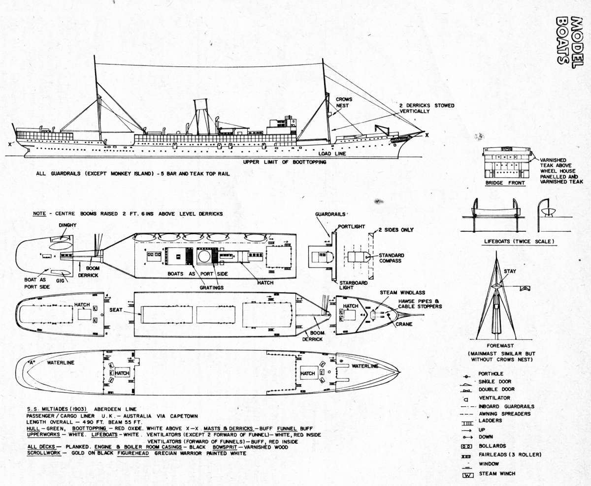

                                  I am currently persevering with a 1:150 scale model of the liner Miltiades of 1901. The reference sources I have are:
                                  1:1200 scale plans from R Carpenter in Model Boats magazine.
                                  1:1200scale plans published by John Bowen in his Miniature Merchant Ships model book
                                  Umpteen photos I took of the builder’s model in the London Science Museum before they put it into storage
                                  Very many photos of the original builders plans now held by the National Maritime Museum of the ship as originally built and subsequently lengthened from a visit with Ashley Needham in 2019.
                                  Various internet photos of the ship taken during her service life.
                                  And guess what? There are notable discrepancies between most of these sources. In some cases the design has been simplified for modelling purposes but quite significantly. In others the builder’s model does not conform to the NMM plans. The reality is probably that various minor changes were made to the appearance of the ship whilst she was still on the building slip and these are not reflected in the builder’s model
                                  So my model can never be more than a ‘best guess’ based on interpolating the various sources and in the knowledge that a definitive solution is lost forever!
                                  When undertaking a project like this it is really helpful to have full details of the interior layout of the ship as this does help to clarify some of the issues. In this case there are some oddities as the space under beds on the promenade deck is used to provide light and air to the cabins on the deck below. You expect decks to be level but in this case there are instances where they are perforated to give light and air to the one underneath! (see pic)
                                  Anyway, it is all an interesting puzzle  although unlikely to be appreciated by anyone casually viewing the model.
                                  DSCN0214 (DTR))

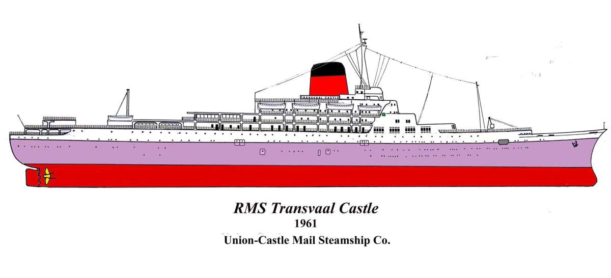

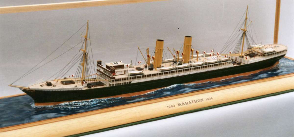

                                    Hi Colin,
                                    I once built Marathon, sister ship to Miliades,  from the John Bowen plans.
                                    By drawing them large, photographing, and colouring in with th PC, they look a lot better than the large originals when printed small scale, and were a lot easier than I thought.
                                    Marathon (Large)
                                    Transvaal Castle for frame copy (Large)

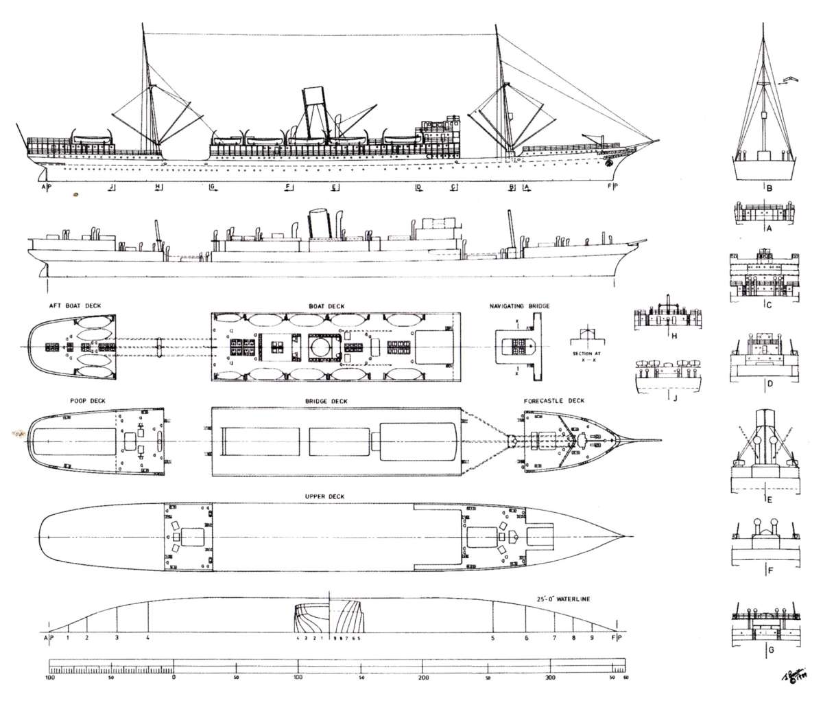

                                      The John Bowen plans are fine for miniatures but are not accurate for larger models. The promenade deck houses have been massively simplified for example. The Carpenter plan has got the central deck house wrong too.

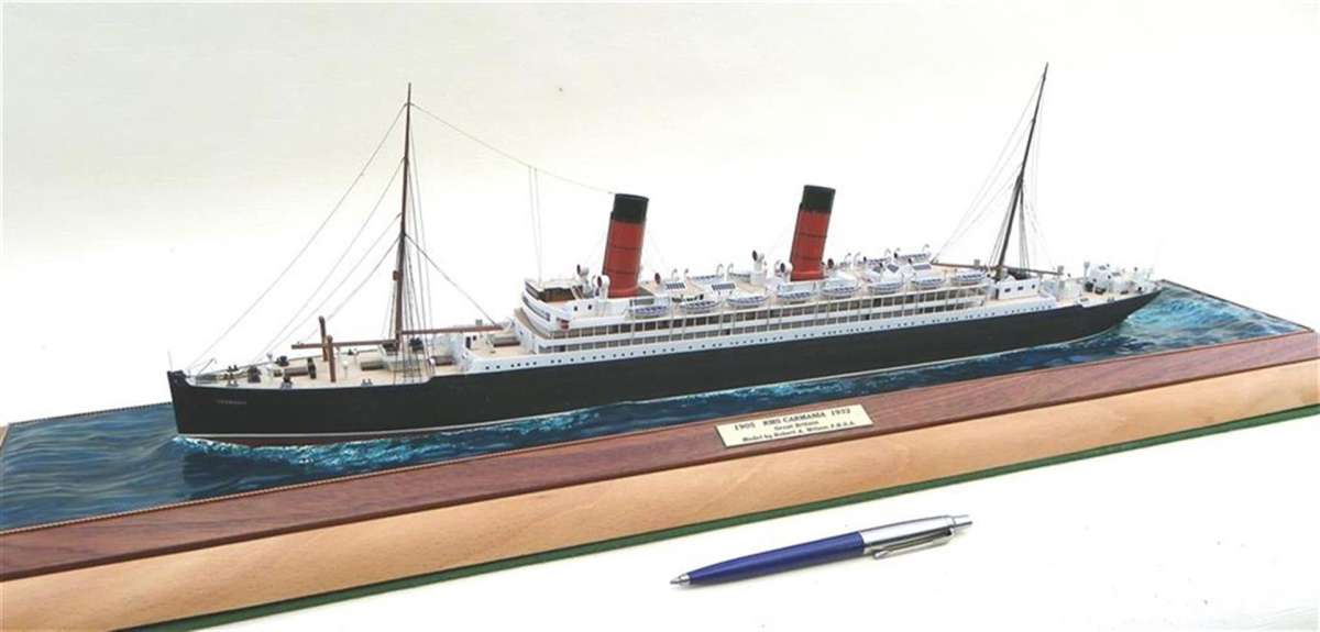

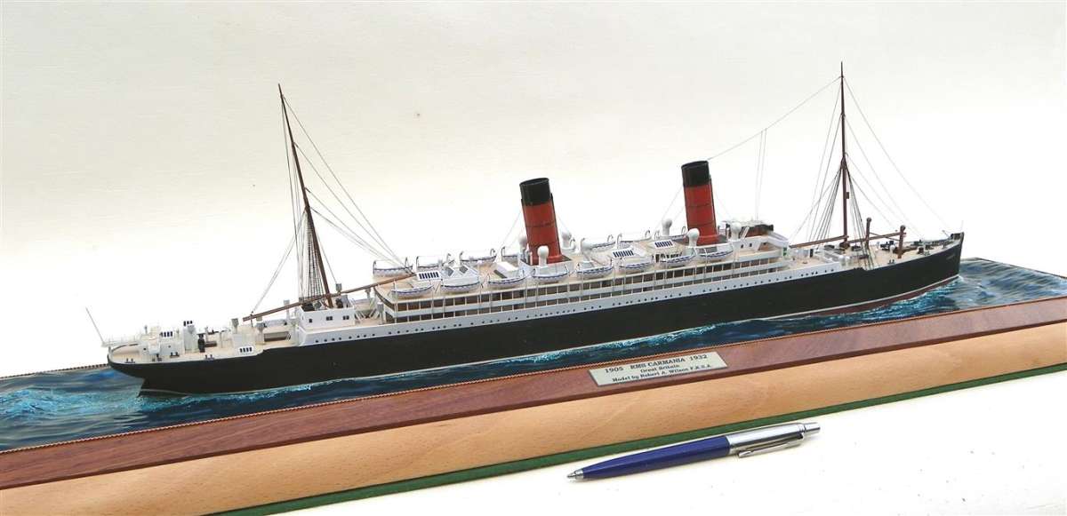

                                        @bobwilson59101
                                        It never ocurred to me that the Bowen plans may have been innacurate, as they looked perfectly in proportion, and I knew that he had the original plans to work from.    Here is a fairly large Carmania that I buit from a Bowen plan, and everything seemed to agree with the many photographs.
                                        Carmania (Medium)
                                        Carmania 100 - 1100 (Large)

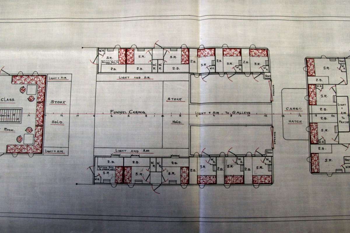

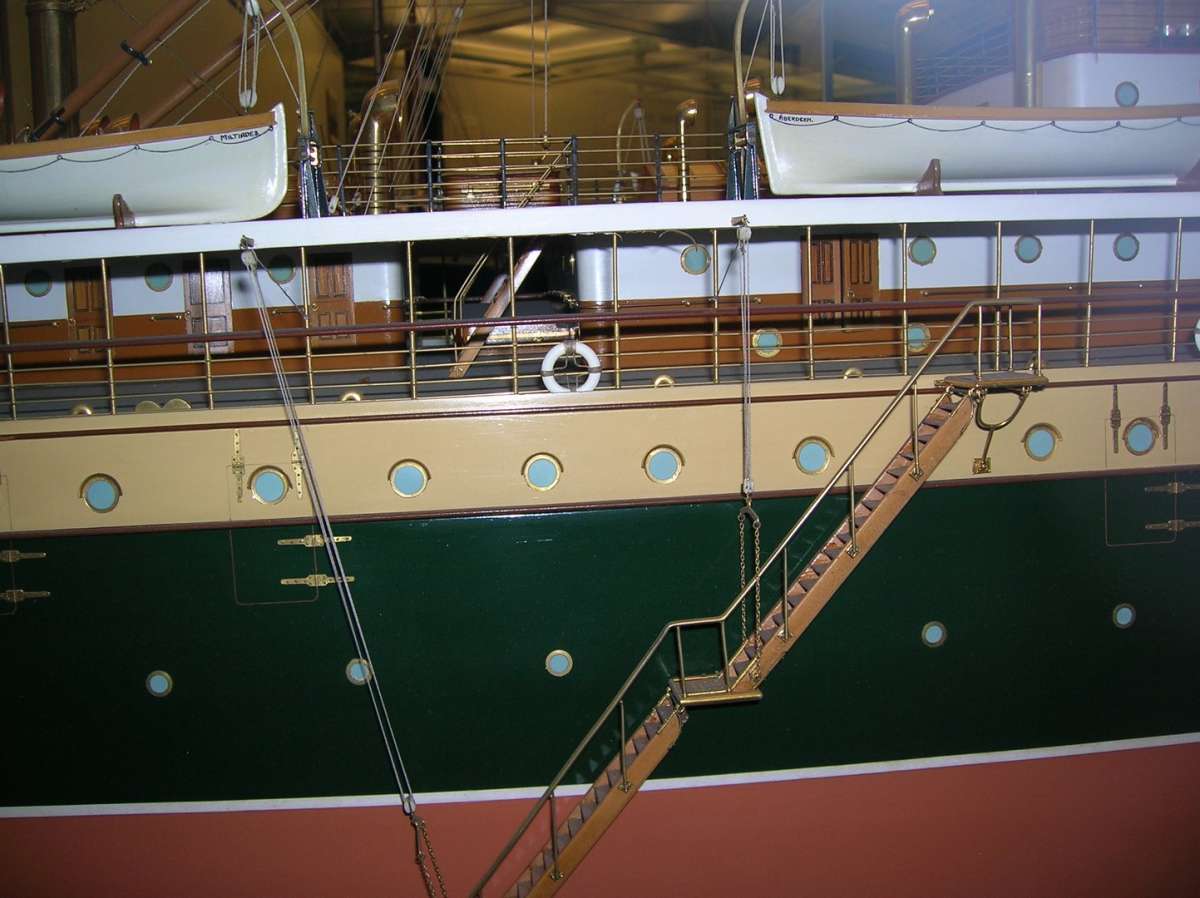

                                          I think the proportions are generally OK on both the Bowen and Carpenter plans. You can only show a limited amount of detail at 1:1200 scale anyway.
                                          The drawings in the NMM collections of Marathon/Miltiades are a mixture of ‘as built’ and ‘as rebuilt’. When looking at them it is easy to be confused as they are mixed up together. Just out of interest, here are the Carpenter and Bowen plans and my photo of the central promenade deckhouse taken from the original drawings. Both Bowen & Carpenter have omitted the cabins flanking the boiler casings. Also, Carpenter shows shell doors along the main deck which are not present on the Bowen drawing. Simplification for 1:1200 scale models is understandable but it does show the dangers of scaling up without supporting information.
                                          And when there is a discrepancy between the builder’s model and the original plans then either could be correct!
                                          Colin.
                                          Plan_0004Miltiades Bowen Plan
                                          Central Deckhouse

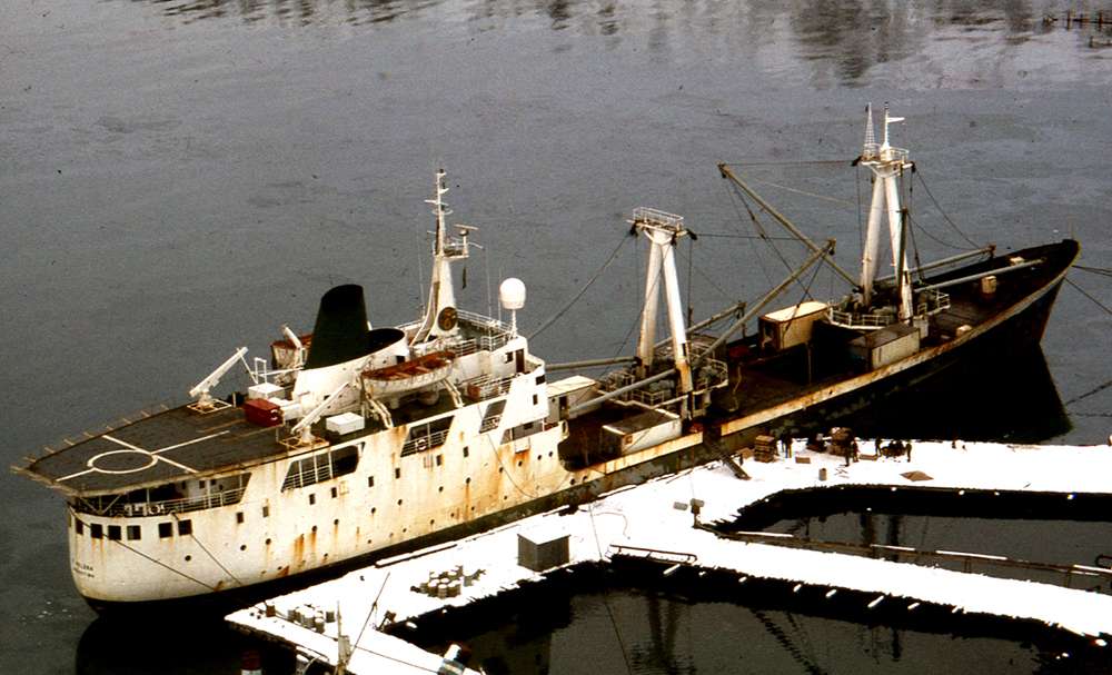

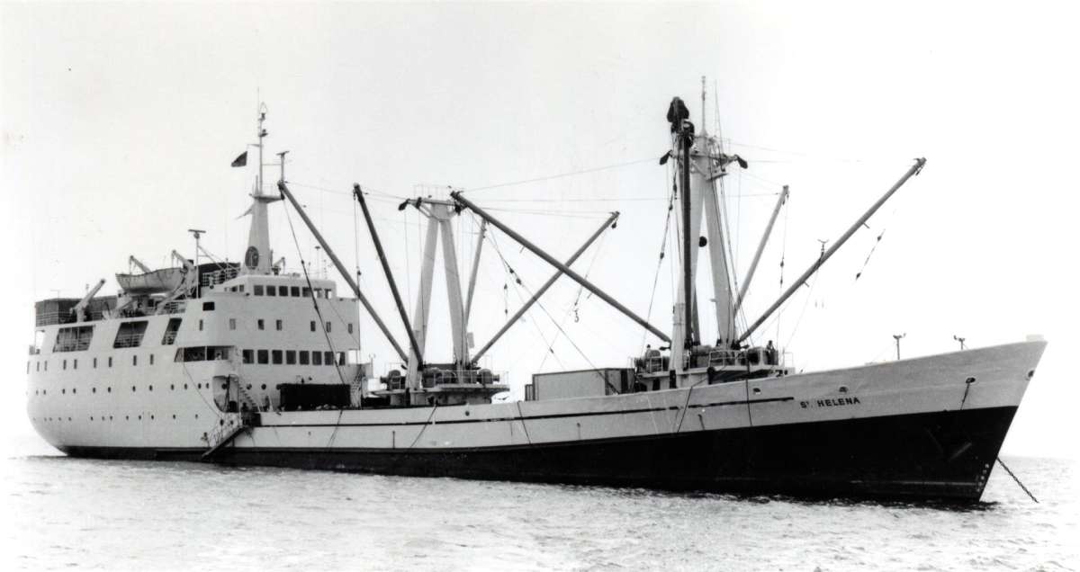

                                            @bobwilson59101

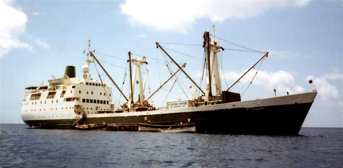

                                            I suppose it is like models, you can have a hudred models of  Cutty Sark and they are all different in some way.    This is especially true of warships where what a battleship looked like in 1920 is often totally different  to what it looked like 20 years later.    I spent 11 years in the St Helena, but at the end, she presented a totally different appearance to when I joined (See below).    I long ago abandoned the “perfect in every detail” approach, and just built to the original plan, maybe changing some parts to agree with photographs.   No one has ever complained, and I am talking about 288 models completed and sold over the years.
                                            RMS St Helena from the mountainSt Helena at St Helena5 St Helena before the funnel was extended

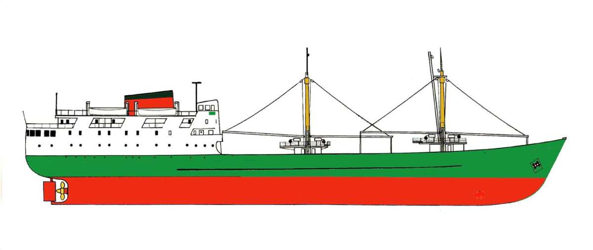

                                              @bobwilson59101
                                              And this is the St Helena as completed as Northland Prince in 1963.
