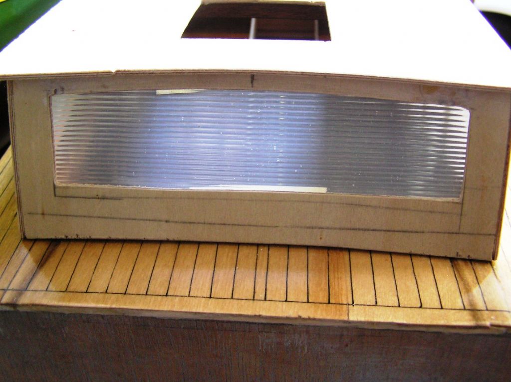

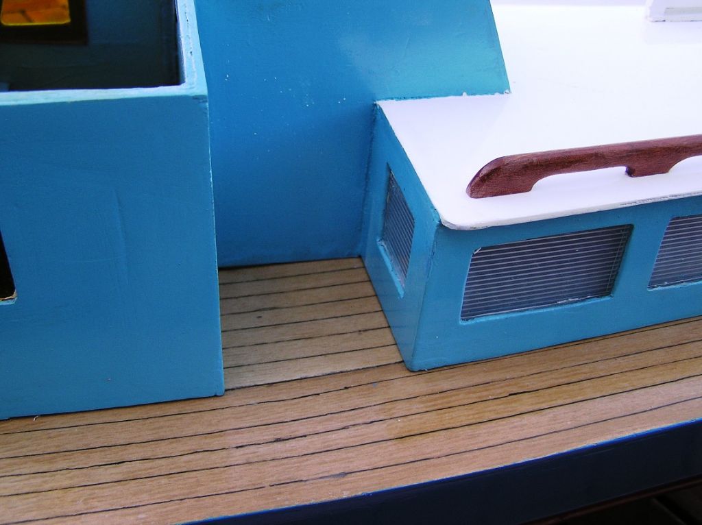

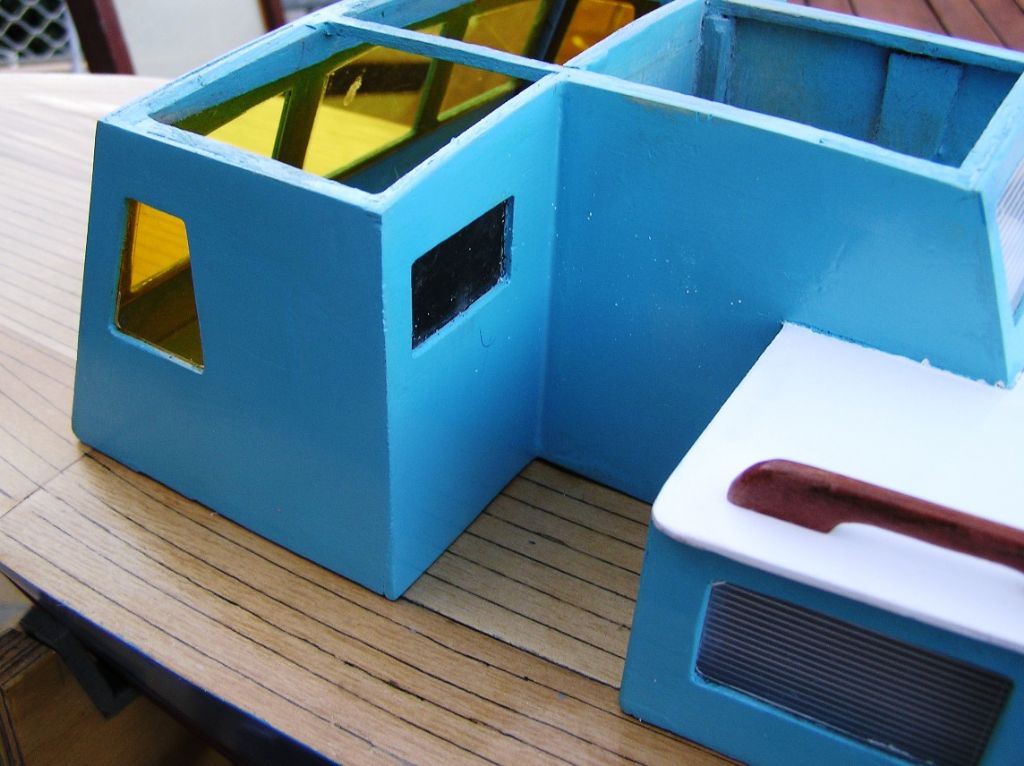

                    p1010157.jpgp1010156.jpgp1010155.jpgHi Lads
                    I cutout the windows from an old flo lights for the rear cabin and perplex for the forward wheelhouse.
                    A small window of good weather for us in late Autumn, the next is getting paint on the bottom of the hull.
                    As I have no idea of the waterline, I am only going to oxide red up to the spray railings.
                    #87444

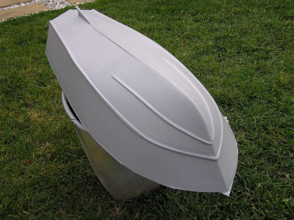

                          #87778

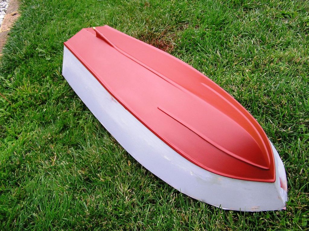

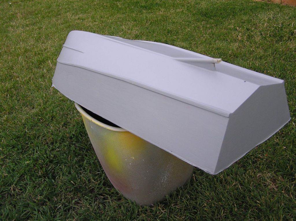

                            p1010160.jpgp1010159.jpgHi All and The Spell checker
                            Spay painted the hull before another cold front hits Tassie again .
                            While the paint is harding up, I can work on the cabin.
                            Waiting on servo's, motor, ESC and some receivers.
                            The 28mm motors are not handling the prop I have, so running them at 65%.
                            The new 35mm is slower rpm but with more power.
                            I have not had this motor before, so I will give it a go.

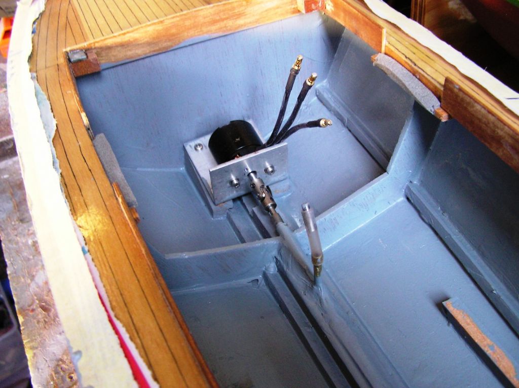

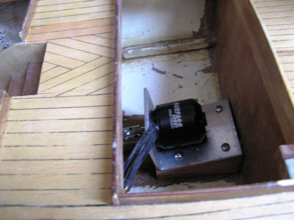

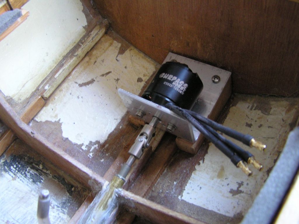

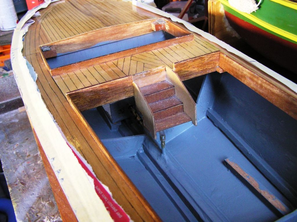

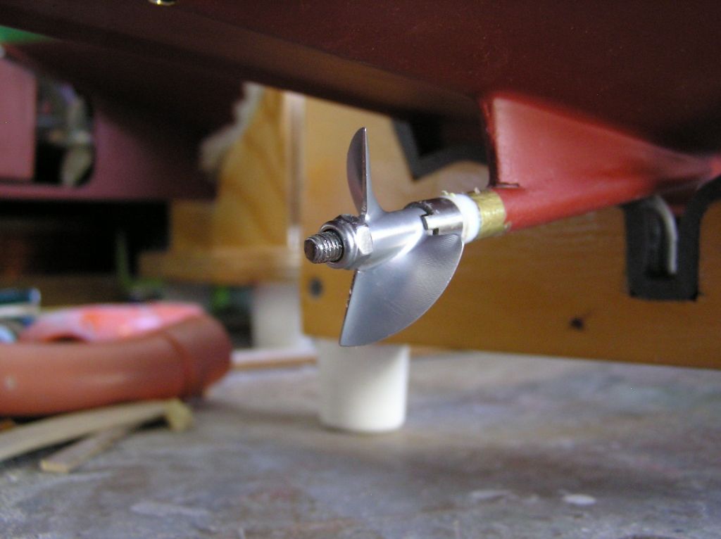

                              p1010164.jpgp1010163.jpgp1010162.jpgHi All
                              Final motor and drive line install.
                              Also added battery mount rails and painted the insides.
                              #88030
                                Harry
                                Sorry if it's a bit like calling out the Emperor's New Clothes but I've suspected since the start of your thread that this isn't actually a Perkasa and your shots of the bow from underneath have confirmed that. PK has a massive concave flare each side of the bow, and no spray rails. The bottom of the hull at the transom is flat while yours has a noticeable vee shape, and the foredeck is more rounded than your model, which is quite "pointy".
                                Does anyone have a suggestion as to what Harry's model might be?
                                #88034
                                  Hi Dave
                                  I check the deck was the same as my two Perkasa's, also length and width.
                                  The bow was incorrect, I though it was because of the wooden hull.
                                  I totally change the shape of the bottom into a vee.
                                  It did not have chine or spray rails so I added them.
                                  Harry
                                  #88039
                                    Ah – that clears that up for me. Thanks, H.

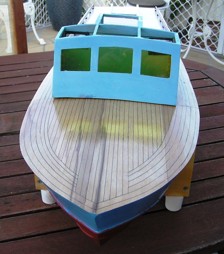

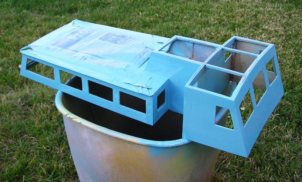

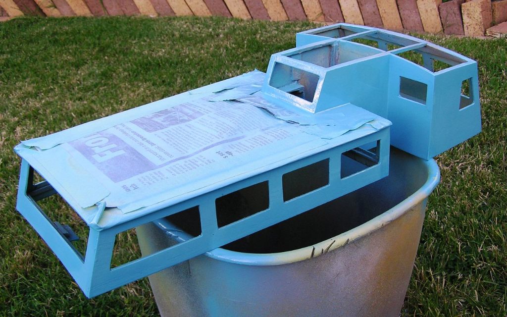

                                      p1010167.jpgp1010166.jpgHi All and Dave
                                      That makes it clear as MUD !!!
                                      Well onto the cabin/wheelhouse is in paint, mid blue.
                                      I have to get the rear section finish so I can install the top rear window before adding the wheelhouse roof.

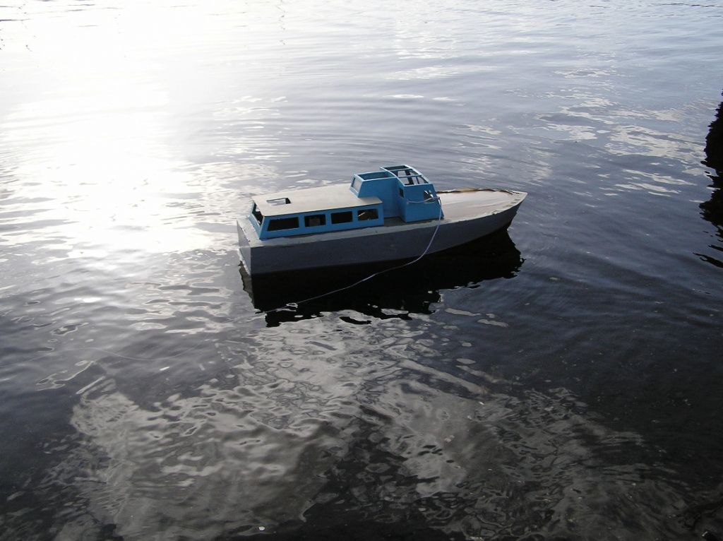

                                        p1010170.jpgp1010169.jpgHi All
                                        Well Lads it's into the water for working out the waterline and back into paint.
                                        Things are moving faster as lockdown has started to end !!!
                                        Finally !!!!

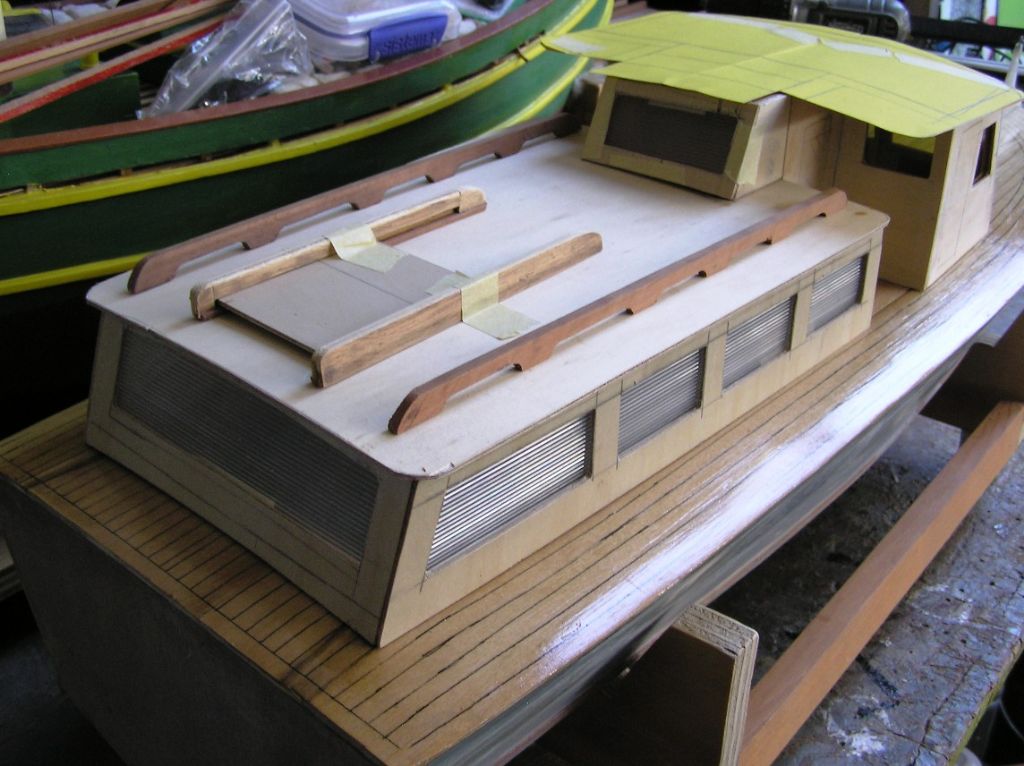

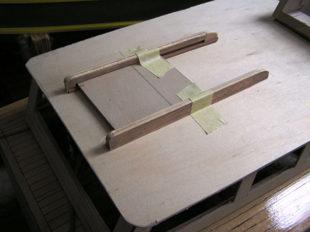

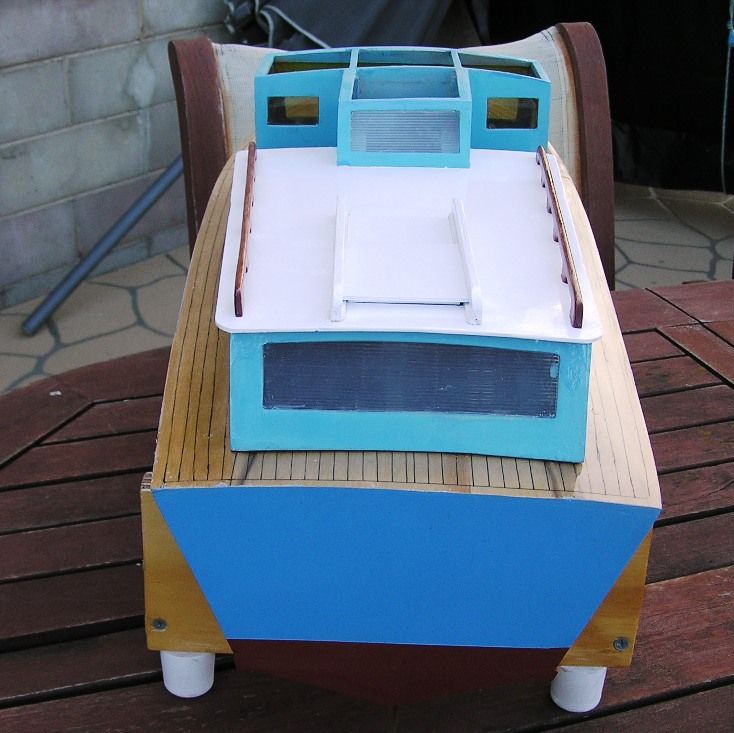

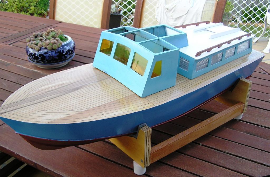

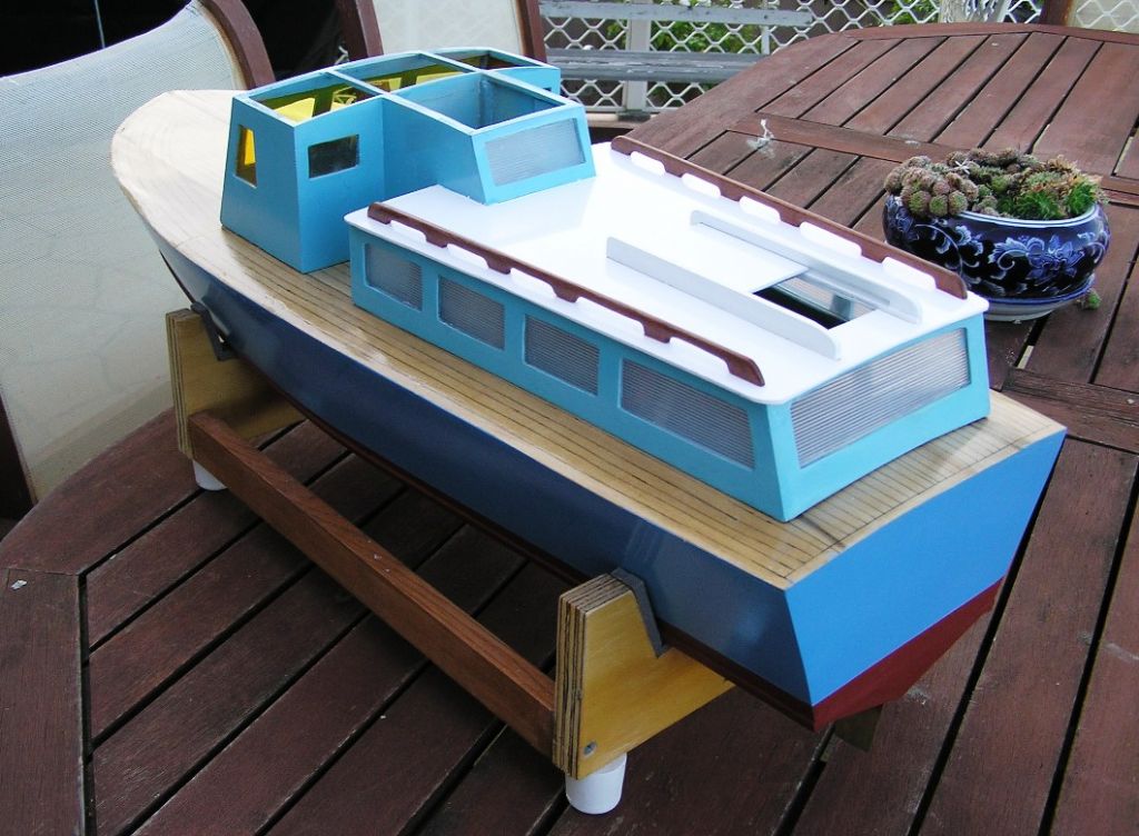

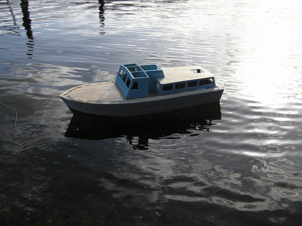

                                              p1010176.jpgp1010175.jpgp1010174.jpgp1010173.jpgp1010172.jpgHi All
                                              May be a couple of Barbies !!!!
                                              A lot more done, but no doors or wheelhouse roof.
                                              Still I hope to test it out on Saturday!!!!
                                              A prestart meeting as a number of members still do not feel that is safe for them.

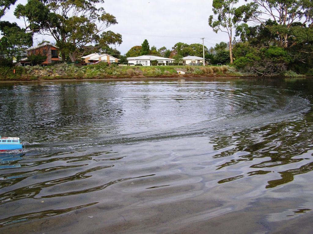

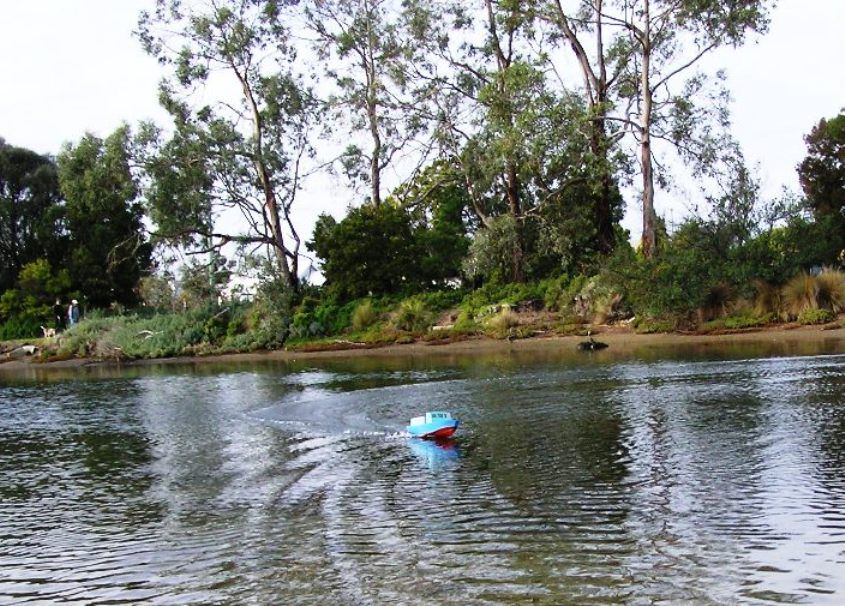

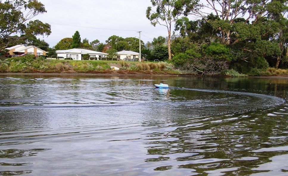

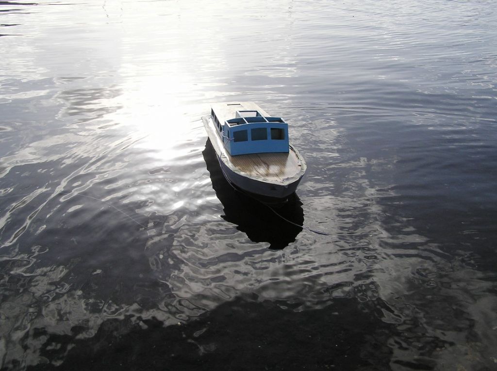

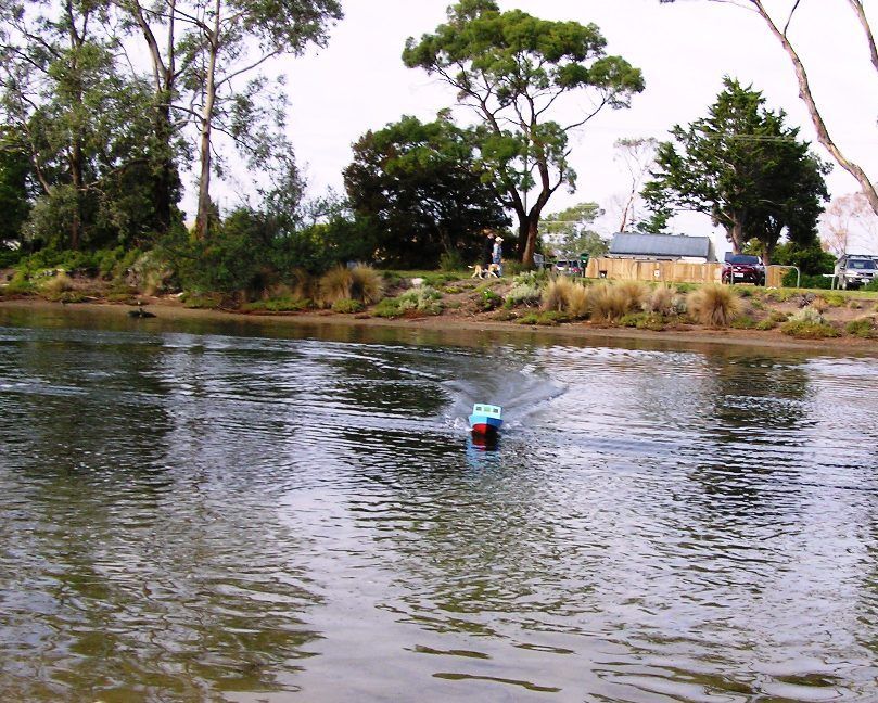

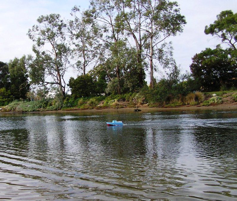

                                                corona 8.jpgcorona 6.jpgcorona 5.jpgcorona 4.jpgcorona 3.jpgcorona 2.jpgHi All
                                                Well we are back in the water !!!
                                                Eight members turn up(limit is 10), cracking day with three new boats in the water.
                                                The cabin cruiser was first tested on 3S 5000mah Lipo and O-boy I got it right !!!
                                                The Surpass C3542-1250kv is a dam good motor !!!
                                                It turn the 2 blade CNC 32mm prop with no trouble.
                                                After a rudder trim change the boat track near straight.
                                                As I was only running a 60A ESC and the specs say the motor draws 65Amps, I was repaired with a 100A ESC.
                                                But as I had no trouble, I reprogram the ESC to 4S !!!
                                                I for a penny, in for a pound !!!
                                                The boat is a rocket on 4S and sits with the last 150mm 0n the water.
                                                The ESC handle it OK with a lot of full fast runs.
                                                Turning is better than the original hull with less bow dig in.
                                                So it's back in the workshop to get finished.
                                                Harry Smith(with a big smile).
