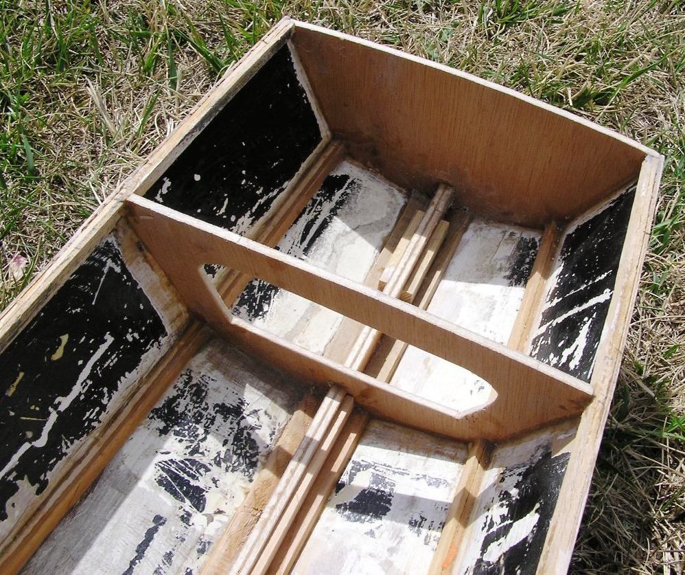

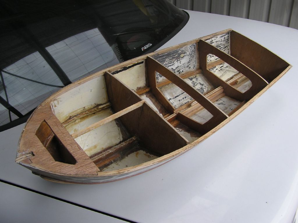

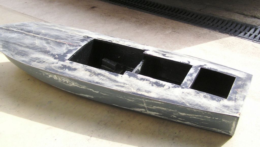

      p1010131.jpgI pick this wooden hull in a swap with other model boat stuff.
      I thought of turning into a cabin cruiser as I have two Perkasa boats already.
      #4641
        Ex Vopser Perkasa
        #86178

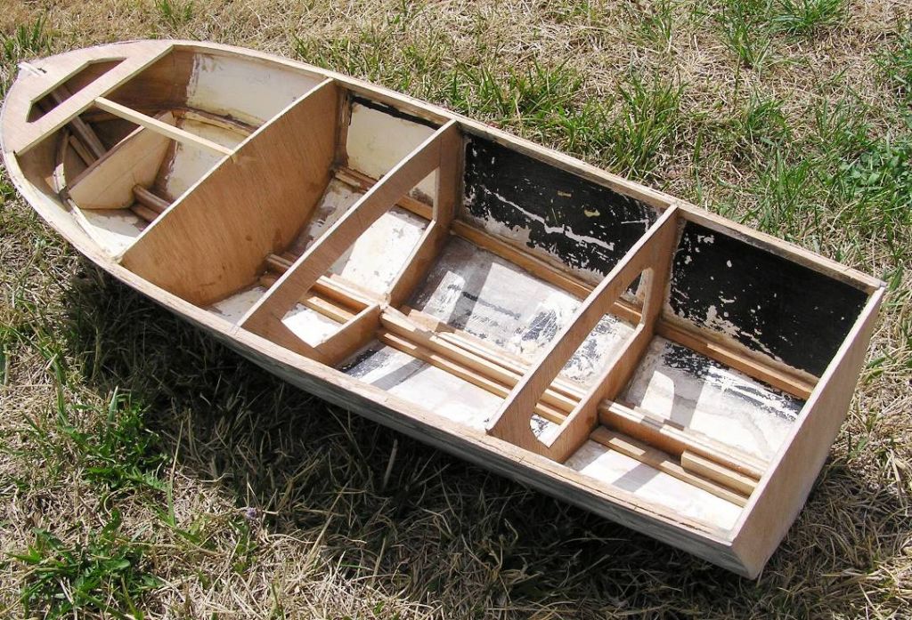

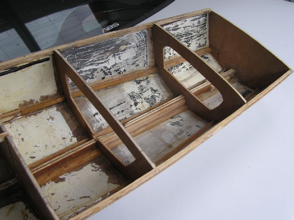

            Hi Ashley

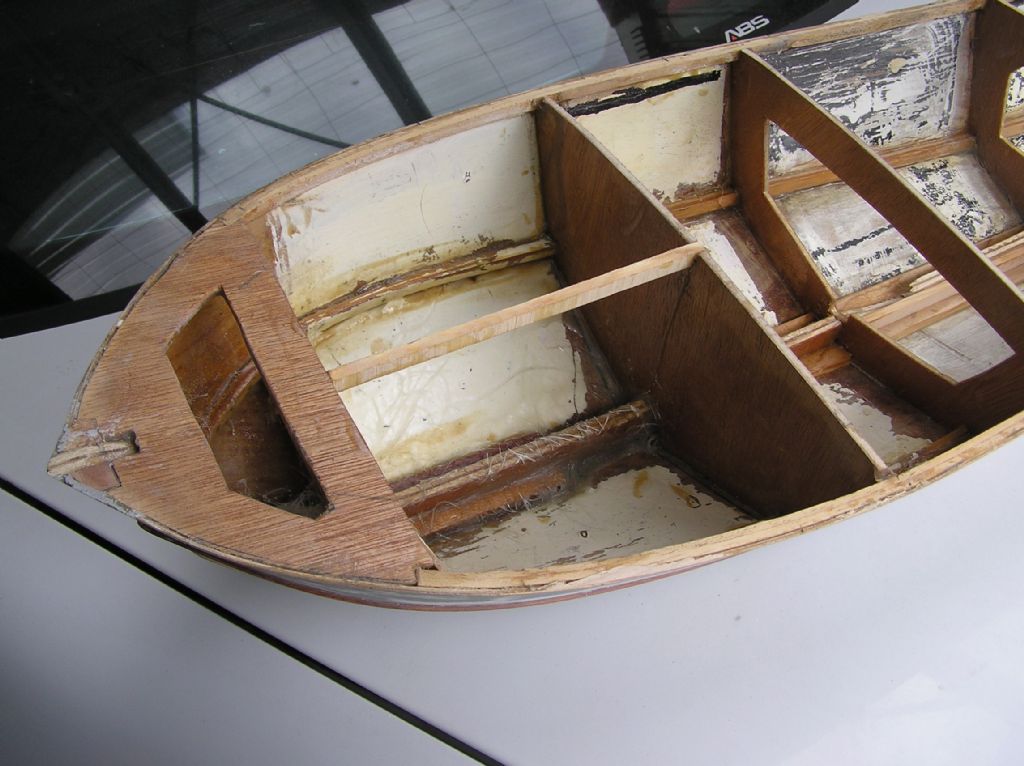

            Removed the deck and found all the forward frames had been wet at one point .
            All the frames totally shot.
            So far talking to the old owner, the bet is a case of Corona BEER if I get it back in the water !!!!
            So I had cut the keel out to forward of the second frame and made a new one from double 4mm plywood.
            Next will be new bow frames.
            I think I am going to earn this case of beer!!!
            Harry

              Hi All
              Repaired all the bow section back to the second frame which has a large rectangle hole in the middle.
              Next is to replace this frame and set the rest of the new keel into place.

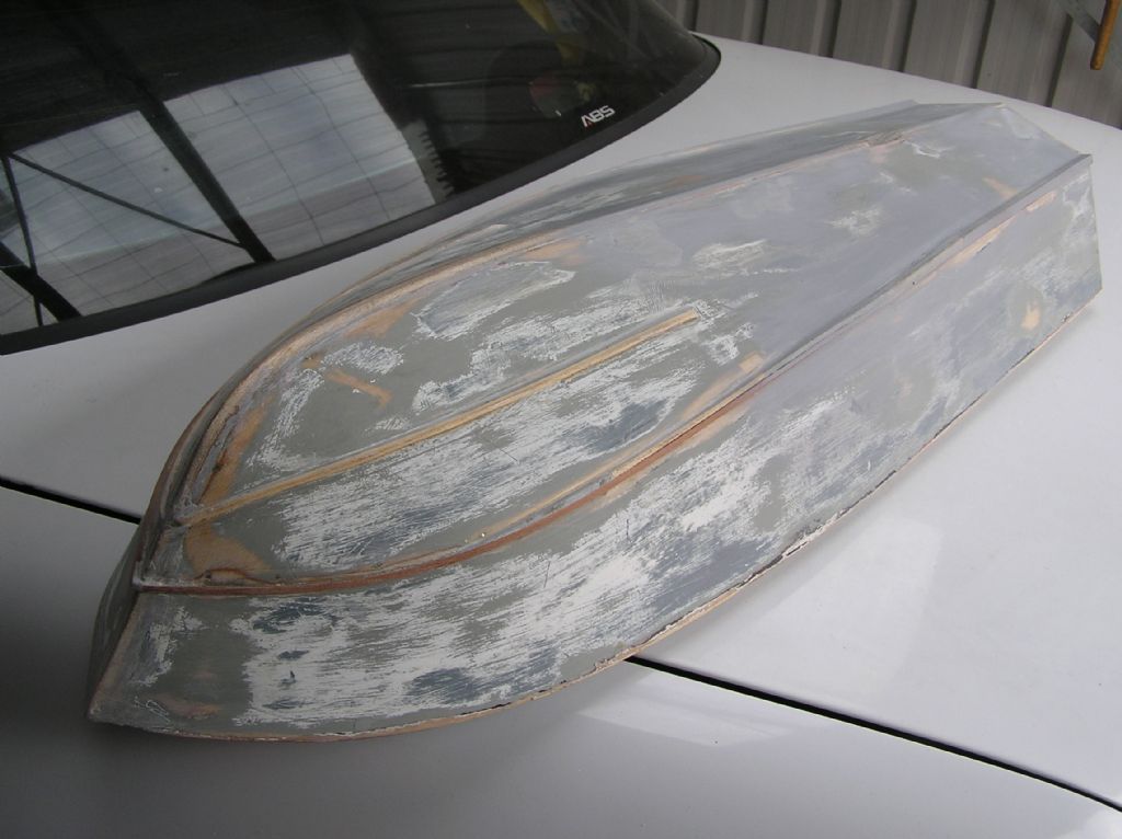

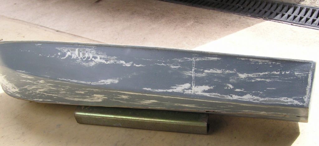

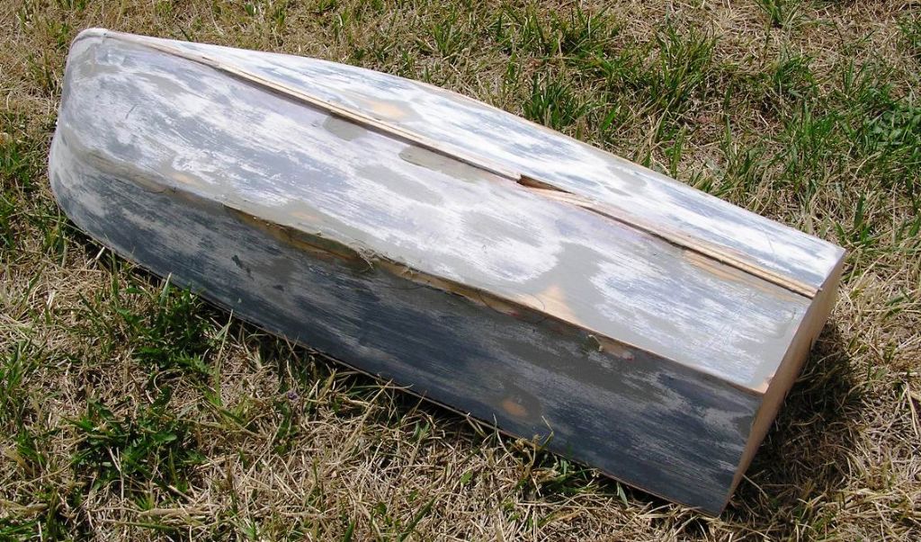

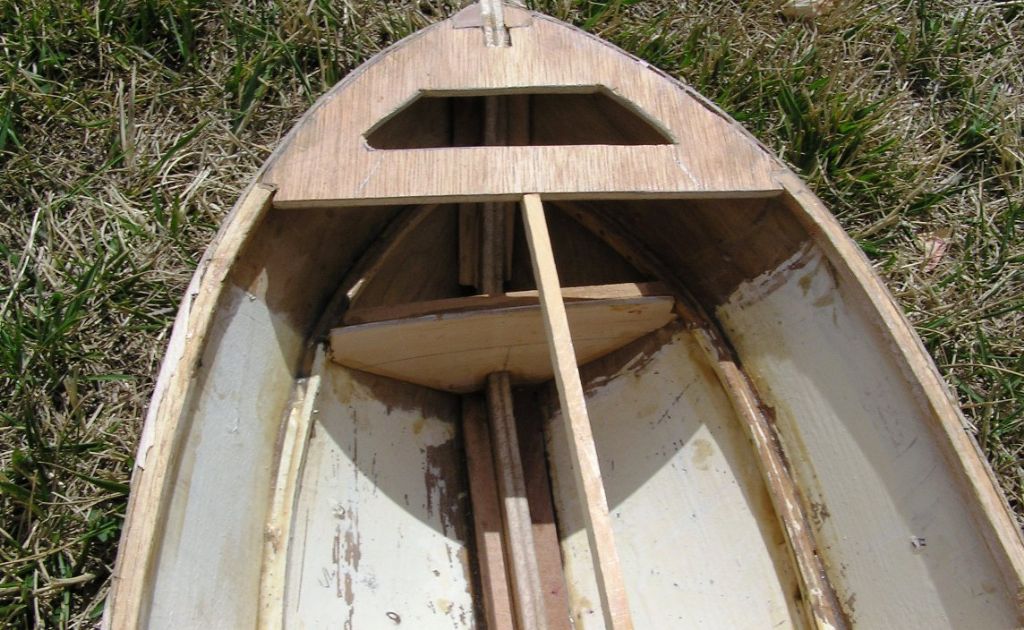

                          p1010137.jpgp1010136.jpgp1010135.jpgHi All
                          The hull is back in one piece with a few edges to fix, but over all happy with it so far.
                          Fibreglass forward of frame 2 tomorrow.

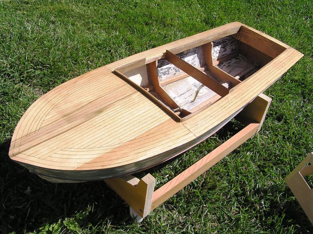

                            p1010139.jpgHi All
                            Fibreglass the forward section of the boat just before the weather change to low cloud and rain !!!
                            Ran the blow heater of a hour to get the fibreglass to harden up.
                            Harry Sp1010138.jpgmith

                              Hi All
                              Added two deck stringers today and skinned the deck with balsa.
                              Spread the glue out on the underside of the balsa to seal it.
                              More glue on the contact sections.
                              Harry Smith

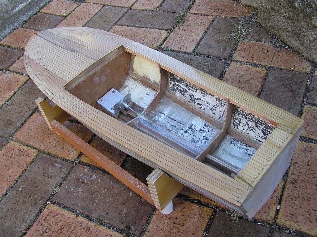

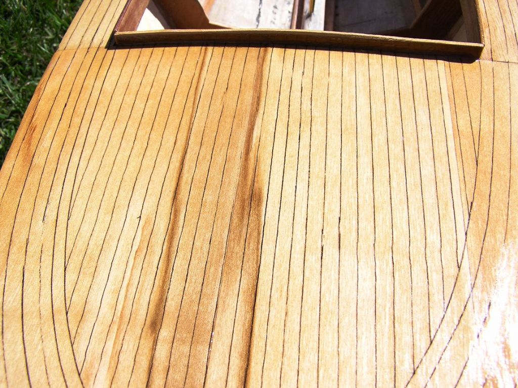

                                  #86553
                                    Hi All
                                    Blackwood veneered the deck and sealed with wood sealer.
                                    Adding two coats of gloss vanish then an experiment with permanent marker pen( .03) for planking.
                                    Hoping by sealing the wood first that I will not get bleeding with the pen.
                                    Add two more coats of vanish after that to seal .
                                    If it fails I will only have to rub it back a bit, but not back to the veneer!!!!
                                    Harry Smith
                                    PS The two deaths in Tasmania were from one un famous named cruise ship !!!
                                    #86560
                                      Harry. I have found that thin marker pens seem to go dry when lining on painted surfaces. Perhaps I have not been using decent pens, or there is a difference on their performance on different paint surfaces.
                                      Youmay like to try a test piece first? Or use the pencil on unsealed wood trick (then varnish)
                                      #86571
                                        Hi Ashley
                                        The pen I am going to try is a Unipin fine line by Mitsubishi Pencil.co.ltd.
                                        I tested on paper and white plastic and if left for 15/20 seconds will not rub off.
                                        The rubbed back vanish should make a good surface for the pen.
                                        Harry Smith
                                        PS Another one died from that cruise ship today in Tassie !!!!
                                        #86575
                                          Hi Harry,
                                          Have you tried a water based varnish ? I find it leaves the timber much lighter in colour than the normal oil based yacht varnish, this showing the lines drawn rather better 😀

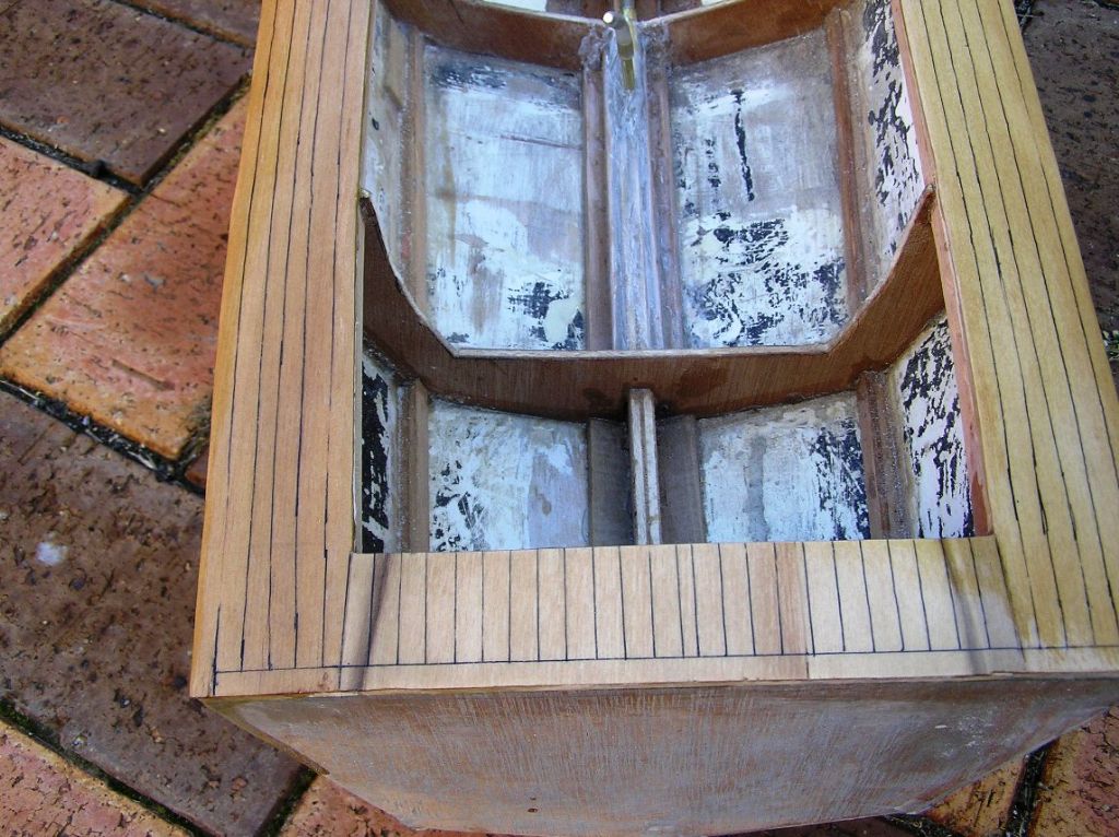

                                          #86631
                                            p1010143.jpgp1010142.jpgp1010141.jpgHi All
                                            Added chine and forward spray rails.
                                            My experiment has worked fairly well with little bleeding.
                                            It's not a 100% but passable.
                                            Another few coats on top to finish it.

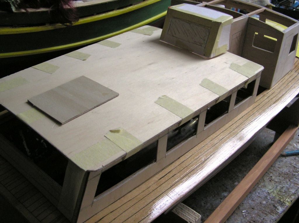

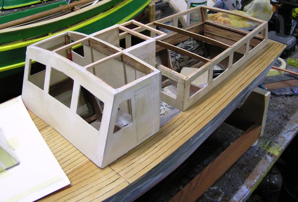

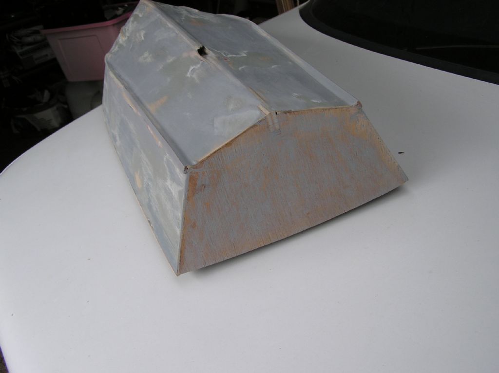

                                                p1010147.jpgHi All
                                                Started making the wheelhouse and cardboard rough pattern for the cabin.
                                                Planning a lift out deck section between the two.

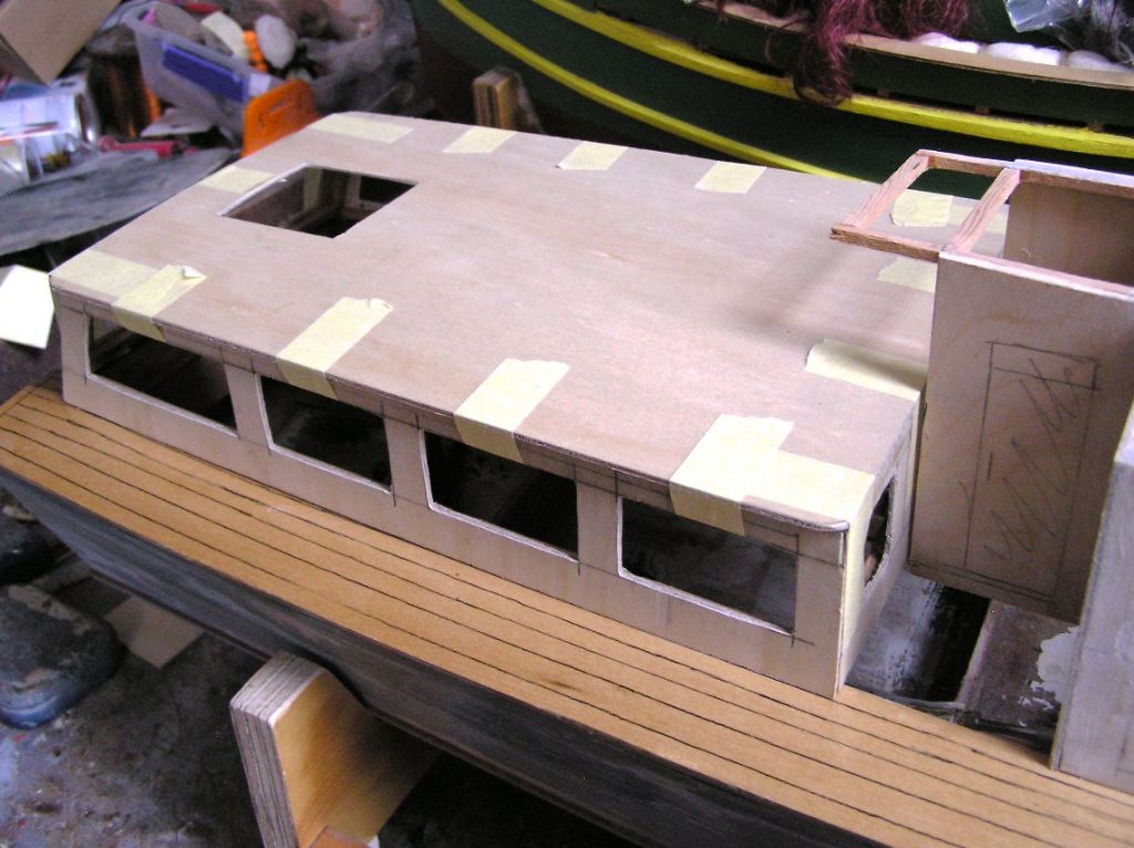

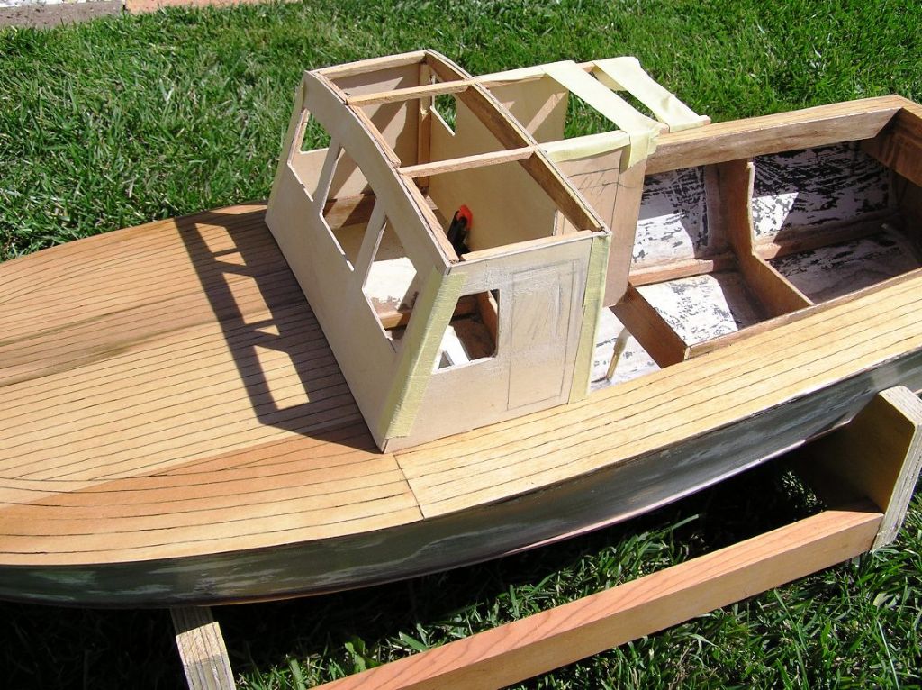

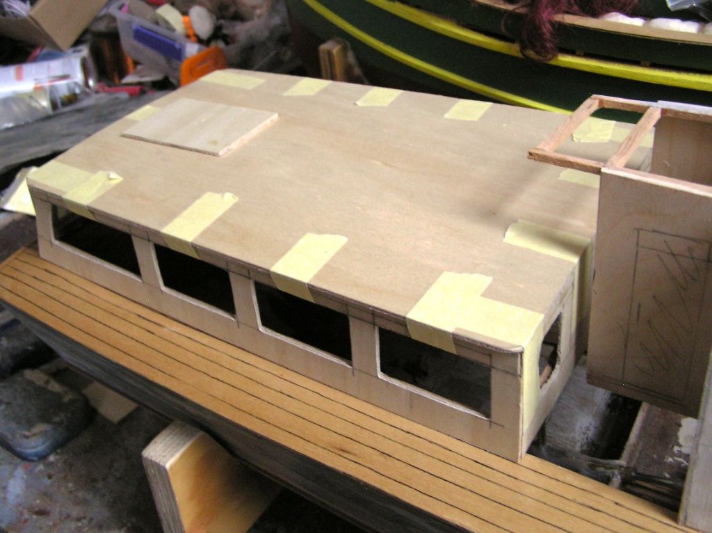

                                                #87176

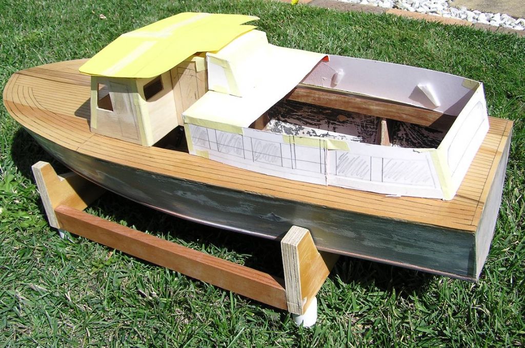

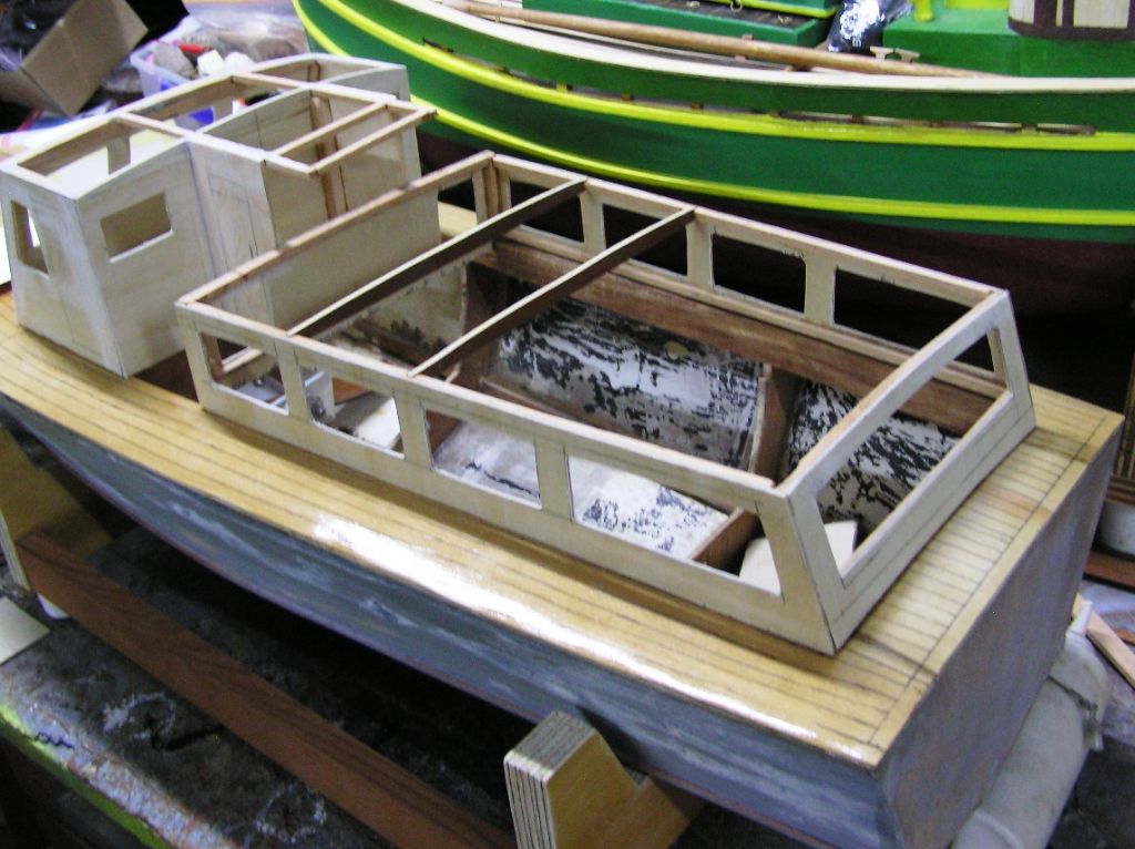

                                                  p1010153.jpgp1010152.jpgp1010151.jpgp1010150.jpgp1010149.jpgHi All
                                                  Design my own cabin setup with 19 windows and a Hatch.
                                                  Stacks of boats getting built at the club and a number getting finished.
                                                  Hopefully we maybe sailing after May11 !!!!
                                                  We are allow to go to our holiday Shack(home) to do security and general maintenance.
                                                  So a big day out (133.6 KM) and three hours mowing on the ride on mower!!!
                                                  It was high tide and very calm, but I did not take a boat.
                                                  As it was only got home at 6PM.
