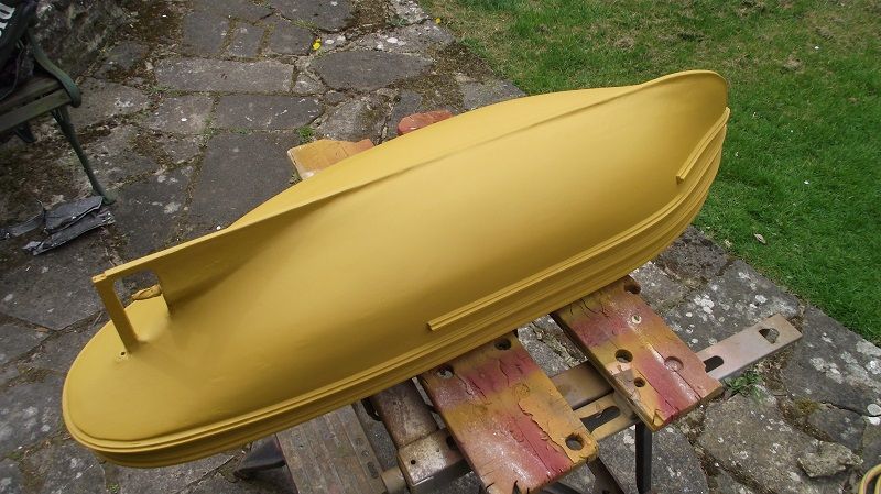

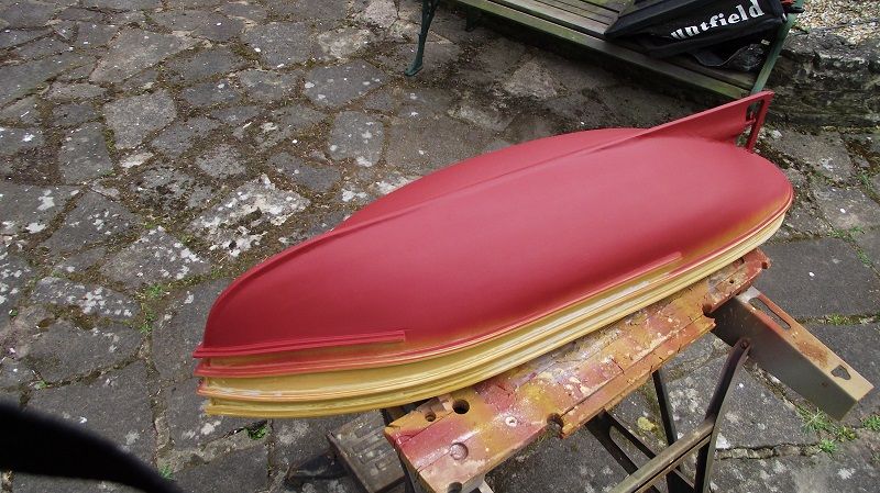

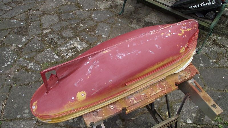

      Fresh out of the paint shop, well the garden, the 2nd. coat of primer and more filling and rubbing down to do.
      Eddie.

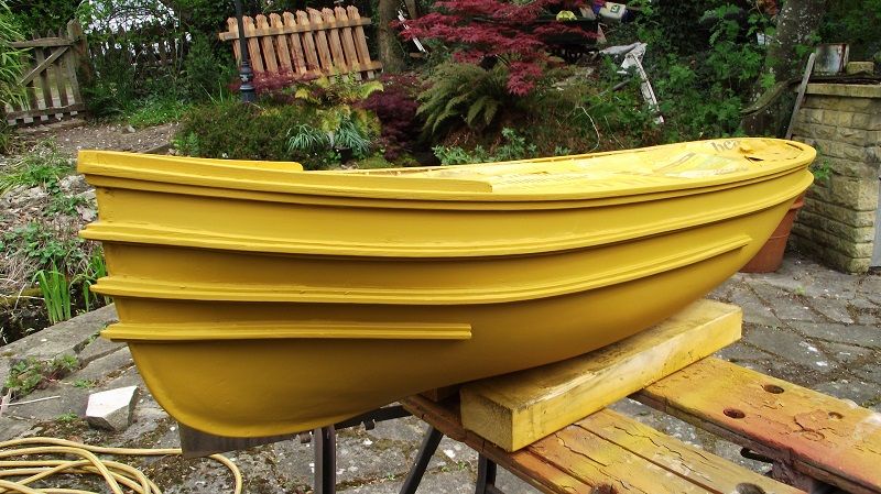

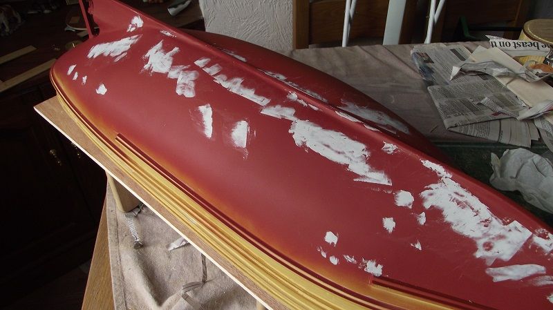

          I had thought about leaving the topside that colour but have decided to keep to my original colour scheme.dscf3466.jpg

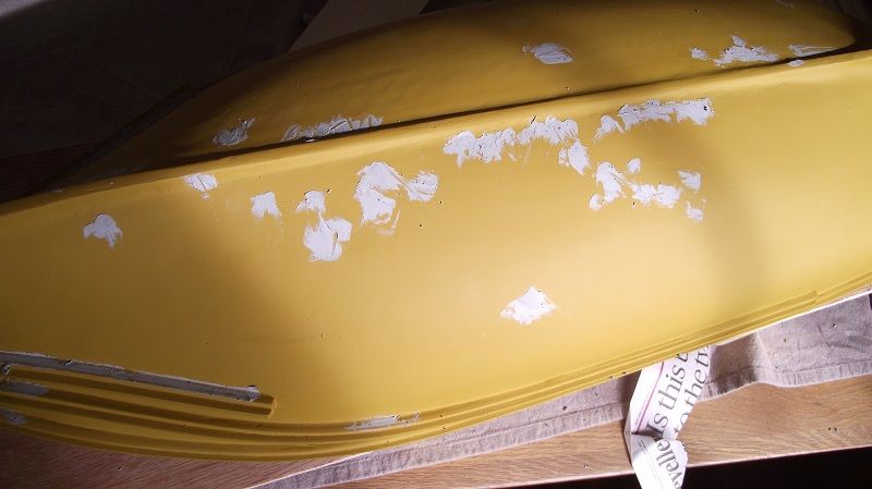

          The first coat of the final below the water line colour,it will be left matt with a protective coat of matt lacquer.
          Even more filler,but it's not quite as bad as it looks.
          After rubbing down again not much of the filler is left. The next coat of paint will show if anymore filling is needed.
          Eddie.

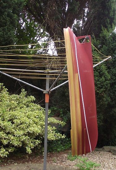

              Hi. Roger, don't worry about your colour scheme mine will be red, green and black, based on SS Master.
              I put mine on the pond today to find out how much ballast would be needed to get it down to the design water line,but disaster, it started to fill with water, after a hasty removal from the pond and a quick look around i spotted a smallish hole above the prop shaft were it leaves the hull, when I joined the two halves together I used 24 hour epoxy to give plenty of time to get all the clamps on, and I think the epoxy must have slumped around the shaft leaving a passage for the water to get through, anyway a bit of 5 min epoxy worked into the hole and allowed to seep down seemed to do the trick.
              Luckily the neighbours can't see my washing line!
              It needed 5900 grams to get it down to the line, but motor and battery weigh 1500g the engine house and wheelhouse weigh 1000g leaving 3400g of lead.
              Regards.

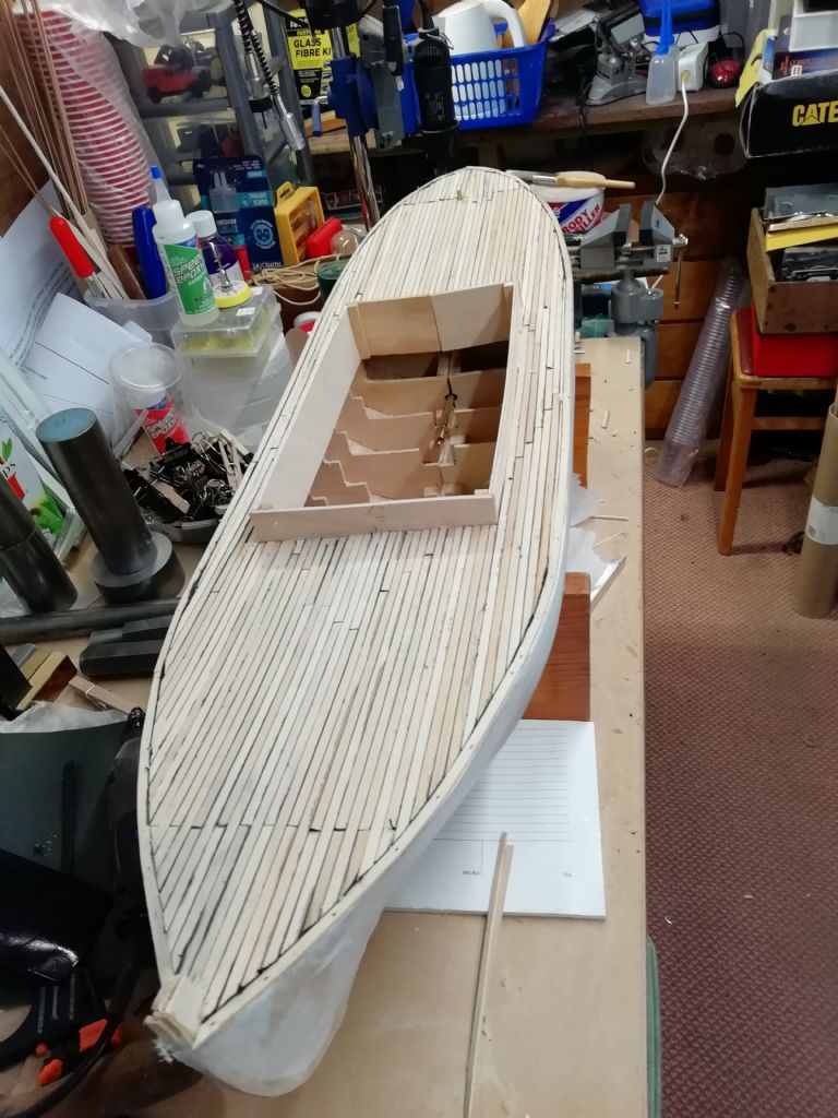

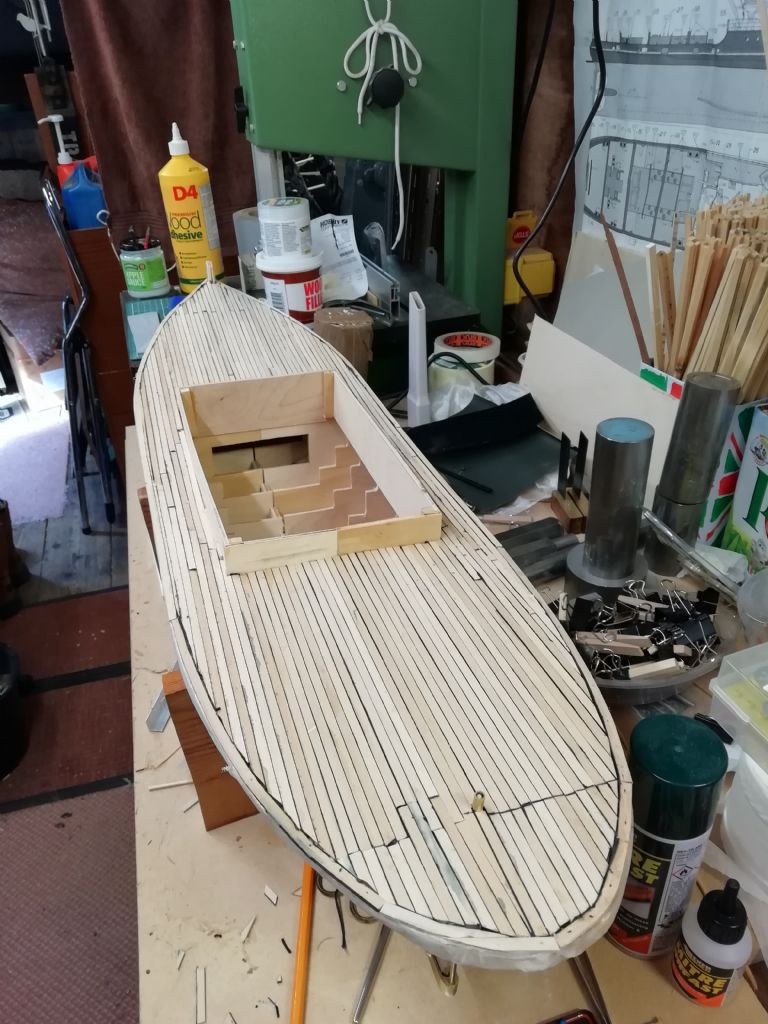

                    Well, another milestone (knotstone?) has been reached today smiley
                    The decking is complete!!
                    A second one just to show how ropey it is crying
                    I do intend to weather the decking as befits a working vessel but I did have an element of bleed from the paper used for the caulking but that's how we learn. I'll do a coat of sanding sealer which will stiffen up the wood and paper fibres and give it a quick rub down and the some weather stain (it silvers up the wood) and then another coat or two of sanding sealer then some satin varnish rubbed down with very fine paper to take the shine off.
                    Anyway sit and relax and let the backpain go away. smiley

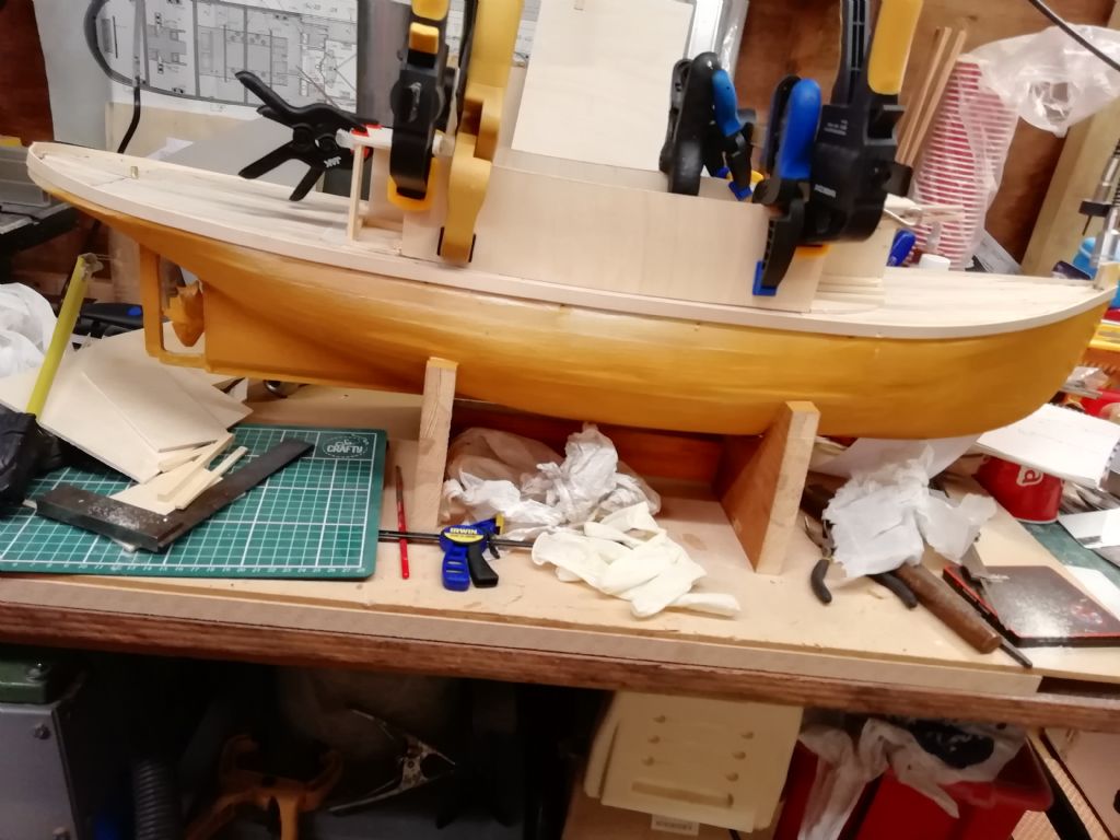

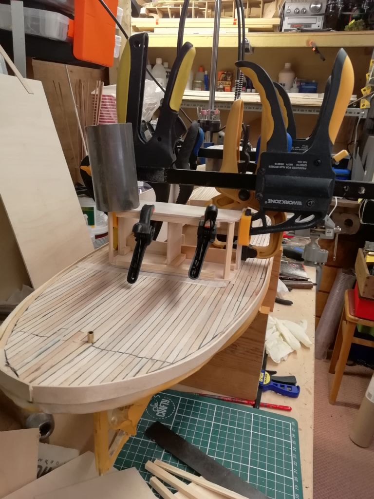

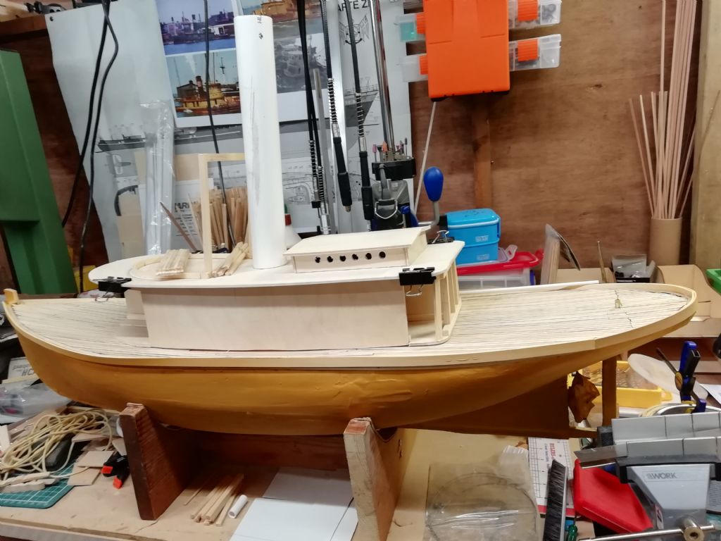

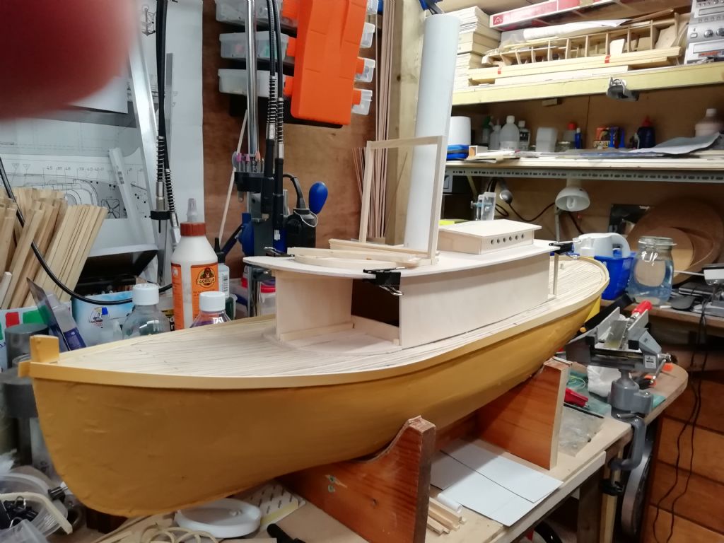

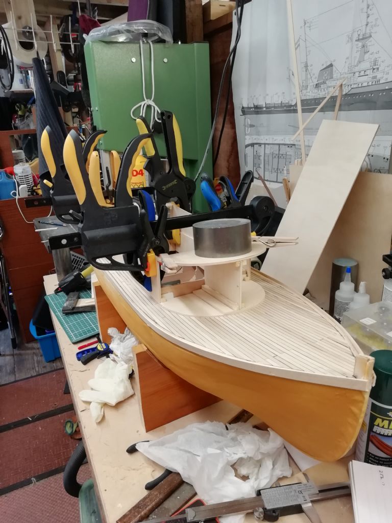

                          Hi All, another entry in the build, put a coat of primer on the hull, not too displeased with the fiinish, some areas need attention but not as much as I feared.Thought I'd bash on with the superstructure for a change. smiley
                          Got it clamped up while gluing smiley
                          The view from the stern
                          and a full broadside, I decided to stray from the plan on the topside, it's surprising how accessible the inside is with the sides on, just might make all this permanent or semi-permanent and just have the top deck removable, we'll decide later on, any comments on this guys, oh and gals. laugh
                          I found that American white oak was often used for the main deck on tugs of this era so I think that is what I shall go for, also I think I will use two 6 volt 3.2 Ah or 6 Ah batteries depending on what will fit without disturbing the C O G too much. I'll make up boxes containing lead to the relevant sizes when I'm ready for ballasting and do some roll recovery tests.
                          Hey I'm sounding like a pro here laugh, It's only from reading and taking onboard advice from you allwink.
                          Regards
                          Roger

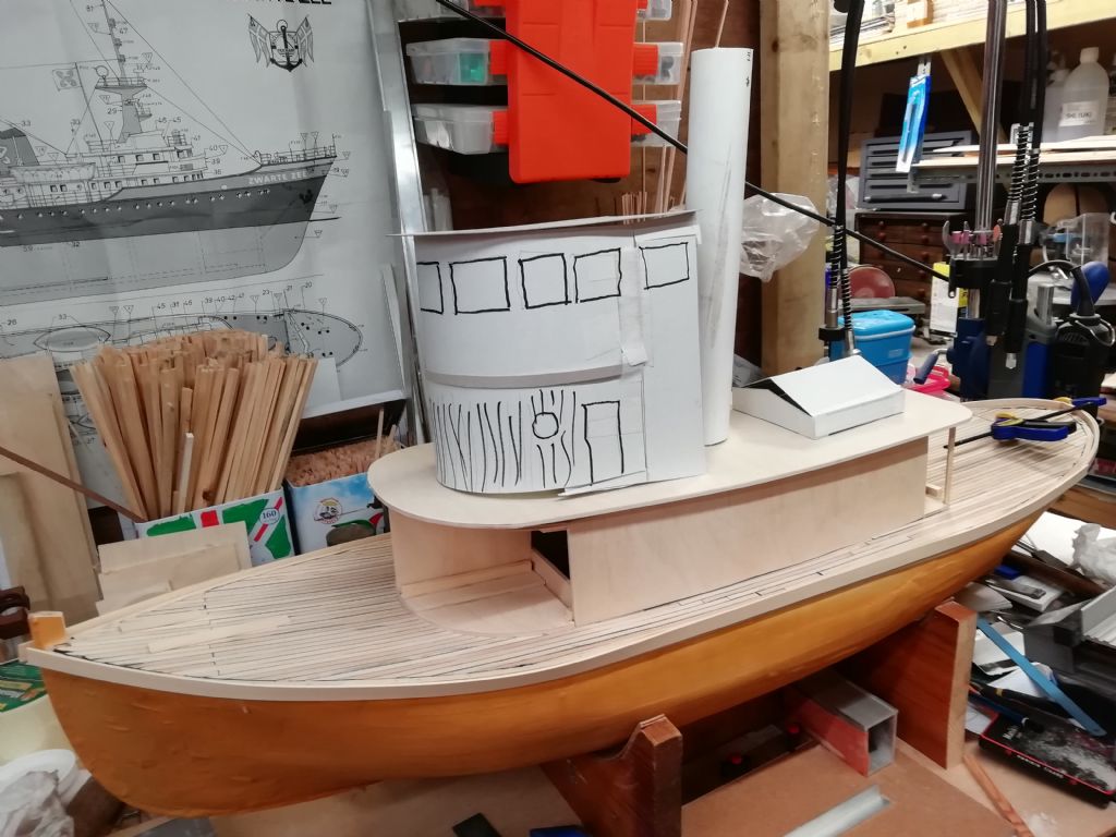

                              I've done a mock-up to try and get perspective of the final build, been using Invincible as part of the style:
                              And this is my mock-up, Cowl vents to be added smiley:
                              So any thoughts, comments, advice anyone? (Other than my grandson could draw better laugh)
                              Regards
                              Roger

                                Hi.Roger, with a build like this, not based on any existing boat, anything goes, so whatever takes your fancycheeky.
                                Eddie.
                                #82080
                                Roger Clark
                                  @rogerclark
                                  Hi Eddie, OK that's it I'll glue it up and run as is laugh

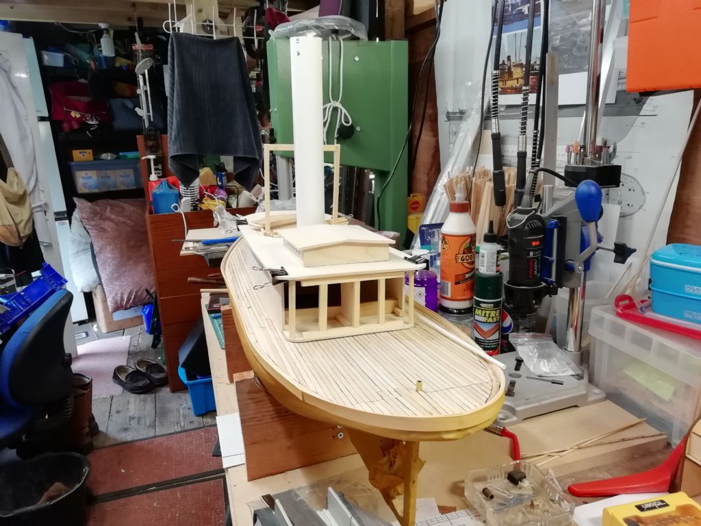

                                    A bit more progress made, filled and rubbed down the hull and another coat of filler primer and some more work on the superduper-structure:
                                    Funnel is just spot glued to get correct rake:

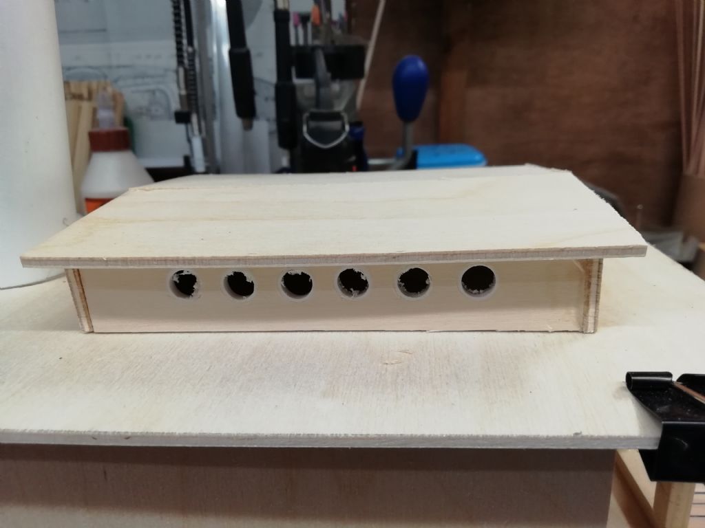

                                    Gone with a different version rooflight:
                                    As the speaker underneath will be a waterproof one I might leave the little porthole vents with no glazing.
                                    Really enjoying this part of the build smiley

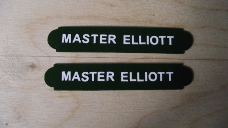

                                            Hi.again Roger, just finished the name plates for my tug,Master is a nod in the direction of the SS Master that I have taken the colour scheme from and Elliott is my grandson.
                                            Have you thought of a name for yours yet?
                                            Eddie.

                                              Hi Eddie, They look great, how did you make them?
                                              Yes I have got a name for mine, it will be Lady Barbara, a nod to my wife, after all she 'tugs' my heart strings, pulls my wallet out and pushes me out shopping so what better? laugh
                                              Regards
                                              Roger
                                              #82119
                                              Eddie Lancaster
                                                @eddielancaster
                                                Hi. Roger, you creepcheeky, the boards are pieces of 1/32" ply painted, the letters are BECC 1/4" vinyl from the Model Dockyard.
                                                Regards.
                                                Eddie.
